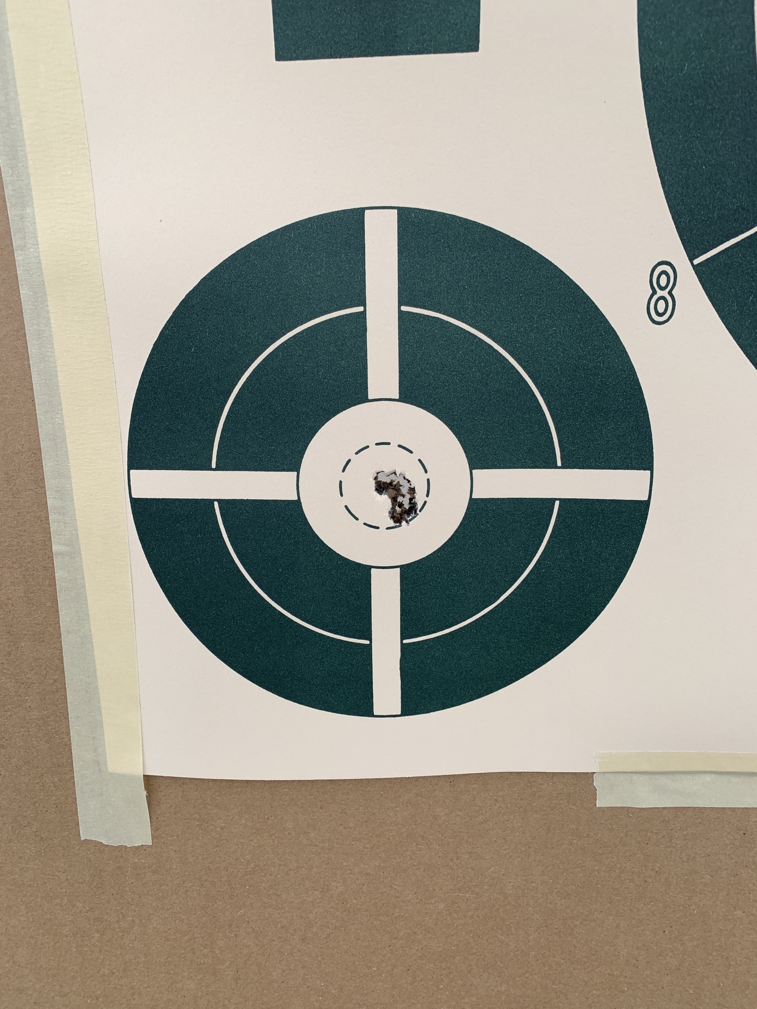

What exactly is a hammer to you? Does it go sub .75moa consistently? Sub .5moa?
Baited question because I know where its going, but I'll play. I've only shot a couple groups for the sake of shooting groups, I find it mind numbing. I've shot a .2665 three shot group and this unmeasured five shot group. I have no plans to do a 5x5, so infer from it what you want. Cherry picking? Maybe a little. F2hqptE.jpg
Was legitimately just curious. How were the other groups, besides the two? I’ve seen a few good groups come out of those barrels, but it just wasn’t consistent. Some tended to walk a bit once warm.
Probably around half with some at three quarter that I’d say are more me than anything. That five shot was shot at the end of the session. Barrel wasn’t piping hot but not cold either.
My 260 shoots consistently well. Any 'thrown' shots are all me.
On a side note my 260 upper/lower fit is not super tight. All other Larue's are tight.
100 yards:
