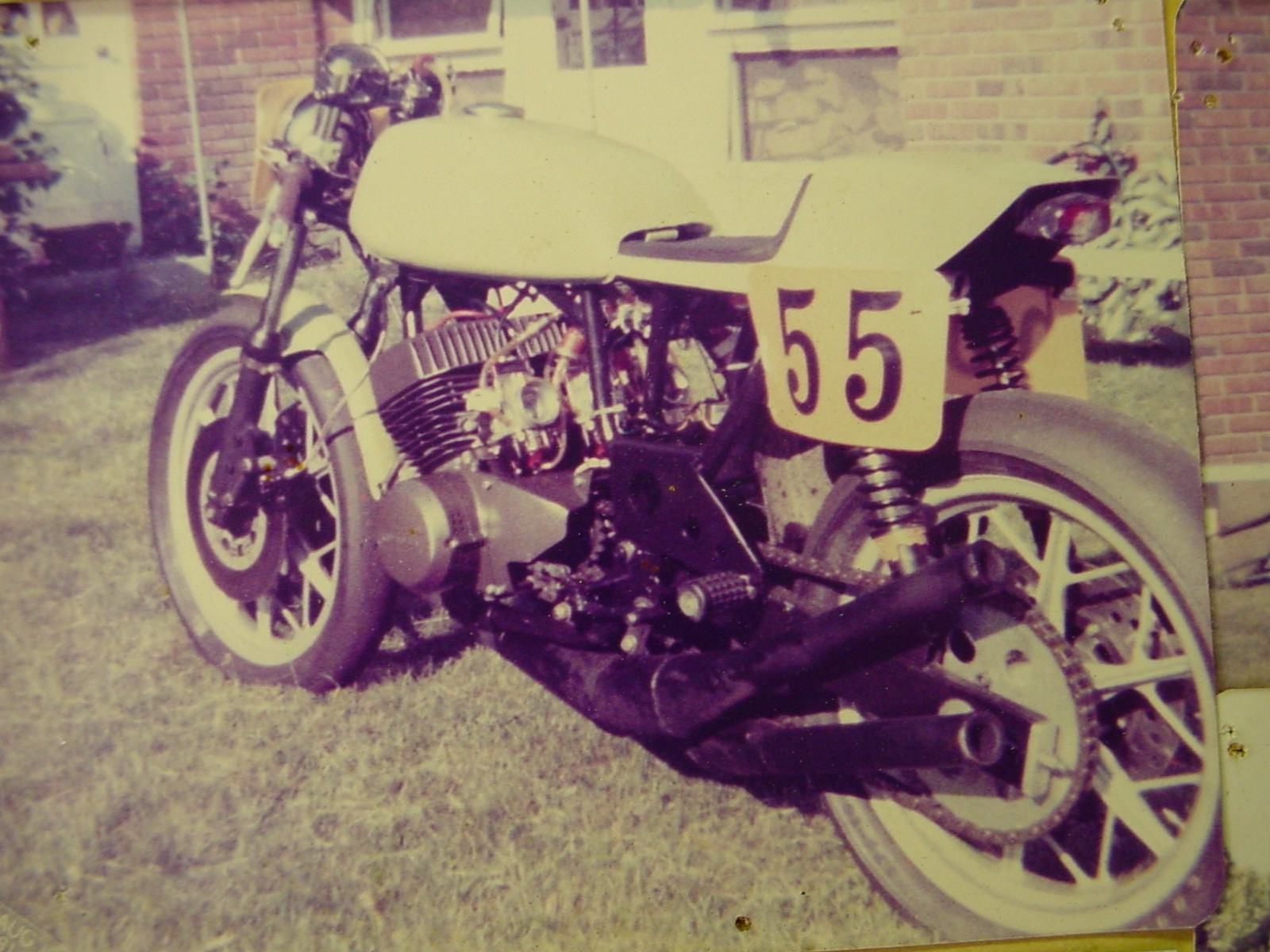

I ran Lectron Powerjets on my racer, outstanding!

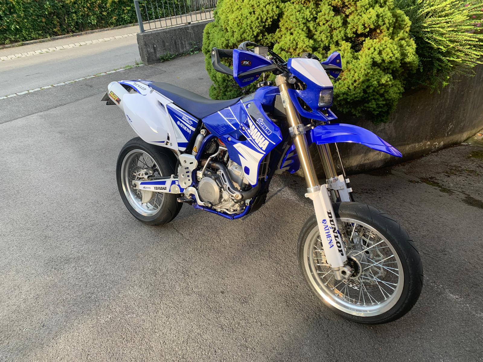

Heyo guys,
So i´ve bought this Lectron GEN 2 Carb for my WR450F 2005 here in Europe last year in january and i didnt get it running well since that.
As you mentioned i told em all my settings and so on bla bla, have to mention first: Im not that good with carbs tho, got my FCR running well but it was very old and worn out (gas slide kept stucking when going off the throttle, cause the slide and housing was worn out etc.) and i wanted to try something new and stepped about that exact page that you posted in here first message @clcustom1911 .
I got it and first things first i broke my IFS housing (Idle fuel screw) because i just turned it a lil bit too far inside, had to send it back to get a new housing. THEY COVERED THE SHIPPING COSTS THO! Very grateful for that!
Should you really not change the stock settings? With these i dont have the best starting behaviour even when its warm outside (20-35 °C , classic summer...) It had insane decellaration popping aswell, so i decided to lean it out a bit... it´s gotten way better BUT at 60-70% gas (prolly around where the Power jet opens up to deliver extra fuel) the bike is gasping and jumping and jucking around (You could only ride before Power came, or with full throttle or atleast 85-90%).
After trying to set that thing up and spending about 20-40 hours just driving around and changing the settings trying to get anywhere because i couldnt stand it anymore (Either i had that problem i just mentioned but a good Idle or if that part of the throttle range was good, the idle was so horrible i couldnt get it started after it stood for 2 days) i legit left the bike in the gutter after test riding and setting it for half a year here and there sometime.
Its in my garage now and i feel the pain that i cant ride it and im probably too dumb to set that thing right, cause i only hear very positive news from people buying that new GEN 2 carb that i bought and have only had issues with by now.
ANY TIPS for a 21 year old wannabe mechanic supermoto rider?
im really thinking about going back to stock and just trying it all again from the beginning.. cause i wanna ride that bike againThanks in advance...
