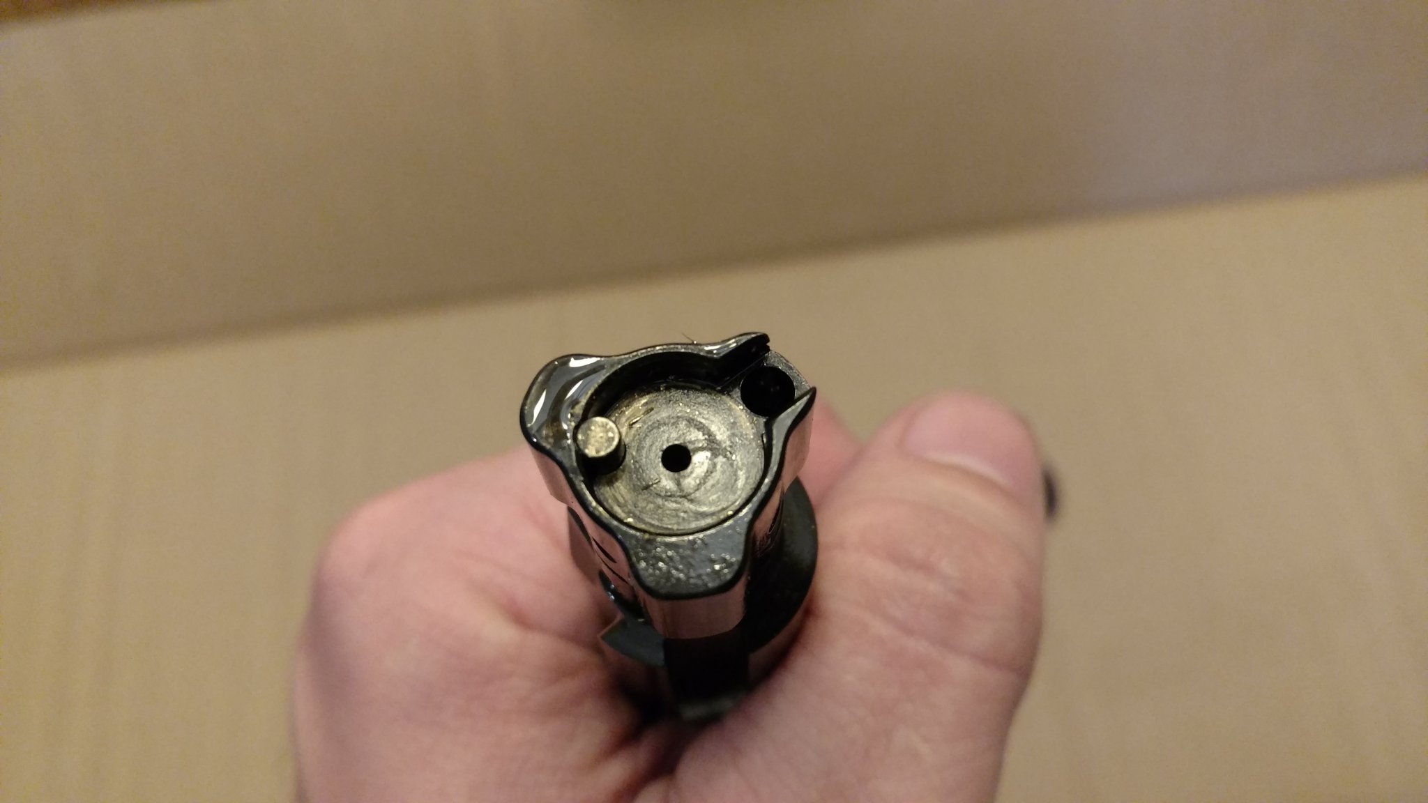

Brought my brand new 6.5 Creedmore precision rifle to the range yesterday. A friend of mine is letting me borrow a scope and bipod until I get my own. We mount everything and adjust everything in his driveway getting everything perfect. We get to the range and set up 50yds to find the target. After 2 shots the extractor breaks on the bolt and we are DONE...
So my first time shooting distance was a complete disappointment. Now I have to call the manufacture and probably send my whole gun back, and have a gunsmith look at it.
You might just need to send back the actual bolt to Ruger.
I'd give them a call up first thing on Monday and talk with customer service & / or e-mail them this weekend.

I'm not really excited to send the gun back at mail, but it sounds like it's what I need to do. Probably put a note in there to put at least 50rds through it before even thinking of sending it back to me.
I had this same issue with a 700. Attempted to extract my 5th shot with the weapon and the extractor sheared off. I had a local smith do the work since it is the riveted in extractor and was above my level of the kind of stuff I tinker with. I can definitely feel your pain.
The only thing I can dredge up on DIY fixes for the RPR bolt is the 'detent ball'. Someone on 65Creedmoor Forum mentioned that you can use No.3 steel shot to replace it in an emergency.
Other than that, neither Anarchy Outdoors or Brownells, both of which normally carry a lot of aftermarket Ruger stuff, have any bolts or bolt components on hand.
RPR bolt detent ball / extractor removal thread:
Call Ruger Monday and see if you just send them the bolt? I've actually asked for parts from them and received them with zero problems more than once. And I have a Ruger Precision 6.5 Creedmore and have had zero problems with it. Imagine it is a fluke. I had far worse experiences with the crap Remington produces lately.

Were you just casually ejecting a factory round when the extractor broke, or was there a hot load in the chamber that you were trying to get out?
The first shot fired and extracted perfect. The 2nd fired and no extraction. The 3rd shot same thing. We pulled the bolt and looked at it and that's when the extractor fell off when we were checking it out.

The extractor is a pretty easy thing to change on the RPR. You need a small punch, the little tool to hold back the extractor and it comes out and is replaced rather easily..... Don't let something this petty get you down, there is a lot of fun in long distance shooting.

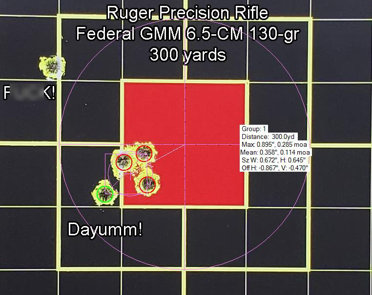

Will FOUR shots suffice in this case? Four shots in a 0.186-MOA group. That pesky 5th shot making it an embarrassing 0.518-MOA group? I calculated it both ways. :p (wait... keep scrolling)

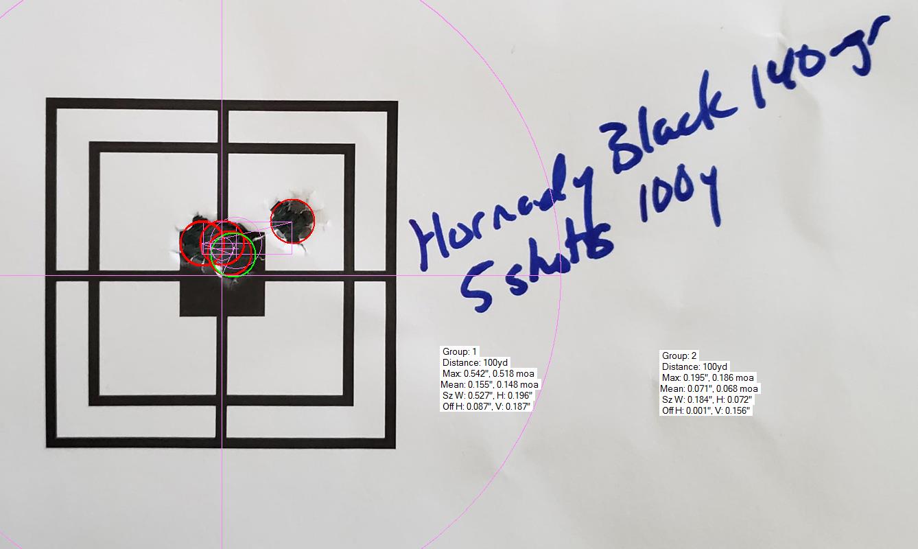

Or this one with the called flyer? It was still a 0.757-MOA group with the "flyer." But, four shots in a 0.285-MOA group is more than three! :p

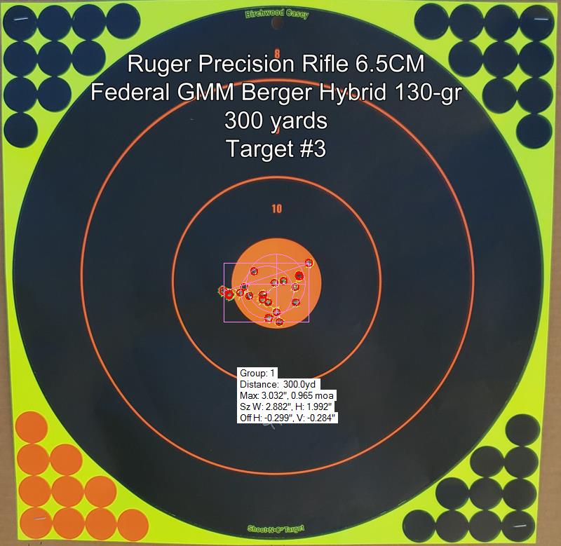

OK, OK.... if you INSIST on ALL five shots counting... Here ya go. This is from last weekend, with 2600 rounds through the original tube. 0.342-MOA. Close enough to 1/3? My annotation says 200 yards, but it was an actual measured 196 yards, which is what I used to calculate the group size.
7040279
Admittedly, the 1/3-MOA groups are not common for me.... But, I believe the rifle is better than me. That said... 1/2-MOA groups (yes... 5-shot groups are the only kind I do)... are pretty frequent, even in this noob's hands. Sub-1MOA is so easy, I feel like I'm cheating.

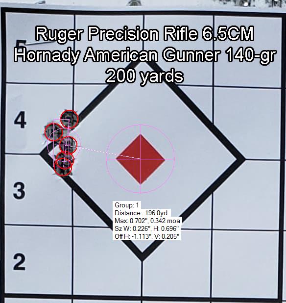

Instead of 5 shots... how about 20 shots at just sub-1-MOA at 300 yards? Shall I hang my head in shame? I've been at this for just over a year. :geek:
7040282
I'm kinda looking forward to when this barrel is finally "shot out," so I can stick a Krieger or Bartlein barrel on it and see what I can do!

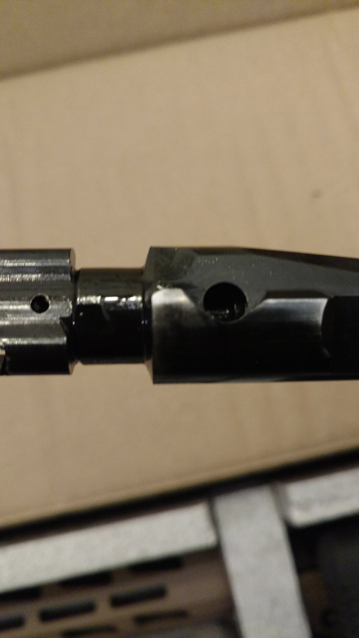

Factory rounds or handloads? You got pics of headstamps and necks of brass and bolt face? Would love to see.
Here is a picture of the bolt. Whatever was supposed to be in the hole is gone. It was stuck in a position and when it became unstuck it just dropped off, something small, I assume a spring shot somewhere, and the other piece fell into tall grass. We looked for it until we started getting attacked by fire ants. I don't have the ammo. It's all at my friend's house.
Reactions: 1J04
There is a retaining pin that holds the spring and the extractor in. See if the pin is there or broken, it is on the side of the bolt.
Nope, it's gone
