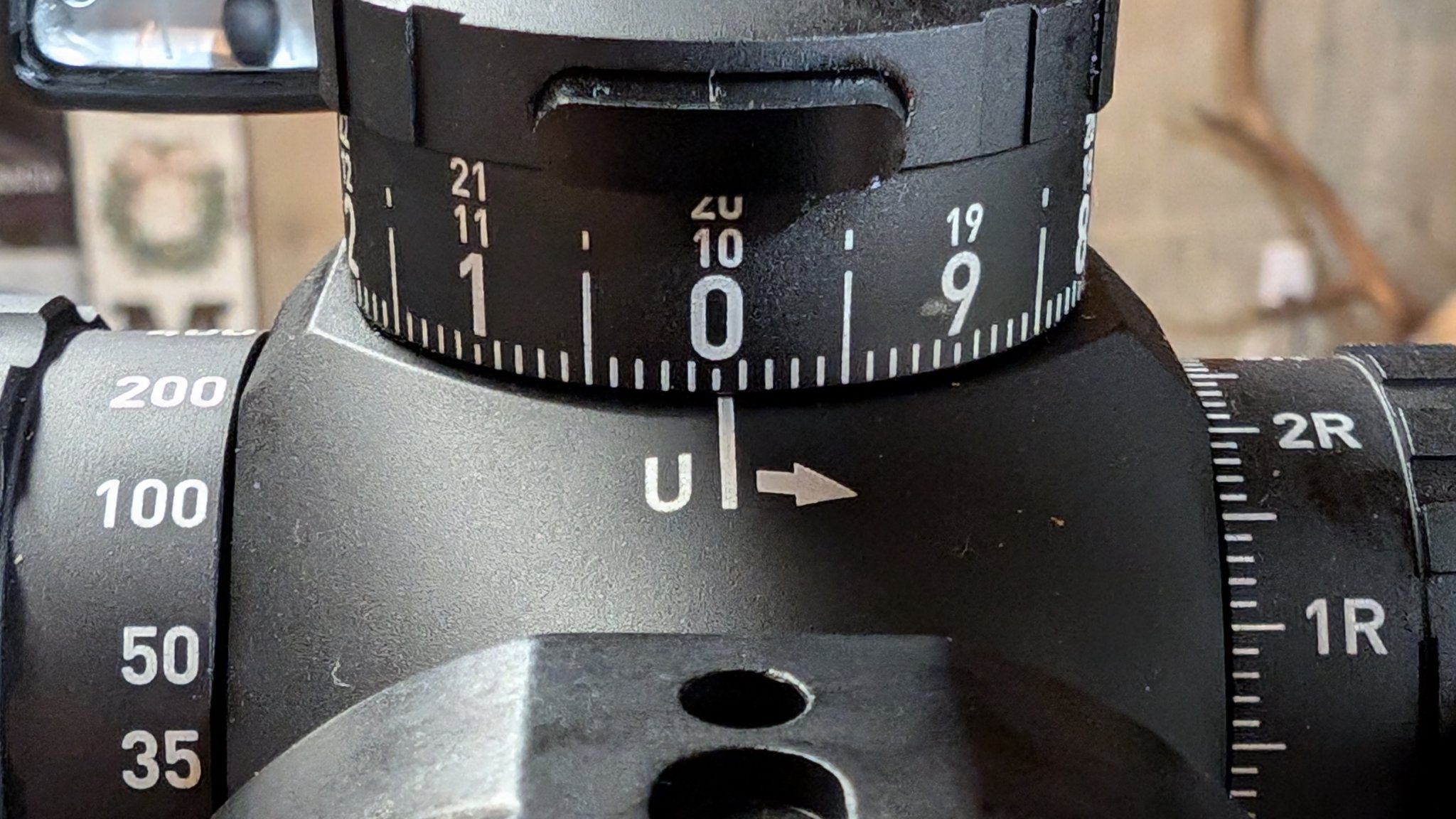

I apologize if this has been asked, I scanned the thread and didn't see it being addressed. Just got a MK4HD, is it a feature or a defect that the indicator on the dial lines up with left side of the line on the scope body. Curious what others look like. If it's supposed to be like that I'll learn to live with it but it is really messing with my OCD.
I apologize if this has been asked, I scanned the thread and didn't see it being addressed. Just got a MK4HD, is it a feature or a defect that the indicator on the dial lines up with left side of the line on the scope body. Curious what others look like. If it's supposed to be like that I'll learn to live with it but it is really messing with my OCD.View attachment 8488627
No way this is a feature. I remember one time the bushnell lrhs scopes had this same issue and the entire hide threw a fit. Bushnell got them fixed.
Supposedly leupold has good warranty too, I'd go that route.
This is just poor design, and sadly, probably normal for the model. They missed a couple/few things IMO, like the zero indicator line being relatively big and 3x as thick as the short itty bitty .1mil lines, and the 2 set screws used to secure the turrets are really small too, so they kind of make any turret play/slop seem worse.
Yeah, so far I'm not very impressed. Hopefully the glass makes up for it but I gotta say, that's very disappointing for a $1500 optic. It's replacing an Arken, and the Arken is better in every way when it comes to the turret feel and marking. Which should be a ridiculous statement but it's true.
I contacted Leupold, I'm curious what they will say. In all reality it could be fixed simply by laser engraving the markings on the dial 0.05 mils counter clockwise. The giant line on the scope body just is what it is.
Reactions: Tikkaguy
Maybe not ideal, but certainly an option is to order a custom turret label from someone like IDTS Dryfire or similar and just place it where you need it. You may prefer their label anyways to the factory read/font.
