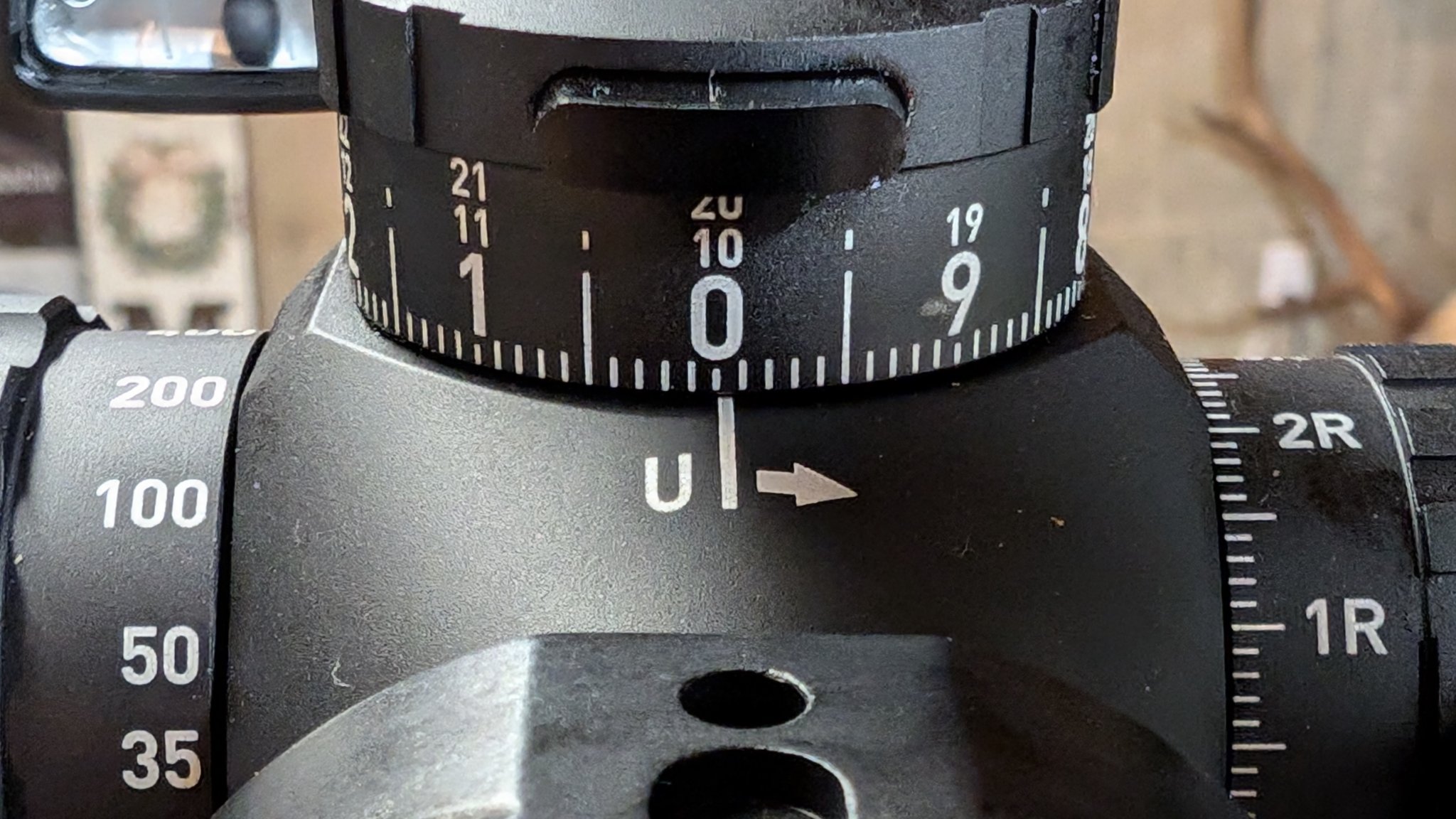

I apologize if this has been asked, I scanned the thread and didn't see it being addressed. Just got a MK4HD, is it a feature or a defect that the indicator on the dial lines up with left side of the line on the scope body. Curious what others look like. If it's supposed to be like that I'll learn to live with it but it is really messing with my OCD.
I apologize if this has been asked, I scanned the thread and didn't see it being addressed. Just got a MK4HD, is it a feature or a defect that the indicator on the dial lines up with left side of the line on the scope body. Curious what others look like. If it's supposed to be like that I'll learn to live with it but it is really messing with my OCD.View attachment 8488627
No way this is a feature. I remember one time the bushnell lrhs scopes had this same issue and the entire hide threw a fit. Bushnell got them fixed.
Supposedly leupold has good warranty too, I'd go that route.
This is just poor design, and sadly, probably normal for the model. They missed a couple/few things IMO, like the zero indicator line being relatively big and 3x as thick as the short itty bitty .1mil lines, and the 2 set screws used to secure the turrets are really small too, so they kind of make any turret play/slop seem worse.
Yeah, so far I'm not very impressed. Hopefully the glass makes up for it but I gotta say, that's very disappointing for a $1500 optic. It's replacing an Arken, and the Arken is better in every way when it comes to the turret feel and marking. Which should be a ridiculous statement but it's true.
I contacted Leupold, I'm curious what they will say. In all reality it could be fixed simply by laser engraving the markings on the dial 0.05 mils counter clockwise. The giant line on the scope body just is what it is.

Maybe not ideal, but certainly an option is to order a custom turret label from someone like IDTS Dryfire or similar and just place it where you need it. You may prefer their label anyways to the factory read/font.

I agree that the turrets kind of suck…

I ordered a turret tape from IDTS which hopefully at least makes it easier to read/dial.

Looks like the lines on the turret simply hold left edge of the line on the body.
Always left edge right? 😀

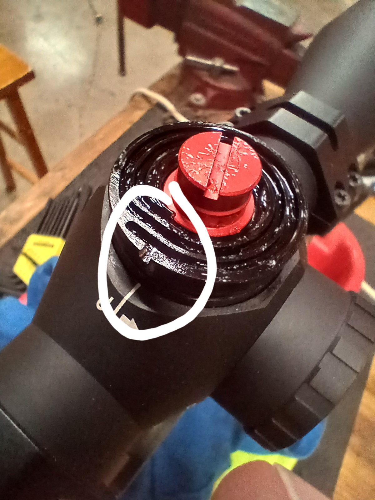

I took a small file on both of mine and opened up the slot that the detent fits in until the turret lined up. I can get pictures tomorrow.
I just got another one and it looks just like the pic @dzeke posted (damn Leupold :mad:), elevation turret is off in the same manner.
I'm hoping your fix is simple because I'd like to mount it, shoot it, and be happy... instead of having to send it back and waiting for it to be made right first.
The good news is the turrets have less slop/play in them as compared to my first one.

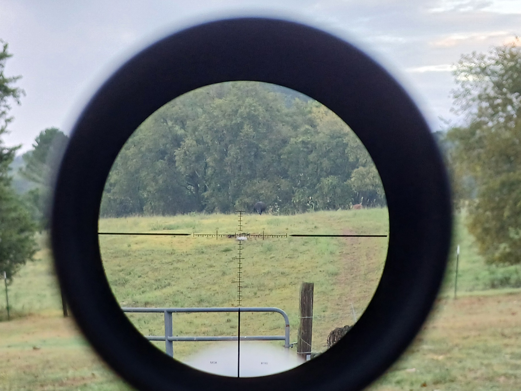

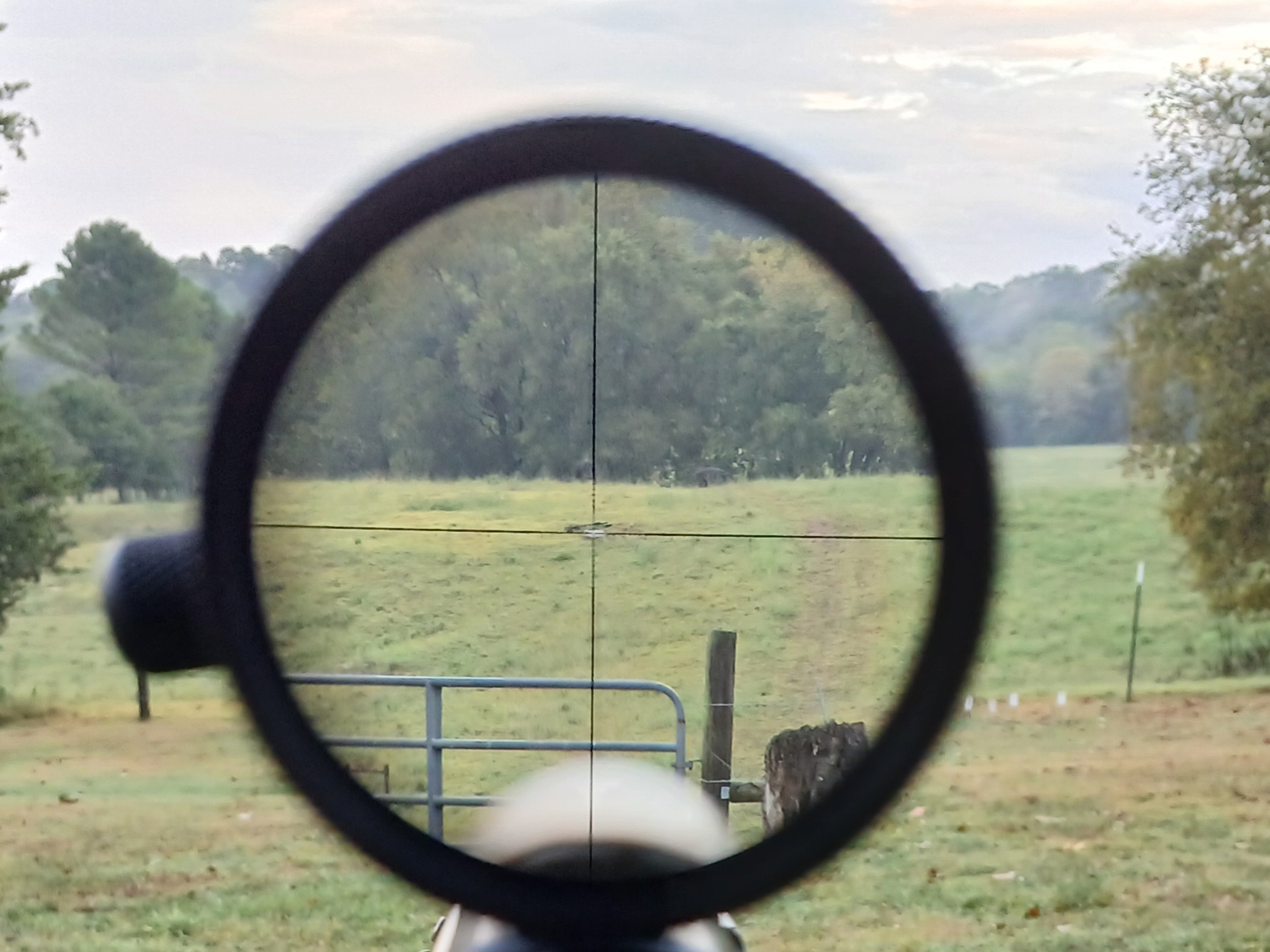

The 2.5-10x42 is just about the perfect hunting scope for me. I really like both of mine.
If you don’t mind me asking, what versions did you get? I’m tickled by the ffp version but would love to know if the reticle is usable on lowest mag when in the brush with or without illumination? My lease has several spots where I’m limited to 30-50 yards and would love to be able to use it at low mag for more fov in there…
Thank you!
Thank you!
A close friend bought the 2.5-10x42 Illuminated TMR in SFP because he didn't envision using the wind holds on less than 10x.
I think he made a good choice.
-Stan
Thank you!
I have the illuminated TMR FFP 2.5-10x42. It works very nicely on low power. I shoot a little below 10x in the wind a fair bit, so holding for the wind with the reticle below max power is very useful for me.
Reactions: supercorndogs
I have the non-illuminated FFP TMR and to me it is still usable on 2.5 power. My experience with the illuminated version is that it is almost too thick.
What conditions are we talking about? Low light? I'm the woods?
I'm seriously tempted to get a FFP non illuminated. I have an NXS 2.5-10 mil dot but I'd like a FFP version with 1/2 mil lines.
The illuminated reticle looks thick in the PDF specs
