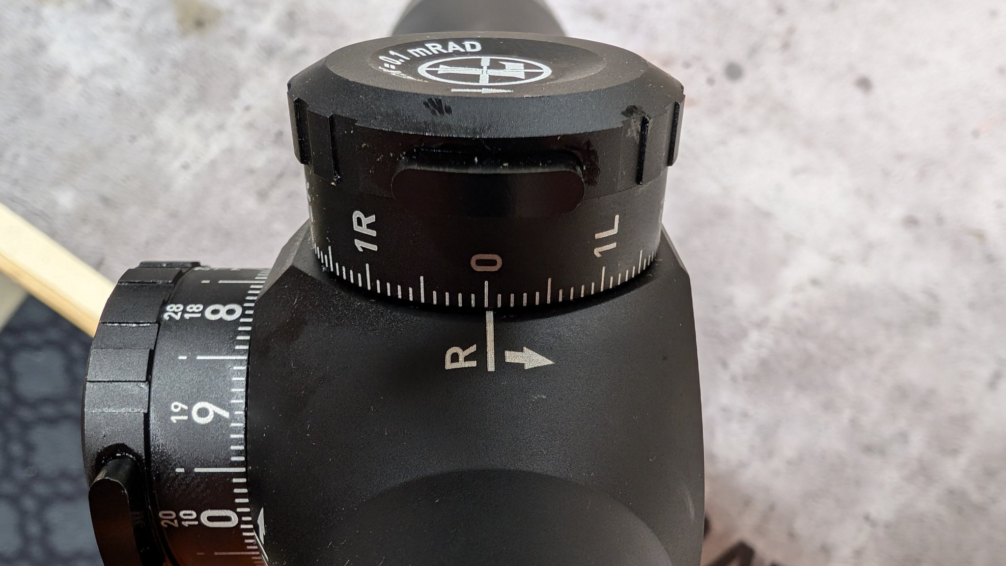

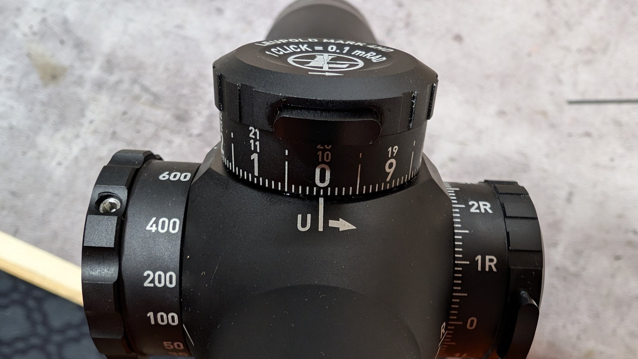

Got a 6x24 PR2. The cap and marks all line up fine at 0.0. At +3 they are off just a little bit, but the 3-mark on the cap is in the width of the mark on the scope body, but just slightly out of center. At 5.0, it lines up perfectly again.
The clicks all match with the cap/marker though. Not like CK1.0 posted where 60 is 6.2. 60 clicks on mine = 6.0 on the cap.

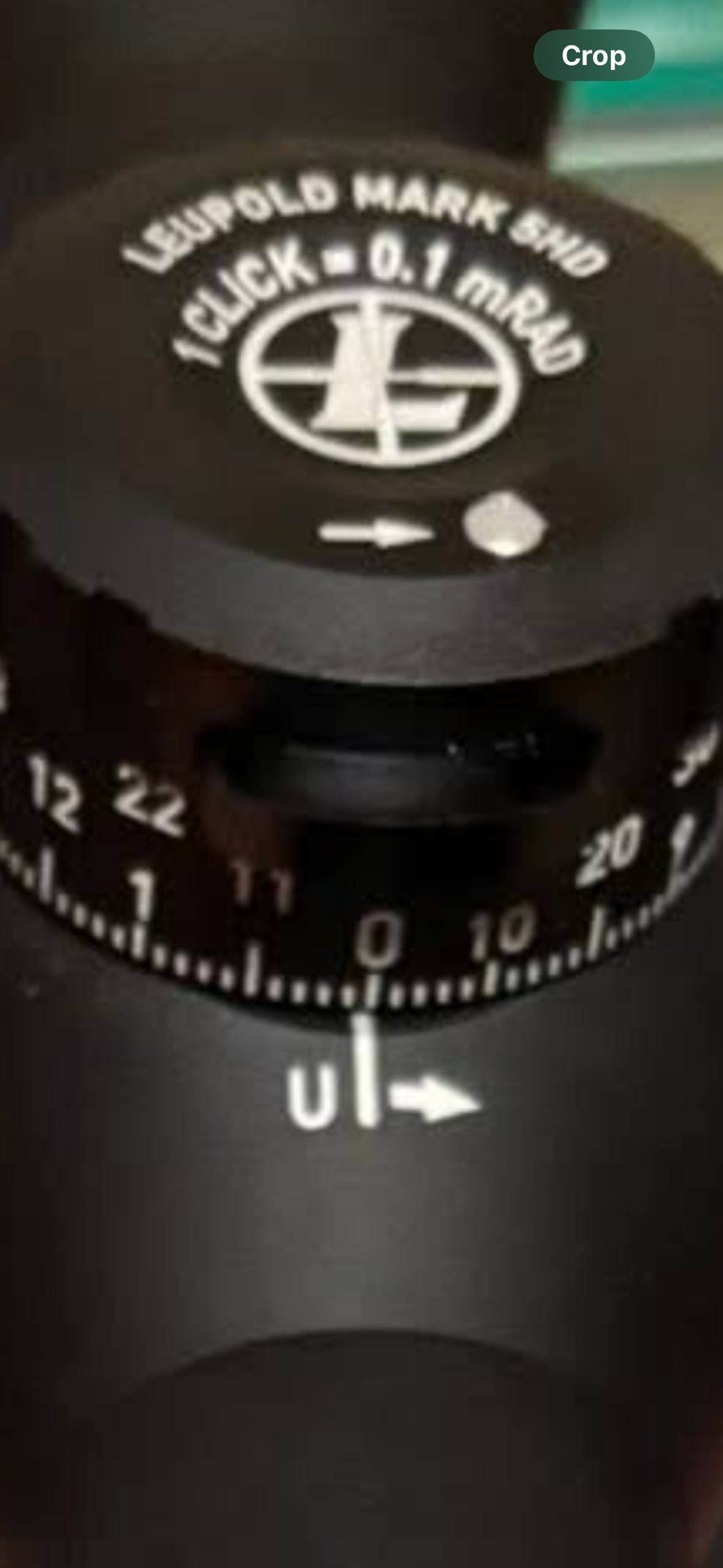

The whole issue with the zero stop not lining up is something that I noticed right off. I read of some fixes a couple of pages back and took a good look at it and made some observations.
First, i noticed that the hash mark on the body is much wider than the marks on the dial and further noticed that there is slop in the turrets. I don't know if this was by design or a fortunate accident, but the hash mark on the body is about as wide as the amount of slop in the turrets. What I did was zero the scope. I then dialed up 1 mil and reset the turret lining the 1 mil mark up with the mark on the body, such that twisting in the slop, leaves the mark on the dial lined up within the mark on the body. There is no mistaking where the dial is. Now, no matter where you dial, the mark on the knob is within the mark on the body.
If you reset the dial with the dial at zero, it will leave the marks misaligned throughout rotation.
On my particular scope, once the knob was set to track correctly, the zero stop wouldn't fully engage at zero. This is where I tried what was mentioned earlier by another poster. I removed the knob and used a file to slowly remove material from the zero stop collar until the zero stop locked into place. Don't remove too much. In my case, removing too much would have resulted in possibly being able to dial -.1 mil with the zero stop engaged.
Now, my OCD is satisfied and everything lines up. I took it out to 500 yesterday and the scope seems to track correctly and I never had to question where the dial was.
I agree that we shouldn't have to deal with these issues, but it seems that unless you're willing to spend north of 2500 on a scope, you're gonna be dealing with something. Shoot, Nightforce NX8 LPVO (I have tape around the diopter because the locking ring won't stay put), Vortex Razor (I keep managing to bend the ocular bell), Primary Arms PLXc (gotta adjust diopter to get a decent image on 8x, if you set it up on 1X), Vortex PST 2-10x (turrets seems to have a mind of there own and won't stay put).
In the end, im happy with the Mk4. Kinda wish the illumination was better. The anti cant feature is useless if you can't see the illumination. Or maybe I'm doing something wrong.

So, for those keeping score, I bought one Mark4HD 8-32x56 PR3 where the turret cap markings didn't line up precisely with the witness mark on its erector housing and which also had sloppy-feeling turrets that I didn't like, AFAIK everything else about it was ok, but those problems were annoying to me since I pretty much had to dial everything twice and count clicks before taking a shot. I ended up selling that one in the PX (at a few hundred dollars loss), and AFAIK the new owner is happy (they did get a like-new mostly great scope at a killer deal after all). That was my first one.
About a month later, I bought another one, same model, 8-32x56 PR3 MIL, only with this one, not only did the turret cap markings not line up with the witness marking on the erector housing (again), but it also didn't track correctly, falling off and out of whack somewhere ~6 MIls on its dial... I probably wouldn't have caught it if I didn't belong to a club that goes out to 1000+ yards and hadn't been shooting the same load/dope for a while. With this one, I decided to send it back to Leupold for repair or replacement and found out the hard way that all the awful stories I'd heard about their CS were true. I had to twist their arm to get them to pay for shipping it in (even though it was defective out of the box) and then I had to wait 4+ weeks for them to test and figure out the scope was defective (like I said it was, they assume the customer is always wrong apparently), and another 3+ weeks for them to finally send me out a brand-new replacement scope. Remember/consider that these are mid-price-point scopes, and if I was a guy who was just starting out in the sport and didn't have access or the funds for another scope, I wouldn't have been able to shoot and the rest of my fancy long-range rifle setup would've been collecting dust for all that time.
I finally got a brand-new-in-the-plastic replacement scope... but at this point, I'd already gone back to running a Razor G3 like I had for 1+ year before deciding to try the Mark 4HD, and decided that I was sick of pulling/mounting scopes and then burning rounds re-zeroing, so I decided to sell it in the PX (at another few hundred dollars loss) rather than take another chance on Leupold.
Well, the new owner got the brand-new scope and already found a defect when taking it out of the box and before mounting it. The reticle is canted in the tube and out of level with the scope body. He said he's going to see whether or not it bothers him and seems to be ok with it (as long as there aren't any more surprises), but that fucking sucks. I won't be surprised in the least if he ends up having to send it in to be made right or to get a replacement.
I still think the PR3 MIL reticle kicks ass and that the glass on the Mark4HDs is great for the money, but, only if Leupold can ever figure out how to get them into a scope one can actually use without having to send back once or more times, and I have zero faith in them.
So, 3 units. 3 duds. Shitty QC. Shitty CS. Caveat emptor.
