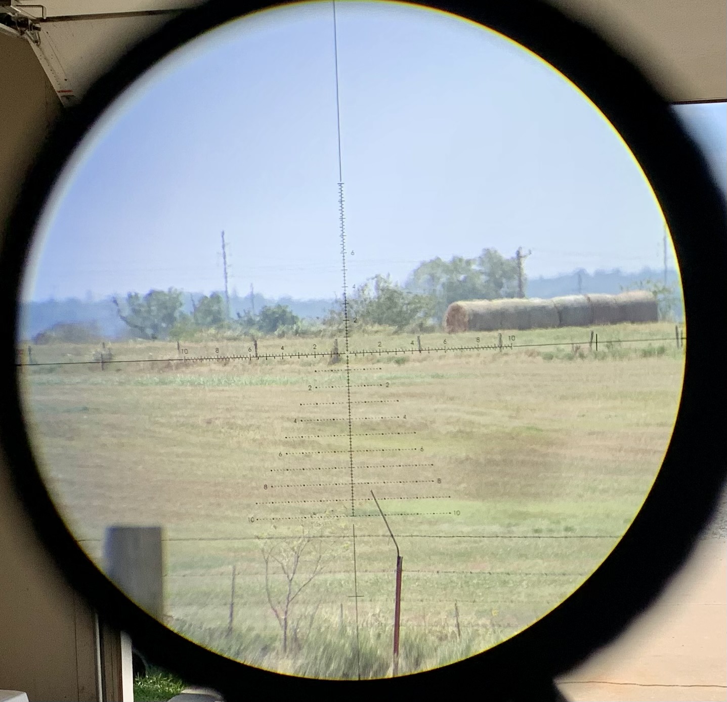

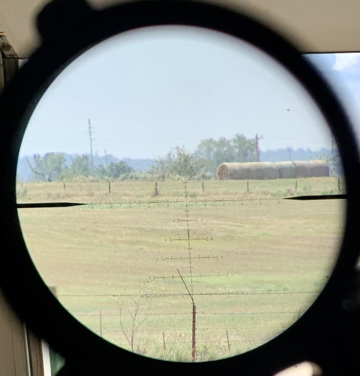

So since everyone is talking FOV here’s phone pics between a Mark4hd 4.5-18 and a Gen 3 Razor. Both scopes on 15x(the MK4 I got as close as I could since it’s 14x then 18x.
First pic is the Gen 3
Next MK4
Fence is 684yds
So either one of the scope zoom is more or less than what’s on the ring or it’s my phone that zoomed in more on one because there’s definite size difference of the hay bails. But either way with my scientific test 🤣 we’re talking 6 fence post vs 5.5 at 680
Next MK4
Fence is 684yds
View attachment 8495820View attachment 8495821
So there's less FOV on the image from the mk4. But it's also zoomed in more so that's to be expected. Is there a numbered zoom that both have in common and you could try?

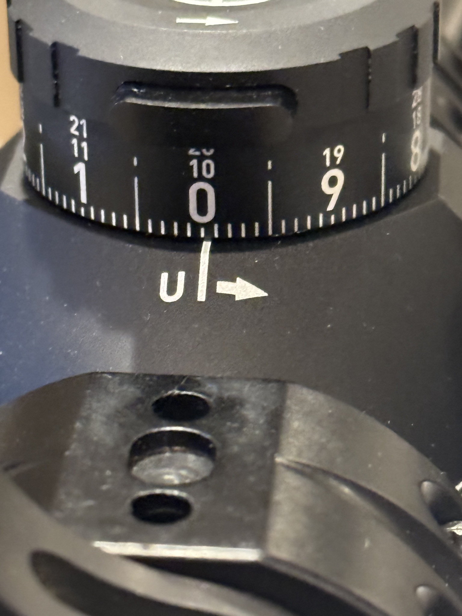

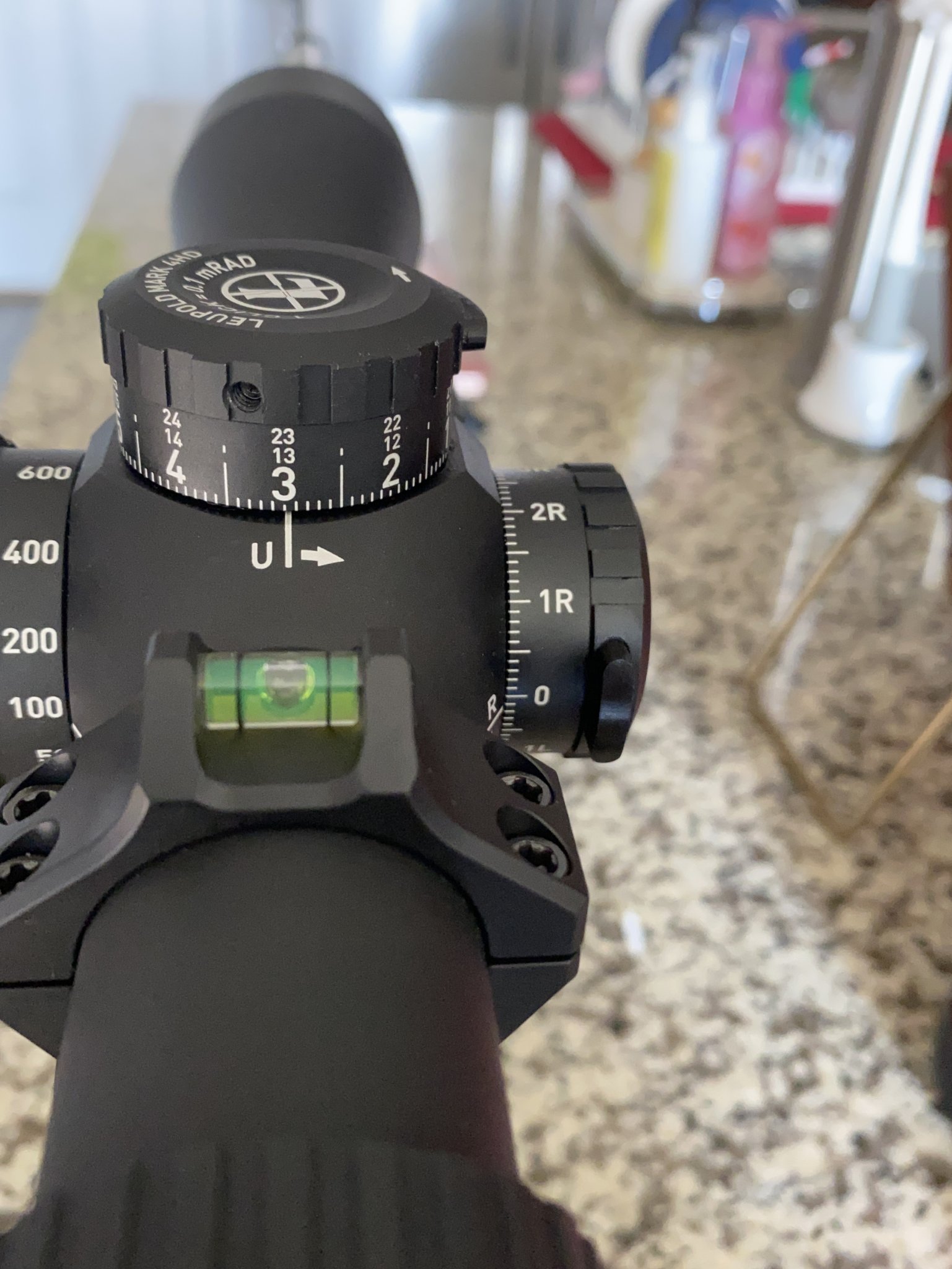

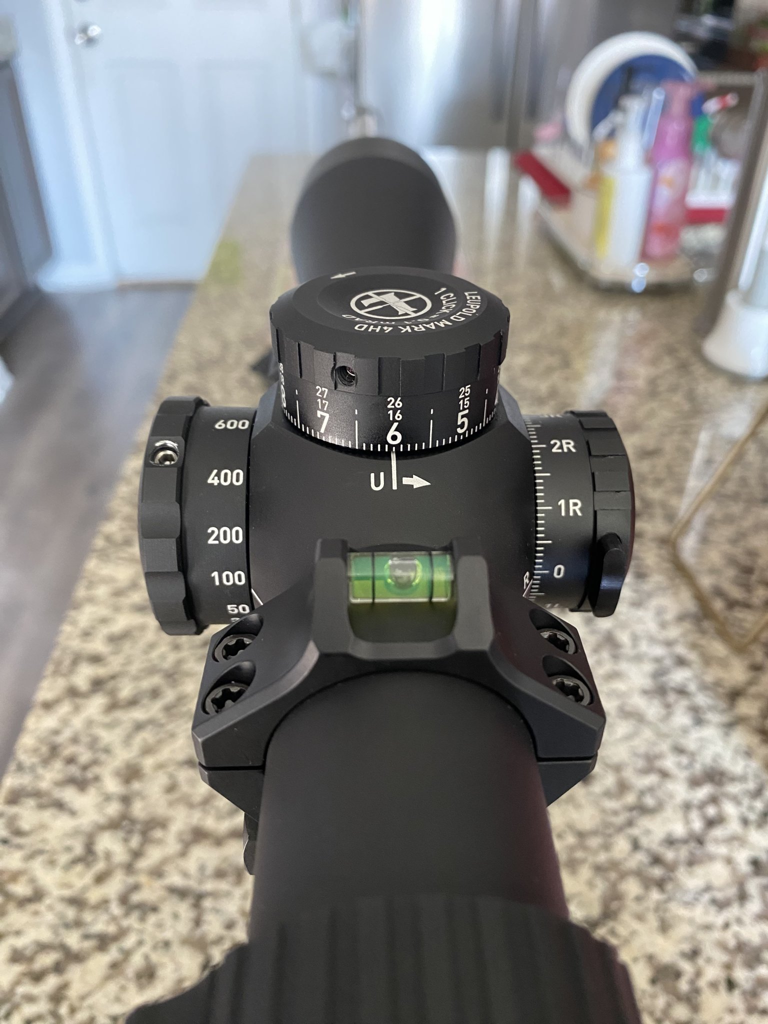

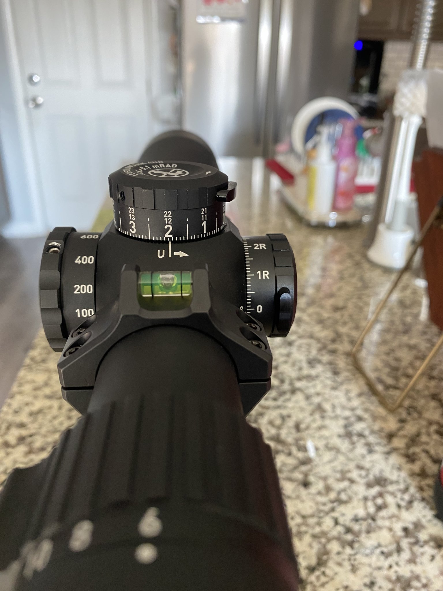

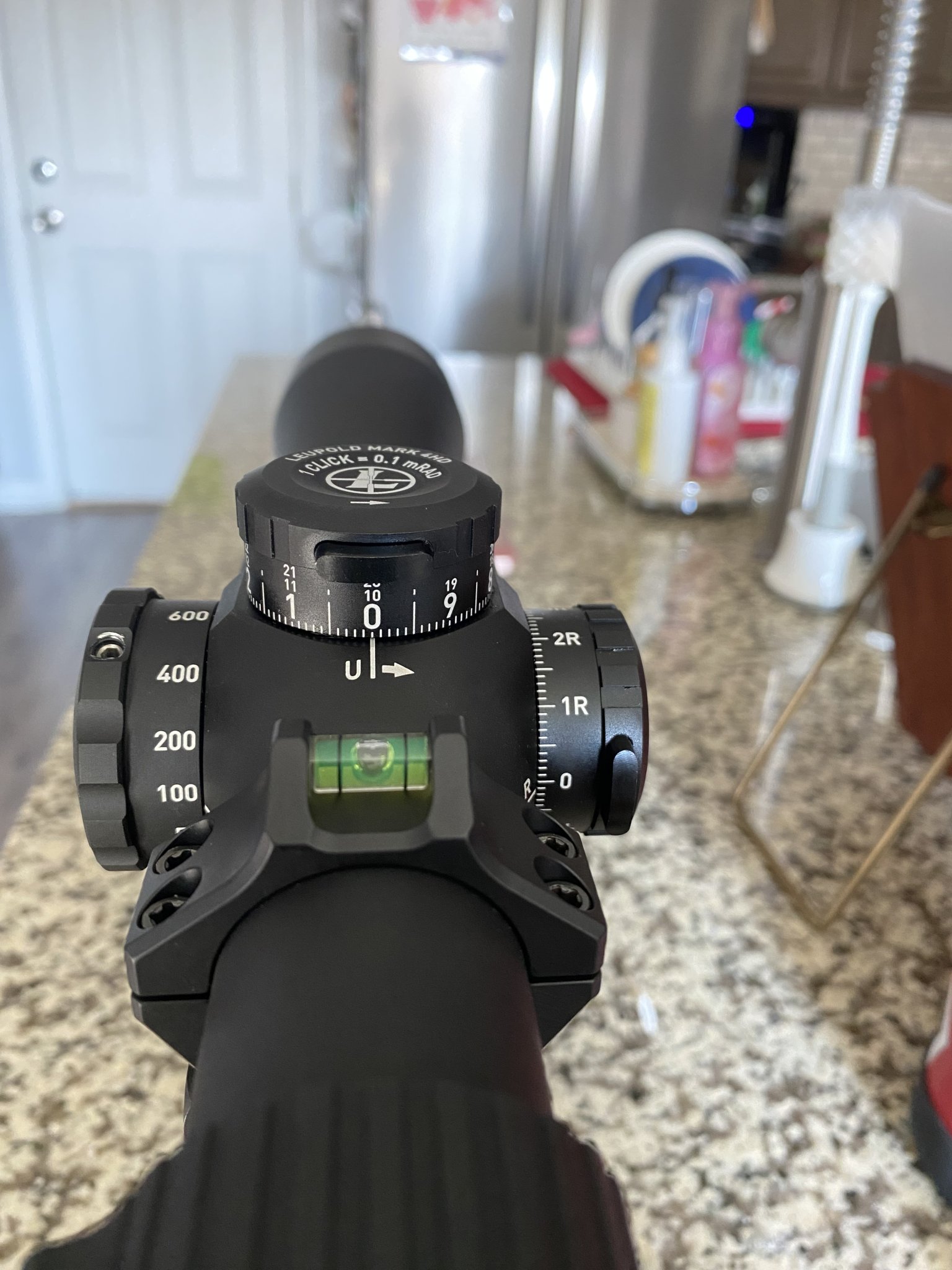

You can add this to your class action lawsuit. Just noticed it today while at the range.
My zero is centered nicely. By the time I dial from 2 to 4 mils the hash is off center. When I get to 5 mils back to zero (10 mil) the hashes are back to center again.

That sucks.
TBH IDK shit about whether they're responsible or liable in any way, I'm just talking shit. :ROFLMAO:
But it's lame as hell! They're supposed to be "precision" rifle scopes for Christ's sake lol... and not being able to dial them correctly isn't very precise, it's the exact opposite of precision, which basically means they're broken. 🤦‍♂️ 🤦‍♀️

For those with the turret hashes not lining up, I'm wondering how do they track? Is it cosmetic or is there an actual error in the adjustment? I was looking at the 4.5-18 but starting to second guess it.
I haven't done a formal tracking test (I probably need to) but I've been getting hits out to 1000-1250 yards, impacts landing where intended, without anything looking wonky. The last couple of times I've been out the conditions were pretty calm (1-5mph avg for wind) and I'd like to think if something was up I would have noticed... but yeah, I'm going to hang a target tomorrow or next time I'm out and see what I get...
No tracking issues for me so it’s purely cosmetic. In all honesty it doesn’t bother me that much since I dial slow and not in a competition setting so I know where am at. But yea, it’s kinda gay.

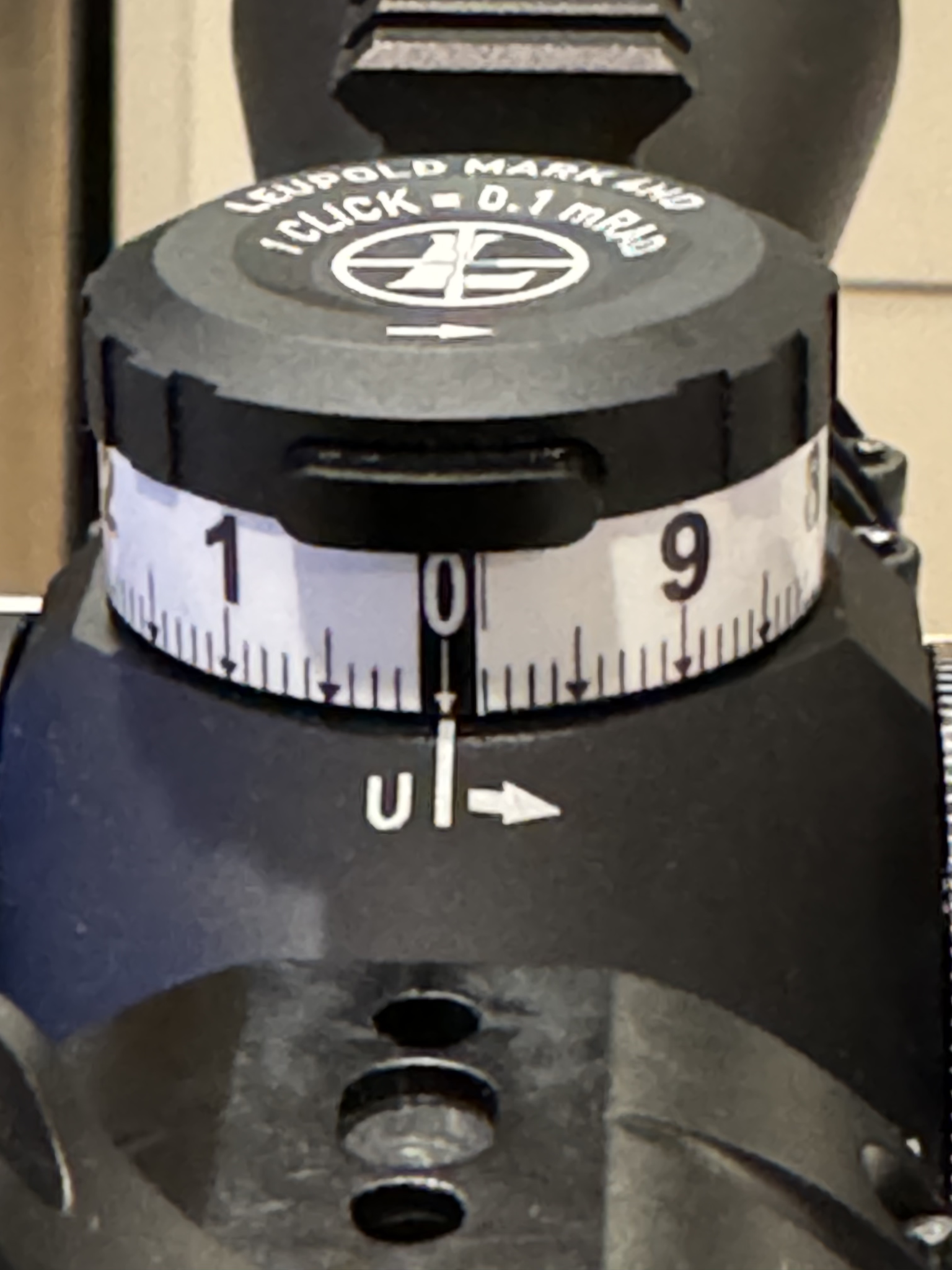

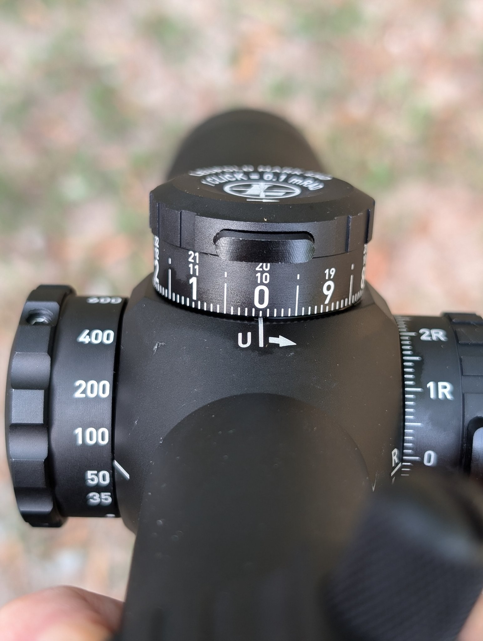

Yes, the numbers line up as I dial up.
It's not perfect, 9.9-0/10 is a little wonky because of how the turret tape came trimmed, but it's 100x better than it was as far as being able to dial and see where I'm at and not being off by a tenth. I probably could have trimmed it at 9.9 and it might have come out a little better (IDTS sends 3 turret tapes, so maybe I'll go full-on OCD on the next one lol).
Hilariously (or sadly, depending on how one looks at it), according to Leupold "Every CDS model scope is eligible for one free custom dial."... so for my custom dial, I might see if I can just order one that actually lines up correctly, in my case pushing 0.0 over a little bit to ~ 9.965ish mils..? :ROFLMAO:
It's not perfect, 9.8-9.9 is a little wonky because of how the turret tape came trimmed, but it's 100x better than it was as far as being able to dial and see where I'm at. I probably could have trimmed it at 9.8 and it might have come out a little better (IDTS sends 3 turret tapes, so maybe I'll go full-on OCD on the next one lol).

So... shot the thing today in a casual local match out to 1250 yards and noticed that due to its turret play/slop, mine does indeed start to get out of whack by a tenth or so somewhere between 5.0mils and 8.1mils (my current DOPE for 750 and 1000 yards, respectively). Trying to figure out if I was on 8.0 or 8.1mils was super frustrating (even with the aftermarket turret tape). (n)
It's annoying enough that it probably warrants sending it in... but IDK if it's even worth the trouble since I fear the dreaded "it's within our tolerances" response and getting it back without it having been repaired, in the same condition as it left...
