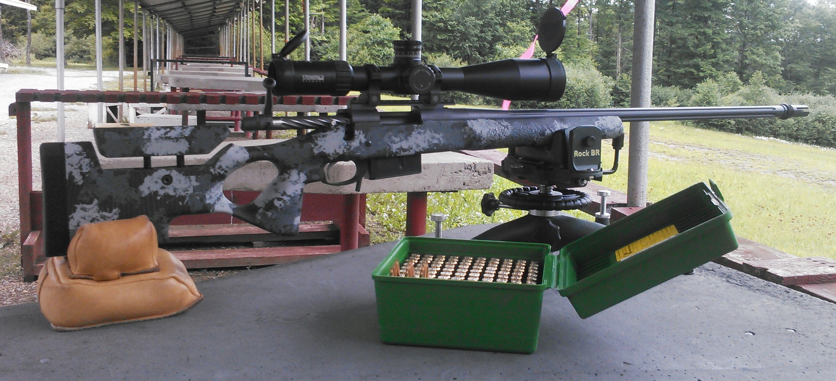

My light weight TAC hunter.
pierce Ti SA with lightening option.
hart 28" barrel fluted with AAC flash hider.
Jewell trigger
manners T5a with mini-chassis, 100% carbon option
nightforce ultra light 34 mm rings
Steiner 5-25x56 MSR
weighs in at 11.97 lbs total.
