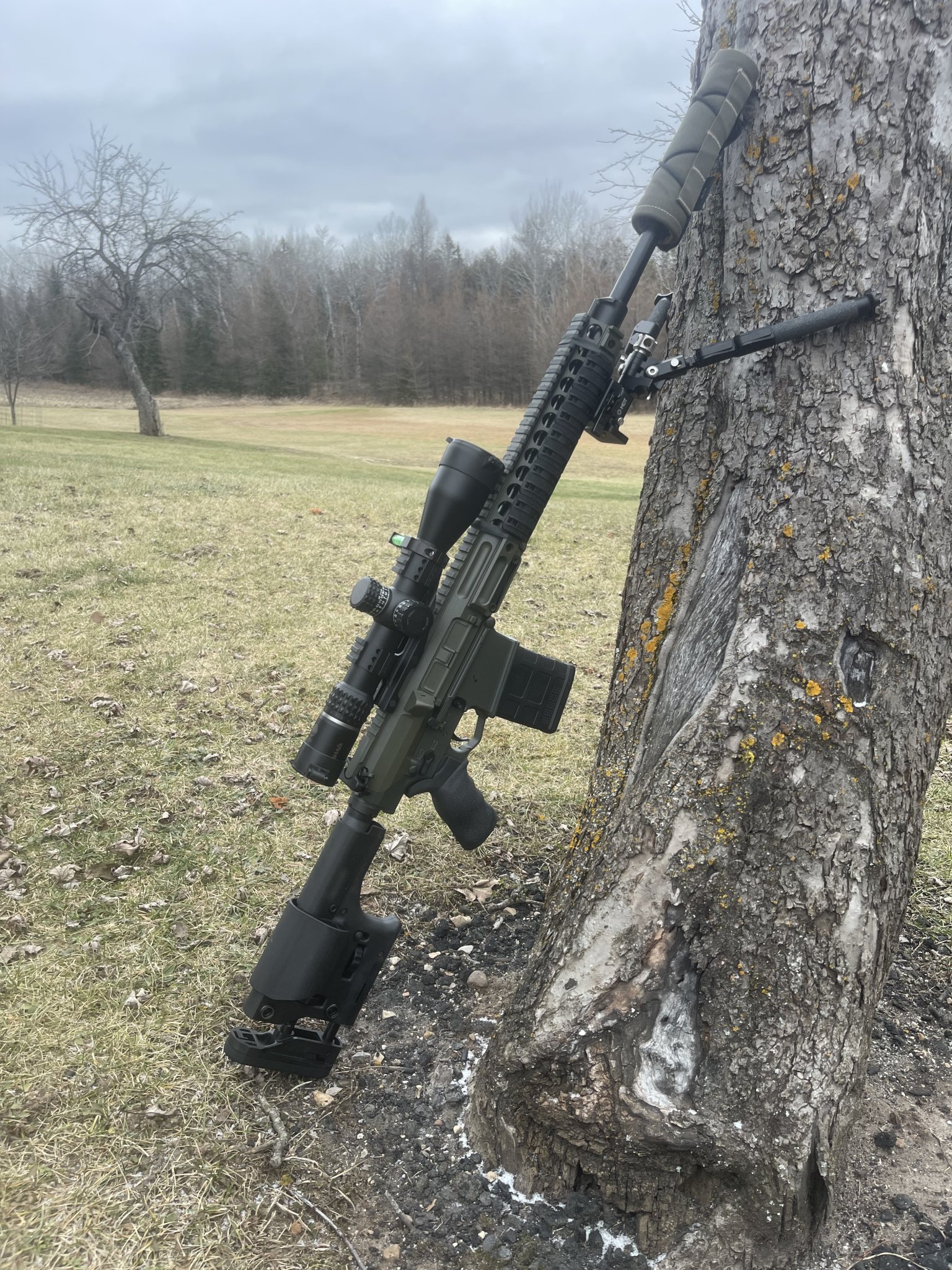

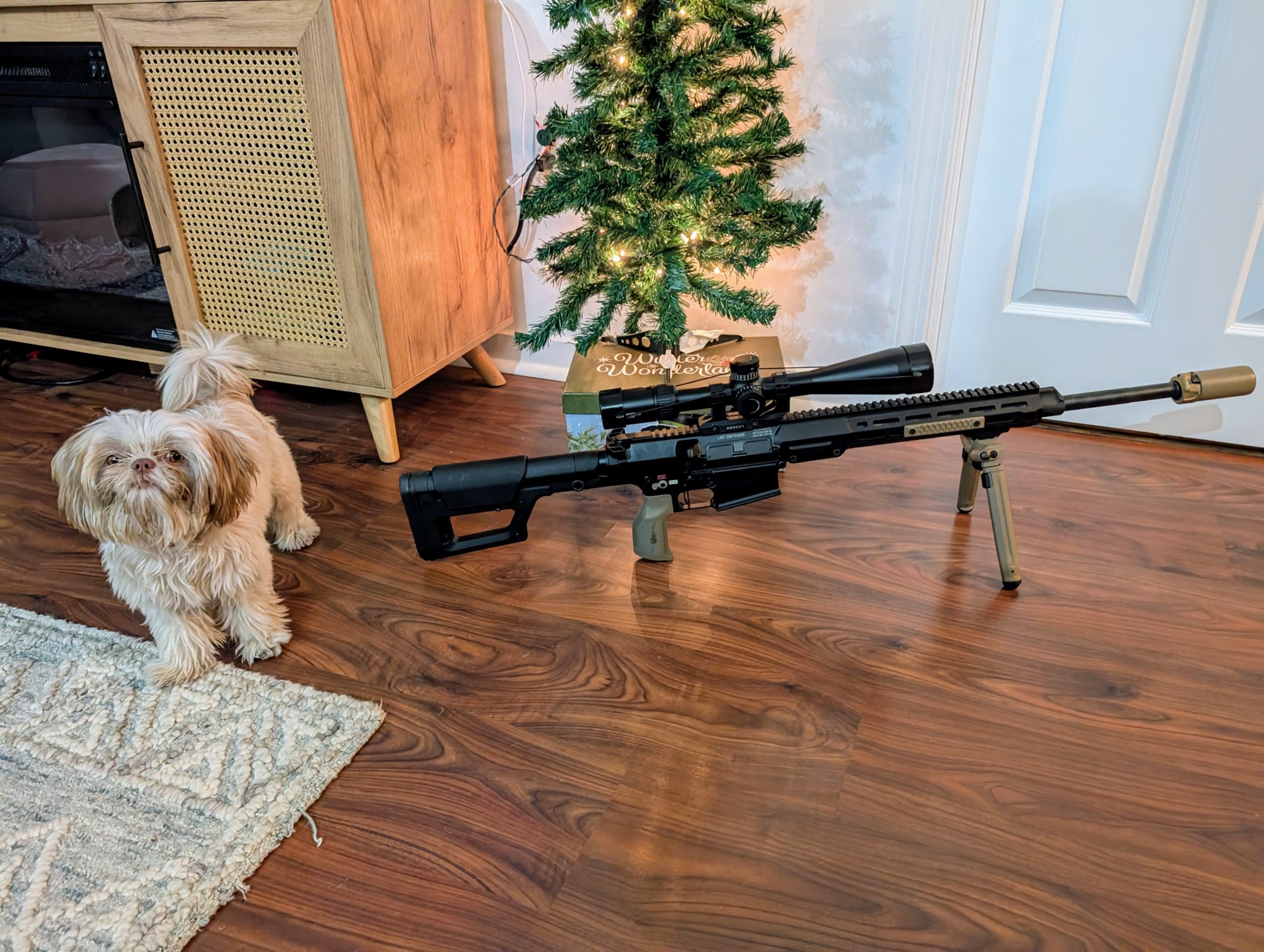

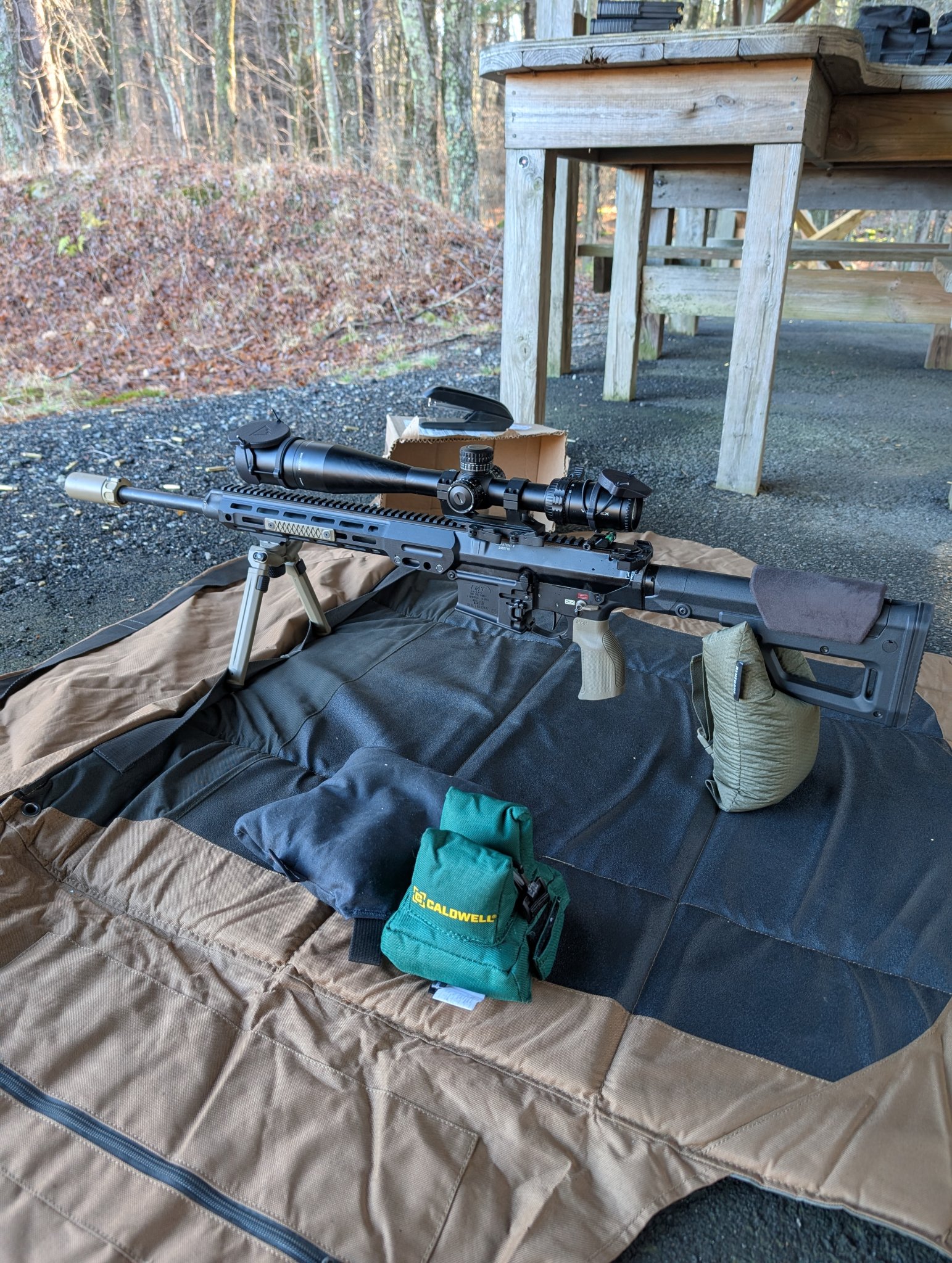

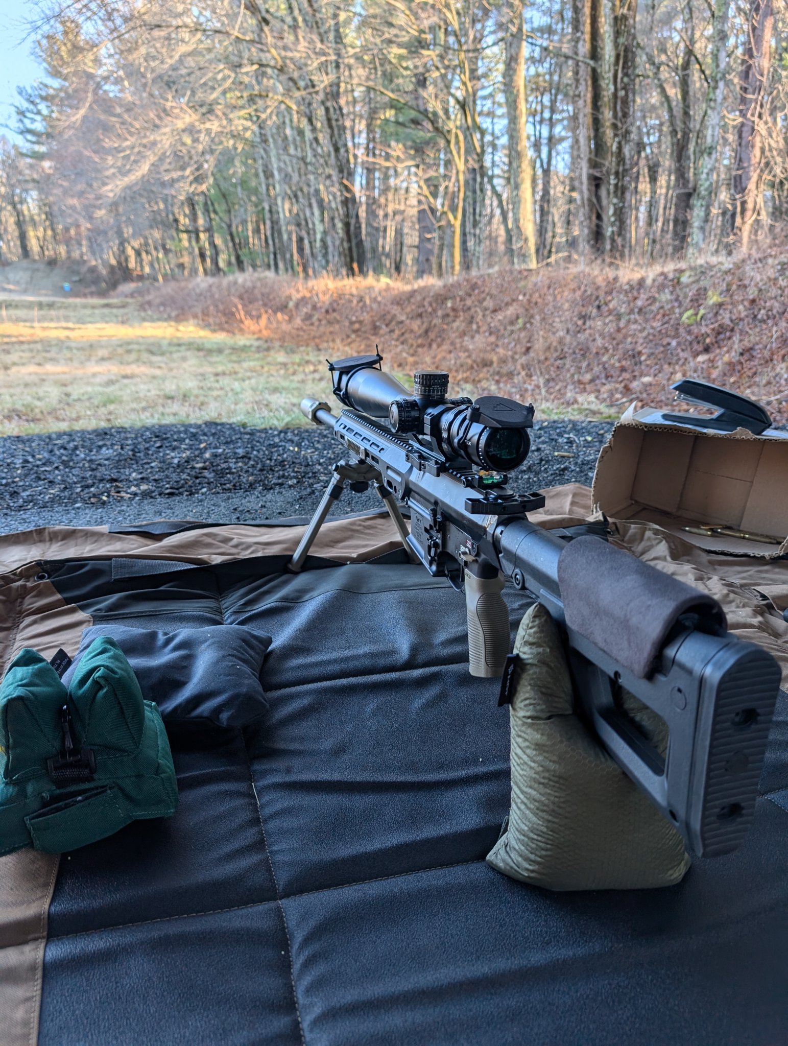

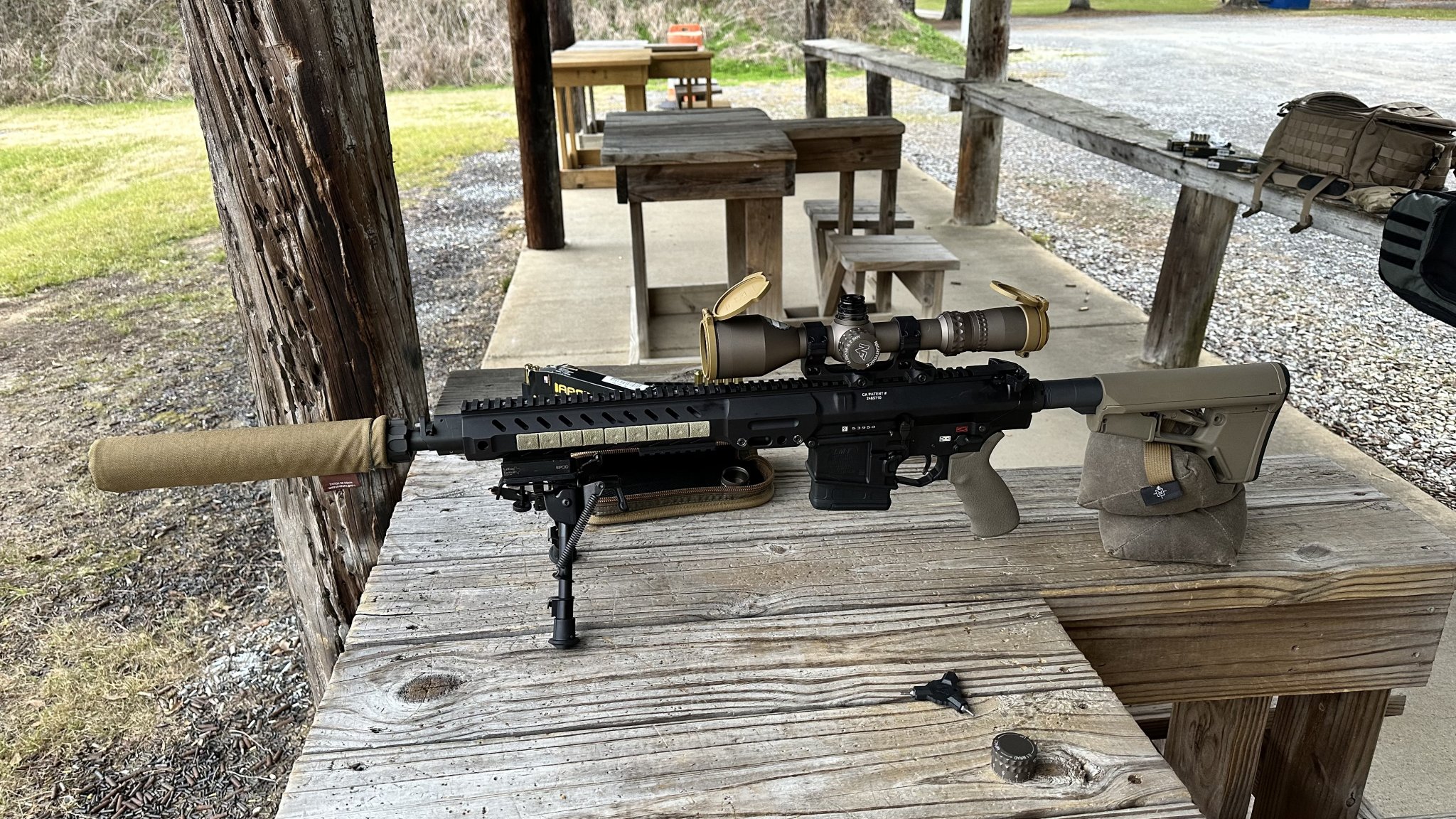

This is my LMT MARS-H. (and the boss)
20" 308 SS barrel
Vortex Viper PST gen II 5-25
JP captured buffer
Larue 2 stage MBT (now changed to SSAE-X)
Magpul PRS lite
surefire comp / blast diverter
Magpul Bipod (soon to be updated to MDT GRND-POD)
Driven arms co Grip (updated to their collab)

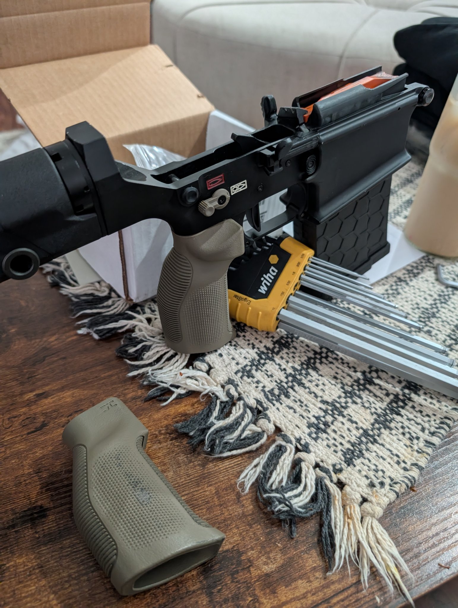

Changed to DAC grip with new right side thumb rest. I ended up having to remove the ambi safety because it was interfering with the thumb rest.

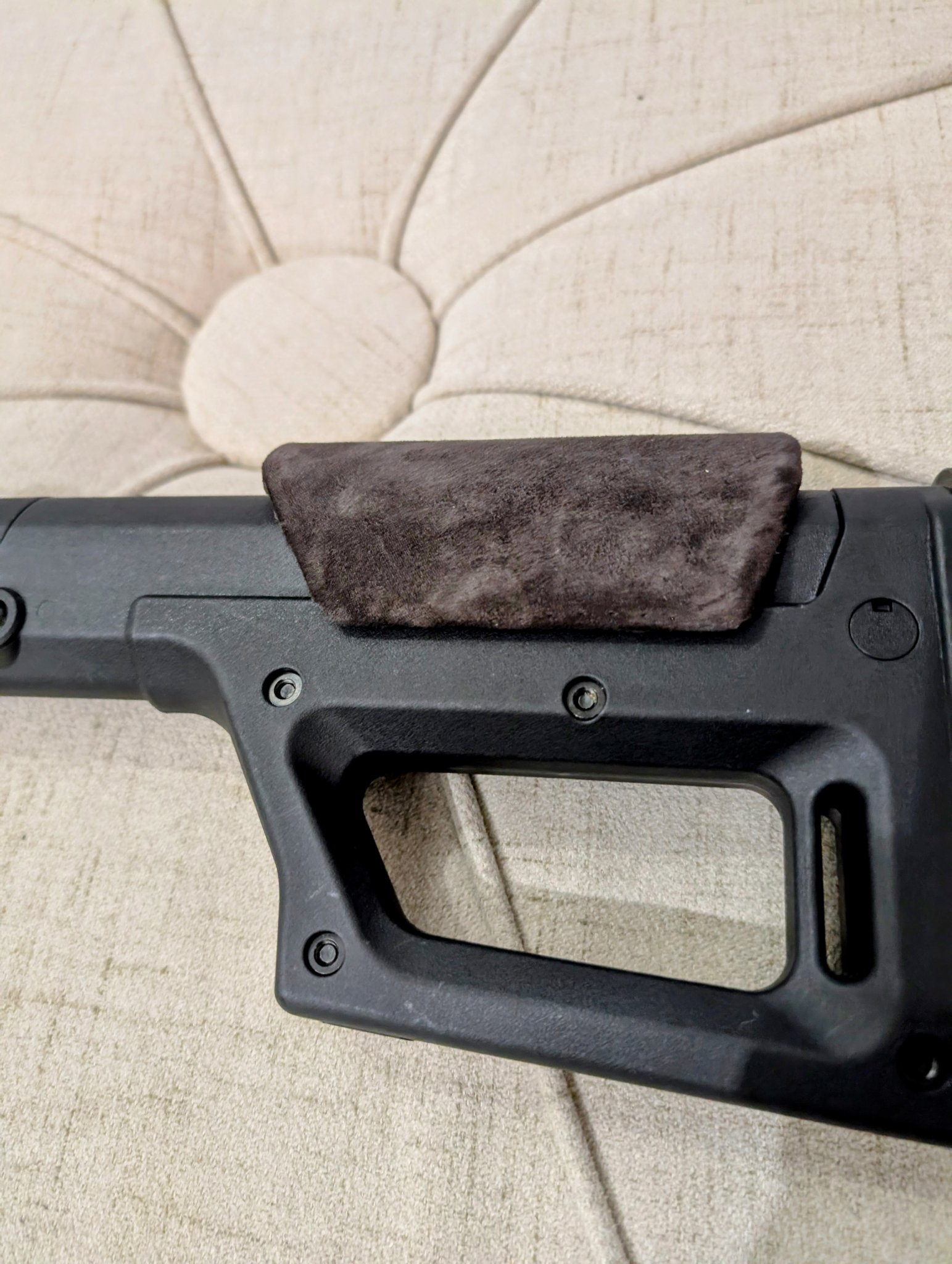

Added alcantera to cheek pad - I had some left over after a car project.

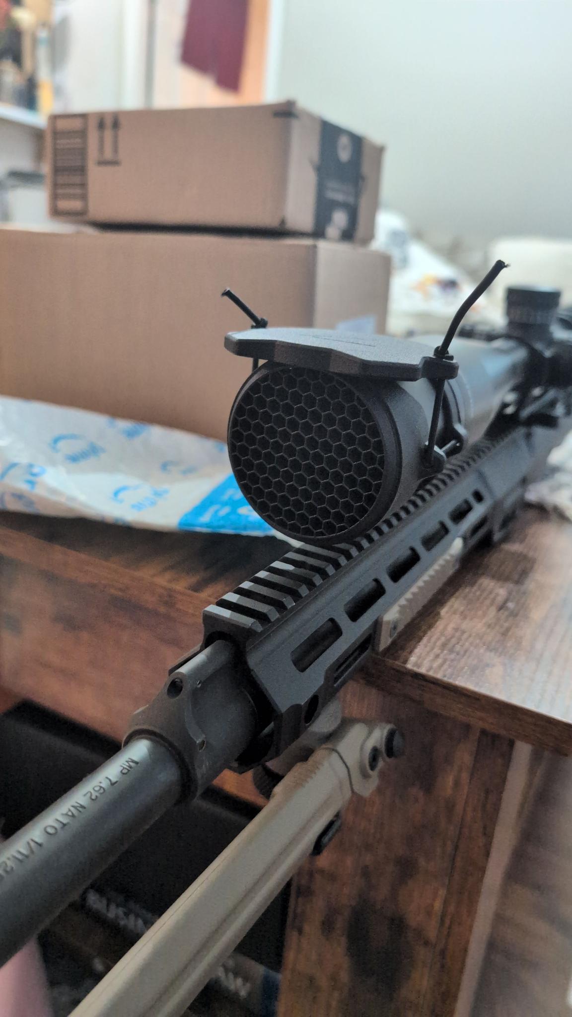

100concepts ARD and scope caps (yes I trimmed the paracord)

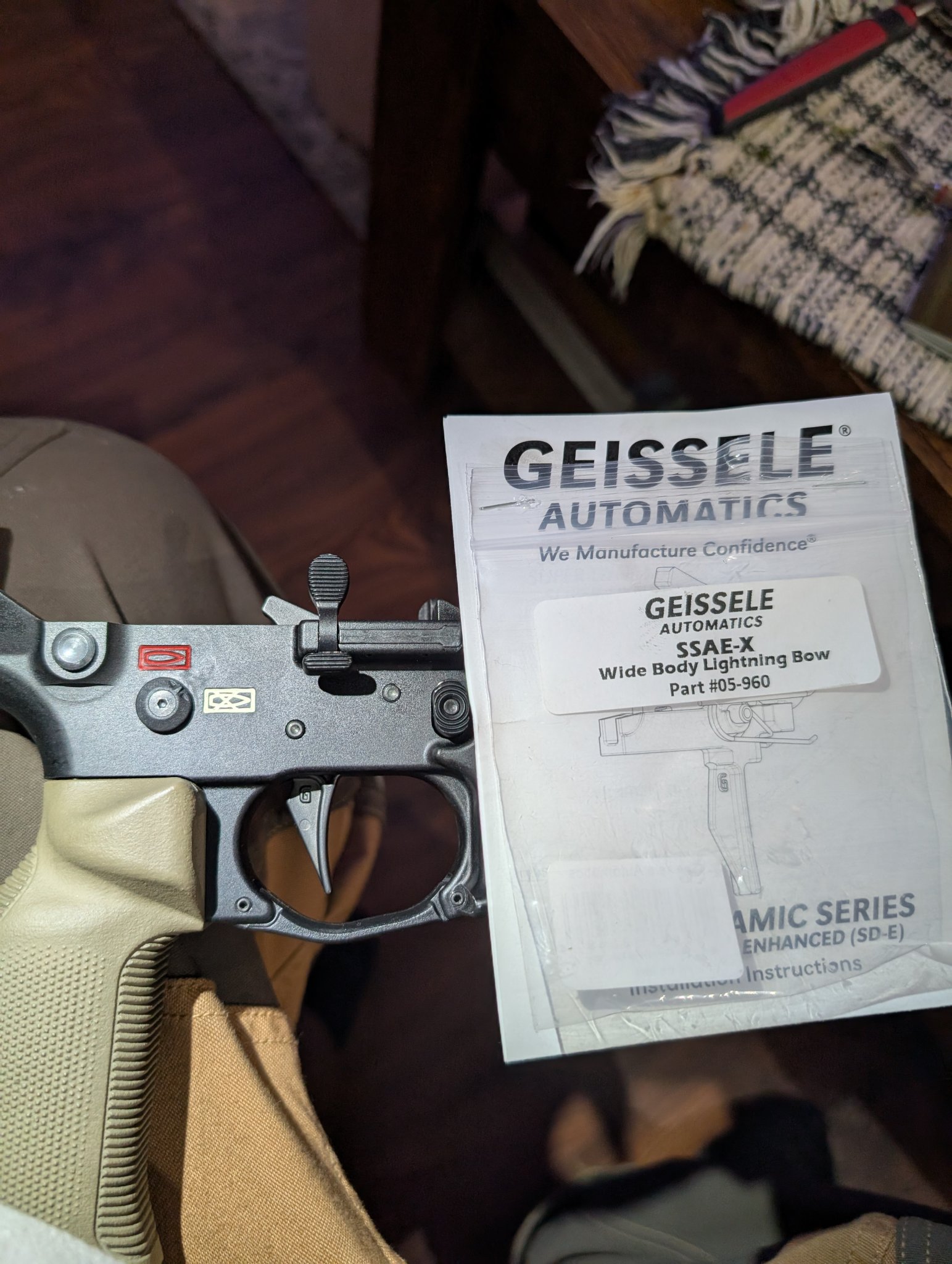

Recently I changed the trigger to a SSAE-X - but I've only shot it a few times since then and I'm not sure I'll keep it. The Larue MBT was pretty good as well. I might switch my American Gold into my MARS-H and put this in my run and gun. We will see.
This is my first big body AR build for myself and I'm just slowly dialing it in. I really enjoy shooting it.
I'm waiting on a 6.5 barrel to get delivered but I have plenty of 308 to shoot through before I start buying 6.5 CM.
So far I'm getting moa+ accuracy but that is def my fault. I'm only starting my PRS learning.
I'm here to learn from you all.
- faylix
Nice rig. I’ve also got the G SSAEX in my LMT 308 and love it. It beaks super clean right at 2.9lbs.

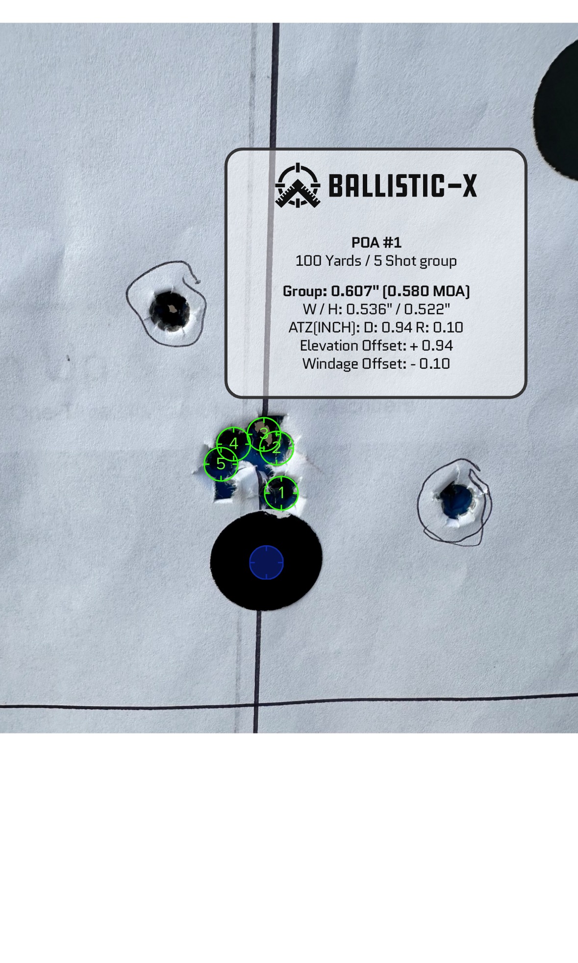

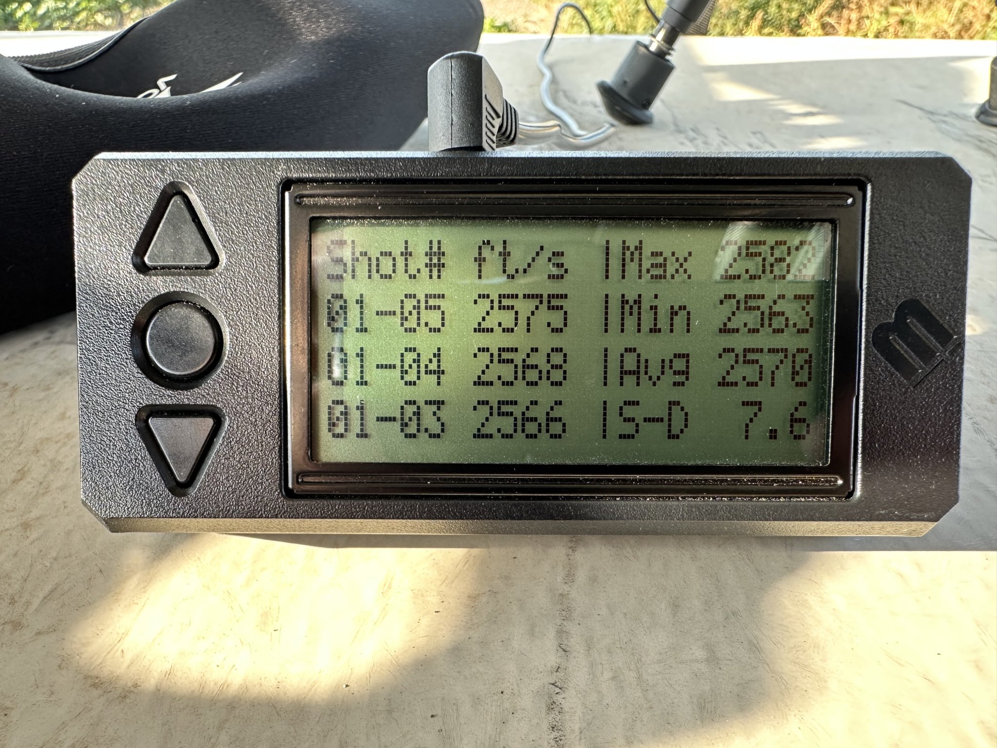

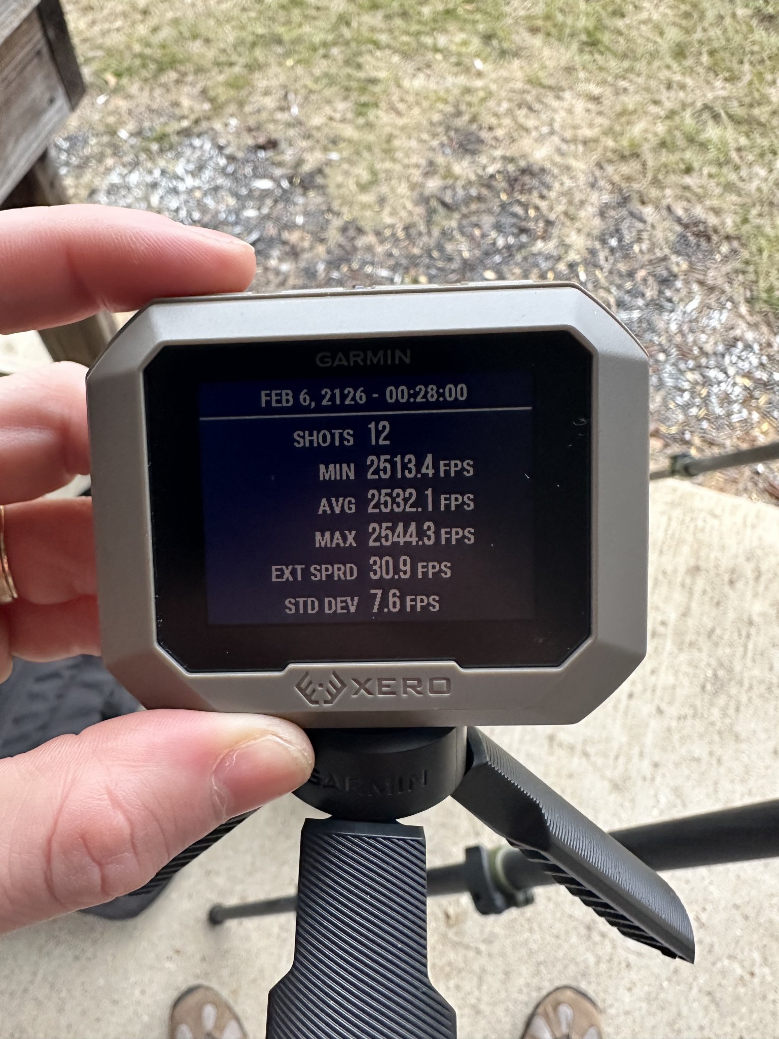

Solid group man, but also really surprised/impressed that the SD & ES were that good.
This isn’t the first time honestly. The first 5 shots i had with the same ammo from AAC was similar. Granted i think it’s hot. I had a blown primer this outing and it’s just a ton of speed for a 17ish gasser. I’ve shot about 85rds of the first 100 i bought. Bringing another 100 home to hunt with it.
This was the first grouping with it.

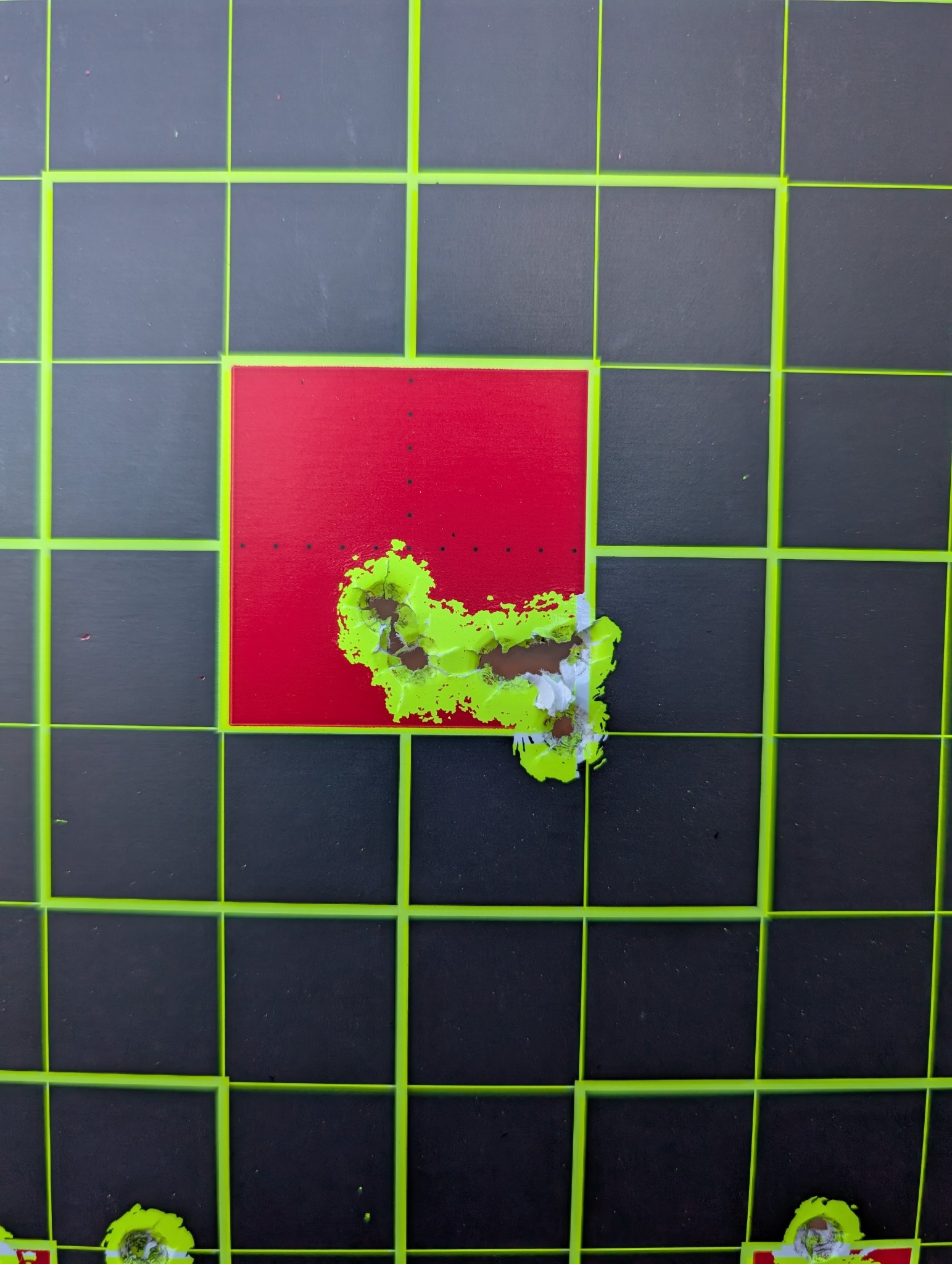

Thanks boss. I had her out this morning and finally got a good chance to work with this new trigger. I still have to break her in a little bit but at least for now it feels like the break on the 2nd stage could be a little cleaner - but I'm splitting hairs. It feels excellent and I was able to put some good (okay) groups together.

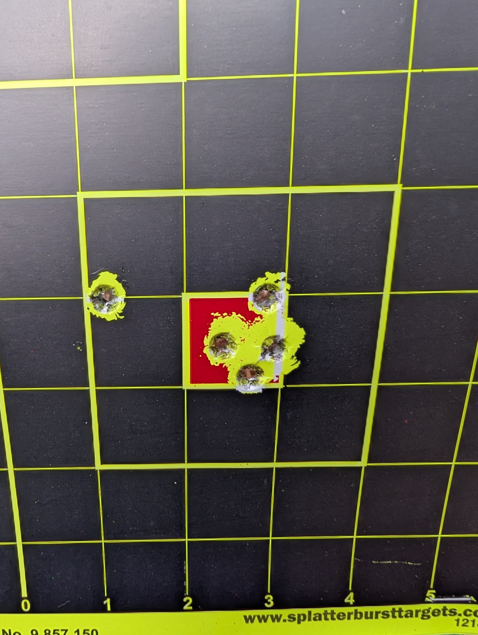

1"X1" @100 yards - still suffering flyers. Def my breathing.
2x2 @100 - warmup on the big square
Getting better every week.
Oh yeah she’ll shoot. You tried using a real good grease on all the contact/friction points yet on the G trigger?
Also, I’ve had several SSAEXs and some are just noticeably better than others. My best one I made sure to put in this LMT 308 and not my 556s LOL.

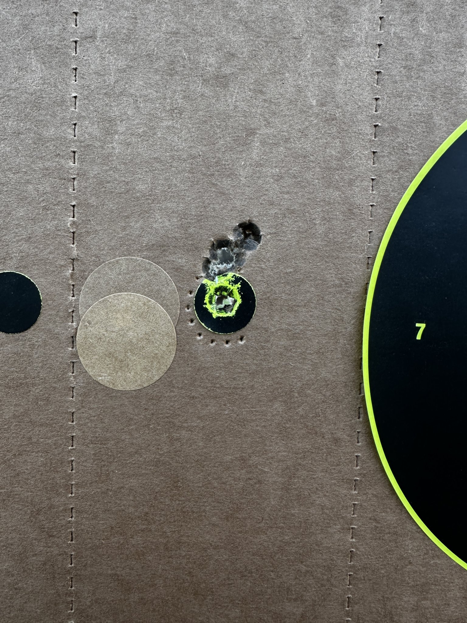

Damn that’s impressive man. I’ve normally only seen those kinds of numbers with FGMM/Federal LE and Berger ammo. I’m glad to know there’s another really good option out there, as I would’ve never even guessed that ammo would be that good.

With G triggers I generally put a small amount when I install them, run about 500 rounds through them, take em out and clean em up real good then grease the hell out of them.
I've built a ton of guns with the G super dynamic combat 2 stage, and that's how I got the best performance out of them. Started doing it for all my G triggers.
It might be all in my head but swear they break in better like that.

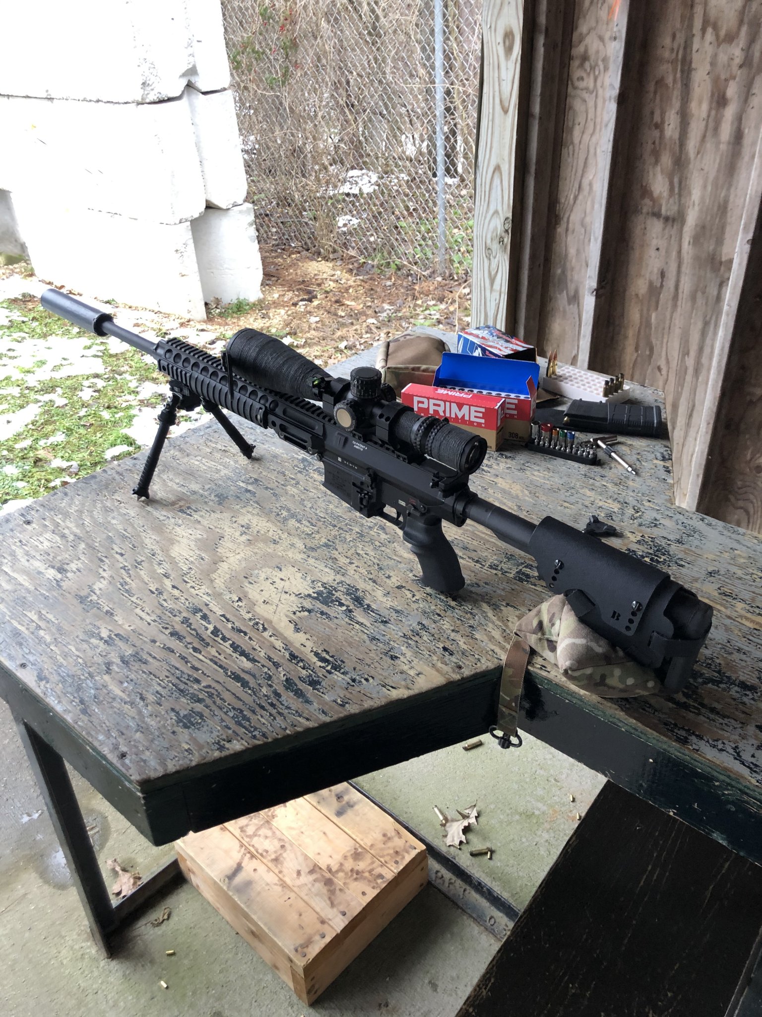

I'd like to settle on one bullet for my 308's. I've got a custom 700 that I built and my MWS. Leaning towards the 169 sierra but I'd also like something that reliably expands to hunt with.
Dang, leave some tail for the rest of us! Nice build. :)
Thank you
She’s going to be a deer killer. So I’ll probably give hornady precision hunter in 178 ELDX a try in it.
I know 175 fgmm will shoot well. At least according to previous owner of the 18” SS barrel. But want something more hunting oriented for a bullet
