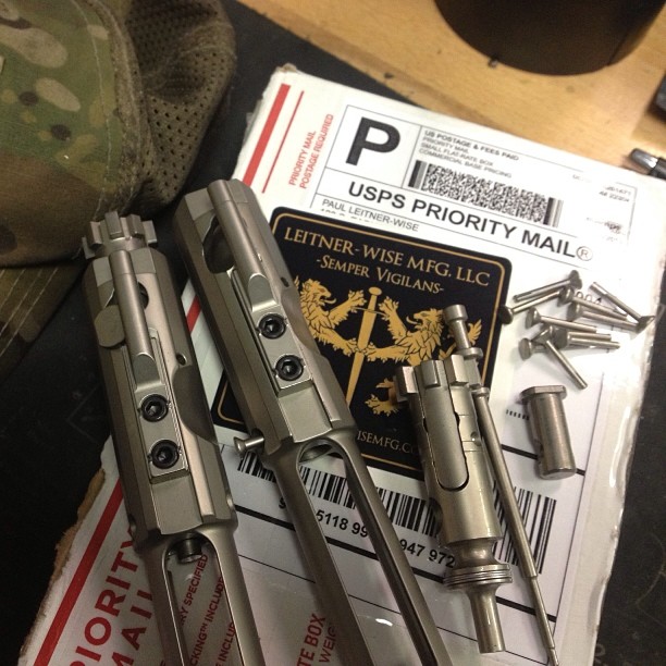

You should be able to use a JP bolt and reuse the MWS carrier. All Armalite / DPMS guns use the same extension . I have not run another carrier in mws since they are both gen two and have the little extra material on the bottom of the carrier tail to interface with the lower (so they don't tilt). What caliber are you switching to? Last time I spoke with Gene at LMT, he said that would ask the boss about spare parts like extractors and bolts becoming available for sale. Gen 1 BCG's are the same as current KAC units and 100% compatible and any other complete assembly will work too from JP, Armalite , Fulton or DPMS .
Are any other BCGs compatible with the MWS? I know a DPMS pattern BCG will fully close in an MWS, but I am reluctant to pull the trigger on a live round.
For sure, you can use the jp 308 bolt or bcg. The kac for sure as well. Not sure about lwrc. Paul was ousted or "left" years ago and I haven't attempted to check fit of my repr bolt in my MWS rifles. I wasn't aware LWRC still made DI bcg's?
I know you can buy their bolts but since the repr is op rod not DI, obviously the carrier isn't compatible. I do like the repr carrier though.
I'm not talking about LWRC but his new venture.
Www.Leitner-wisemfg.com
