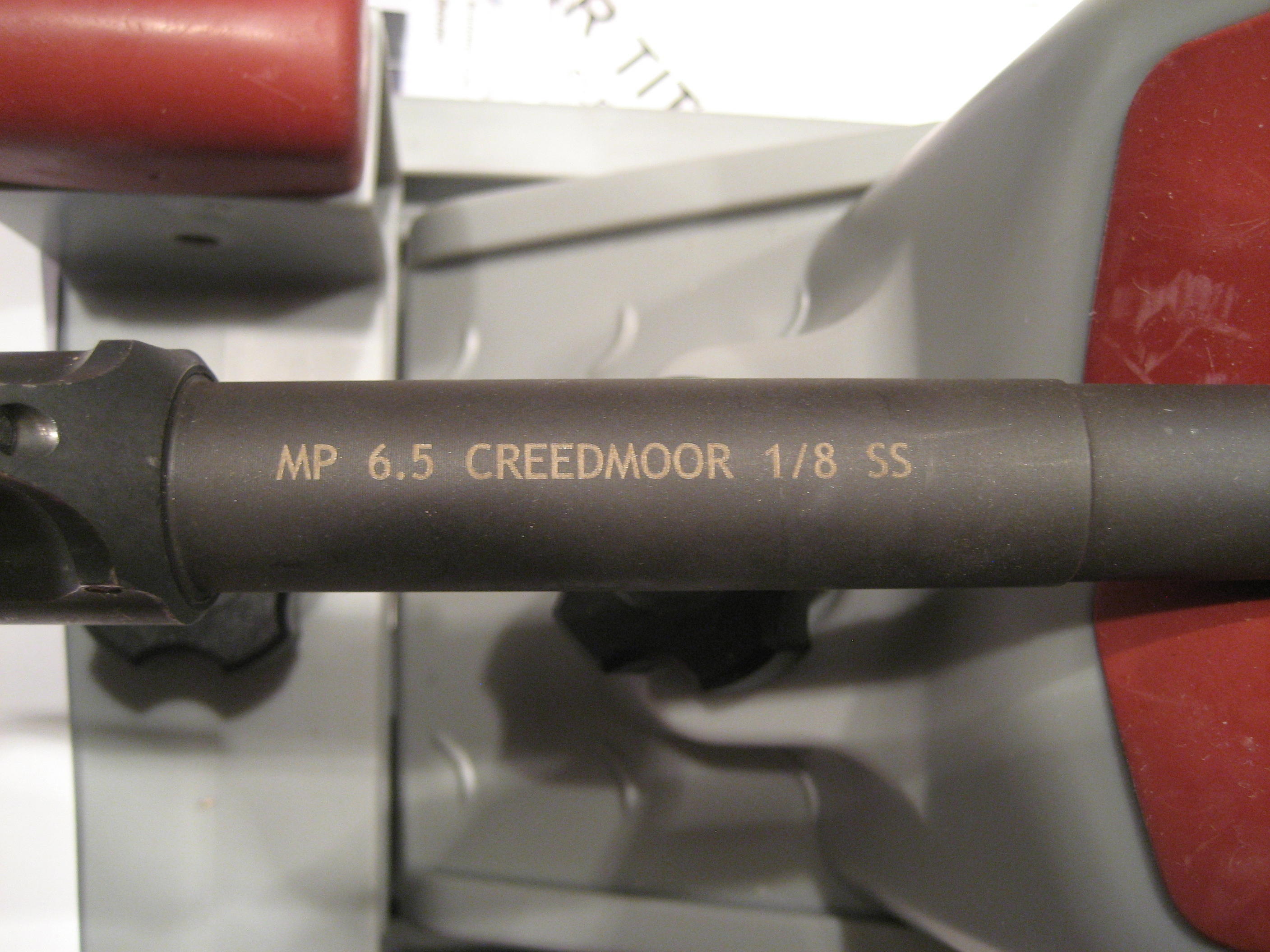

I was pleasantly surprised what showed up in the mail today. I ordered a 6.5 CM barrel a couple weeks ago from LMT and confirmed it would be a 1:9 twist. I settled on running 120's and 123's (and still might to get velocities I want).
I opened the box today and low and behold 1:8.
I thought I would share as this seemed like great news for those on the fence wanting to run heavy pills without the twist to do so. I am not sure if the .260 barrels are still 1:9 twist.
Reactions: Mdp777

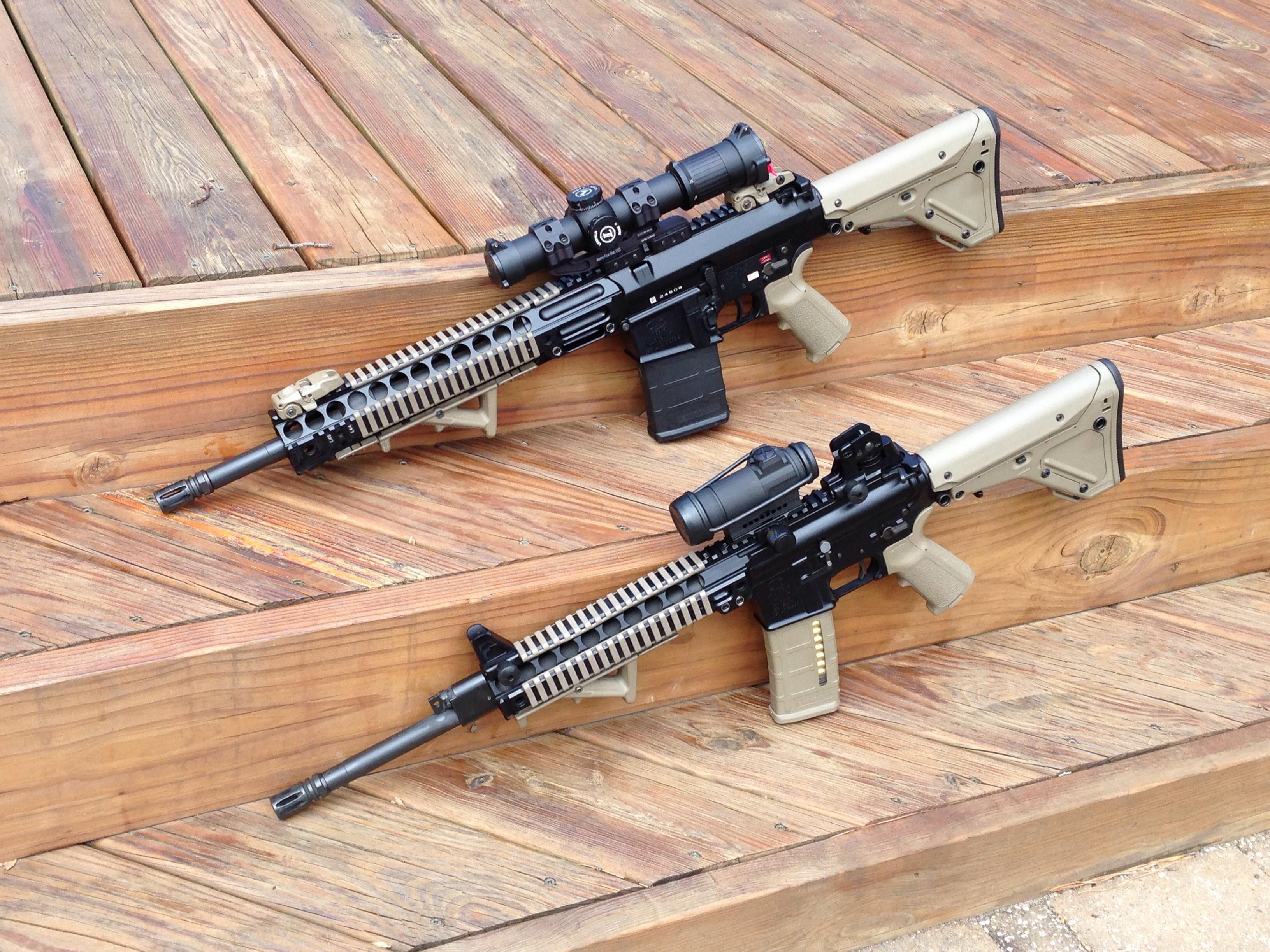

Here's mine in its current state. I've had it for about two years, during which time I have run it (with 16" chrome and an EOTech) in a 3-gun, brought it to a few long range classes, and shot some--for me--very good groups. It seems to do well with my 175 SMK reloads. Trigger, stock and buffer weight round out the upgrades. While I wish it were lighter, it does a whole lot quite well...
Reactions: Mdp777

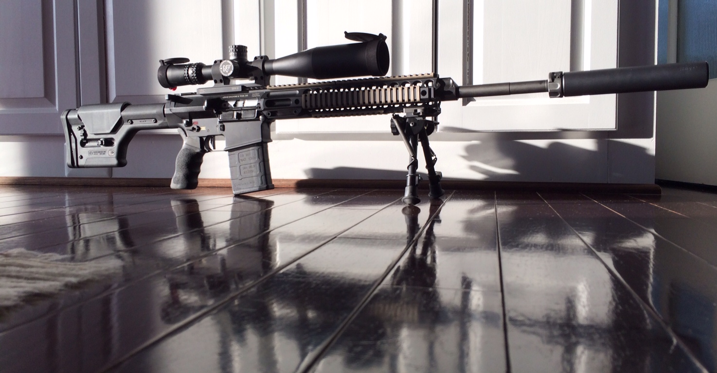

Finally got one of these. They were never available for reasonable prices when I could swing it until now. Picked it up from another member.
These look terrible after all of the pictures I've seen of Trident's over the past few years but had to quickly snap a few.
[/URL][/IMG]
[/URL][/IMG]
redirt78.... it warms the cockles of my heart to see you pick up a MWS :)
You're a real deal shooter, and the MWS is real deal rifle......winning combination.
Big congrats brother, and enjoy your new rifle!
