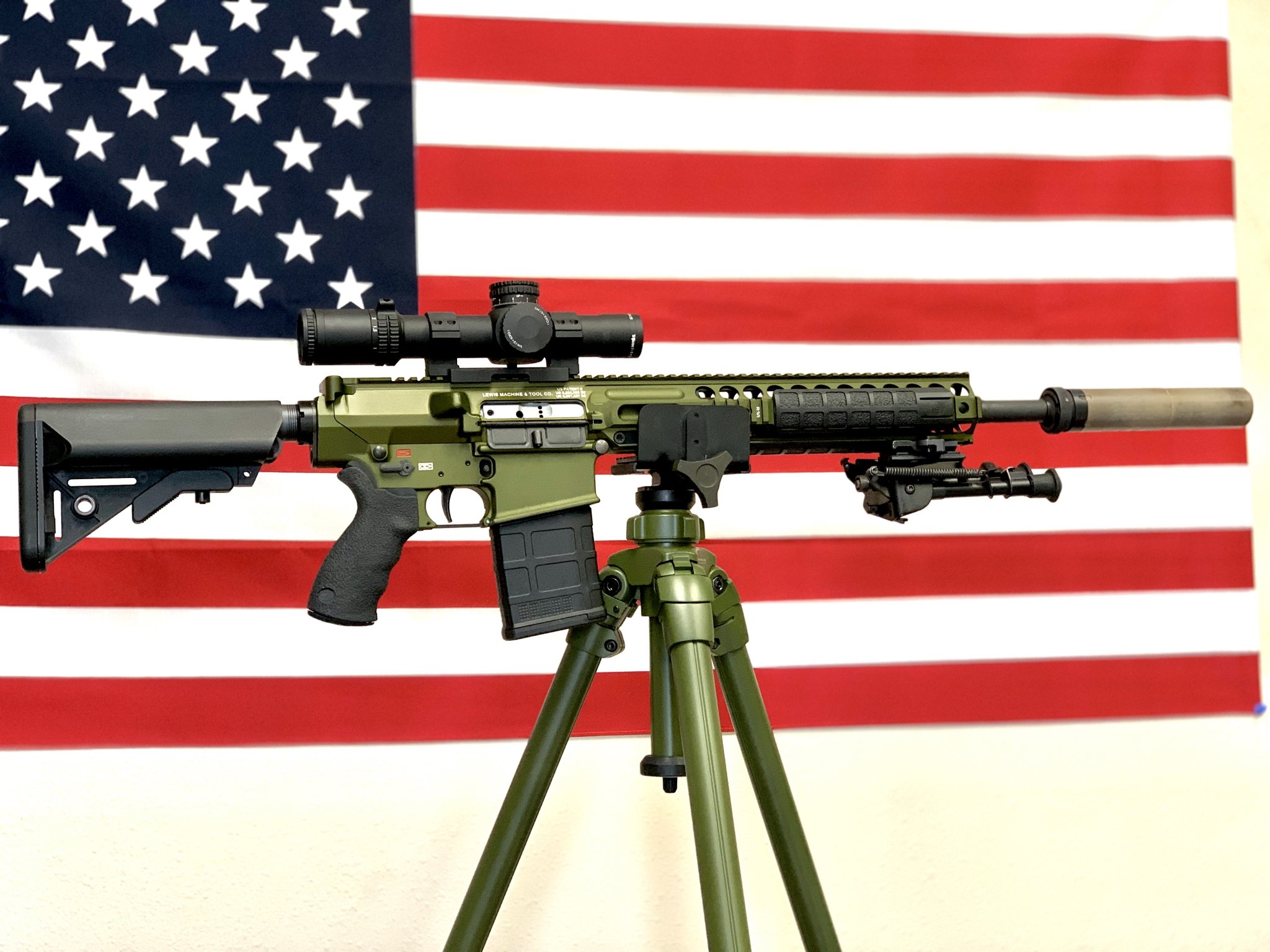

I guess I missed the news. Where did you get these apple green beauties??
I love my generation 1. Use a omega can on it with a 2.5-10x24 NF.

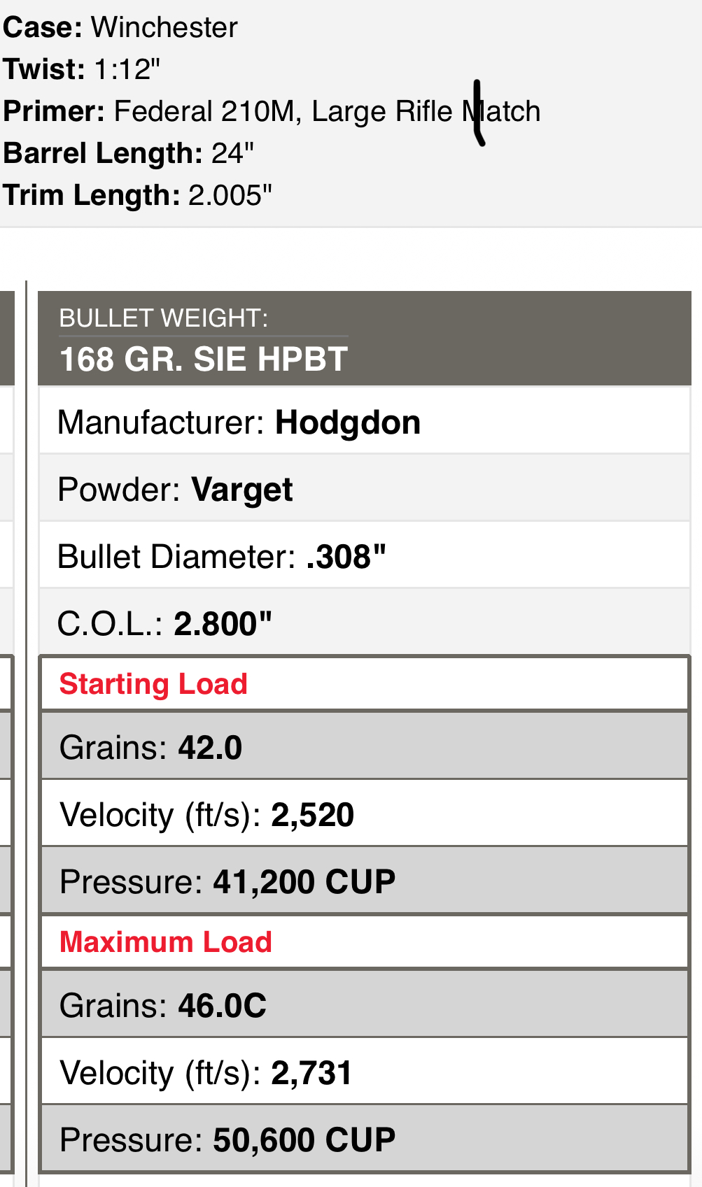

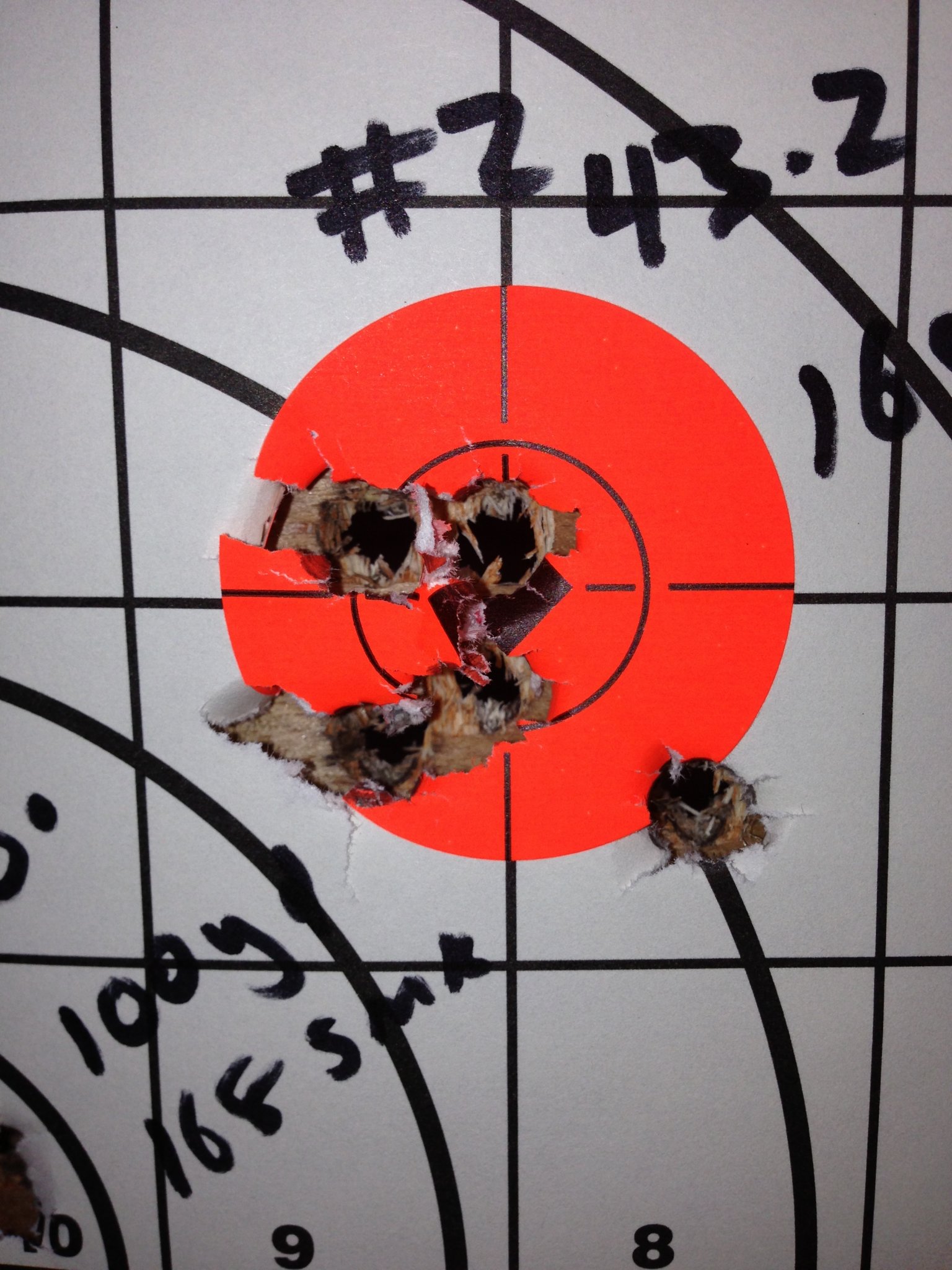

Been tinkering with my loads but it shoots pretty good for a gas gun. Using 43.2 grains of varget with fgmm primers and 168 smk. The 16 CL barrel definitely likes 168 over 175. View attachment 7051548View attachment 7051549View attachment 7051550View attachment 7051551
Nice gun, and nice shooting!
How does your brass look with such a heavy load? I see pressure signs very early on with 41 grns varget, and 41.4 of 4064 using 175smk. I now shoot 168 ELD-M at 41.4 of 8208xbr and still have flat primers. If I shoot suppressed, forget about using the brass again as all primer pockets are blown out. (I use 7.62 brass from LC and IMI so less capacity) I don't want to use my stash of LC-LR, FC, or Lapua brass cause I want to be able to use it after firing. Our guns are very overgassed. A bit better result using JP SCS and 2 tungsten weights. Going to the 18ss barrel and rifle gas helped but still beats up brass.
I also tried the Gemtech adj. BCG and JP HP bolt but they fail to feed every 2 or 3 rounds so stopped using it.
Love the gun, but if you handload, you're gonna lose a lot of brass after 1st firing. Unless I'm doing something wrong.
I seem to consistently throw 1 flyer low right in a bunch of my groups. I’m sure it’s me. I’m still working on shooting the beast better as I used to basically free recoil everything but am now moving to the firmer hold recommend to “ride” a semi-auto.
Honestly I have so much brass that I’m barely only into one reload per piece so I have not checked the effect on primer pockets being enlarged for multiple loads, but 43.2 grains of varget with 168 SMK doesn’t seem hot at all in my weapon and ejects neatly as expected.
I have attached the load table off the hodgen site for your review.

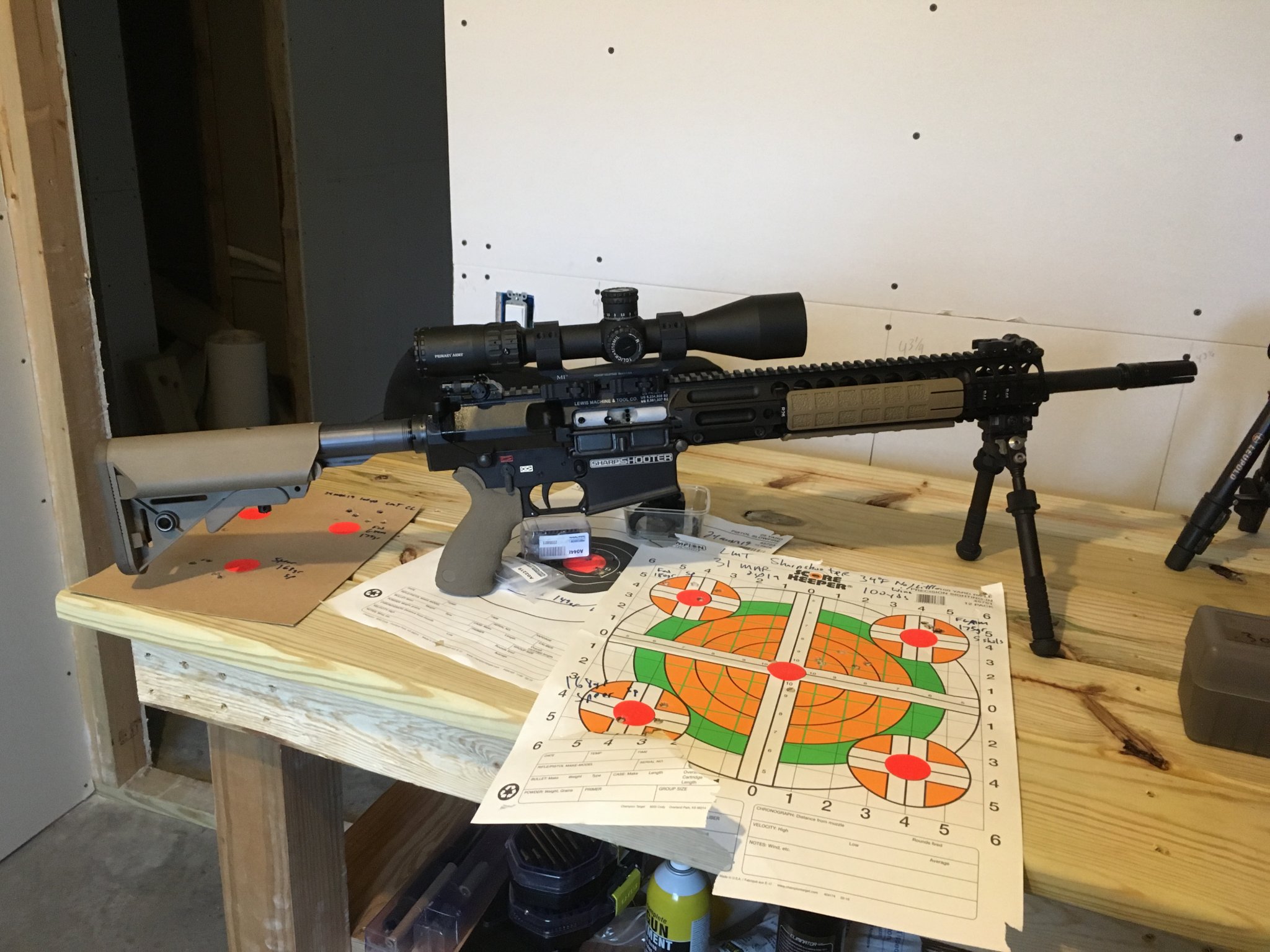

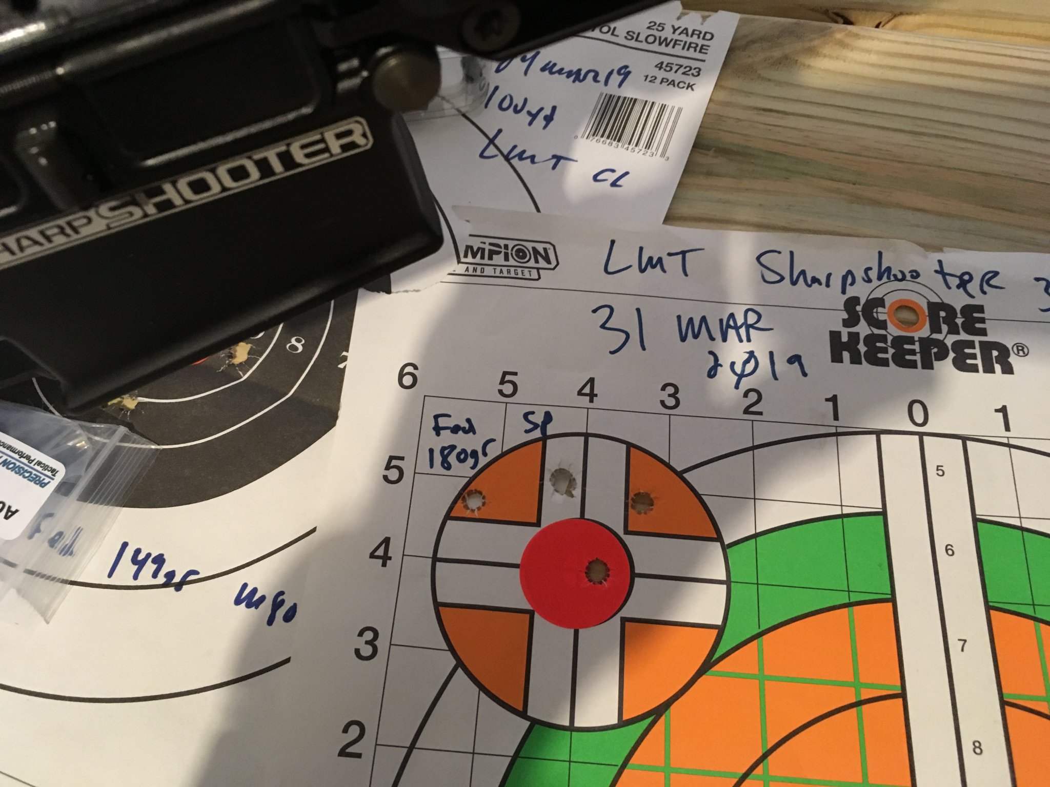

I'm I'm leaving the range now but all I can say is wow. I didn't try any type of precision stuff out of the 16 inch chrome lined Barrel as I did order a 20 inch stainless steel 5r barrel but let me say that I am very impressed as wolf, Dag, DP you all shot very well at a hundred yards with a 14 mile an hour wind
ok, 14-15mph wind and was shooting DAG and Wolf. Wolf is the first target and Dag the second. Ignore the shots 3 shots on the left of the Dag as I was adjusting the scope. 100 yards and off a bag but I'm sure to tighten these up as the rifle breaks in, I learn the trigger, better conditions etc. first 20 or so rounds.....

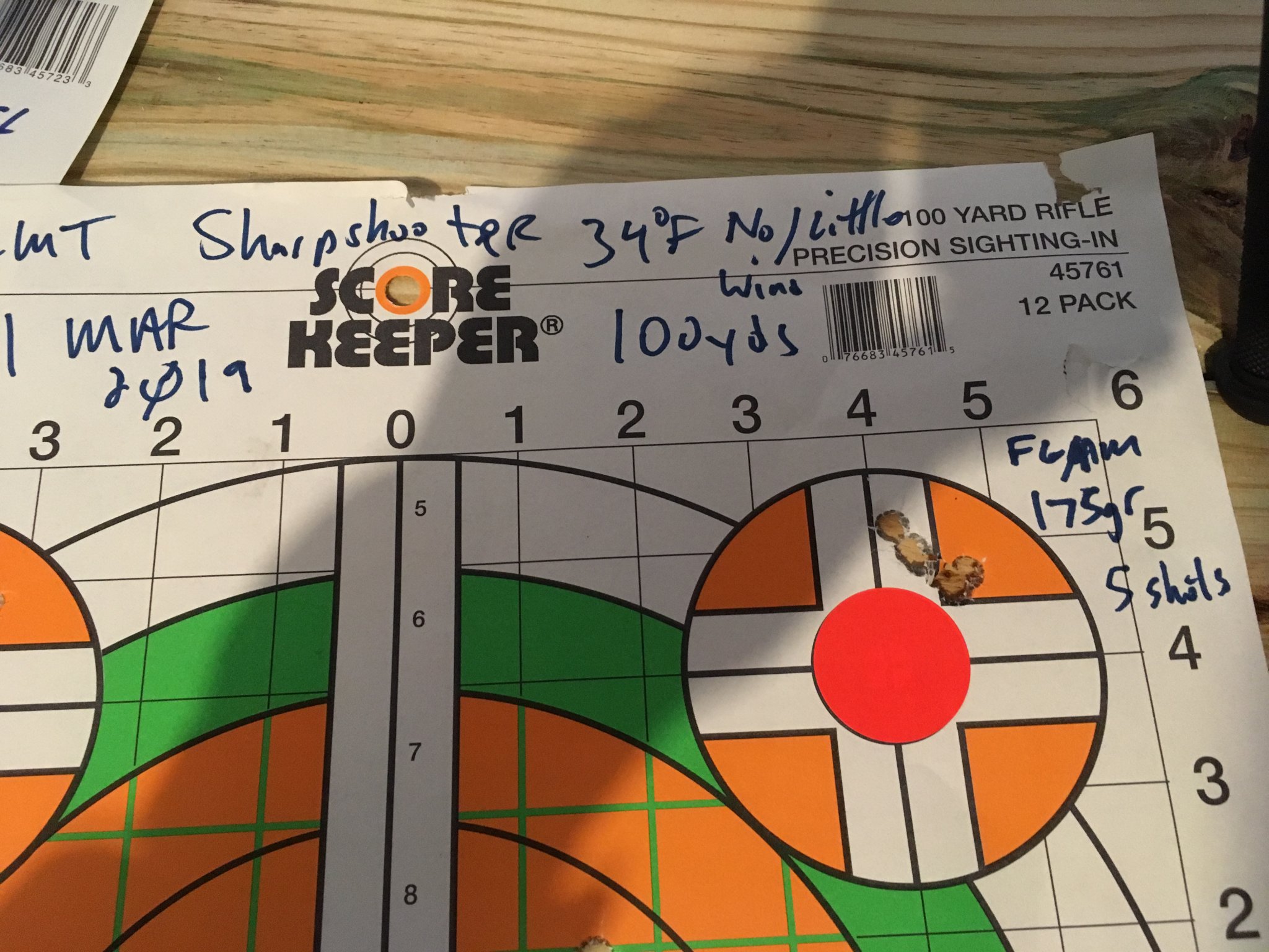

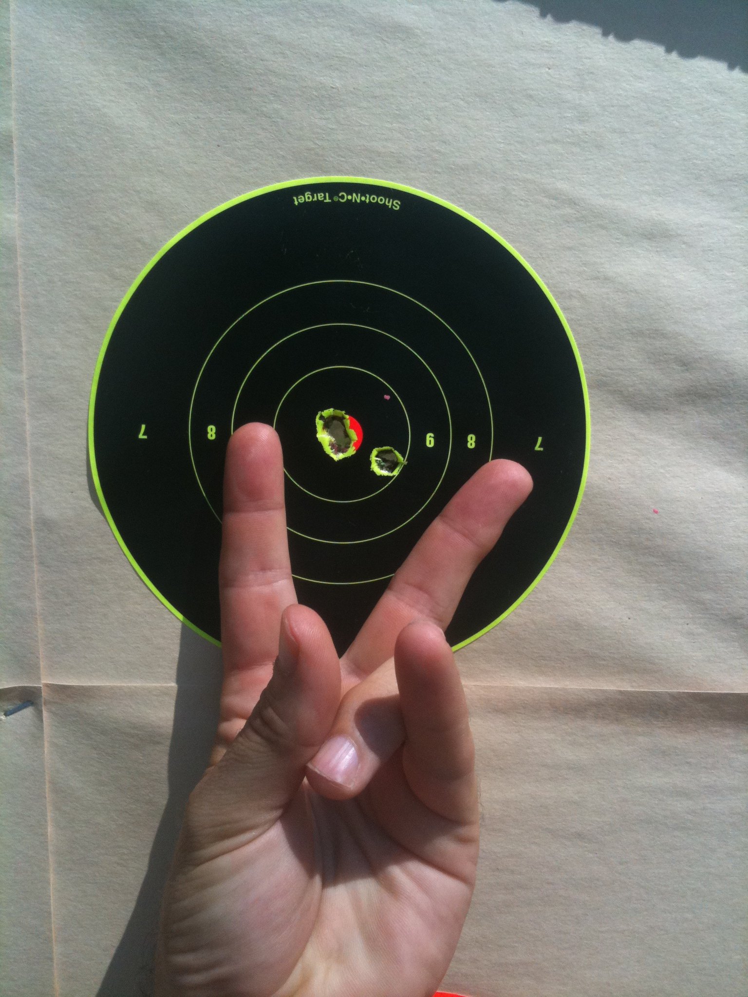

So, as an update to this, the rifle had been shooting .75-1 moa with the Hornady Precision Hunter. I was using an Elite Iron STFU on it, but did not like the amount of gas blowback. It really is a great can on bolt guns, but not on semi auto. I changed up to an Omega, shot three groups to rezero. Smallest was .25 moa, largest was .4 moa. It really shoots this stuff well.

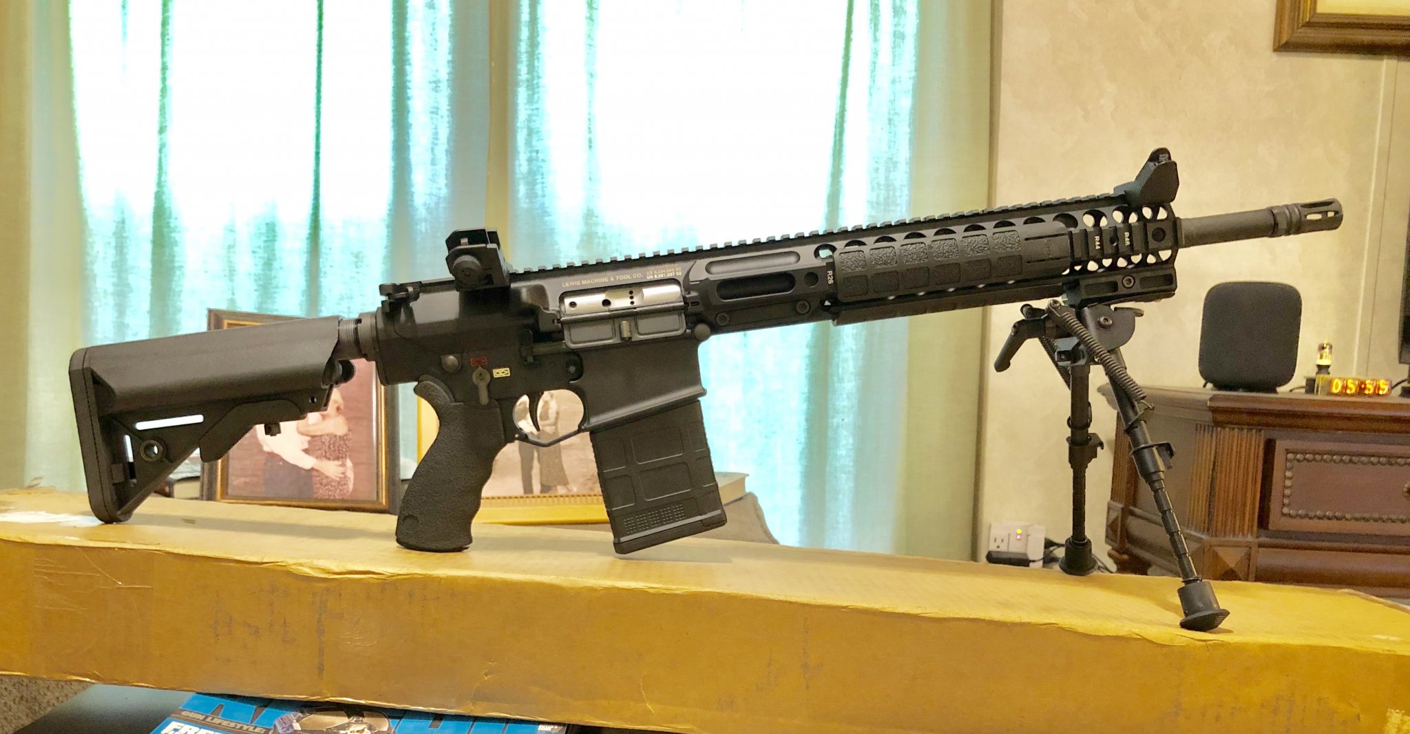

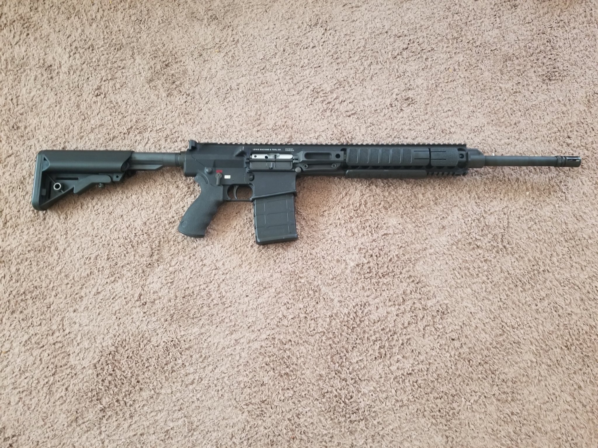

Just a “throw it out there” post. New here, read a lot, still reading a lot. First new rifle for me late in life (68yr. old). Just happy and have to get funds still to finish off the glass portion (probably be a Vortex Razor HD GenII 4.5-27x56 EBR 2C reticle). Heavy, I know, but for now that hits the good glass spot I want at a price I can handle. RTS iron sights. Heavy full profile 16” chrome. Got the Pelican 1750 case, 5-20 round mags LMT PMAG, Healy 2/1 point sling just in case. AMMO in wait: HPR 308 Win 150gr STSP, HSM 308 WIN 169 grain BERGER HPBT HUNTING VLD, and then ABM AMMO MISSION READY 308 Winchester 175 gr BERGER Match OTM Tactical...400 rnds/ 100 rnds/ 200 rnds respectively. Should be enough to start out, lol?. I’ll cut the case insert when get the glass mounted up....then got a buddy ex Navy (Subs) we plan to probably use a local range (up to 1300yd.) to play with. Not a hunter though deer are all over the back yard. Looking forward to a lot of time on trigger and dry fire. Just glad this forum is available for all of us. ?
^^^^Nice rig. I have a similar set-up-although MLOK upper-offset sights are Magpul Pros but I did consider the Daniel Defense ones similar to yours.
I'm still experimenting with ammo-but I think it likes the 168gr match types. Have more incoming and will report back.
edit-I have a 5x fixed on mine and down the road get either an Elcan or ACOG 6x.
