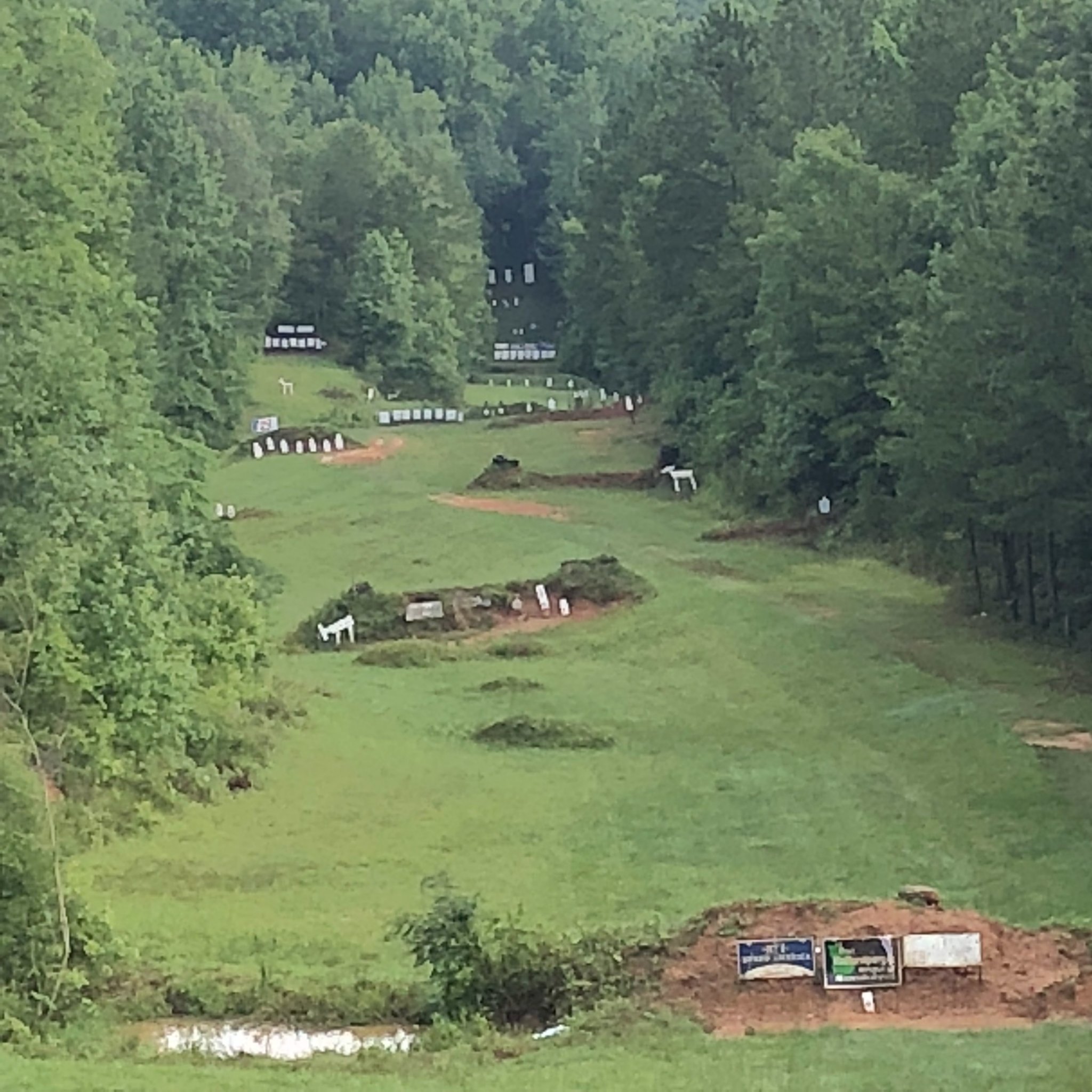

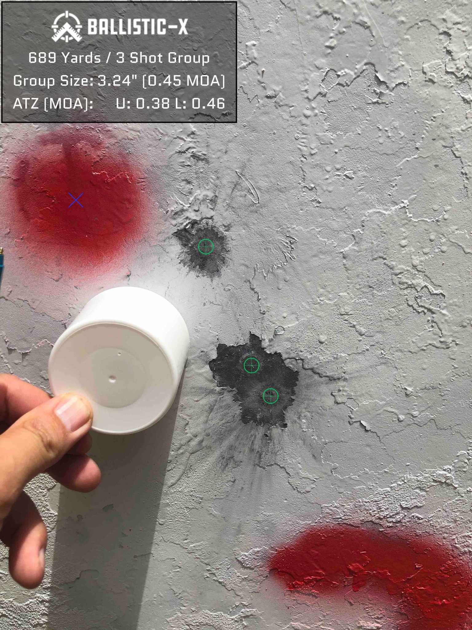

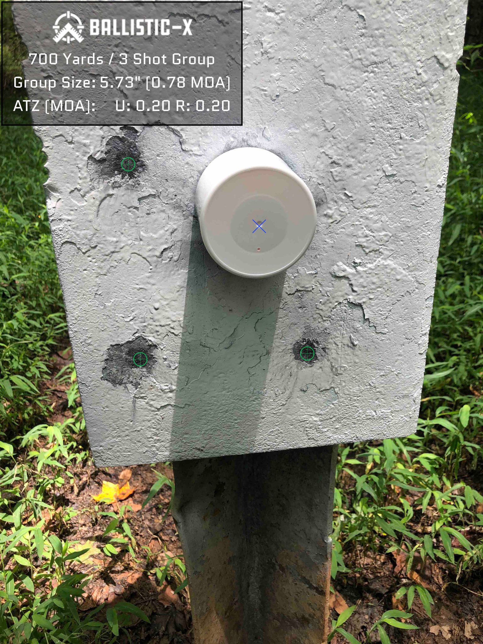

I was rushed for time so I cheated and shot 3 shot groups?? at the 600, 689, and 700 yard targets. Spray can top is 2 1/2”.
LMT MWS 308, 18” stainless barrel, 168gr Magtech ammo. 2.5-10x32 NF NSX.

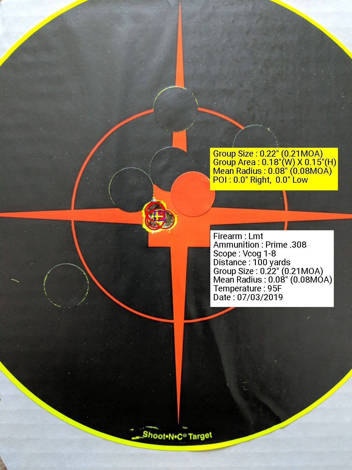

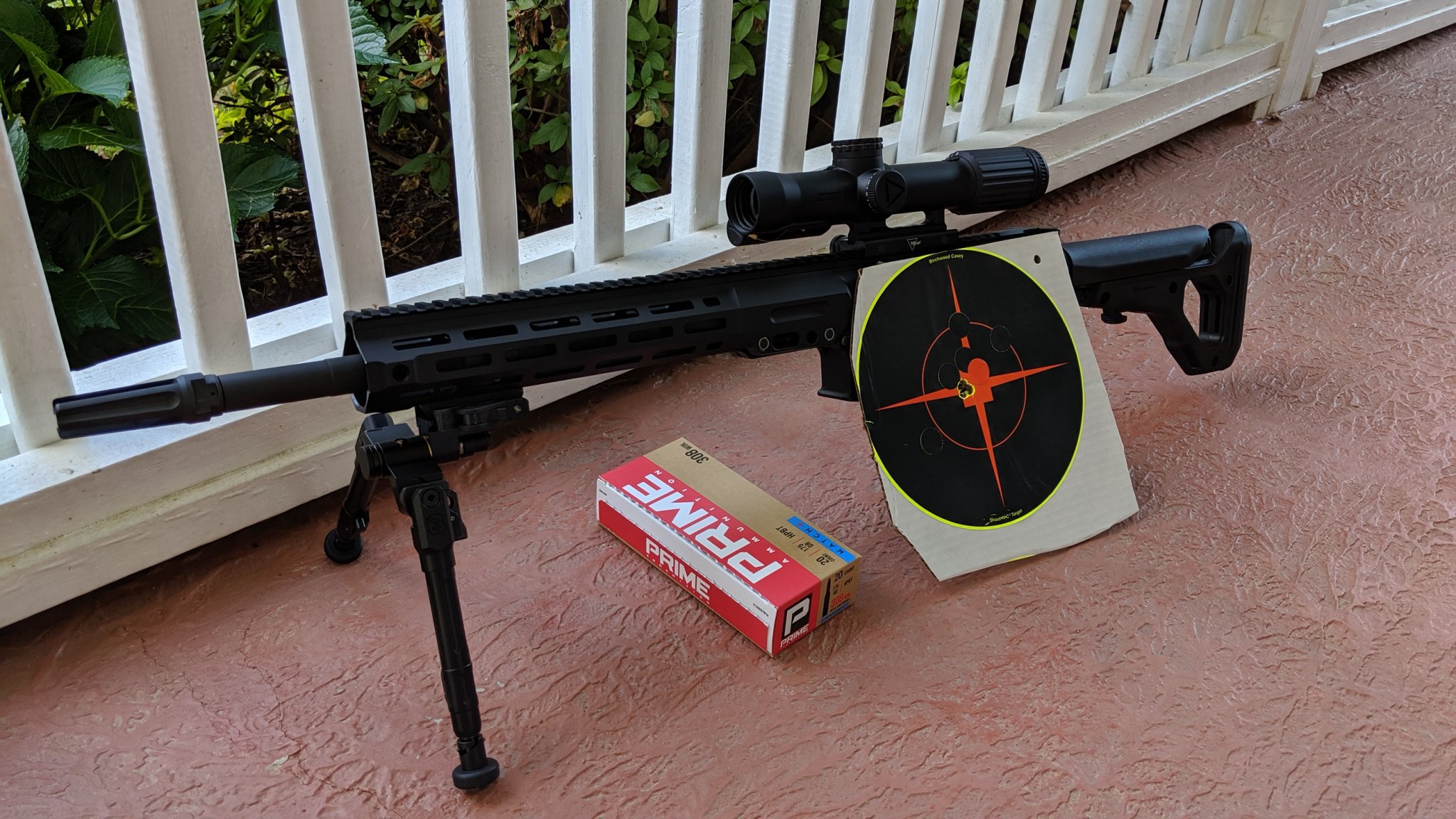

I finally got around to shooting for groups with my 16" CL .308 barrel, and I believe I answered my questions about accuracy for the MWS. For reference the dots are 3/4".
I'll take it out in a few weeks and shoot some dot drills with 5 shots and see what kind of consistent shooter it is, definitely think it has potential.
7105823
5 shot group with the new 1-8 VCOG with mil reticle. And you can bet your ass I wasn't taking this one to 10 shots just to appease folks on here that think only 10 shot groups count! ? Prime 175 .308. I was actually a little astonished, I am generally a 3/4 moa semi and 1/2 moa bolt gun shooter. Anyway, that is great shooting for me and really happy with the plain Jane 16" barrel, thanks
