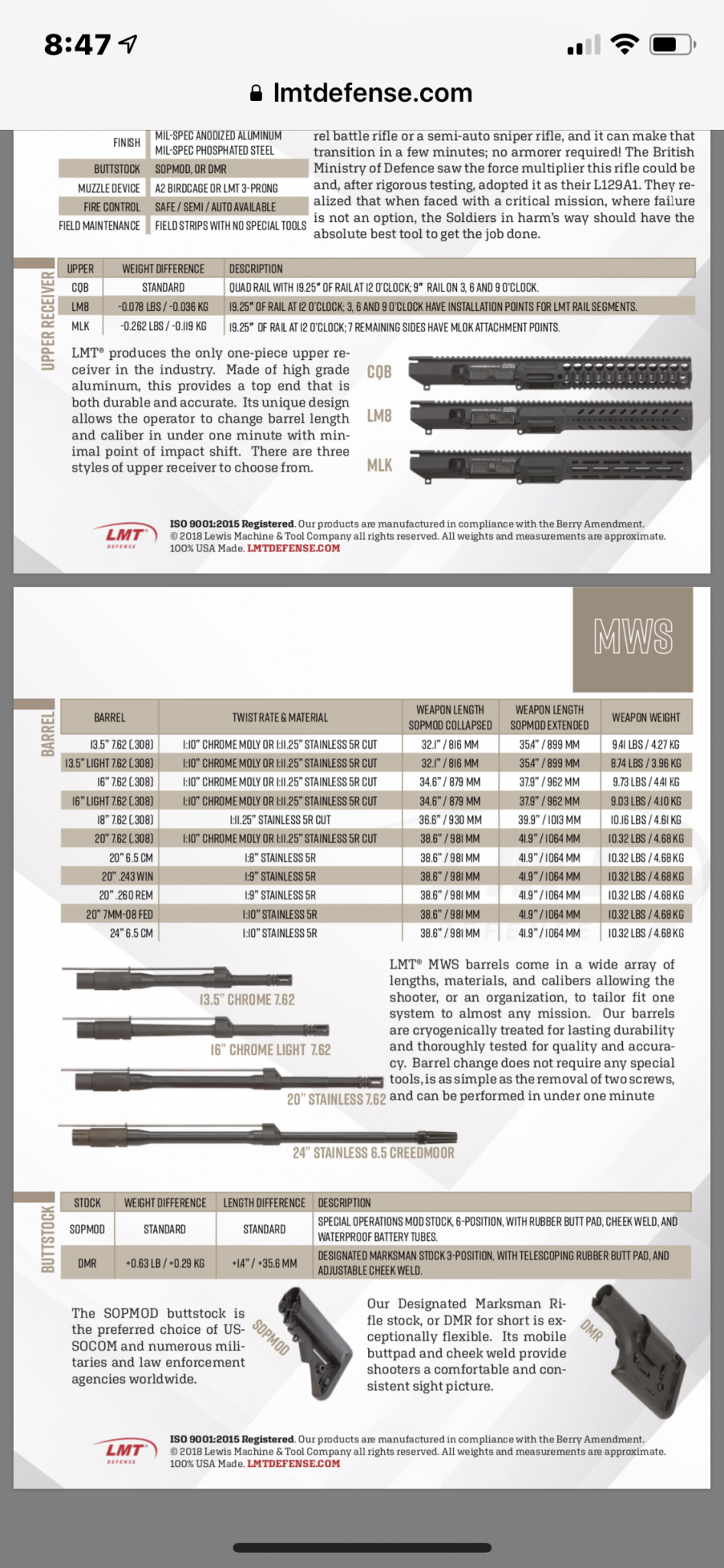

LMT has 20" ss .243 and .338 Federal barrels on sale for $275 right now-just a heads up. I've been trying to convince myself of either but can't seem to do it. I don't seem to be very good at the modularity part of the MWS system as whenever I buy another barrel I end up buying a new upper and lower to use it in.

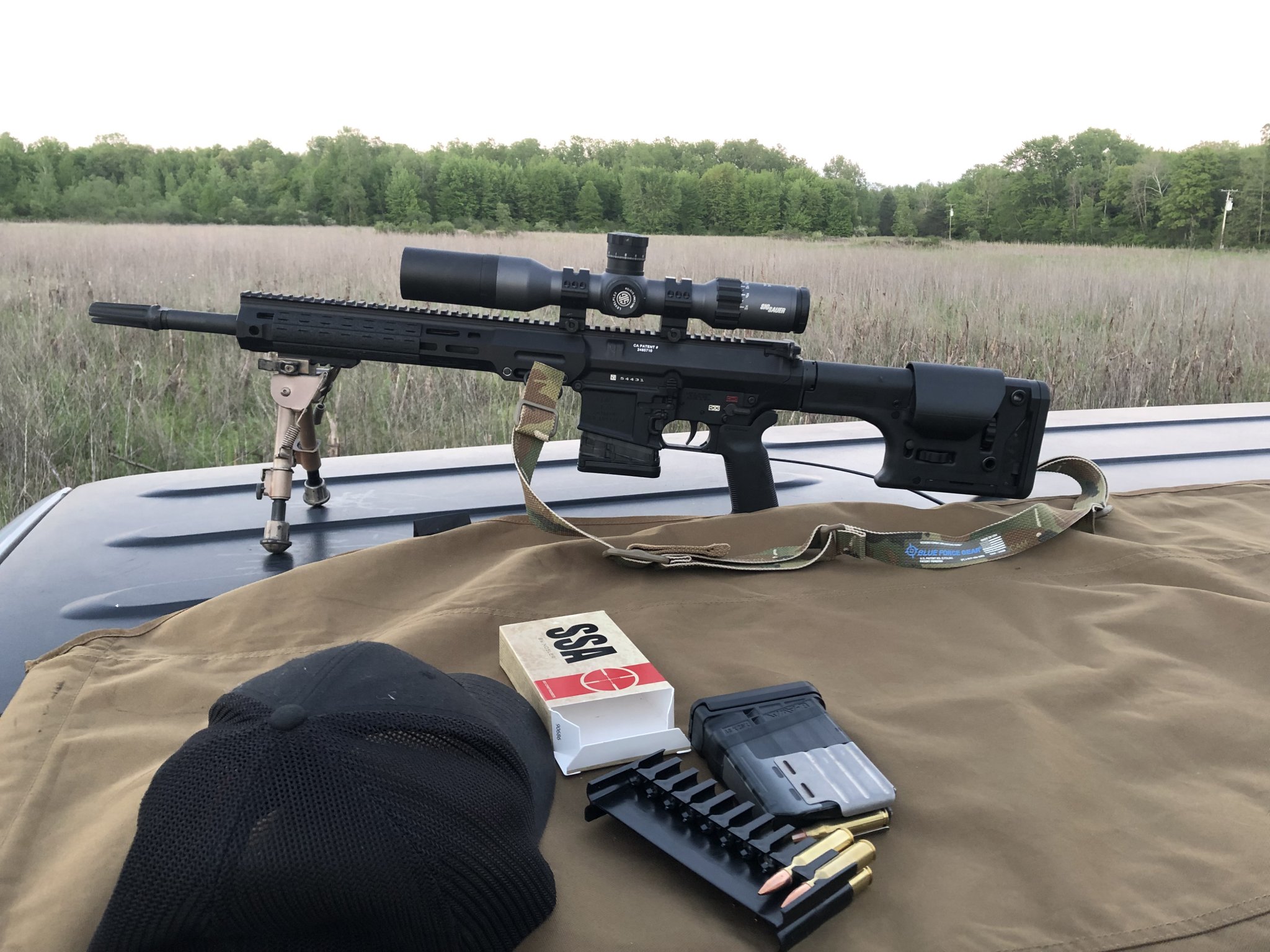

I was finally able to shoot a couple of groups with the 20" SS .260 Rem barrel I picked up for my MWS and they looked very promising. I also checked on getting one of the .243 Win barrels and those were shown as out of stock on LMT's website Monday. My MWS came with the 16" CL .308 Win barrel. I've modified it with a Magpul PRS stock, .308 rifle length spring and buffer. I'm not very good precision shooting with this platform yet, but so far the .308 set-up will hold under an inch with FGGM 168s and hot military 150s and reloads. I haven't been able to get any good loads to work as well with 155s or 175s
LMT had recommended Black Hills Gold Match so I tried that first. I was a little skeptical that the 1-9 twist would stabilize the long 139 gr. Lapua bullet from the old boxes I had; however, it produced a nice round group of about one and a quarter MOA in a gusting 5 - 15 mph crosswind. Current production lists the 140 gr. Hornady ELD at 2700 fps, and my Chrono indicated 2669 fps from the 20" barrel. I didn't get much better accuracy out of my GAP custom .260, which is why I still have most of this case on hand.
Next I tried the Berger Match ammo using the 130 gr. Hybrid OTM Tactical bullet that was specially designed for use in semi-auto match rifles. Accuracy for this ammo was good with the first three rounds going into a long diagonal hole, before the MWS jammed on the fourth round. After clearing the jam, the next round dropped low spoiling the group and the last round joined the first three. Berger lists the muzzle velocity for their load at 2847 fps. This was the second time I tried this ammo and the second time it jammed on the fourth round out of five being loaded into a ten-round Magpul Gen-3 magazine. It also failed to lock open after the last round fired.
Finally, I tried some handloads that I keep on hand for my GAP .260 using 123 gr. Lapua Scenars over 44.0 gr. of Hodgdon 4350. My Rem 700 based GAP custom easily groups 5 under 0.50" when I do my part and has occasionally produced some 0.2s and 0.3s with this load. Muzzle velocity was 2886 fps from the 20" MWS versus an average 2958 fps from the 23" barreled GAP custom Rem 700. Unfortunately, the MWS didn't like this load any better than the Black Hills Gold Medal, and it had one flier about 2 MOAs high. It too failed to lock open after the last round, although there were no actual jams.

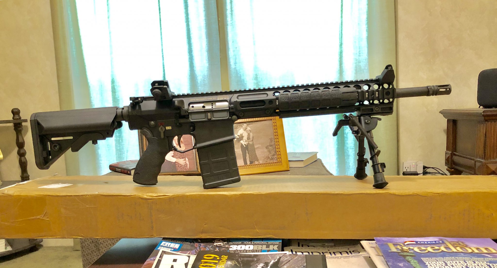

How’s she shootin’ for ya’? Still waiting for funds to glass mine (shown earlier this thread)...not hurting to wait a bit and learn/read all the scope stuff in The Hide for sure. ?on the new stick.
