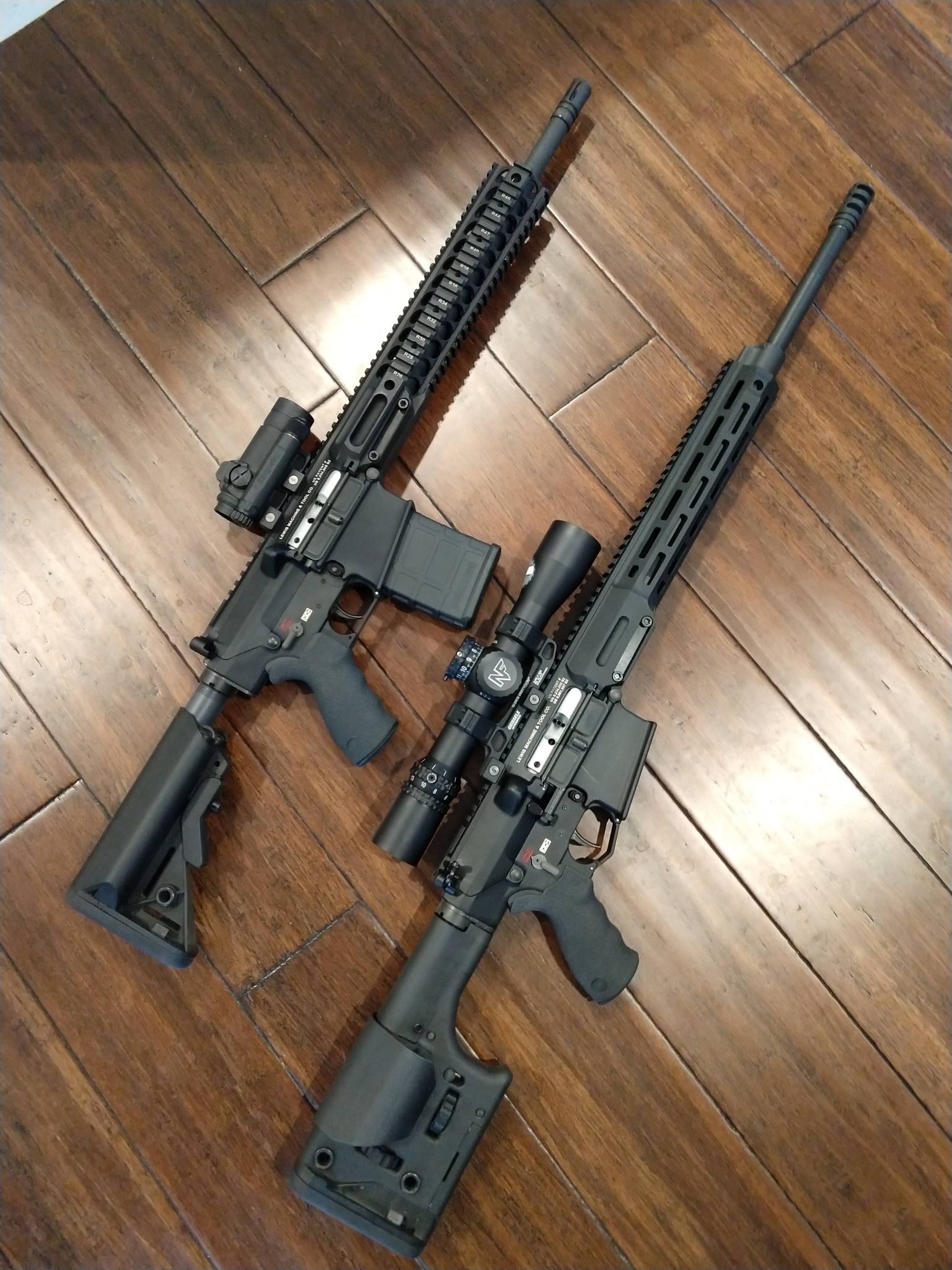

How many of you guys own more than one MWS or don’t even have a bolt gun anymore because of am MWS?
I don't personally own a bolt gun, yet. Two MWS one pic rail, one mlok both ambi. 308 16" CL x2, and 20" 308 SS and 20" 6.5 SS. Toying with selling the pic rail off, but I so like it...

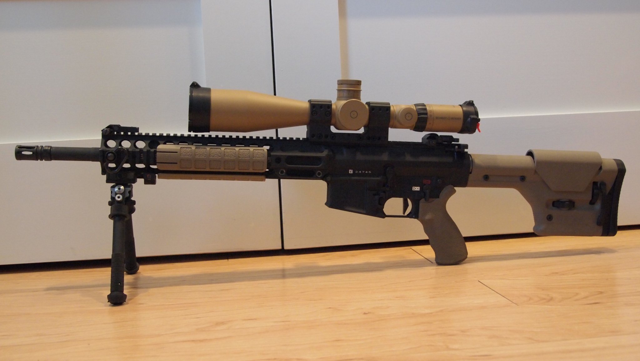

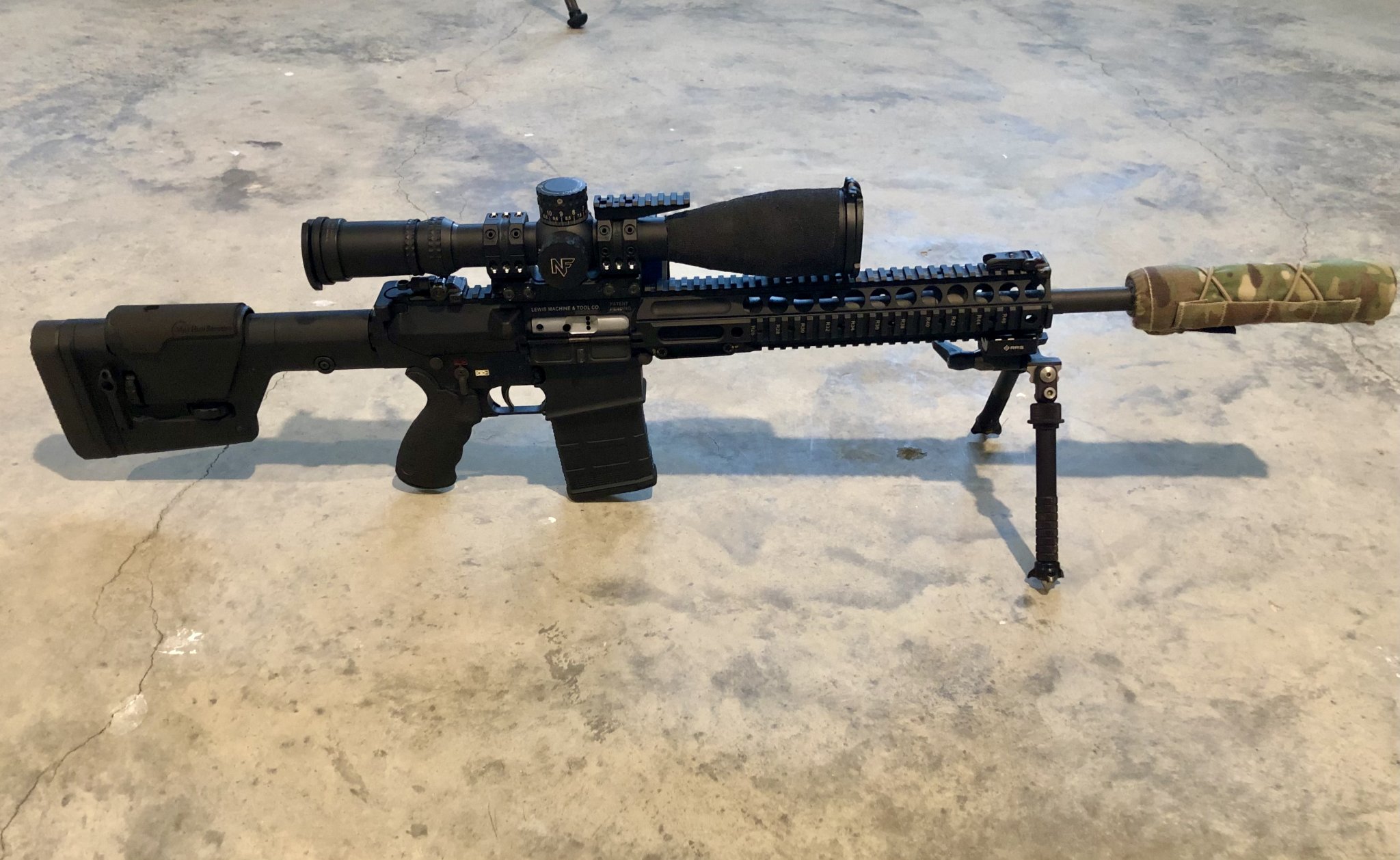

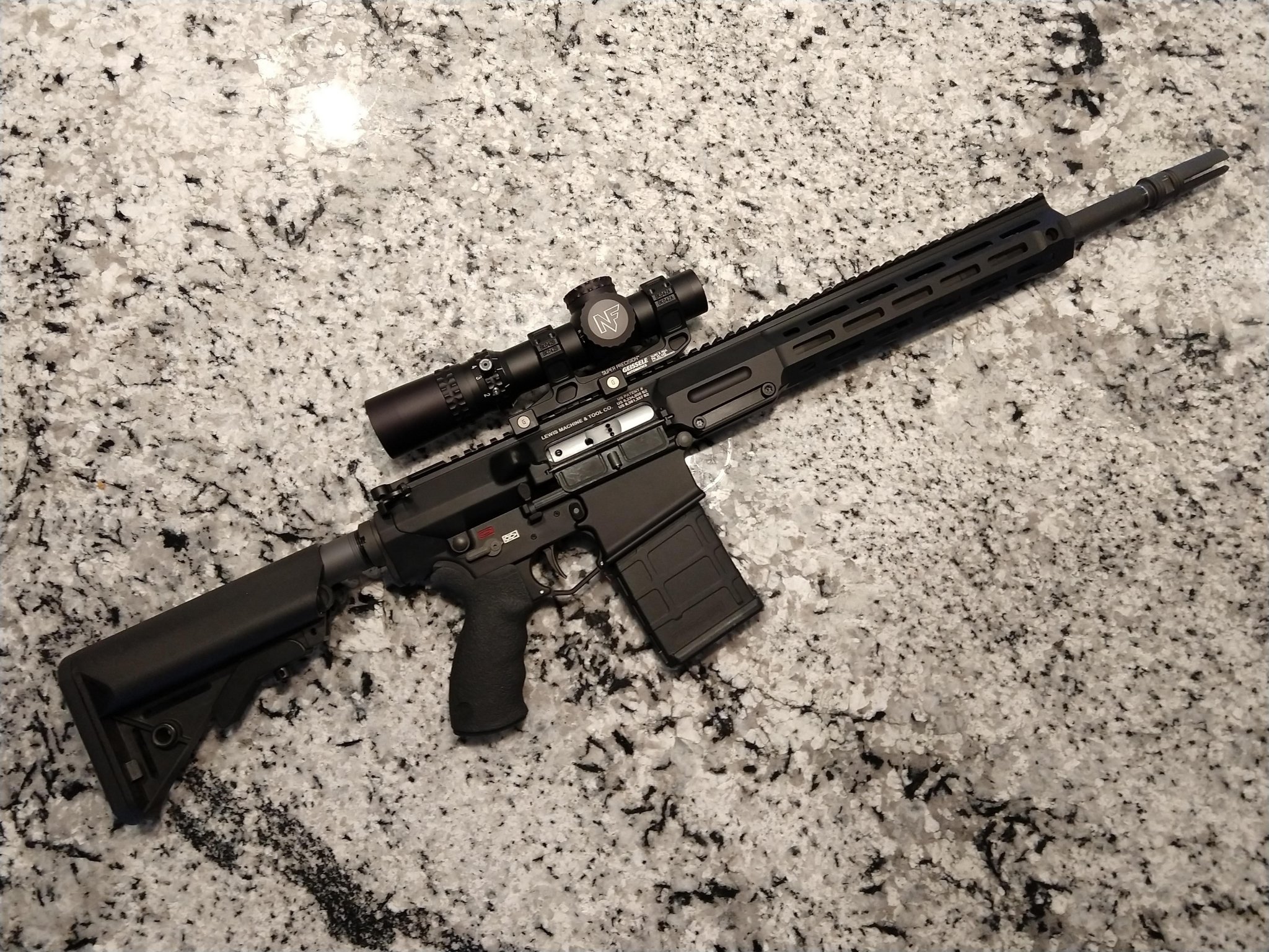

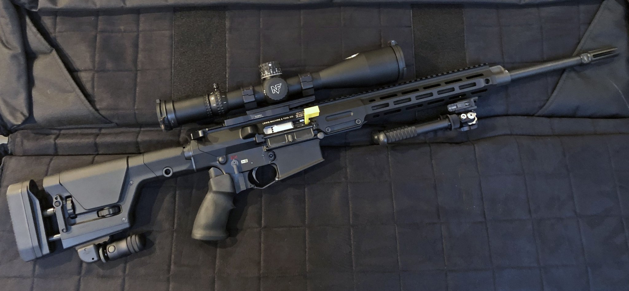

What is everyone using for glass on their MWS? Share pictures if you have them.
I should have the final parts from V1 by Dec and need to start working on a scope. I could use some help narrowing it down. I'm likely going with the 16" LW SS barrel and want to keep weight in mind.
Currently considering ATACR 4-16, NX8 2.5-20, Mark 5 or 6 3-18, Trijicon Tenmile 3-18, T5Xi 3-15, Vortex Razor AMG, or more budget Viper PST Gen II.
This will be my first step into higher-end glass so any help is appreciated.
Also Mags. Pmag or Lancer L7? I really like my Lancers in 5.56.
I run an ATACR 4-16 FFP on mine.
I use Pmags. 100% reliable. No experience with Lancers.
Reactions: LMT/556
Also Mags.
My current selection for MWS is a CompM4S, NF ATACR 1x8, and a NF ATACR 4x16x42. I have an older NXS 5.5x22 that would work on a long range config also. I have both Magpul and KAC mags, either works fine. Most rounds at the range get fed from a KAC, but at home the loaded MWS has a Magpul in it. Buy once, cry once on the glass, and if you like something don't be a dumbass and sell it...

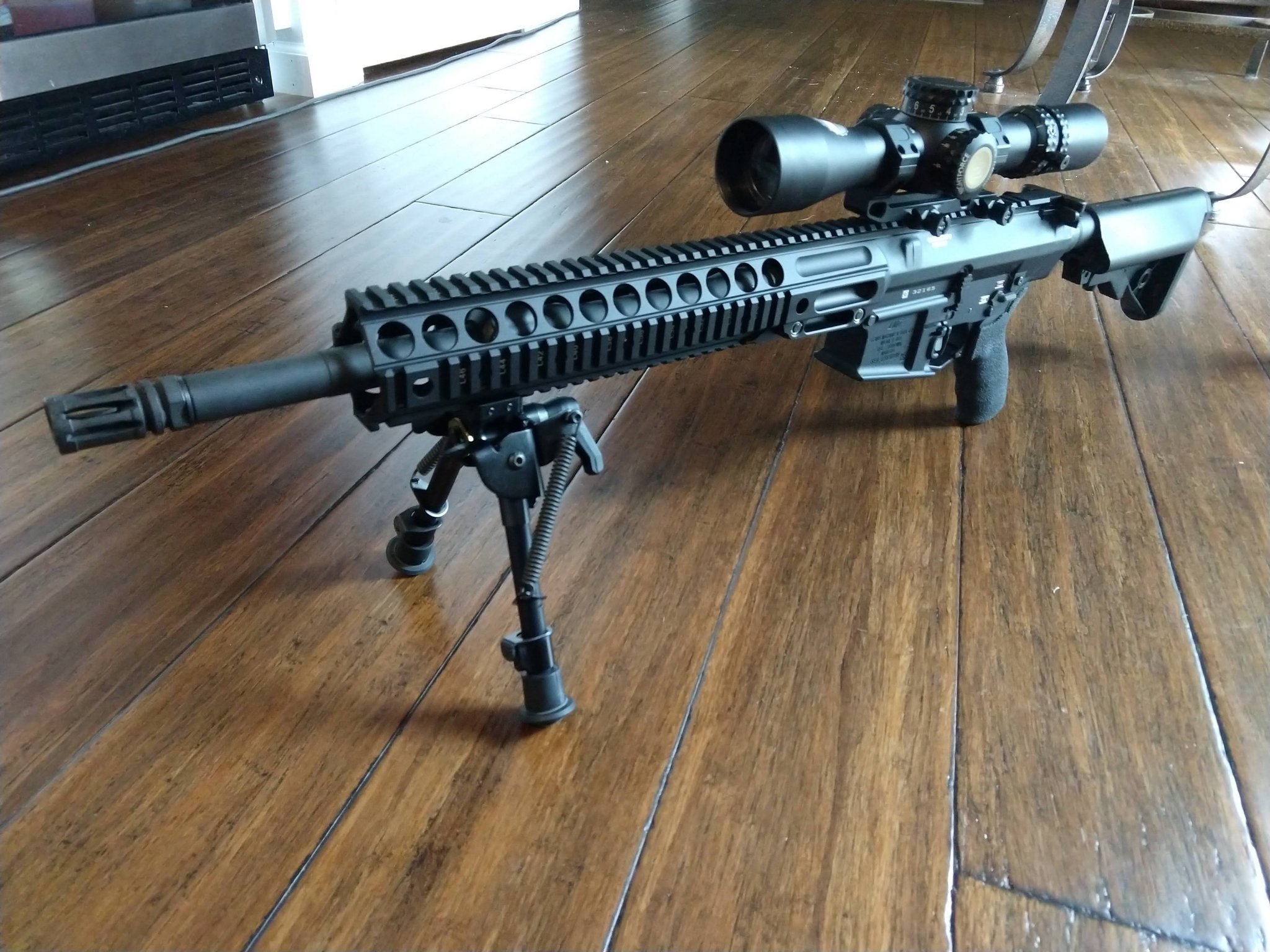

I started with a Schmidt 5-25 PMII.
I also had a Magpul PSR stock.
It made an anchors anchor.
I went back to the LMT collapsible and mounted a USO 1-8X (sorry no pics).
Mo betta.
