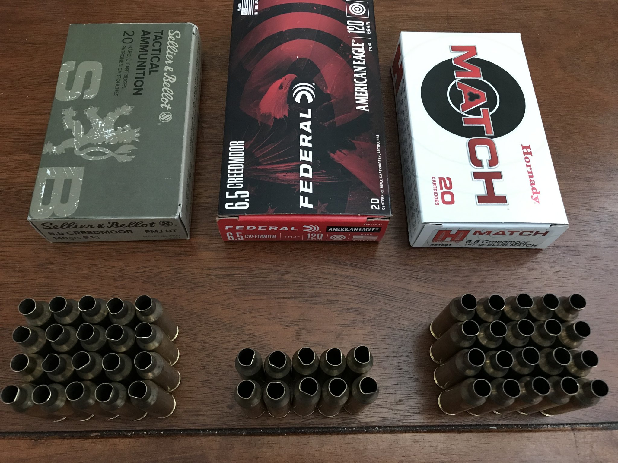

Just took out my Black Friday 22" 6.5 Creedmoor Barrel with a New unfired & uncleaned MWS with some CLP squirted on the bolt and it ran like a top, 100%.
Only fired 50 rounds (20 S&B 140gr, 10 Federal American Eagle 120gr, and 20 Hornady 147gr ELD Match). All from a single magpul loaded 20>10>20. Iron Flip Sights. S/A Carrier. No special Buffer or spring just stock.
Didnt check accuracy at all. Only Rapid fired it into about a 1.5" Circle at 25 yards.
Only thing to note is it kind of chewed up the brass picture below
