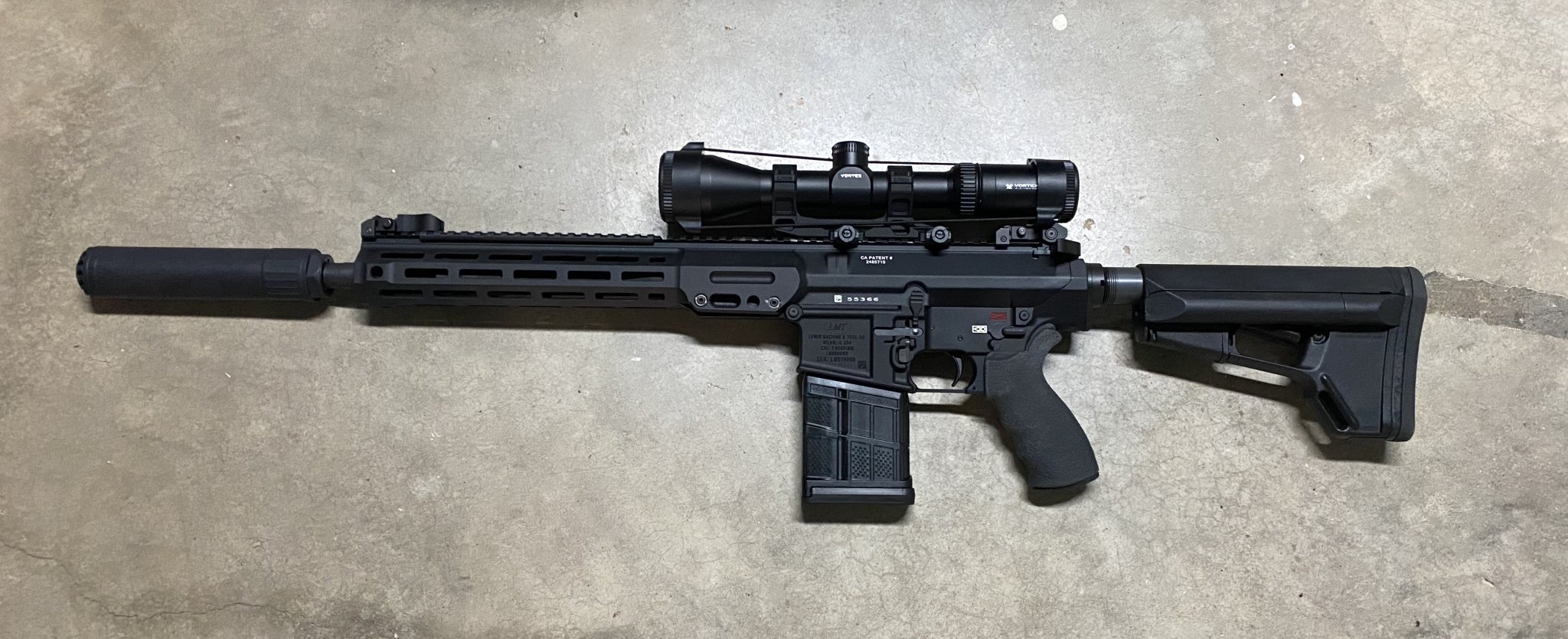

For those of y'all with 13.5" .308 barrels, what role are you using this gun? And what optic? I love mine, just have no idea what to do with it really.
I've tried several LPVOs and scopes. Seems like the shorty .308 would be a good thermal host, but I haven't tried that yet. I use 5.56 SBRs for NV pig smashing with a T2 and PEQ.
Since I shoot on the east coast and there are no a lot of long sight lines, so I sort of use it as a CSASS type rifle similar to the KAC APC. With that being said, if I slap RDS on it I can do blaster stuff. Really, it can pretty much do anything I want it to inside of 800.
Edited to add, The LPVO is fine, but I am going to shift that over to the ACC and the Eotech to a 556.
Heavier accuracy type stuff
Blaster type stuff
Blaster type stuff
Is that the 13.5” 7.62 barrel? Hows the noise level suppressed? I’m considering this route.
It is,
With that can, its fine, with cheap foam earplugs. Since its a lower pressure can, there is less noise at the shooters ear and more noise at the muzzle. Without the can, its quite concussive.
I really like it.

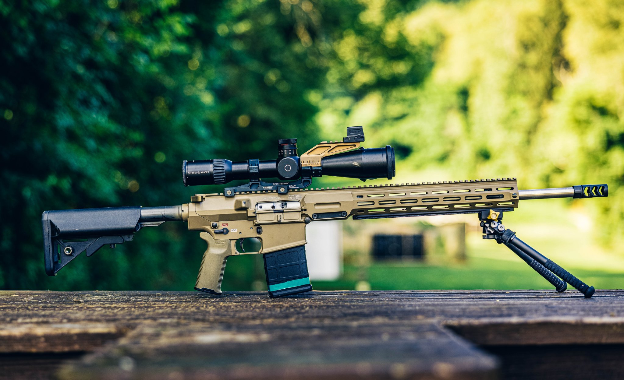

Gunner10’s 13.5 inspired me to have one cut down and pin&weld my OSS flash hider. I really like the balance now. I just need to figure out my optic now…. the vortex is just a temporary option
Downright sexy man! I went with a Mark 5 for mine. CST has it right now, they’re cerakoating it fde along with spuhr. If I could afford to have a 3rd TT or another ZCO I would’ve 😂

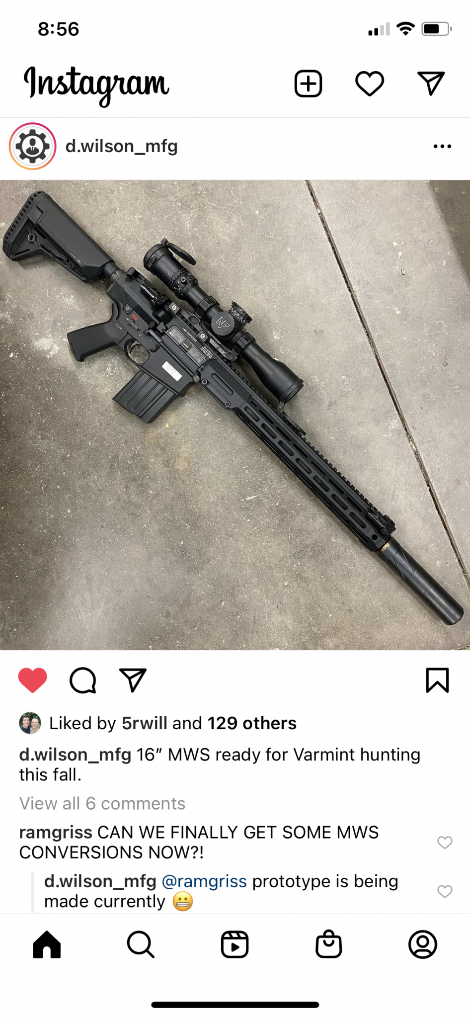

I was just thinking about putting a 419 rail on my MWS. Would it be possible to pull barrels without removing the rail? I'm guessing not... But I've also heard people say that if you grind the screws down, it's not a problem. How is it shooting off hand with that 419 rail on the gun?
Depending on how often your are actually pulling your barrel, It may not even be worth your time to trim the screws. i had mind trim pretty short on my panels, and I still need to take the panels off to remove the barrel. It would be nice if that was not the case, but in no way is it a show stopper.
