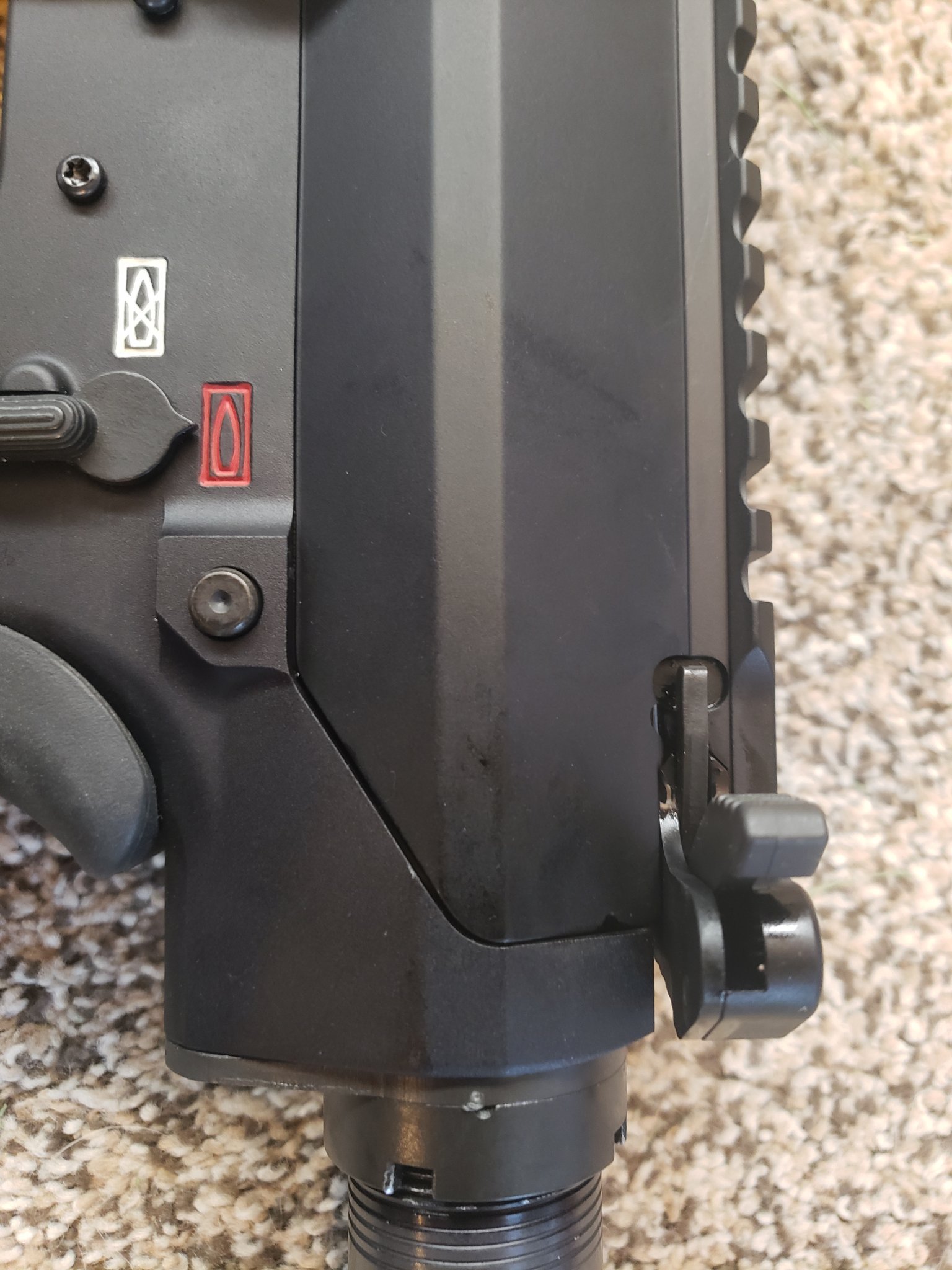

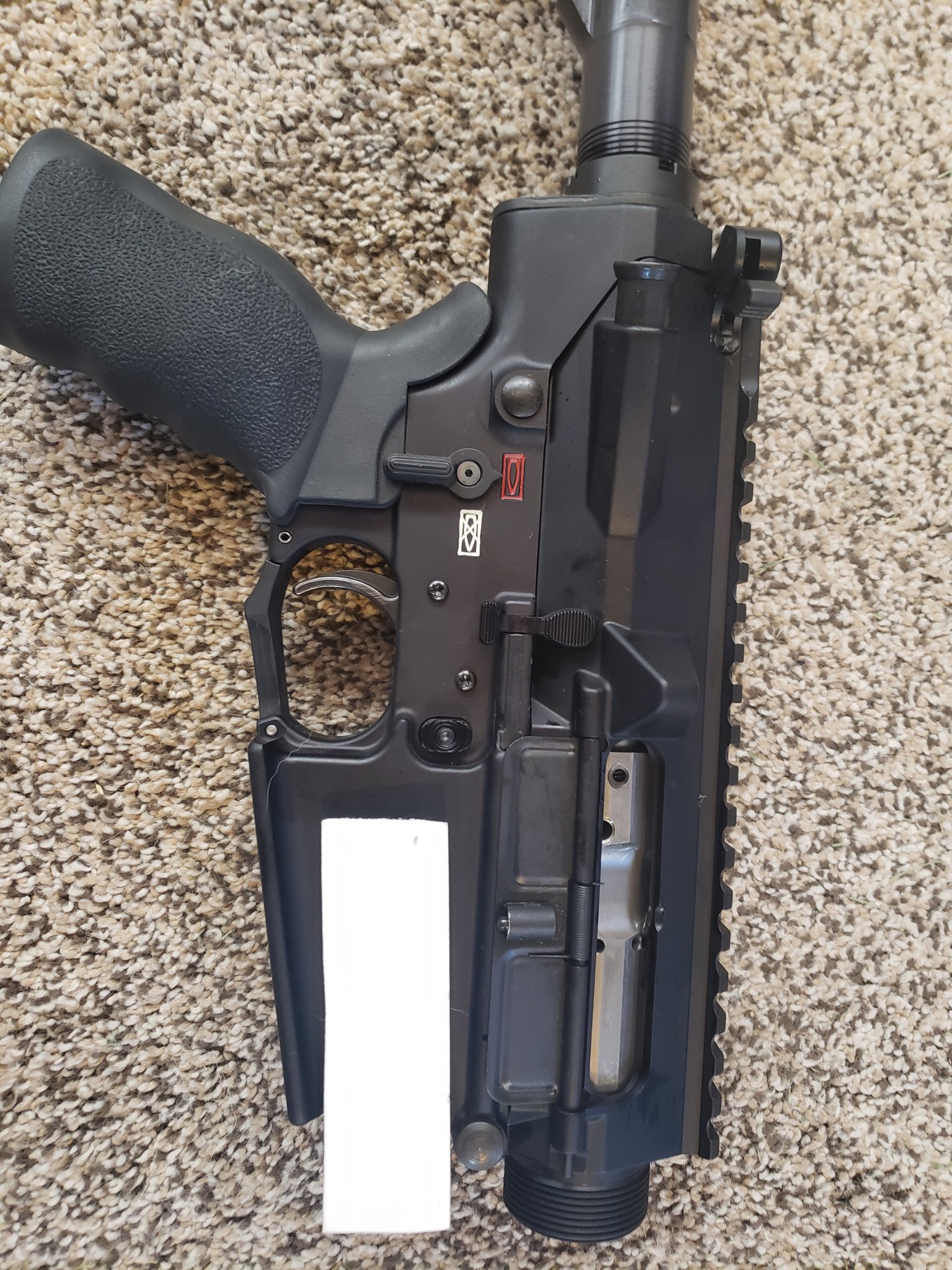

Stag arms upper on a mws mars h lower.....
#idemandaFA
#FAupperslivesmatter
