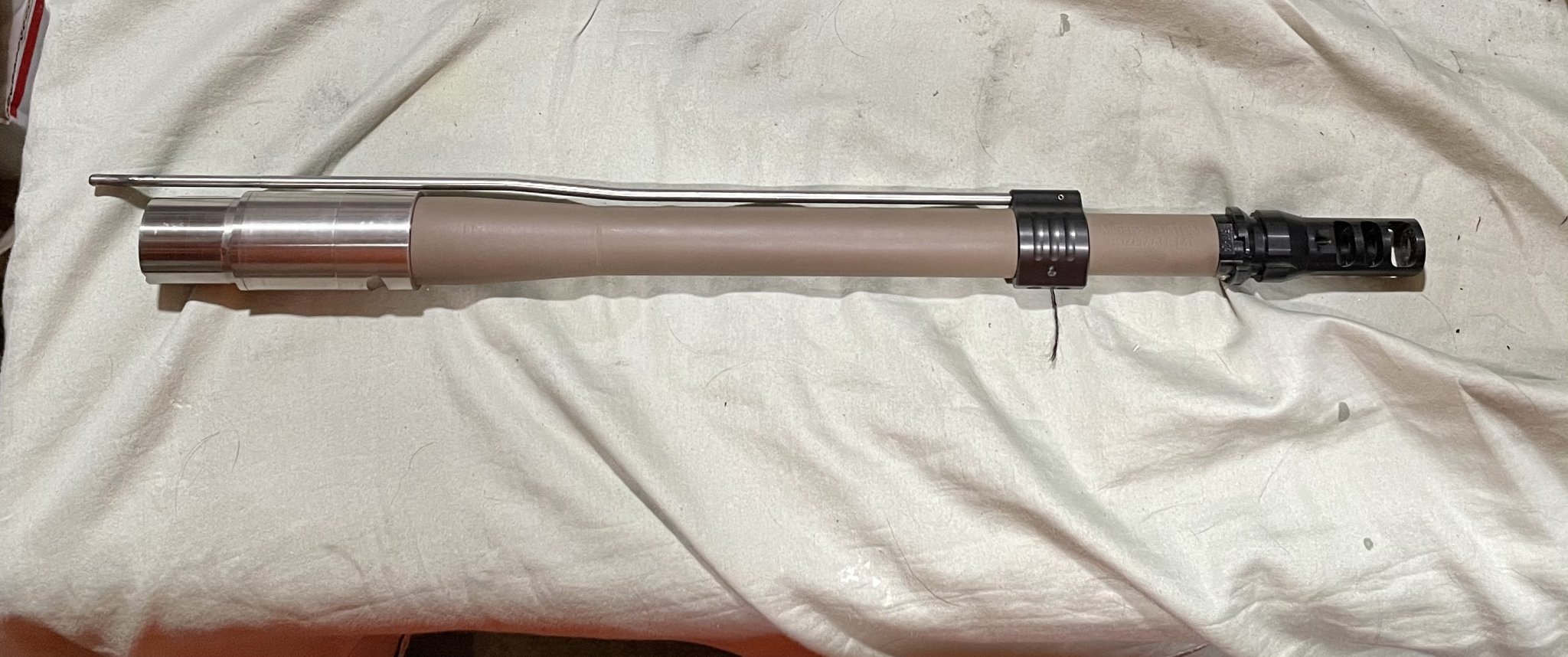

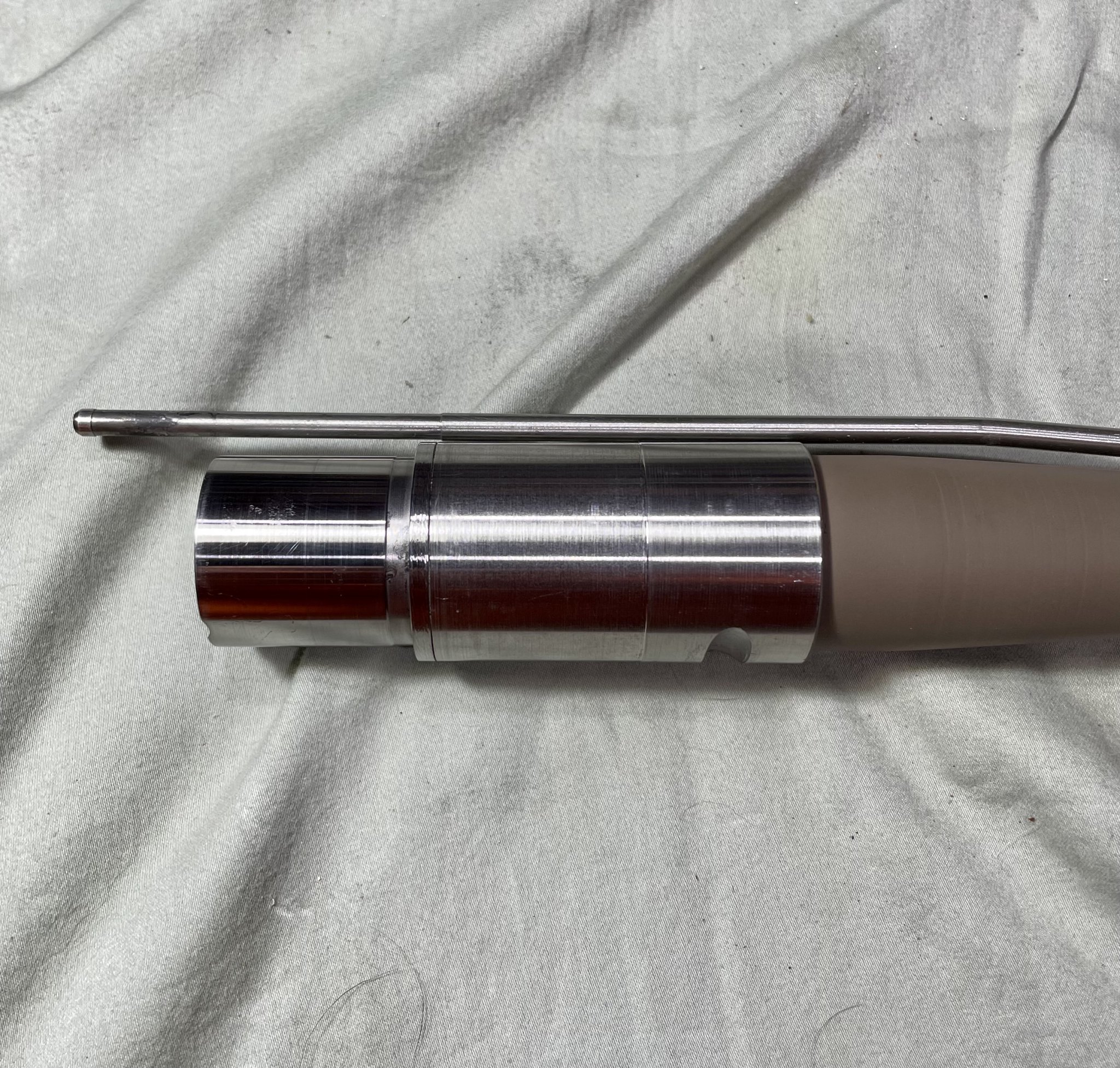

MWS project I was working on this week. Got a wild hair up my butt to convert a Proof barrel to work.
Will you be offering converted barrels? Cost?Heard the rumor LMT and Proof may be working on a some sort of deal. Ideal scenario for a company the did those conversions….
We’re entertaining it. We’ve been doing small frame conversions for a while, but the MWS is a whole other animal to convert mainly do the wild fluctuations in contour differences with AR10 barrels.

Very nice, has it been on the scales to see how much she lost?
The 22” carbon barrel is about 6oz lighter than a 16” steel barrel. Even with the can on, it’s pleasantly light in the front end, even with the musket length.
I have a few more things up my sleeve to get the weight down even more.

I need to put a few thousand more rounds through this guinea pig before I can commit to doing them for customers.
I always thought the steel portion on the cf barrels was too short to accommodate the length of the mws shank. Is it actually long enough or did you have to counterbore the sleeve to keep it off the cf? If you had to get creative for the cf would you have reservations about a steel barrel?

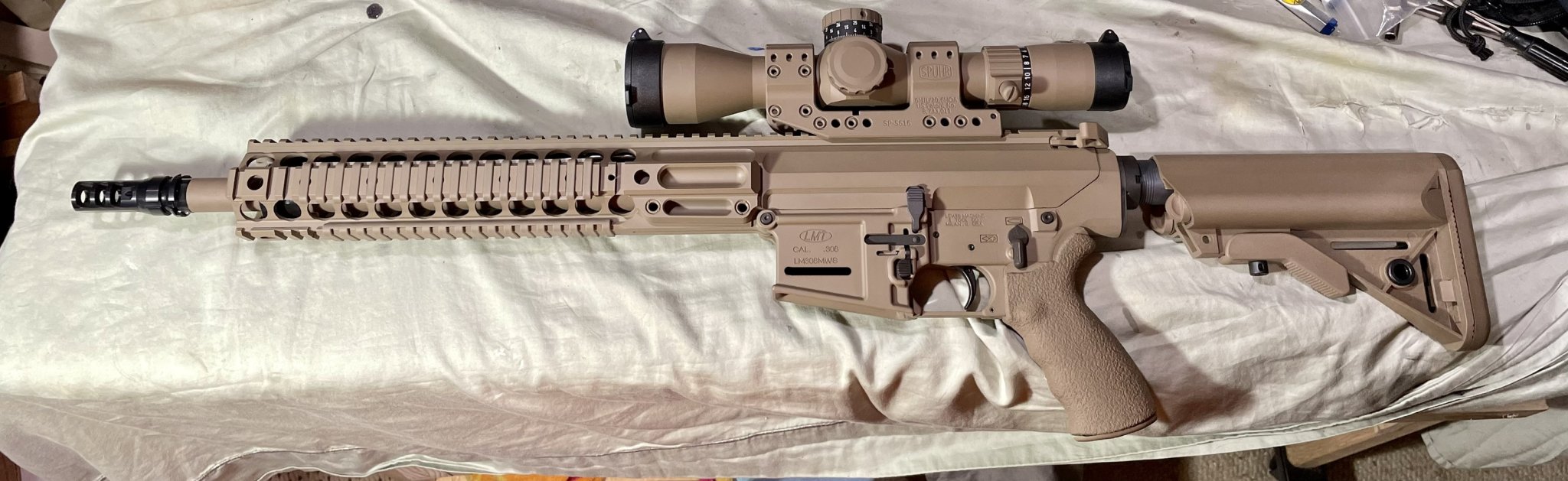

I took my 13.5 and SR25 ACC into the mountains this weekend and can offer a few observations.
While the ACC is noticably lighter than the 13.5 stripped, from a practical standpoint once optics, cans and loaded mags are added., I really don't think there is a difference between the two.
Recoil, with both the 16 inch ACC and the 13.5 wearing the same dead air brake. Pretty much the same.
While I would not sell my SR25, I honestly shot the MWS more. While there are alot of good large frame gas guns, it's really hard to beat the mws, it just works.
I was running the dead air sandman k on both rifles, and while it's loud, I like it and think it serves it's role well. I think I will look for another mid to full size can that offers a little better suppression, while not overgassing the system too much.
All in all good weekend

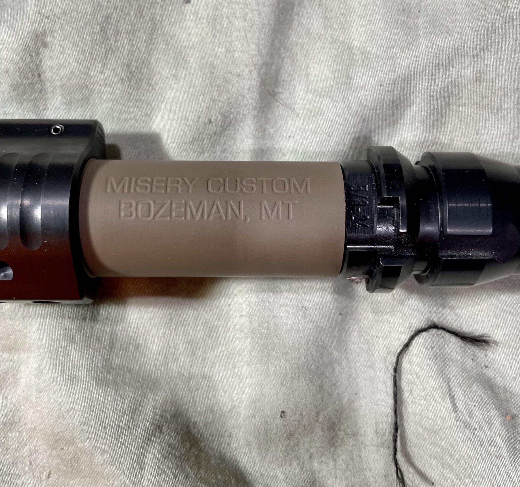

Received my 308 16” pin/weld Bartlein custom MWS barrel. Mocked it up as I’m waiting for some LMT Barrel locking screws to come in. The DA Sandman-S-MIL is still in jail. Should be a fun little range plinker.

Well I know who did my conversion, I wasn't sure who did the one for HenryTheAce.
I knew Marvin Pitts was doing then, but wasn't sure if there was someone else out there doing them as well.
Lol! Missed understood who was asking. Need to pull my head out of my ass and read.
Really great to see more people doing MWS conversations
How’s it functioning with the new carrier and gas block?
Which buffer and spring are you using?
Haven't shot it yet.
With the steel bcg, it had a standard spring and H3 buffer. I'll likely ditch the H3 for something lighter and turn the gas way down. I need to dig through my parts drawer to see what I have and figure out what I need to order to dial in tuning it.
