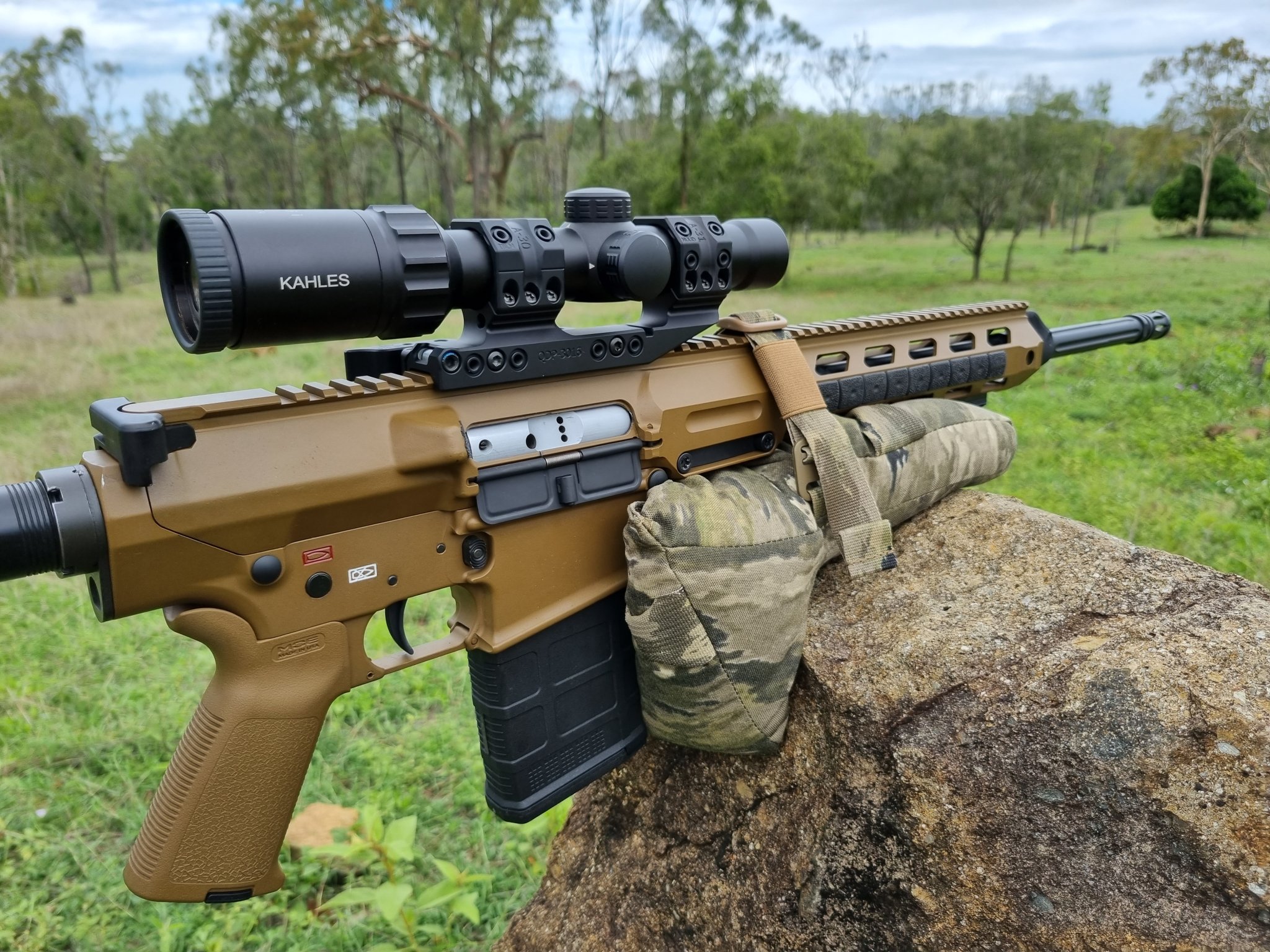

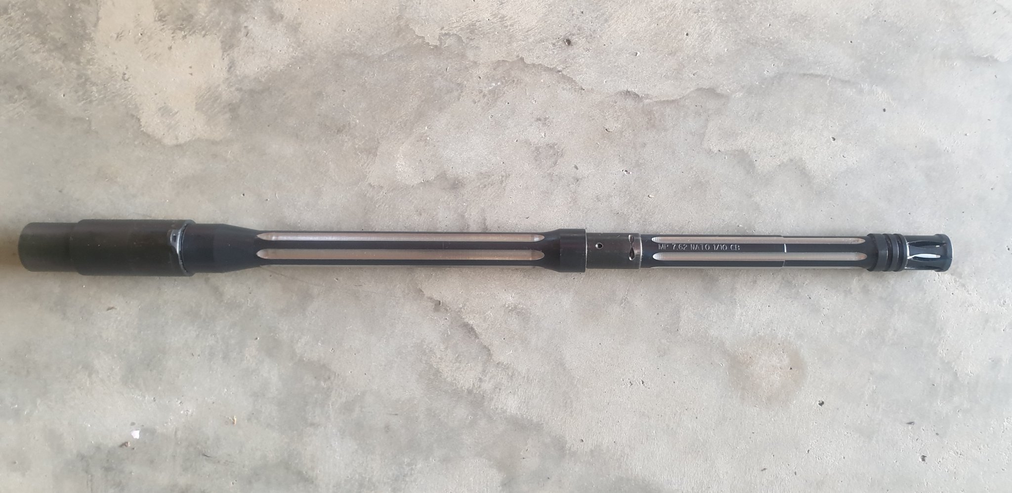

Fluted my 20"CL 308 barrel to try and loose alittle weight.
And gave @96C new Low Vis Gear, Aurora bag a run.

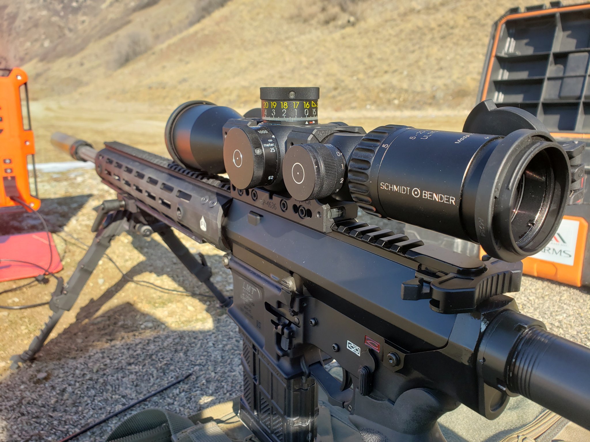

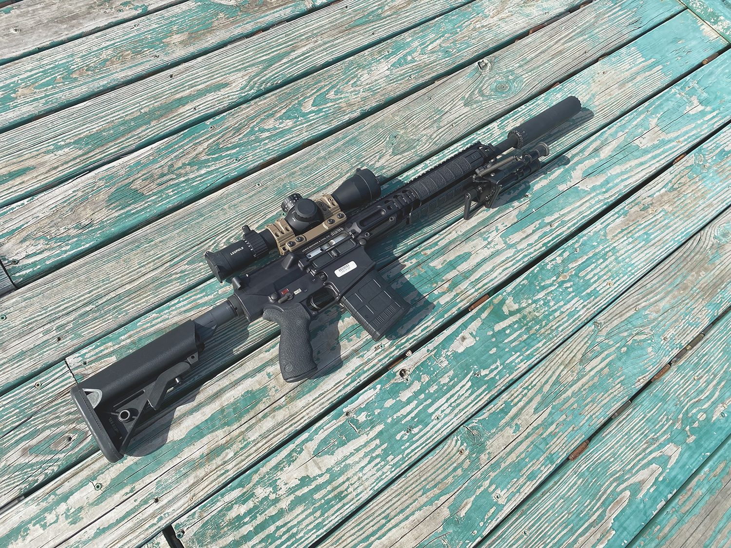

The MWS arrived yesterday. I have a spuhr 5602 waiting for the MK5 3.6-18 to arrive:
Running through the BRT gas tube configurator:
Buffer is CAR H3, but what are y’all selecting for the spring?
I called LMT and they said the factory spring is between a Carbine and Rifle length…
Thanks for the insight. Sounds like the gas tube is the way to go!
Report back once you get some shooting in. Personally, the BRT tube didn't make nearly as much of a difference when running as switching to the XH buffer did in my MWS. The combination of both is a good improvement though. YMMV, of course.

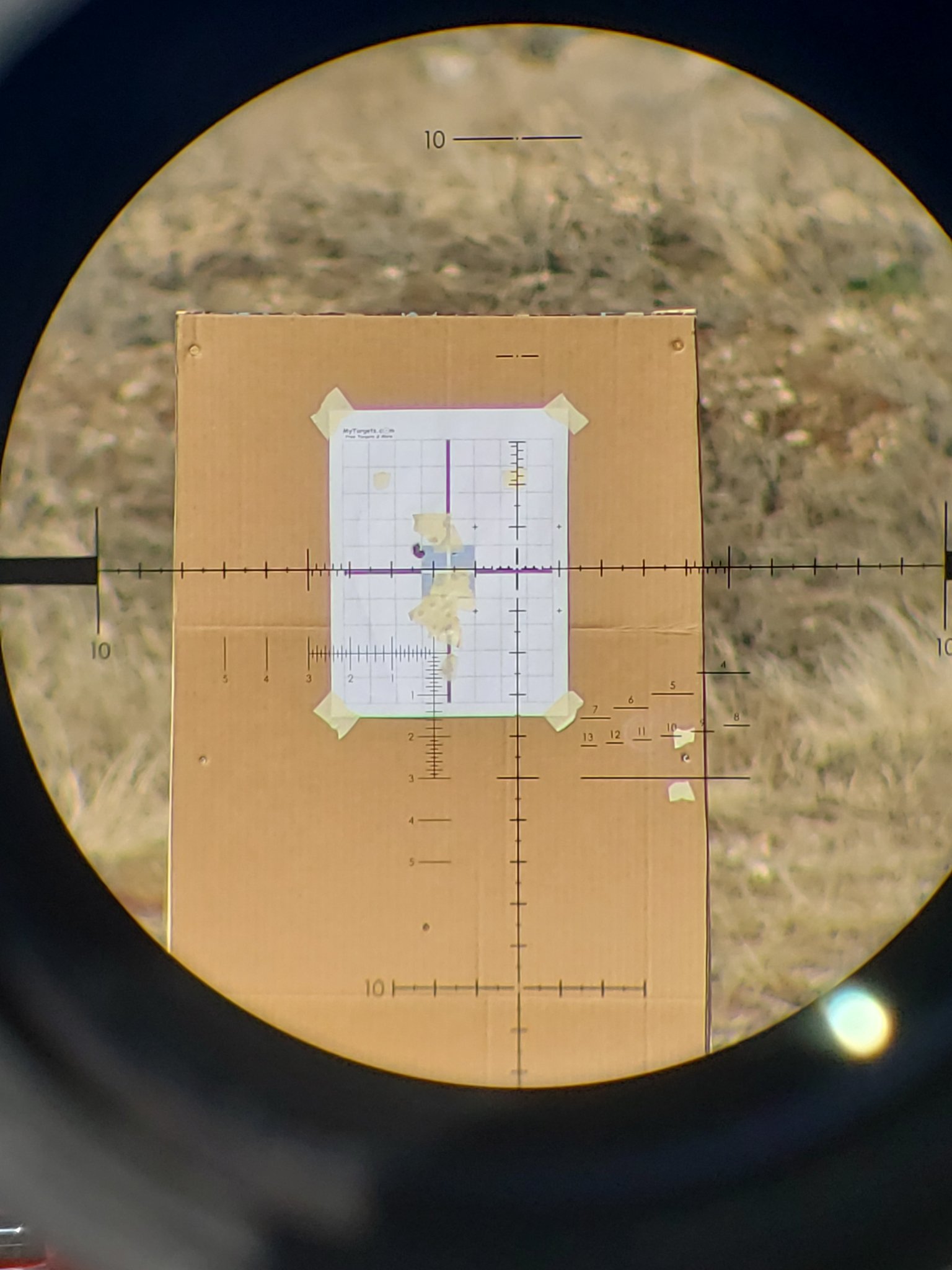

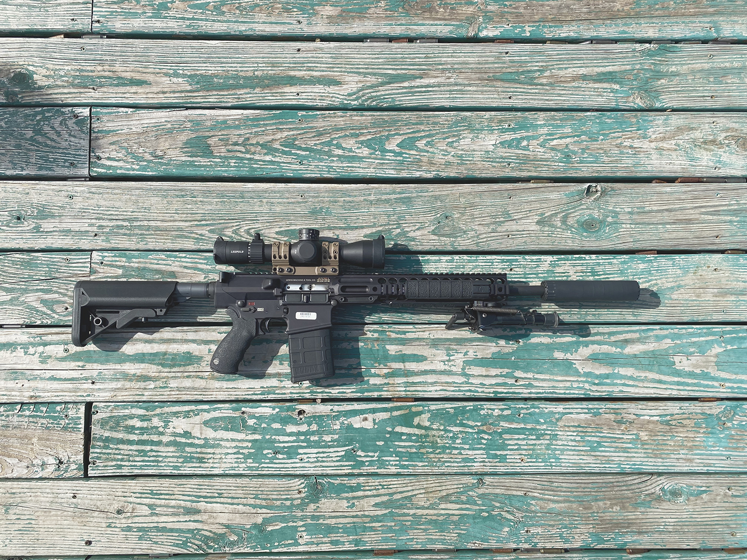

Finally got the MWS out today after getting it fitted with a Spuhr 5602 and Mk5 combo. The old man and I were ringing steel at 850 without much effort from the 16" stainless steel barrel shooting m118lr. Video below, listen for the impact.
The thing shot phenomenally well, even with my YHM Resonator R2, which didn't seem to add that much back pressure. I was originally worried and was a click away from ordering a BRT gas tube but decided to shoot it first and see how it performed. Looks like I'm getting about a 2:30-3 ejection with the can on, super happy with this result. I looped the ejection pattern below as well.

In my opinion, they are both very nice optics.
Better field of view with the Vortex, less fisheye at low power with the Atacr. I do prefer the illumination function and reticle on the Atacr though.
I've had both on my MWS and I agree, both are very nice. I found the new FCDMx reticle to be useful on moving targets at distance and very little fisheye at 1x.
With the G3, I felt the need to run an offset T2. With the ATACR, I don't.

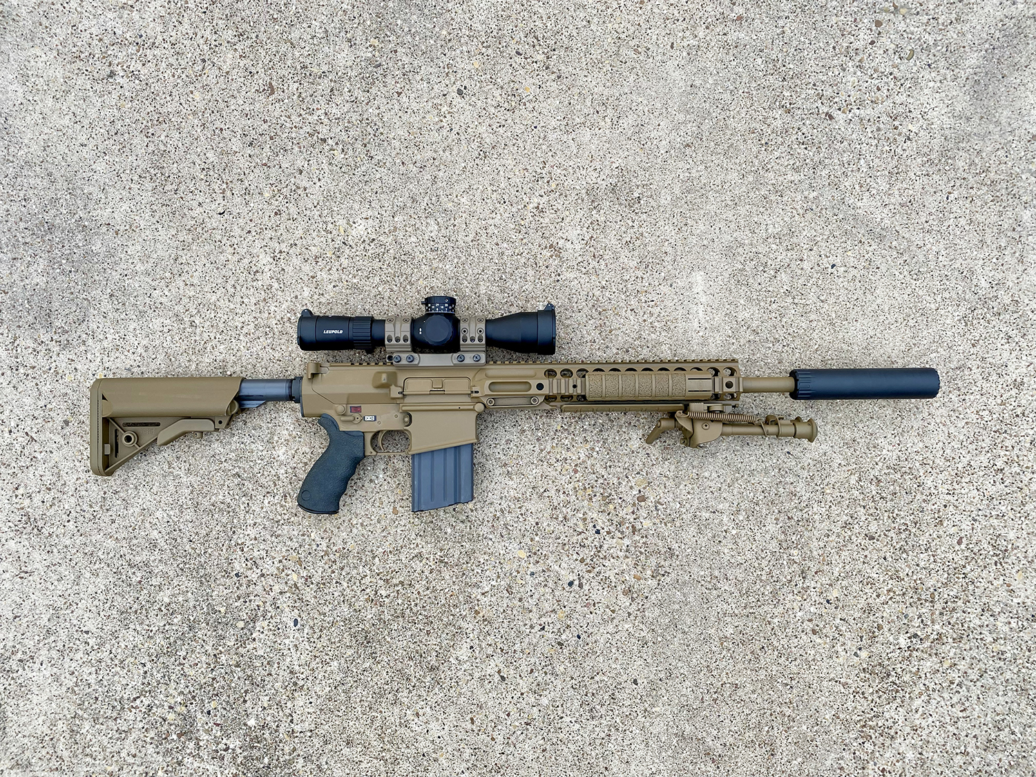

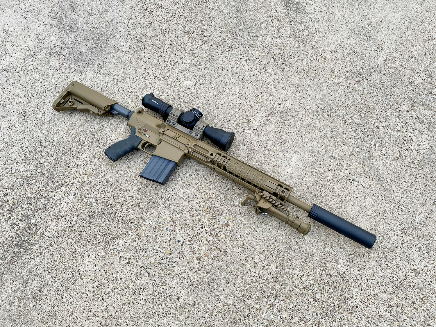

Apologies for spamming the thread recently, but I've had some fun setting this this up.
After I was able to verify the rifle could shoot, it was time for an Aervoe baptism. I think it's done, for now.

Thanks! Looking forward to getting it worn in.
Go for it. There's something liberating about spraying a perfectly fine rifle.

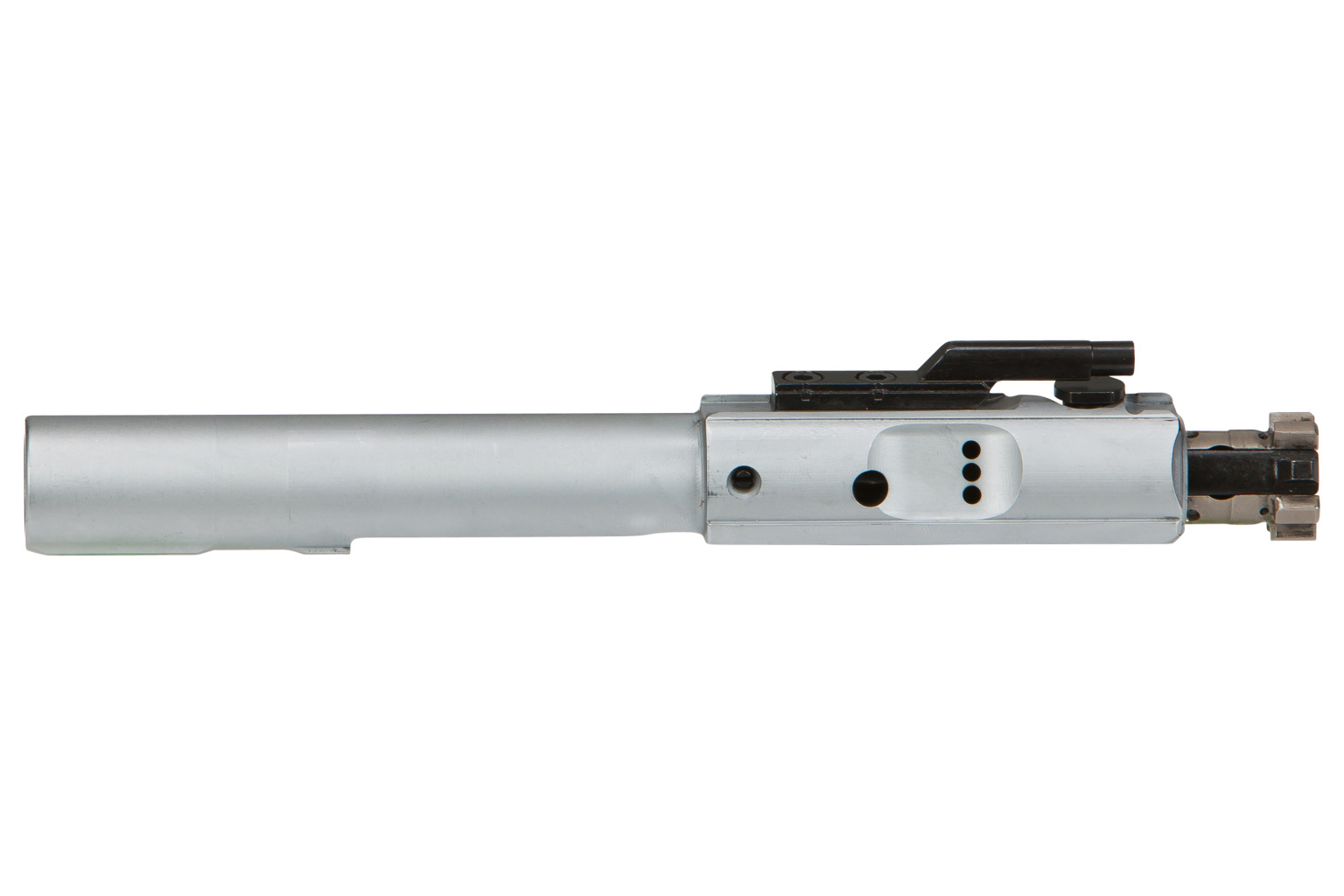

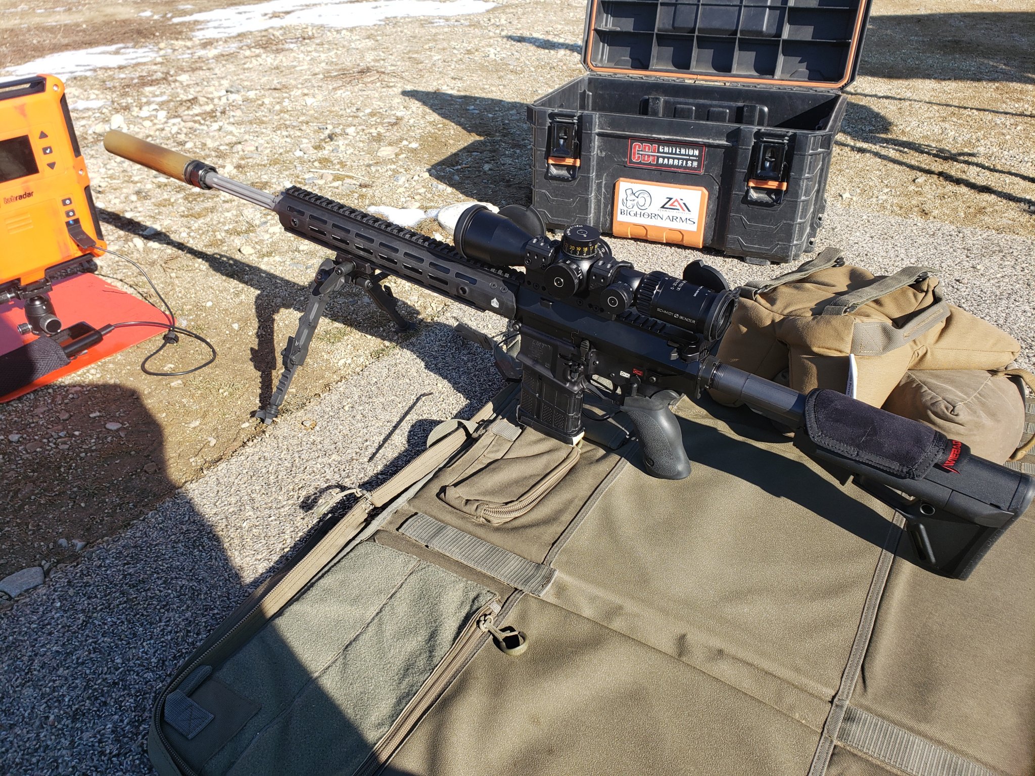

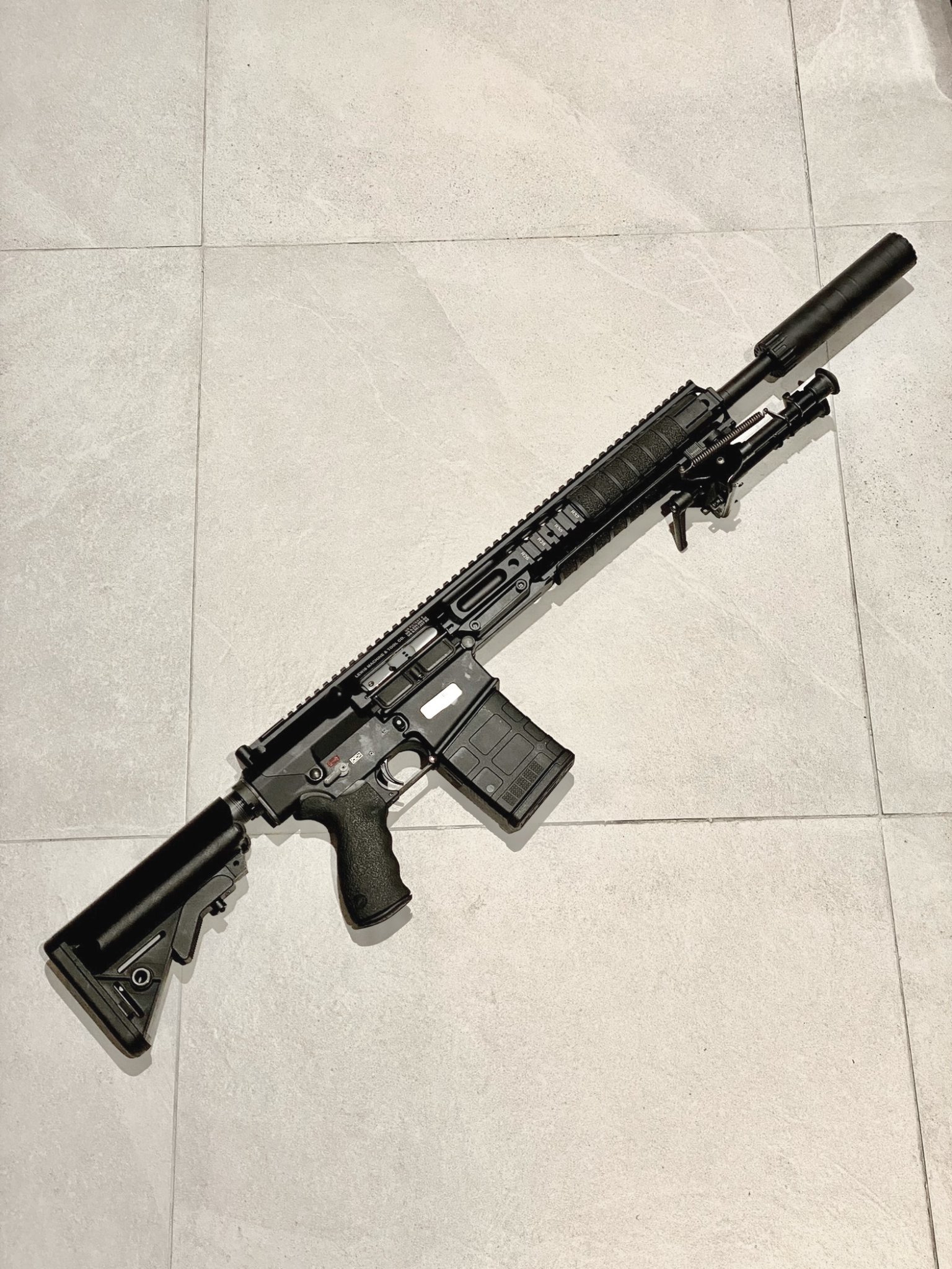

The diet continues. Dropped a good bit of weight switching to a titanium BCG and Superlative adjustable gas block.
Looks great. Curious on the stock and grip selection. I am looking to potentially swap out my LMT DMR stock for something lighter for some overall weight savings. Do you have any thoughts or preference on the Magpul SL vs the SLS version that you're running? The enhanced butt pad seems like a no brainer.
On the grip, any specific reason you went with the MOE? Curious to put a K2 on to see if the more vertical grip angle would be more comfortable. Currently have the ergo grip on but not the biggest fan of the feel.
I've used lots of SL and SLS stocks on my guns. I think the SL is a simple stock for a AR15, but the SLS has a slight bit more heft to it, so I think it makes more sense to put in on AR10's.
As for grips. I do like simple MOE grips. They feel nice in my larger hands and they are cheap. Some of the other models have weird angles or are very small, which I don't care for.

How do you like that PRS lite? Does it install on the LMT buffer tube?

Who has a LMT 308 DI BGC Bolt (Carrier Group) that they would be willing to part with? Full or Semi Auto would be fine.
I have everything but the BGC. I need entire bolt and carrier.
They selling for a little over $1000 on gunbroker. And the 5.56 version isn't selling for much less.
