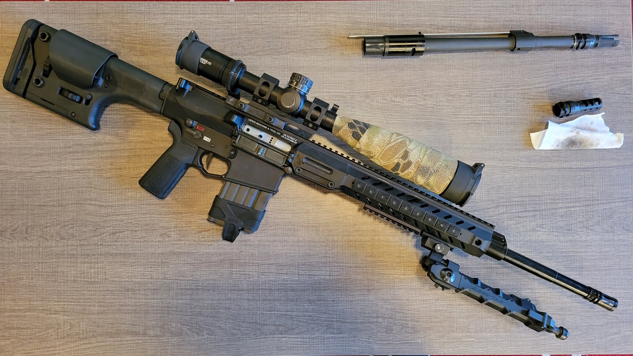

Factory 20 inch SS 308 barrel (might be fucked due to internal rust from humid storage conditions in Georgia while I was on a rotation to Korea, I need to test for accuracy again, if it is fucked then I might get a D. Wilson Proof 6.5CM barrel conversion)
Precision Armament Hypertap muzzle brake
Harris 9-13 bipod with picatinny adapter
NF ATACR 4-16x42 MIL-XT with NF mount
Geissele Hi-Speed National Match trigger
Total weight 14.8 lbs unloaded

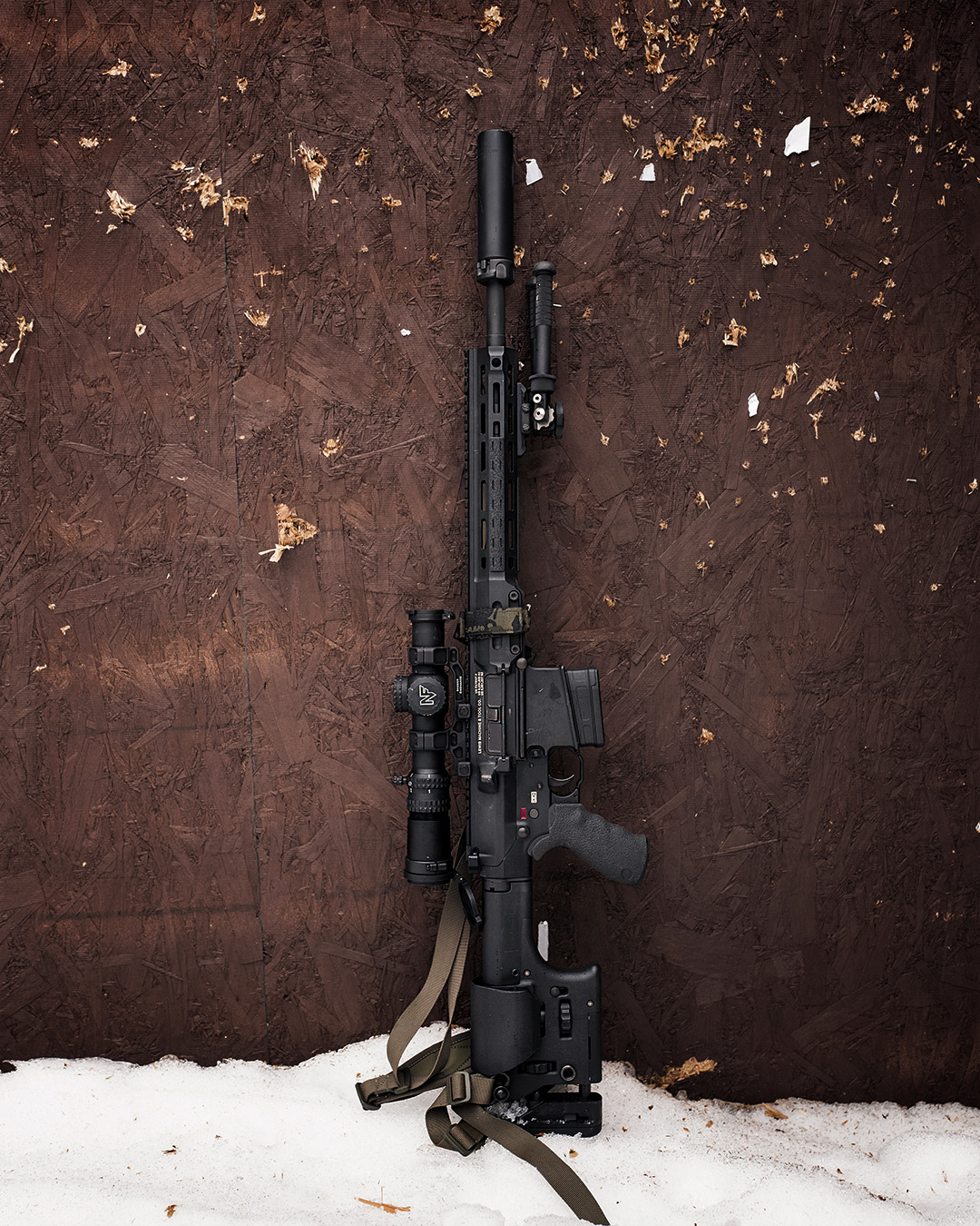

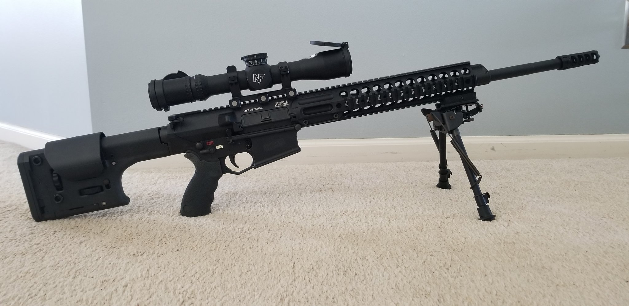

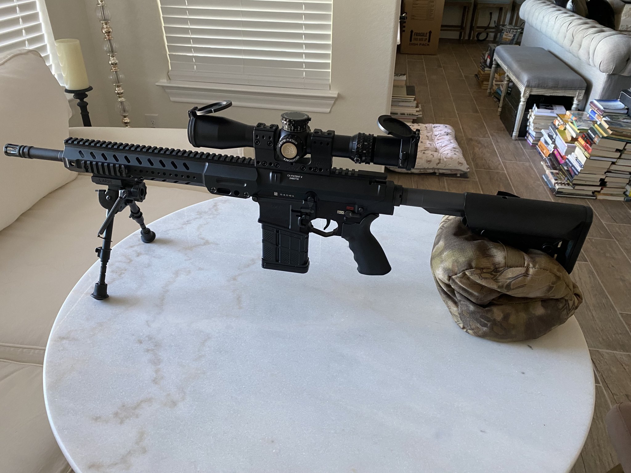

I got my dream rifle thanks to a lot of knowledge from this forum, thank you guys.
Awesome. I have a 1-8 ATACR on mine, but I feel the 4-16x42 is the best optic for this platform.

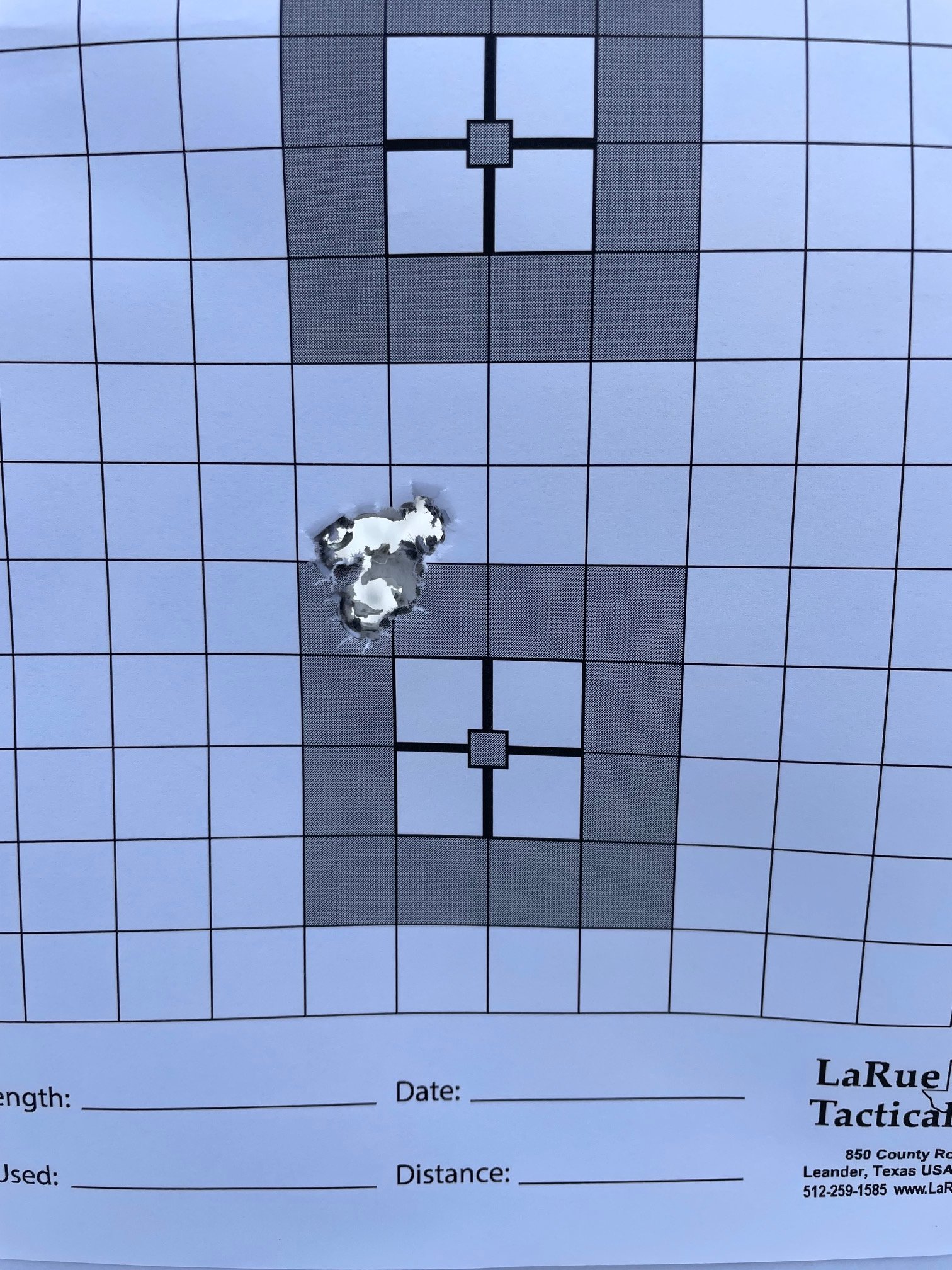

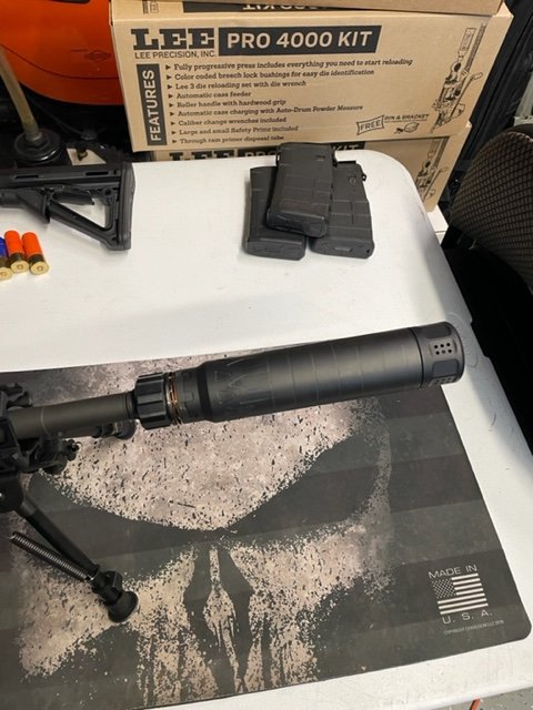

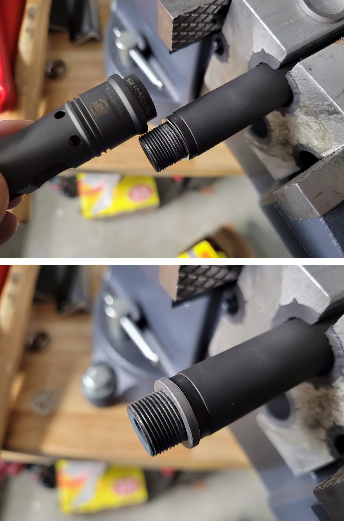

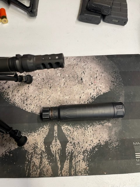

Any issues with having a bit less thread for a suppressor muzzle device?
It was concentric and shot okay (2.5" down diagonally) but just thinking about long term use.
The grey shim is required to clear the handguard with the can.
What barrel length and handguard are you trying to clear?
We aren't big fans of PA shims in our shop, they tend to crush like a crush washer. We also don't recommend ever shimming anything but the bare minimum for timing. More shims = less threads and a higher chance of mis-alignment.
16" CL barrel trying to clear the 15.5" handguard. I want to replace it with an 18" but haven't seen any available.
That's good to know about the PA shims. I was trying to avoid stacking a bunch of surefire shims, but that may be a better solution.
Without the PA shim it ends up just barely clearing the handguard. A few sheets of paper of distance from the end of the can to the handguard.

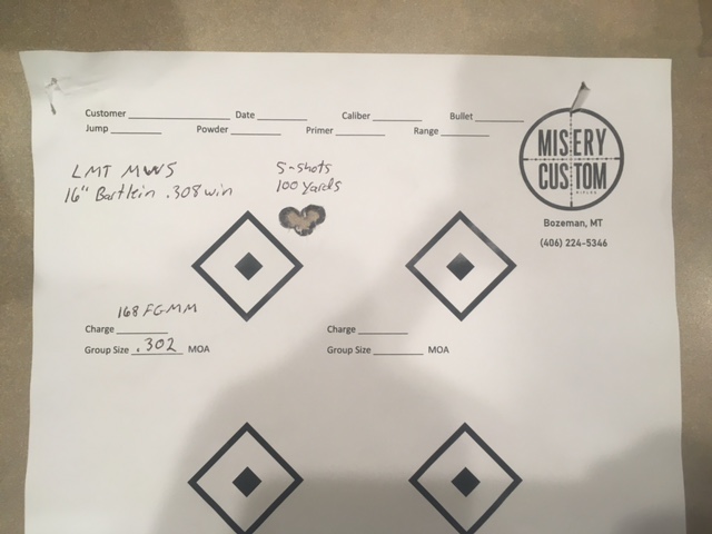

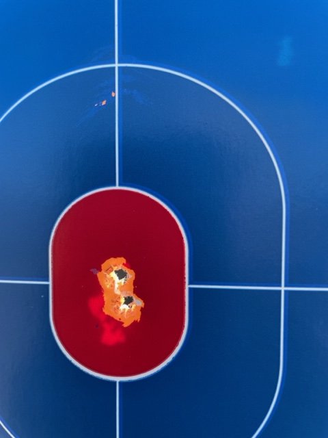

I've been very happy with my MWS. The 16" chrome lined barrel consistently shoots just under MOA and it really likes Federal GMM. I dropped a Geissele National Match trigger in it, which really helps with the accuracy control. I'm thinking I would like to put something on top besides the 1-8 ATACR.
168gr Federal Gold Medal Match

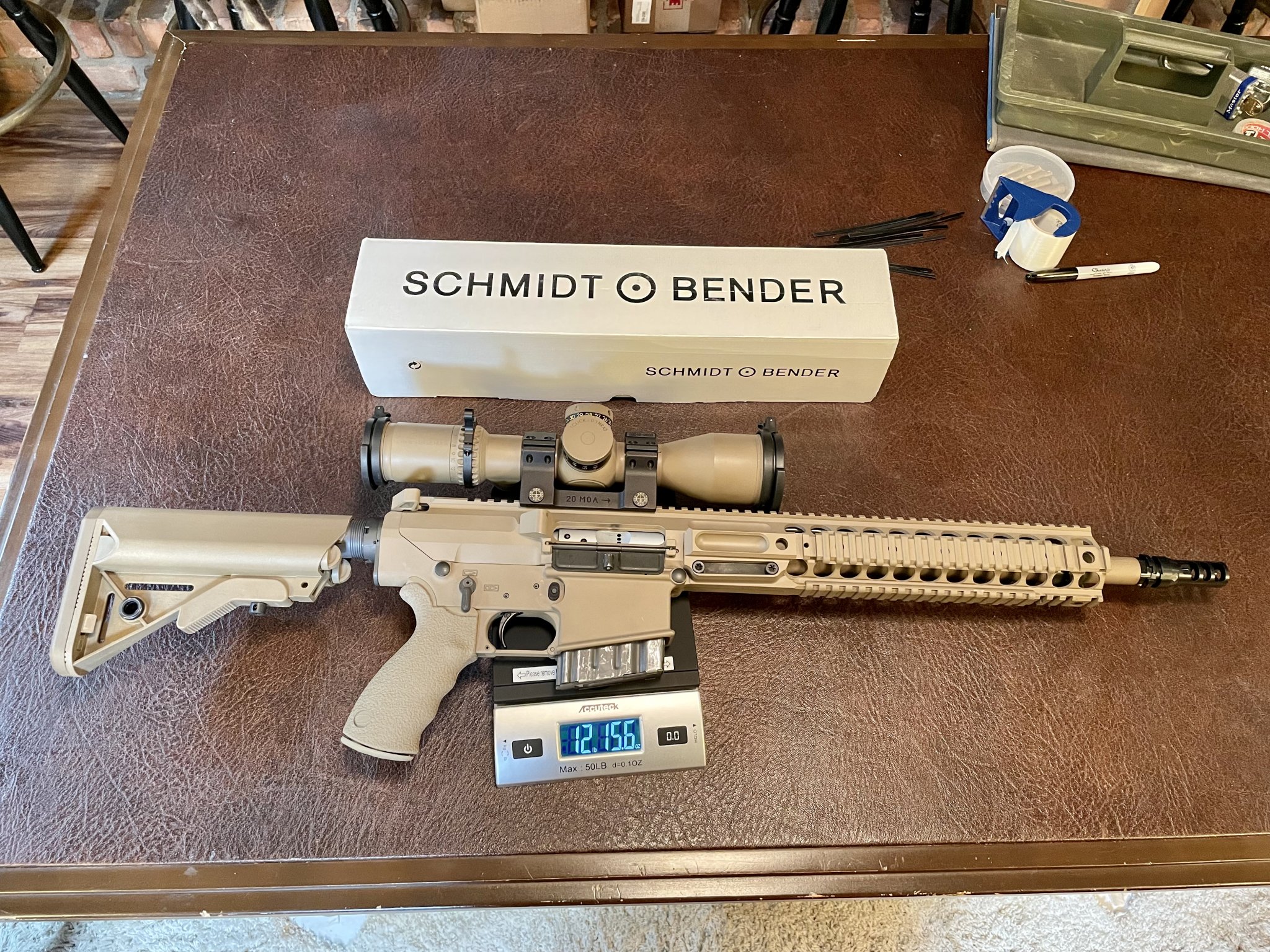

That setup looks spectacular. It's making regret getting the long hand-guard which doesn't play as well with the 16" barrel.
I noticed my 16" CL also seems to like 168gr FGMM a bit more - at least at 100.
Reactions: dogman

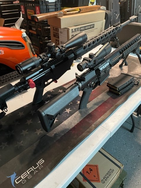

On the LMT I use the Nomad L with added DeadAir break extension. Also use the Q-Mo mounting system. The LMT operates great but it gets dirty much sooner than shooting unsuppressed.
The strike point moves lower with the Nomad L but it's a simple known adjustment now thus no issues. The sound level is greatly reduced with this configuration. I have a Nomad-TL in jail right now. Feel your pain.

Just my .02 but there’s no way I’d try to run a can with that much spacer and the minimal amount of thread engagement you’ll have. Trim the rail, get a longer barrel, run the brake only or use a different can that will fit with the rail.

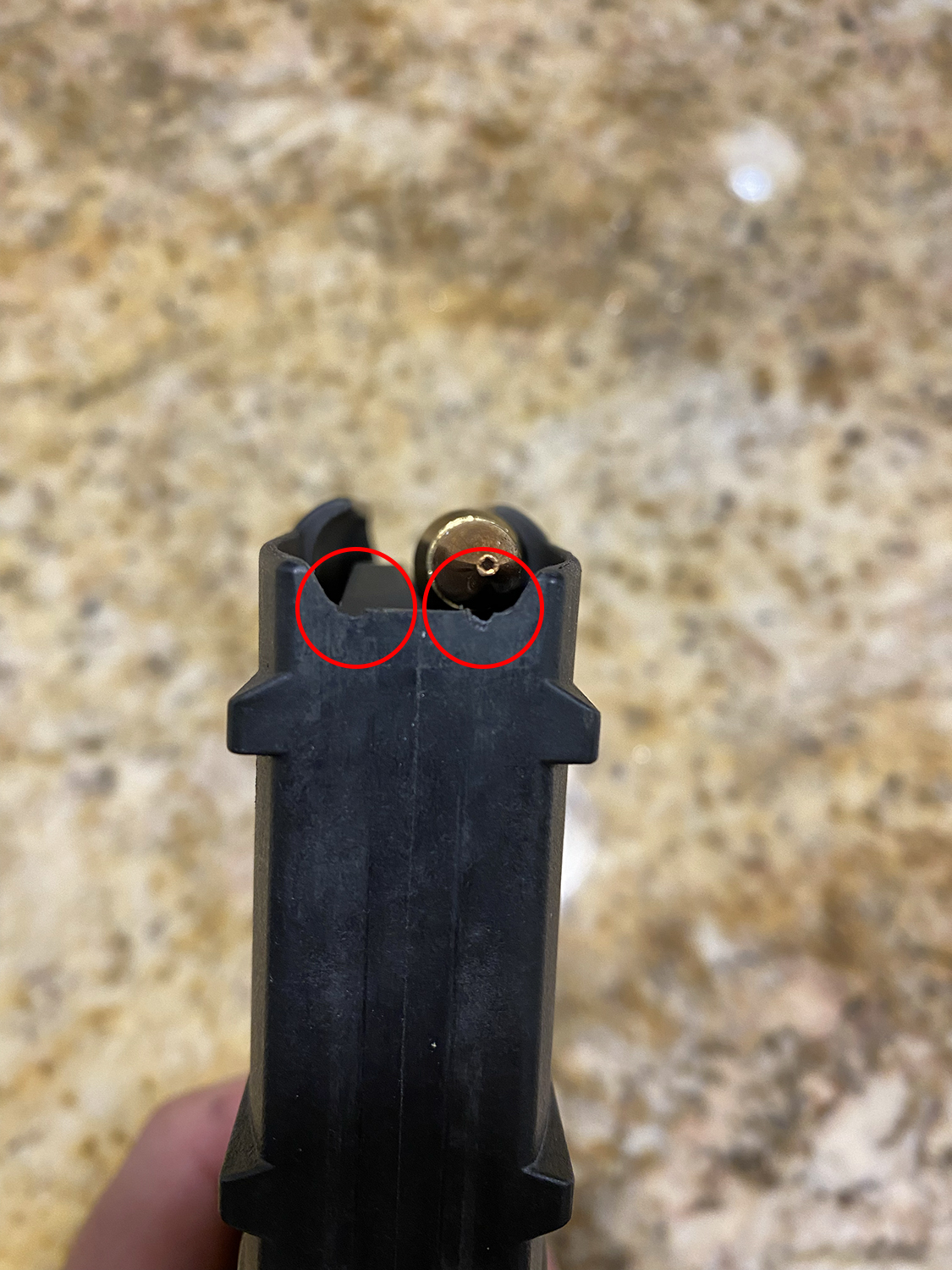

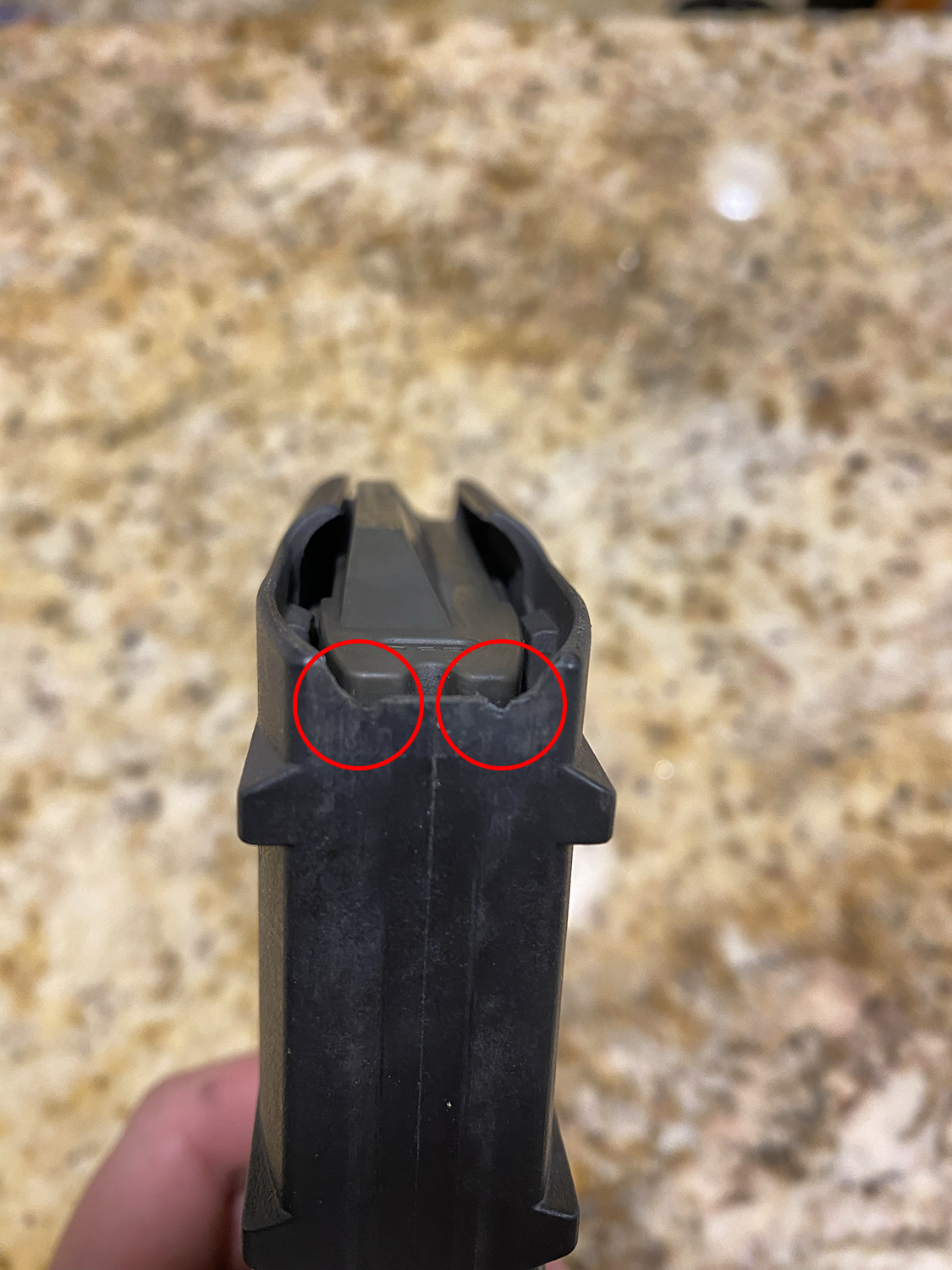

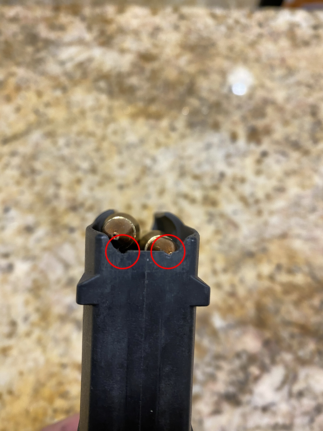

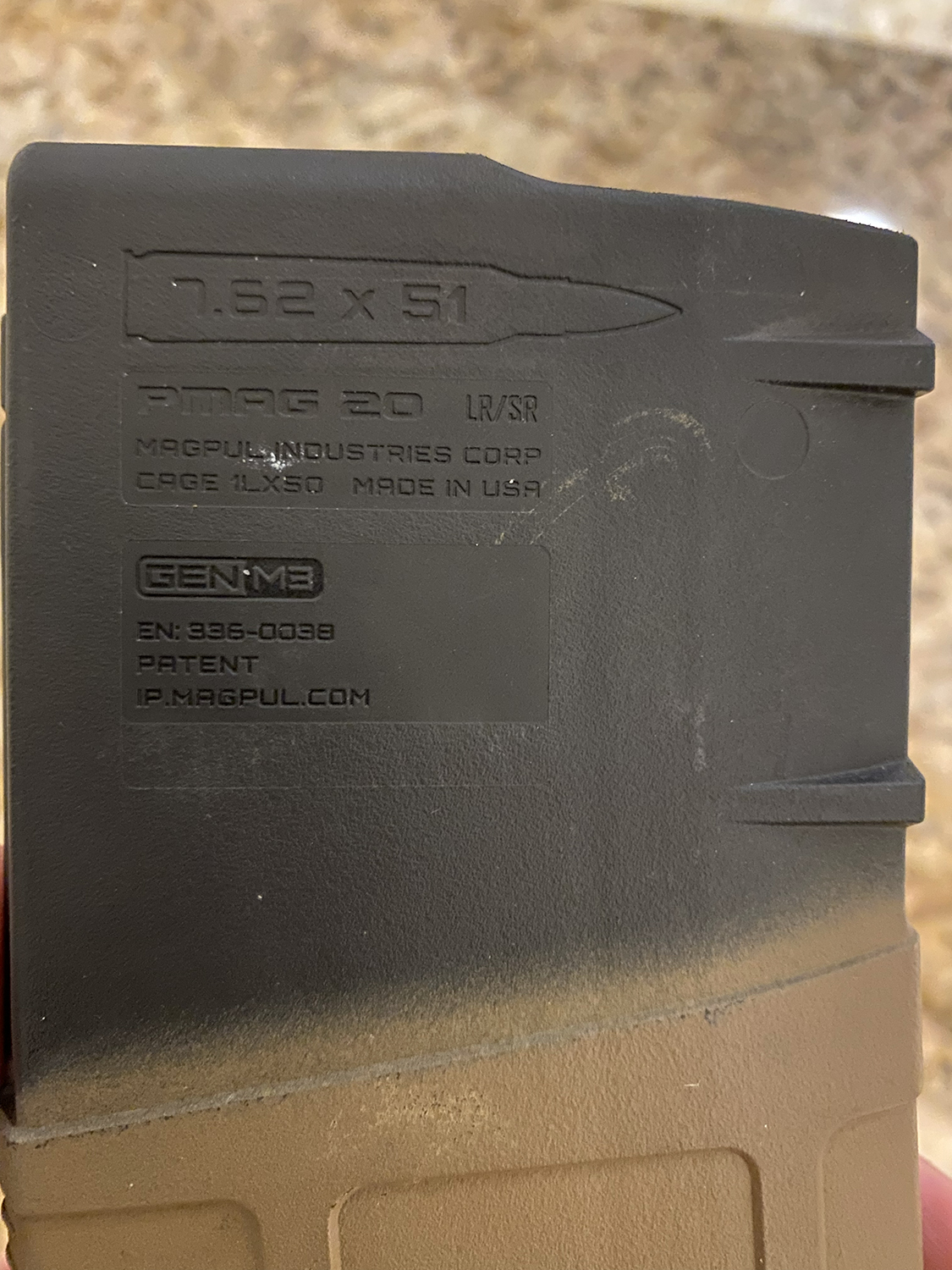

Had an issue with a PMAG today.
I noticed weak ejection, uncharacteristic of the usual 2:30-3:00 about 5 ft away pattern, when using a 20 rd pmag. The mag is new (less than 100 rounds through it, all suppressed). About 10 rounds into the mag, I had a misfeed event in which the bolt picked up the round but never made it into the chamber, rather making contact with the front wall of the mag, pushing the bullet about 1/4" into the casing.
I took the mag out and realized there was some material missing from the front lip (see pics). This appears to show that the rounds had possibly been pushed into this front section, repeadely, prior to reaching the chamber.
Has anyone seen this before? I am assuming this mag is the culprit of both the misfeed and inconsistent ejection pattern?
For the record, I swapped in a KAC sr25 mag and had not a single issue. Ejection was perfect and repeatable.

Thanks, I should have clarified. The mag in question is a Gen 3 Pmag LR/SR.
Pic:
Ive had this before as well. Way over gassed and the rounds aren't being pushed up fast enough for the bolt moving forward and end up chewing up the front of the mag. Your not seeing it on the KAC mags because they are metal and possibly slightly lower cut so the nose can clear. Heavier buffer would help or somehow regulate the gas a bit.
Reactions: t9regg
Just the first hand input I was looking for, thank you!
My ejection pattern must have been masking the issue.
Even if I have a 2:30 - 3 o’clock ejection pattern would you expect overgassing to still be the culprit? My brass is being thrown pretty far (6ft-ish)…
Yes, in my experience the duel ejectors on the AR10 bolts throw a completely different (and more reliable) ejection pattern than single ejectors that are commonly seen on ar10's.
