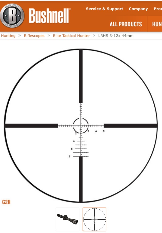

I have a lot of the same requirements. That being said, there are a few scopes that come to mind:
as mentioned, the LRHS 3-12x44 with the gap hunting reticle is very nice
Leupold vx5hd 3-15x44 with the impact 29 reticle
Leupold vx6hd 2-12x42 with the impact 45 reticle
Meopta optika6 line is coming, but reticles haven't been finalized and only the FFP have zero stops..
The LRHS is going to get you very, very close.
Now discontinued, but very much available in the classifieds.

I have a 4.5-18 LRHS and at 4.5 the donut of death is very visable. There are some illuminated versions of the 4.5-18 out there but not the 3-12 version. I like the non-illuminated LRHS more than my illuminated 4.5-18 LRSTi for hunting because of the donut on the LRHS.
What model are you referring to when you say the 3-12 version? I'm also not familiar with the "donut of death" that you mention.
donut of death

The LRHS and the Z5 BRH are about as good as it gets for a hunting scope that doesn't do some kind of ballistic reticle that only works for some hypothetical bullet, and that doesn't have a bunch of tactical/target hooey that you don't need or want on a hunting scope.
I've got a Z3 and a Z5 with the BRX / BRH reticle, get the BRH, the BRX is too thin, but I deal with it on my Z3.

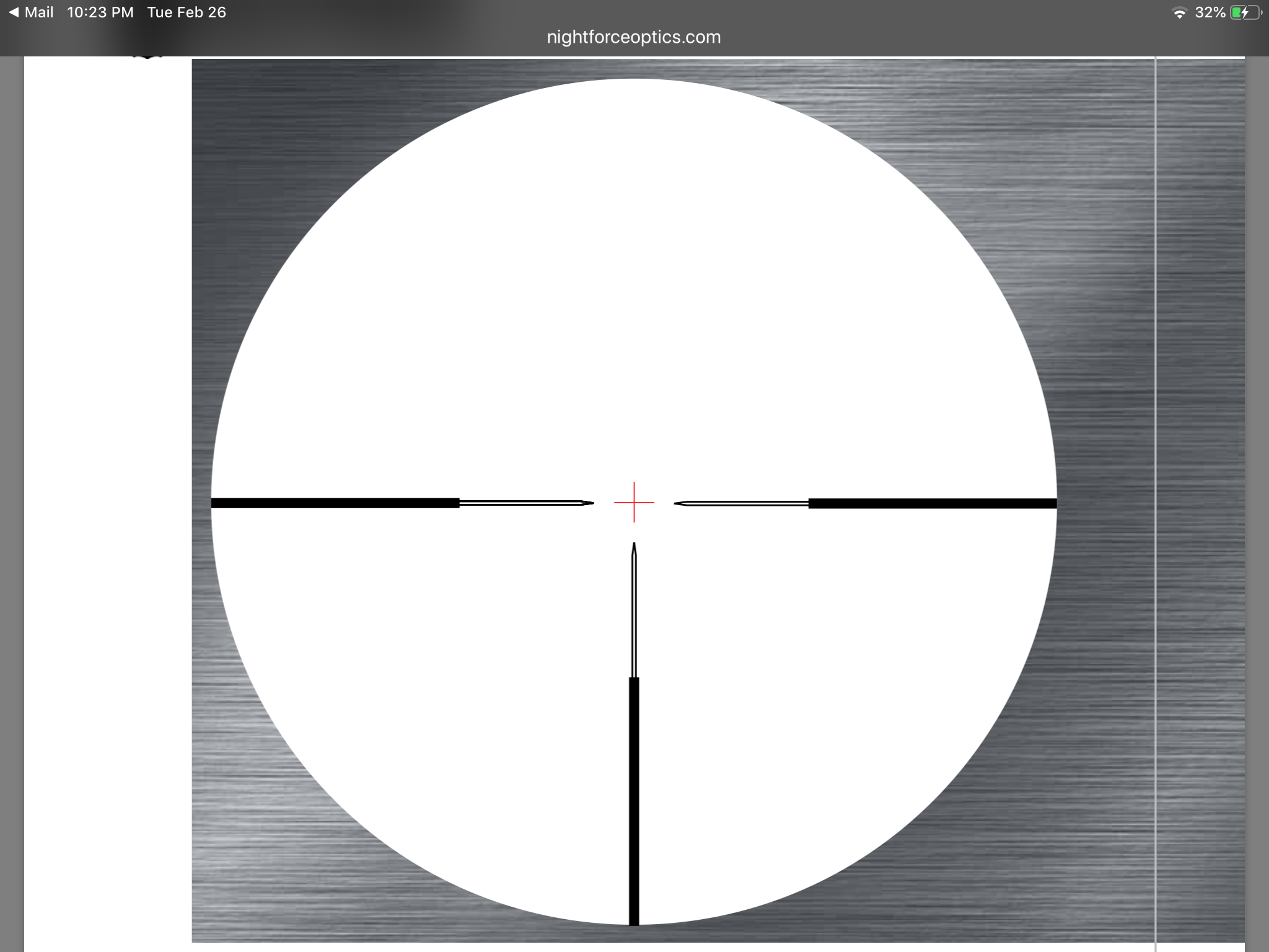

I have a Nightforce 2.5-10x42mm with the IHR that’s MOA and it works great for me. Killed a buck last year that I jumped while he was running away from me across a field more than 100 yards out while on 5x and the scope & reticle were very quick to acquire target and the deer jerky in my fridge is payback for my shelling out $2k for it...

Better look at that again....though the windage cap is also exposed, so that may be a problem...seems like it checks the rest of the boxes though
https://www.eurooptic.com/nxs-25-10...-c458.aspx?utm_source=eoic2017&utm_medium=JAB
That said I have one of these on a 5lb barrett fieldcraft that is surprisingly a 1/2 moa gun with 143 eld. Planning to run it out to 1k shortly for entertainment sake.
If NF is reading this...bring us the NXS with a capped wind knob. Keep the zero stop elevation. Bum the G2H off Bushnell, or bring out something similar. Keep the weight under 24oz. You’ll sell the HECK out of it.

The windage knob isn’t easy to turn, so you prolly have zero chance of moving it accidentally and if you do bump it and it moves a click you’re just looking at a 1/4 MOA change or 0.1 Mil so it’s not even worth thinking about. That said, if you hunt you always will check your scope settings long before you ever put the bead on a trophy...

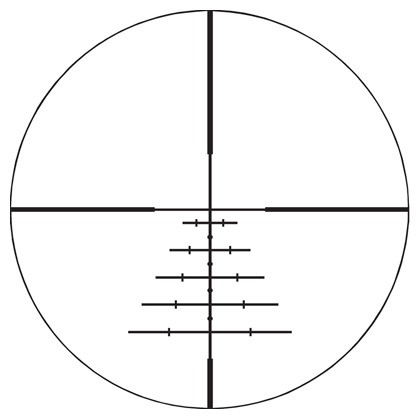

The Zeiss V4 line would check a lot of boxes. 4-16x. 2moa marked reticle. MOA turret with zero stop. Capped windage. The 4-16x models are not illuminated, but the reticle is thick enough if you have shooting light you can see it. Pretty lightweight and some of the best glass in a $1000 optic. It's what I keep on my hunting rig.
