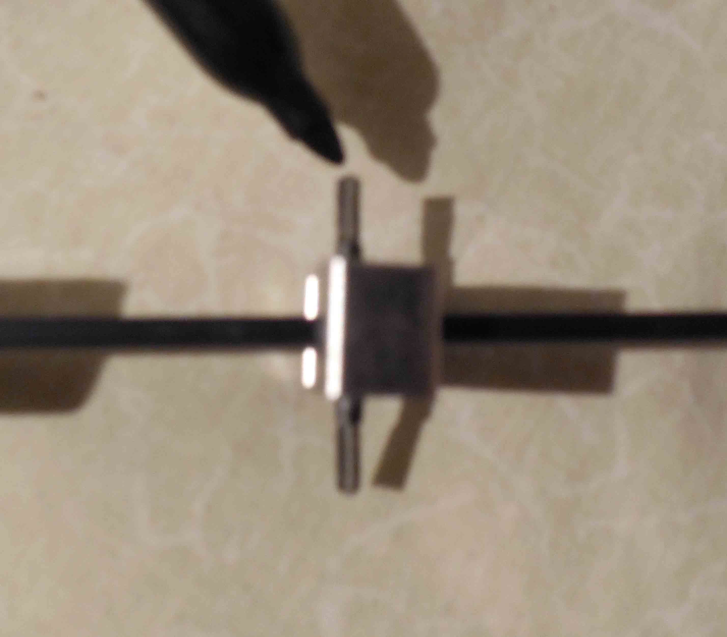

    I'm adding pics to show how I tweaked my scale a bit. I used a Smith Knife Sharpener(diamond cut) to bring the balance knifes on the beam to a sharp point! You must clean DUST out of the Quartz crystals and keep the beam posts SHARP! Otherwise, false readings every time. Make sure your beam is straight and the copper coated steel is perfectly centered between the magnets. Adjust as necessary. I have adjusted and tweaked USA and Mexico made scales. If they are tweaked right and cared for properly, will serve you great for years to come.

    I have been using that trick for about 20 years now, keeping your pivots clean and burr free is important for consistency.
    I use denatured alcohol to clean the bearings with.
