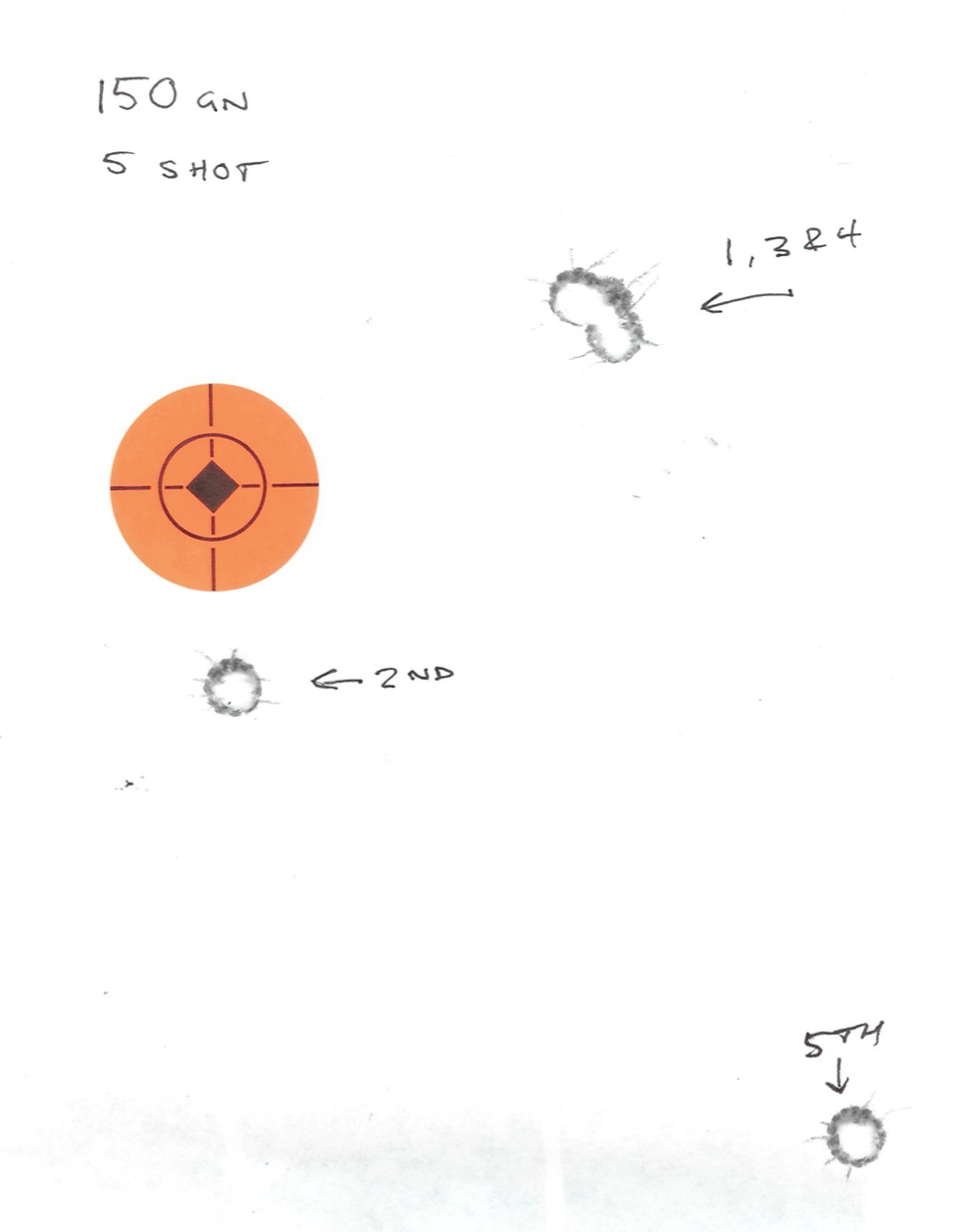

Looking for insight. Is my gun trash?
exacto
Blackland Arms
Commercial Supporter
Feb 9, 2022
480
76
NE TX
www.blacklandarms.com
Long story short, I have a POF Rogue AR 16.5" in 308 - can't seem to get it to group within 4moa with my go to round, 175smk (factory ammo). So I hand loaded some and took my lee hand press to try different seat depths.. tried 10 depths at .005" increments and couldn't get 2 bullets within 2" of each other.
Called POF and they blamed my "too hot" ammo - I never said how hot they were, actually had a lower velocity "accuracy" load per Sierra load data. So I asked what ammo they recommended and the customer service rep emailed me a list, which included the very ammo I was shooting. He also suggested I buy an adjustable gas block - if the gun needs one to be accurate, why wouldn't it come with one?
Went yesterday at lunch to try some lighter ammo with result below. I thought the barrel was just bad until I shot the 150gn and had 3 in the same hole.
After suggesting I didn't know how to shoot a semi-auto and they were different than bolt guns, he suggested the ONE cartridge to hang my hat on with this rifle is the Federal Gold Medal Match 168gr SMK... I started to order a box, but I really have no interest in owning a gun that will only shoot better than 3 or 4 MOA with ONE ammo flavor.
Any ideas??
OP, you probably don't want to hear this but POF was right. They aren't the same as bolt actions. So unless you do have experience with them, it may be you.
Has anybody else shot the rifle?
How many rounds through it now?
When you're shooting groups are you single loading or feeding from the magazine?
Any chance the bullets are being damaged by the feed ramps when mag fed?
Shooting from a bench or bipod?
Possible bad scope, loose rings, loose mount?
Some specific AR10 style platforms do really well with the lower weights than with the higher ones, based on how the barrel and gas system is setup.
Looking at your target of the 150gr stuff it looks like the rifle shoots a very tight group with that.
I'm betting with work practicing how to drive it, you won't get those flyers and could keep the whole group tight.
You might also try the 155gr match stuff and see how it likes it.
Do you know what barrel twist you have on that specific build?

Hey Mike, I hope they are right. I'd much rather it be something I'm doing that's an easy fix. I've got around 200 rounds through it. Haven't had anyone else shoot it yet, but I'll try it. I've single loaded them and magazine fed them with no difference. I've shot with bipod and rear bag prone as well as on a bench with front and rear bags. I do torque optics and mounts to spec, but haven't tried a different scope (using vortex strike eagle 3-18x44mm currently).
I will throw another scope on it and try some even lower weight bullets, as well as the POF prescribed 168smk federals - and if that doesn't work, have someone else shoot it.
Thanks for feedback!

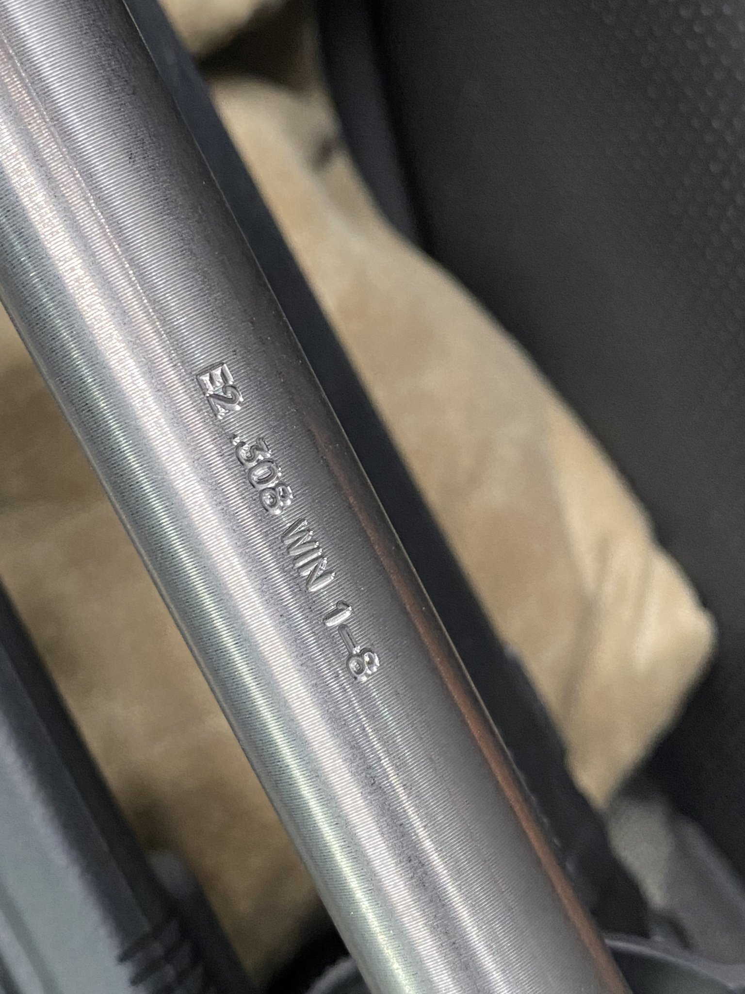

1 in 8 twist. I'm not saying practice won't fix it, but I shoot bolt guns every weekend and get consistent .2-.4 moa.. I can't imagine a semi-auto would be that different, but I guess it's possible.

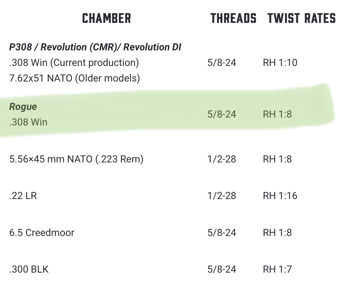

You sure its an 8 twist?
308s are typically 10, 11 or 12 twist, all of those handle the 175 smk just fine. Bearing surface, moreso than weight is the determining factor in bullet stability through the supersonic flight envelope to transonic.
Semis are challenging because they are much less forgiving when it comes to problems woth your fundamentals, ive seen my own groups look like your pic above where the cause was me. But its def worth ruling out other causes (scope, mount, issue with rifle construction, etc).
Reactions: rpoL98
Surely not 1:8. Check again. Also, I agree with having someone else shoot it and you shoot theirs if possible. If that truly is how inaccurate the gun is with factory 175 SMK, then it is garbage and POF should make it right.
Reactions: exacto
A semi-auto .308 is a very different beast when it comes to shooting well than a bolt gun.
That being said, you might want to verify that twist rate, if it's legit 1:8 as mentioned above, probably needs to be swapped for a 1:10 or similar.

That twist rate is stupid fast, on the podcast Frank even mention 1:8 being bad for 300PRC (I think, memory getting old) in 308 its gotta be bad mojo.

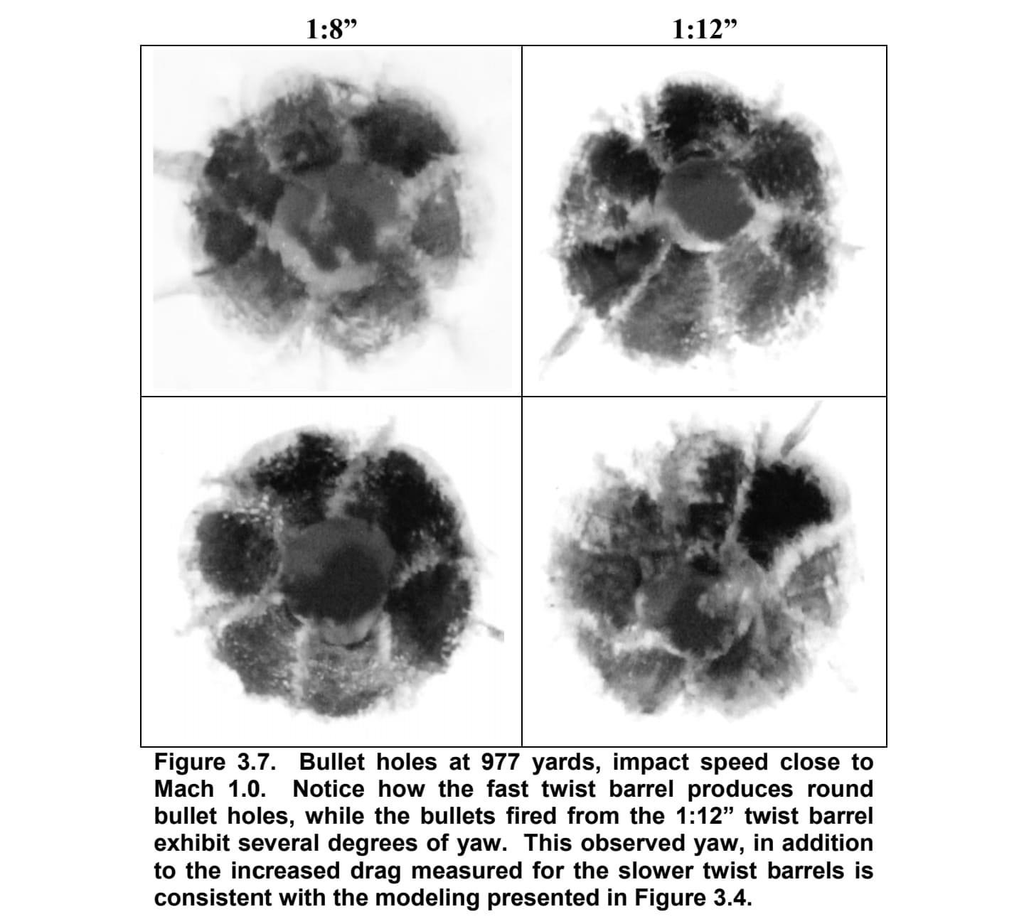

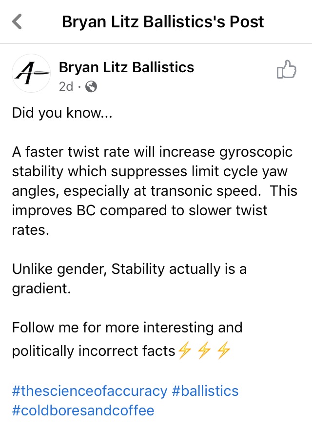

Some clown named Brianna Lipshitz or something just had an informative post about tight twists, including the 1/8 in a .308.
Never heard of her, apparently some science nerd about bullets and stuff.
End says you need a level. Do you have a level
So maybe POF is at the front of things and yall are Fudds?
Likely
Apparently my search fu is weak. Link o master?
Reactions: rpoL98

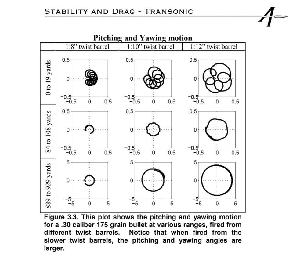

Lower drag is not the same as lower dispersion.
Rotational velocity is squared in the equation that determines eccentric imbalance forces, and it has a negative effect on dispersion. Every bullet has some level of eccentric imbalance. It doesn't take much imbalance to cause problems, and spinning it faster exacerbates them.
There are also issues with terminal performance windows & bullet integrity with uber-fast twists.

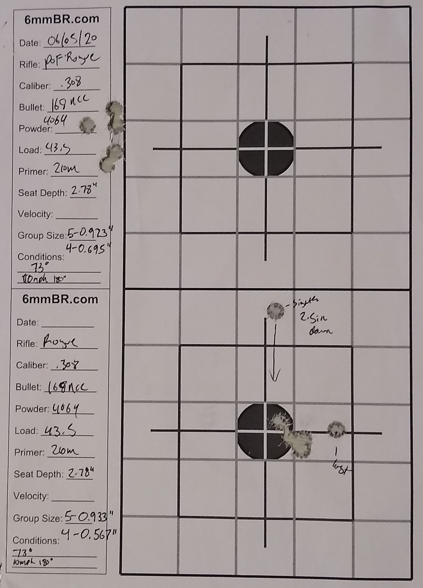

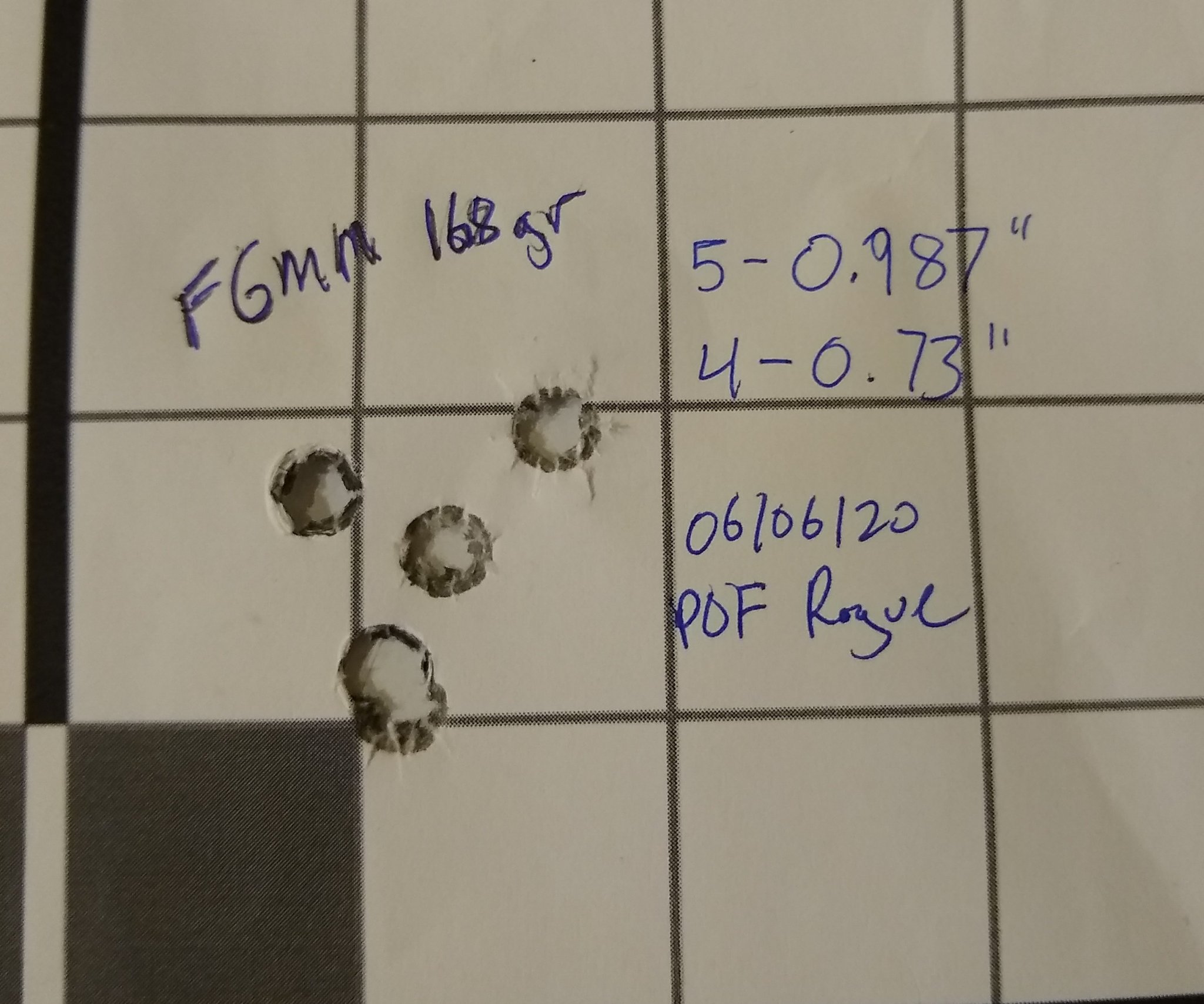

The Rogue really does have a 1:8 twist, and always has, that didn't keep mine from grouping better than I figured a sub-6lb naked .308 semi should. It is definitely work shooting a .308 semi that light for groups, not much in common with something like a PRS rig.
I don't know if it's the shooter opening it up that much, but it could be flinch or something if you're putting 3 in a hole and two off yonder.... or something could be loose.
If you're wanting a load to try, mine did well with 168gr over 43.5 of 4064 (a solid load over multiple rifles for me), and with the aforementioned 168gr FGMM.

Perhaps I got hoodwinked with this and its all BS.
Have not had time to correlate with his website or confirmed written stuff. Yet.
The dig on the gender fluid was funny too.

This is a real thing. I’ve watched 12” twist .308s come apart at about 800yds for decades now when spotting for shooters. Repeatable and predictable shot placement on steel is no problem out to 750yds, then at 800yds, a dispersion opens up and you can’t get predictable hits.
It’s why they went to 11.25” twist on the M24 (shooting the old M118 173gr FMJBT target bullet), which still isn’t ideal for a shorter barrel.
Conversely, I’ve seen the impact profiles of 7mm and .338 bullets that didn’t nose over after passing through their maximum ordinates, which then came down through reactive aluminum silhouette targets at a high AOA, but still had predictable impact at 1100-1300m. They went through like a keyhole profile, but consistently nose-up. Those had tight twists.
So the 1/8 rifling is ideal for a 16” .308 Winchester, not an accident or production shoehorn cost-savings measure. If I was custom-building a .308 Win, it would have a minimum of a 9 twist. A 16” .308 with a tight twist has consistent POI from 800yds on out, whereas a 24” 12 twist does not.
This is why I was going to do a 6bra build for the summer when I go out to a range that has steel to 1,300, right around 800 it seems the 308 runs out of gas.
So with a 1:9 a 308 would be good to range? There no free lunch, so does this mean my damn near able to pass the barrel on to my grand kids 308 is going to eat barrels like a 6mm now?
.308 Win case diameter to neck diameter ratio is so low, that it doesn’t stress throats as much as overbore cartridges run at high pressure, hence the long throat and bore life. Twist rate will have minimal effect on that.
6.5 Grendels have 1/7.5 to 1/9 twists, and even longer barrel life than .308, with more overbore, but lower working pressure.
