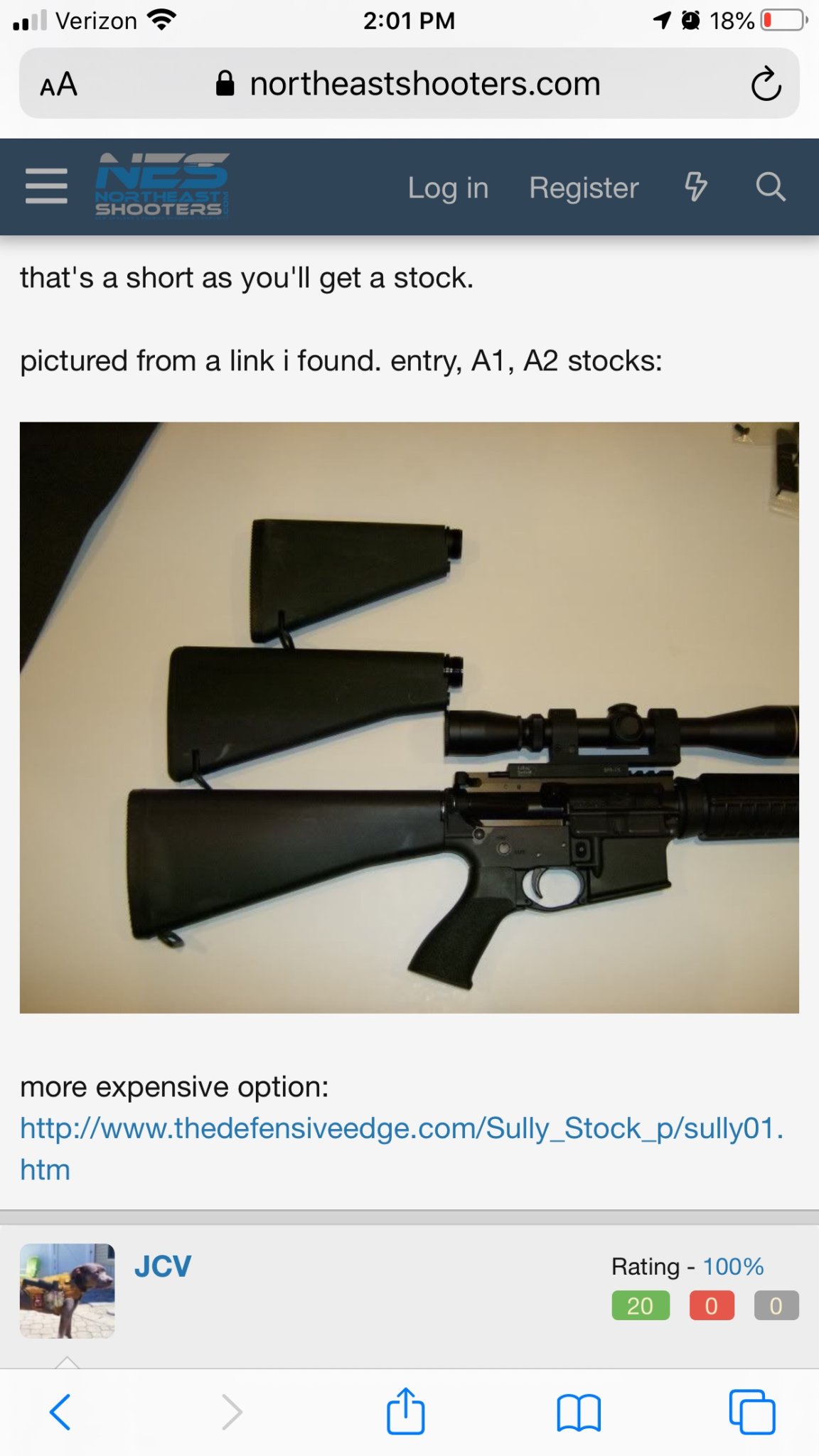

Here’s one (not even sure if there’s an A1 stock in this pic):
It appears the A1 is 12.875” and A2 is 13.5” (I did find a number of posts about the A2). But some say the A2 has a 13 5/8” lop.
I’m not sure why there’s a discrepancy other than maybe people have triggers that have a slightly different resting position? Not that 1/8” matters that much, but it’s nice to know.
Can someone verify these numbers and add the LOP for the entry stock?
Visually, for those noobs who are learning snd don’t know what I’m talking about, here they are below.

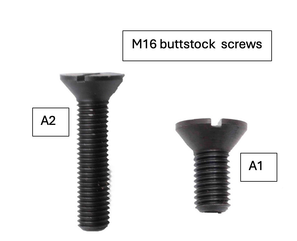

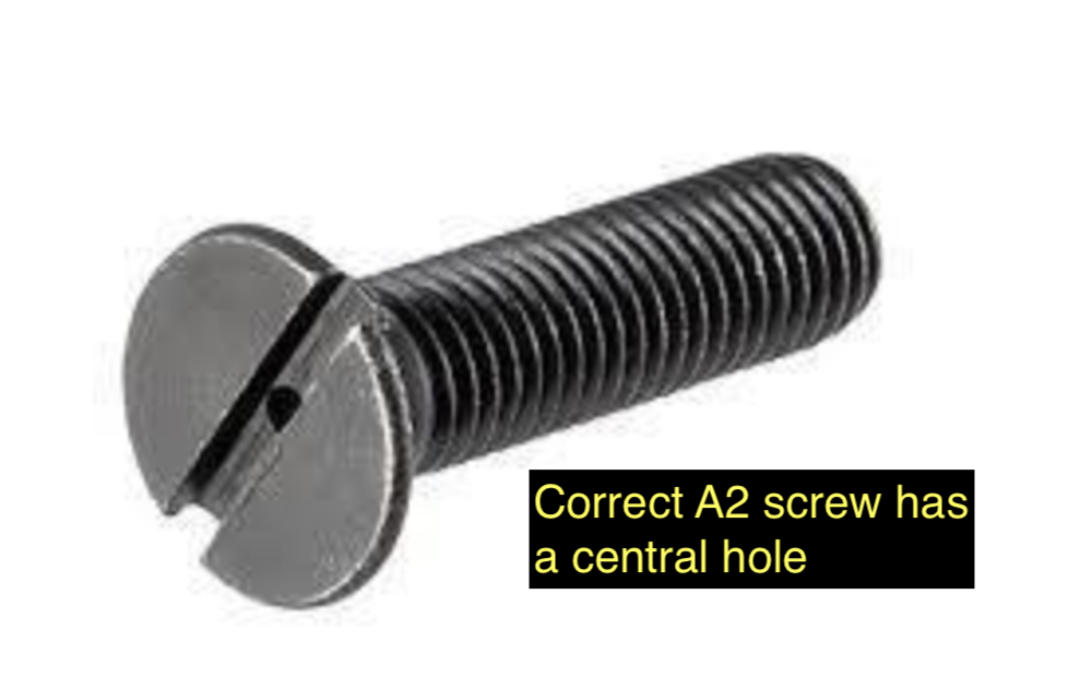

The original AR15/ M16 (with rubber butt pad) used a single screw (with no drain hole in the fastener) to secure the pad and fiberglass (Colt) buttstock into the single hole in the rear of the receiver extension (buffer tube). Later a short style screw with a drain hole was used.

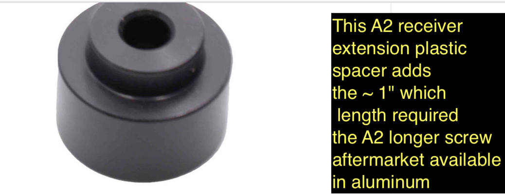

The M16A2 was adopted in the mid-1980’s, it had a length of pull ~1” longer than the A1(LOP ~13.25”) however the receiver extension was not lengthened. The A2 used a plastic spacer (available in aftermarket aluminum) to make up the difference in length thus a longer single screw with an integral drain hole, was then necessary to secure the butt plate to the receiver back surface.
