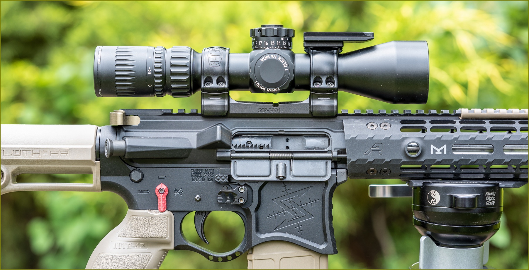

    If "short" is your forte, it's pretty clear which scope wins that challenge, but what is surprising is how compact Vortex kept their 1-10x24 as it is essentially the same size as the 1-6 scope. SAI uses a 30mm tube while the Vortex has the larger 34mm tube and while March's tube is 30mm there is no space to mount in front of the turret housing and March is using a 33mm diameter bell which will require a special mount. Audere (a specialized manufacturer in Italy) happens to make a mount and March has assured me they objective bell is strong enough for this mount. If you'd rather not use this style mount, some have used Aimpoint Pro mounts like the one from Scalarworks, but I put up two of my ARC M10 rings and they will both fit behind the turret housing as the picture below shows.

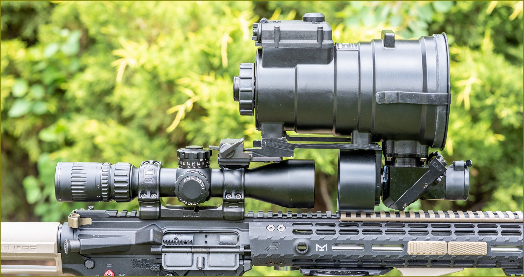

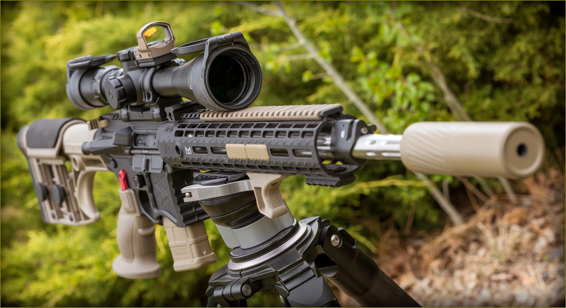

    Here's how the scopes setup on my MDRx
    Ignore the mount, it was my only 34mm mount at the time but clearly this would need a cantilever mount if I had kept the Vortex

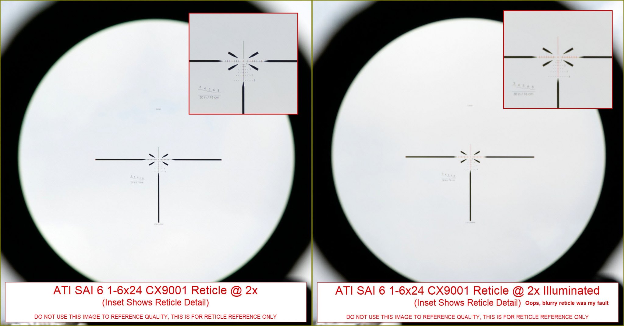

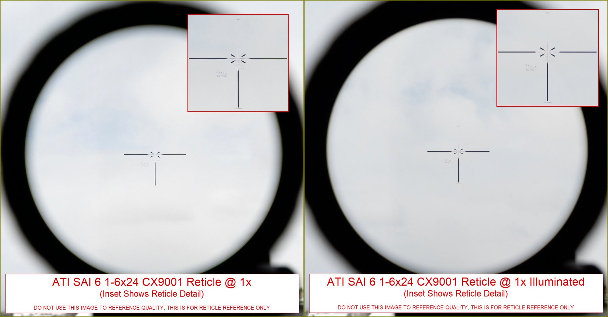

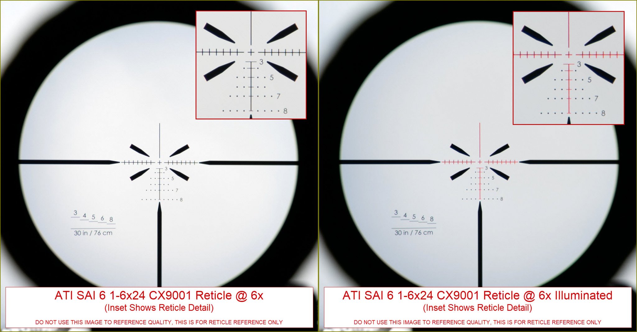

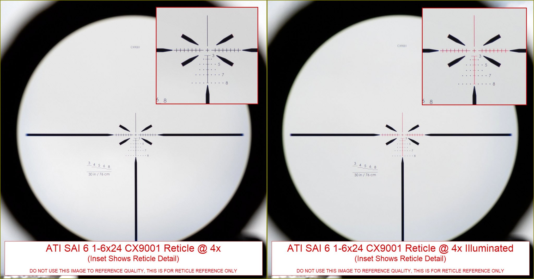

    So why the SAI 6 when it's only a 1-6, to be honest it was the reticle, I really liked their outside the box thinking with the design and especially for quick short range work without illumination, while most manufacturers opt for a horseshoe style SAI went with four bullets that point toward center. I need a lot more time with the scope but I think it's going to be a benefit for sure and I really like the fact that their BDC goes out to 800 meters, which brings us to the Vortex and the EBR-9 MOA BDC reticle which was clearly designed for 5.56 work as it only goes out to 600 yards, if you intend to go further than 600 I highly recommend the EBR-9 mrad reticle which is a very well thought out reticle, but for 600 and in the Vortex design has the traditional LPVO BDC reticle features but with a different style illuminated quadrant (more on that later). At first glance it appears March is using a standard mil hash reticle but in reality they are using a dual focal plane design, the center (illuminated) dot and the main crosshair stadia are in the second focal plan while all the mrad hash marks are in the FFP, that being said the March is not a Christmas tree design and I wish it was but it doesn't sound like that will be an option with dual focal plane, I think we will end up seeing a tree but it will be FFP only.

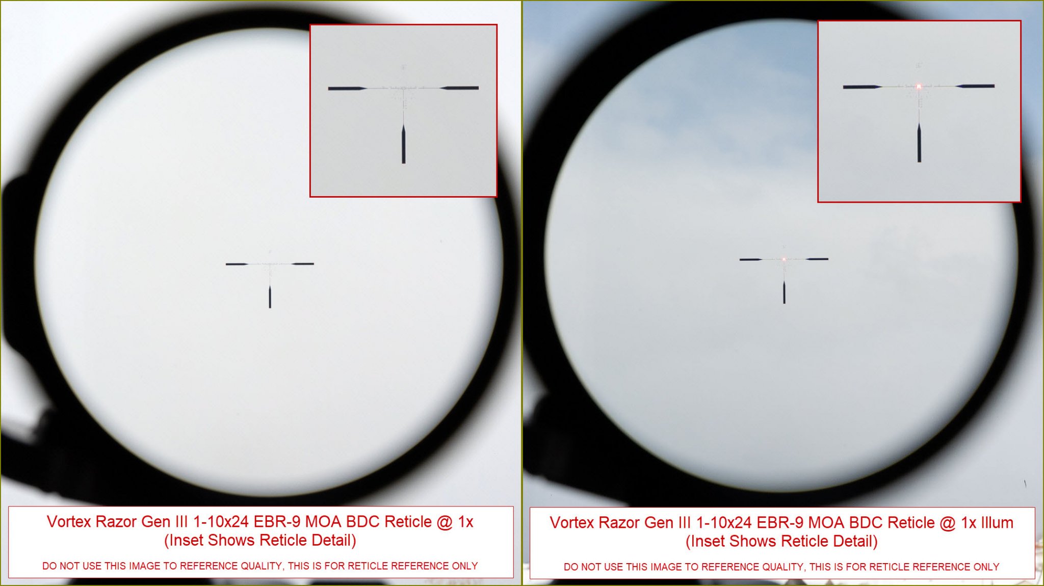

    ILLUMINATION​
    Outside of the reticle, illumination may command the most attention feature wise and in this category Vortex hit a home run, their illumination module and reticle etching is the best I've seen, if you prefer how bright RDS sights are then you'll be pleasantly surprised with the Gen III, their illumination is nuclear bright and at the highest setting is really too bright even in full sunlight, I turned my down a few notches and felt it was more than adequate. While March and SAI are not nearly as bright as the Vortex they are what I would call "daylight bright" meaning that you can see the illumination in full sunlight. ATI decided to illuminate the full center cross but not the wind dots, while March chose to only illuminate the center dot and nothing else. While March is not really known for their bright reticles (something they could improve upon) the center dot in the DR-1 reticle is surprisingly bright. If your intended purpose for an LPVO is to shoot mostly at 1x then Vortex has the advantage with the brightest dot in the business, SAI's CX9001 reticle with the four bullets pointing to center are another big advantage when using low magnification as the brightness of illumination doesn't quite cut it for me (at 1x). At 1x the March's center dot illumination is visible.

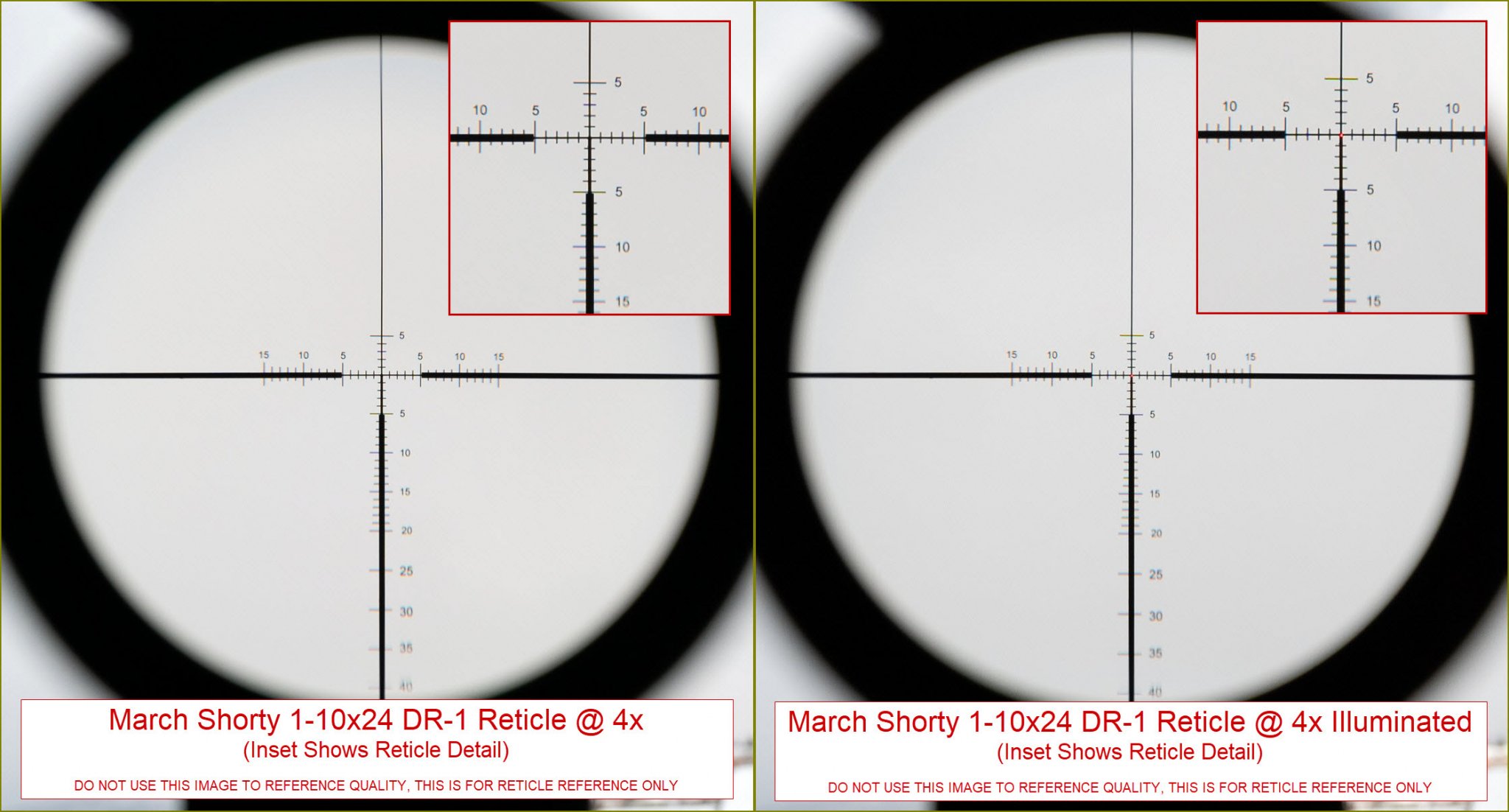

    March has really been upping their game lately with short scope designs that perform very well (something that is difficult to do). Kudos to Vortex for their brilliant illumination and shaking things up with a very capable 1-10 design. And brilliant move from ATI by introducing a budget conscience scope that takes the tried and true 1-6 design and improves upon it with a cleverly designed reticle.
    In the next couple posts are the through the scope images, please keep in mind these are meant for giving you an idea of what the reticle and illumination look like at different magnifications, please do not use these as an idea of IQ. Also, in some of the images you will notice that the reticle starts to blur towards the periphery of the sigh picture, keep in mind we are using an optical system which has it's own issues taking images through another optical system. While some blurriness was noted during testing, it was not as bad as the images show and I found all these scopes gave an acceptable level of IQ both for the reticle and for the test targets.
    All images were taken with a Nikon Z6 DSLR with 24-70 f/4 lens set to 28mm. I used manual exposure mode and fixed ISO to ensure the camera did not adjust, with each scope you will begin to notice some brightness falloff as the magnification gets larger, this was barely noticeable to the naked eye because of our eyes ability to compensate for varying light levels, also the sky was overcast mostly and light was changing but I was doing the best I could to get all images shot within a reasonable amount of time. What I found was that illumination was brighter to my naked eye than it appears my camera (sensor) was able to pick up so keep that in mind, illumination appeared brighter than these images show.
    If you notice the inset image seems to have a darker background than the main image it's because my software modified the blackpoint when I created the proof images, this was not my intention and I'm too lazy to go back and change them all over again so please accept my apology.
    ALL ILLUMINATION SETTINGS IN IMAGES WERE AT MAX FOR EACH SCOPE

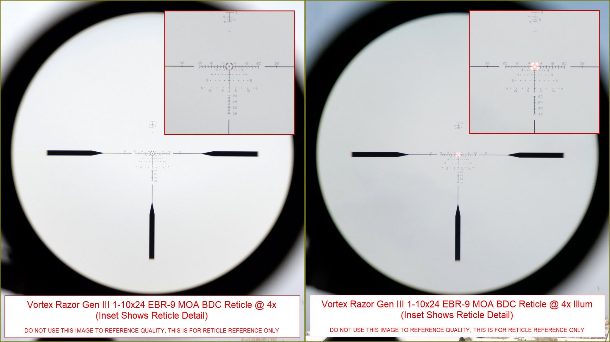

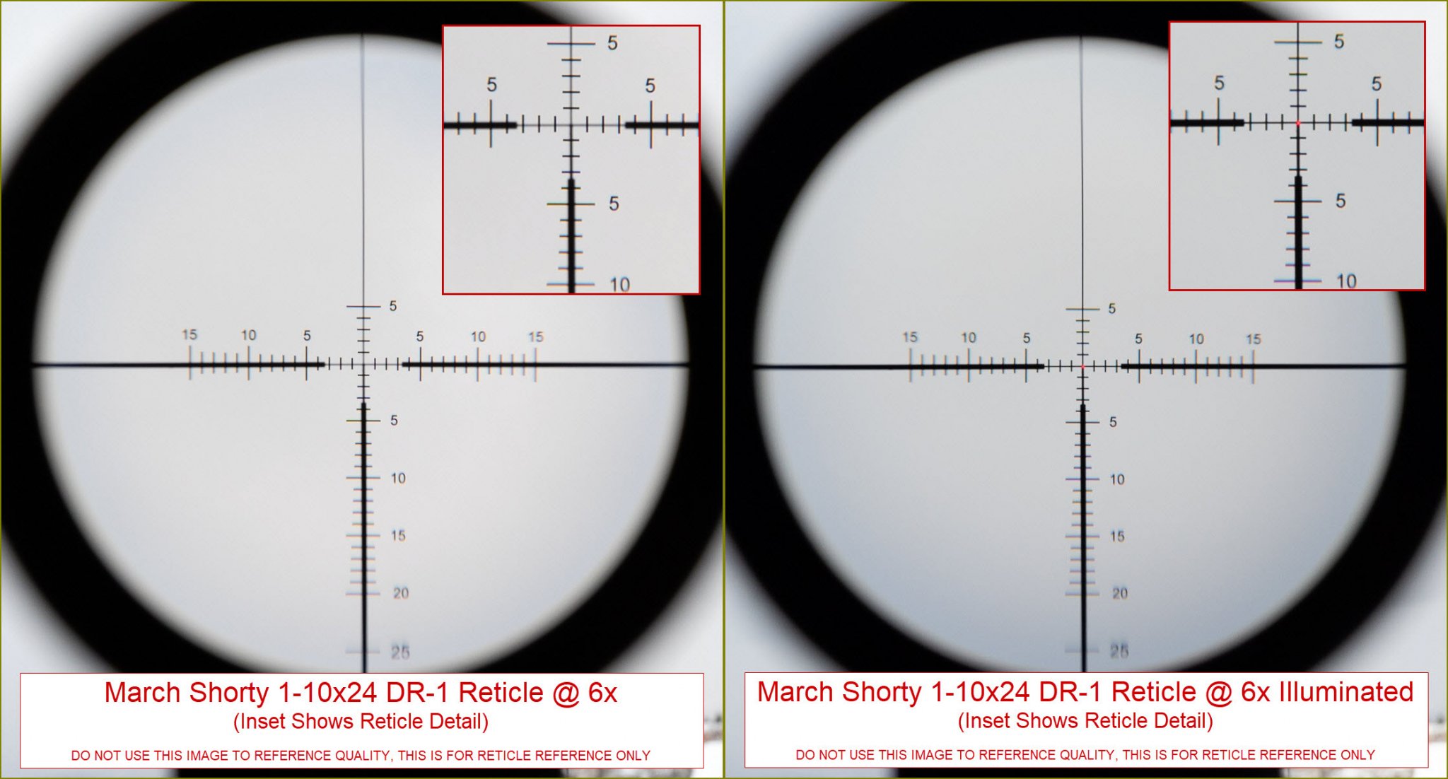

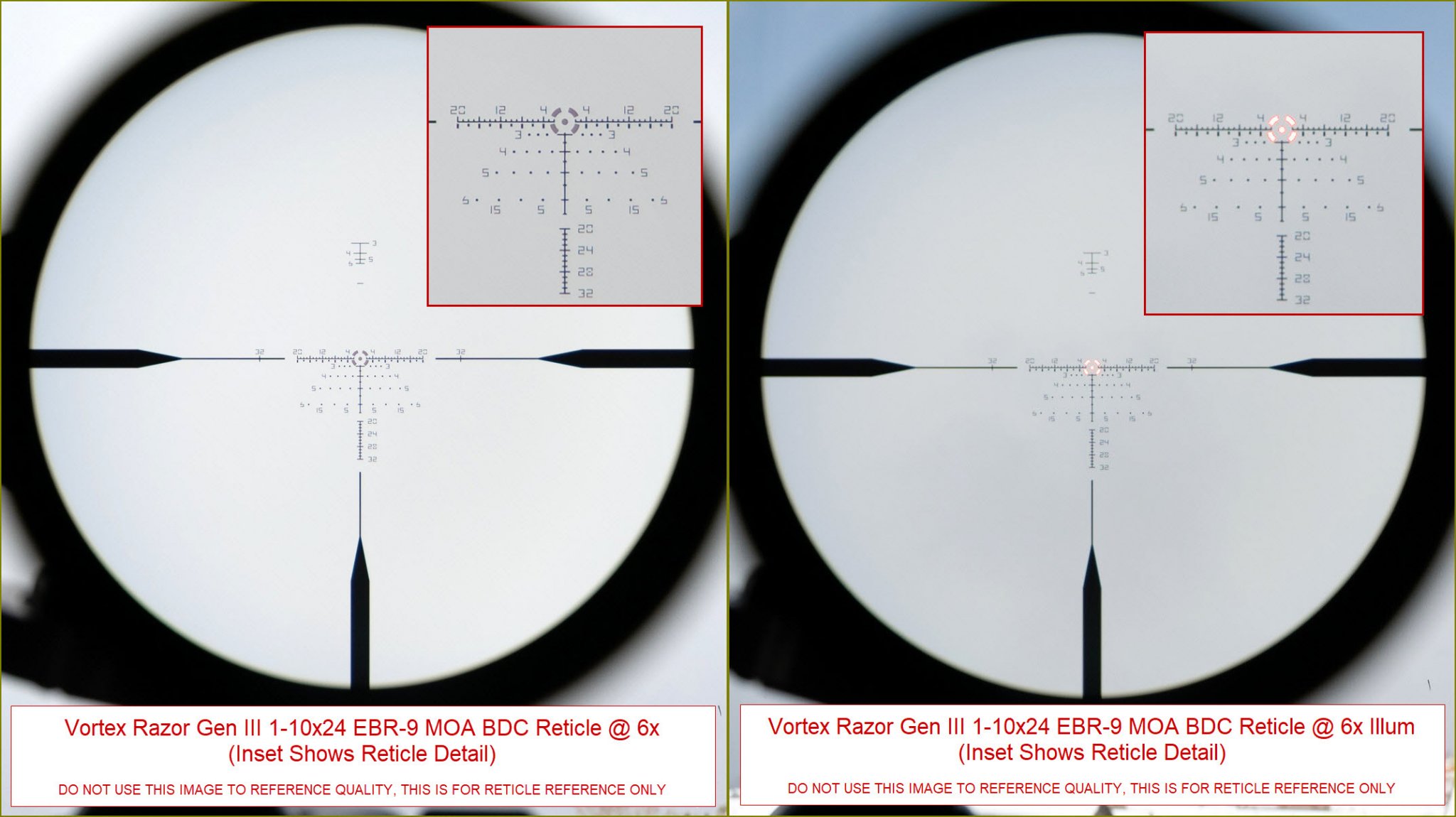

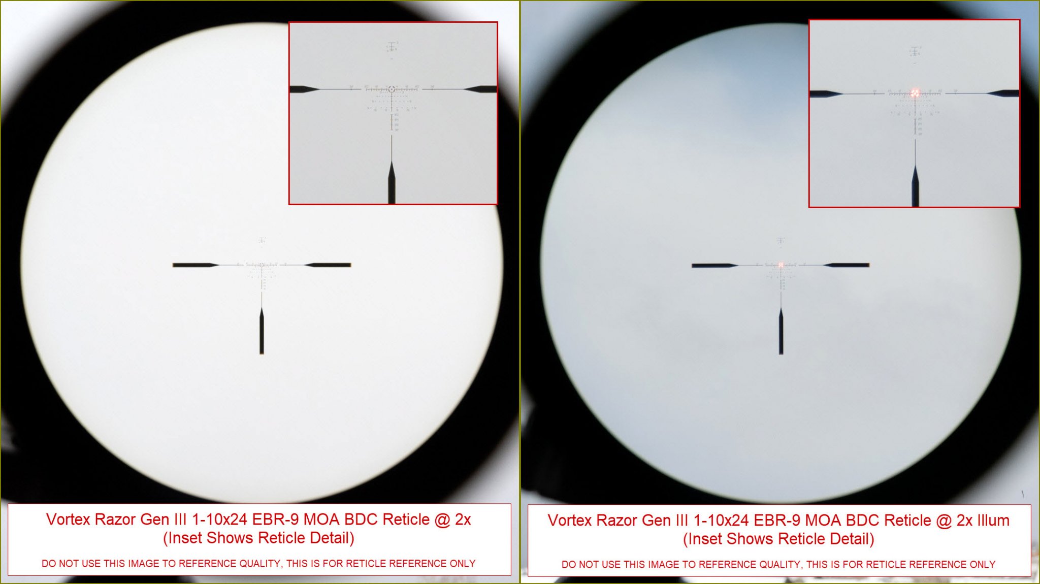

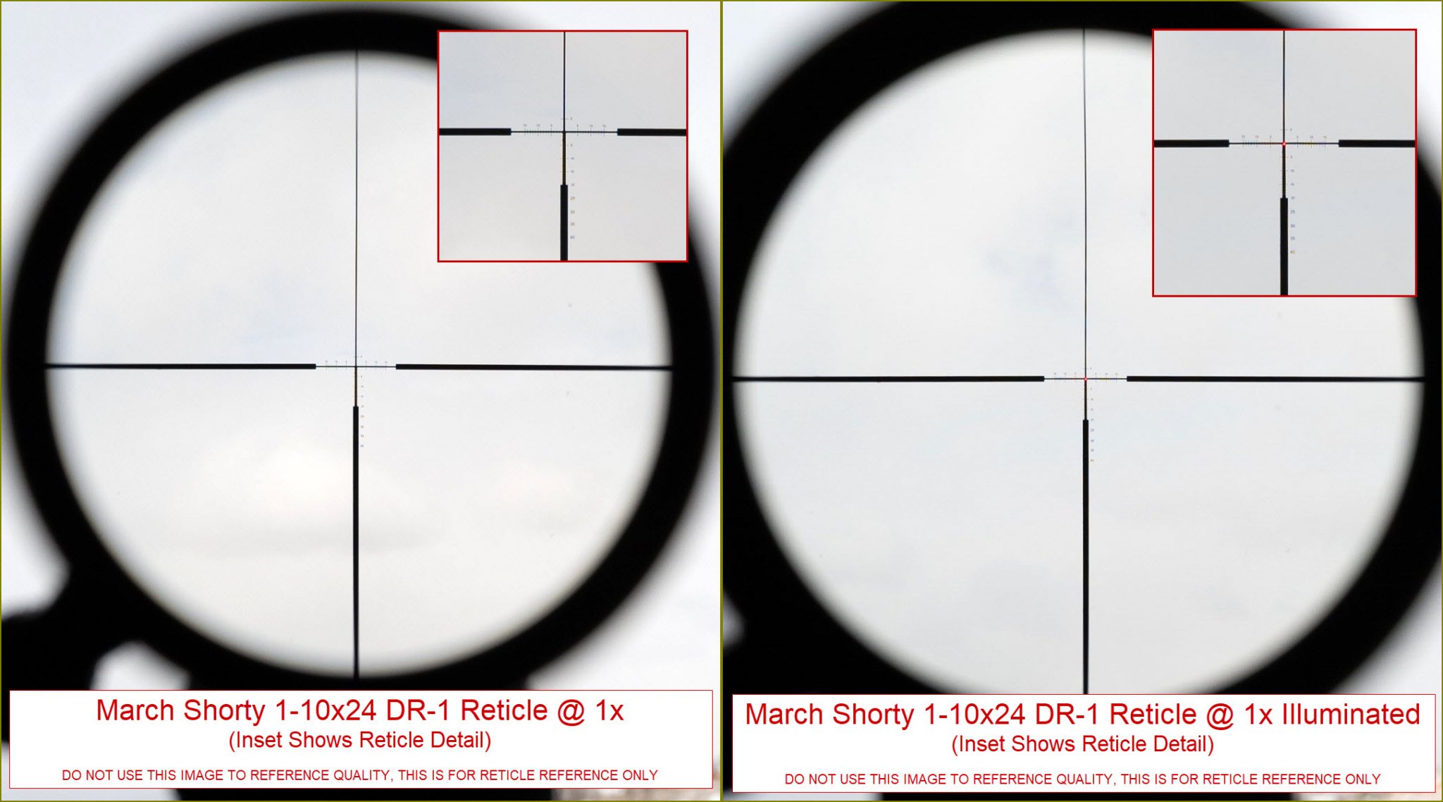

    AT 1x​

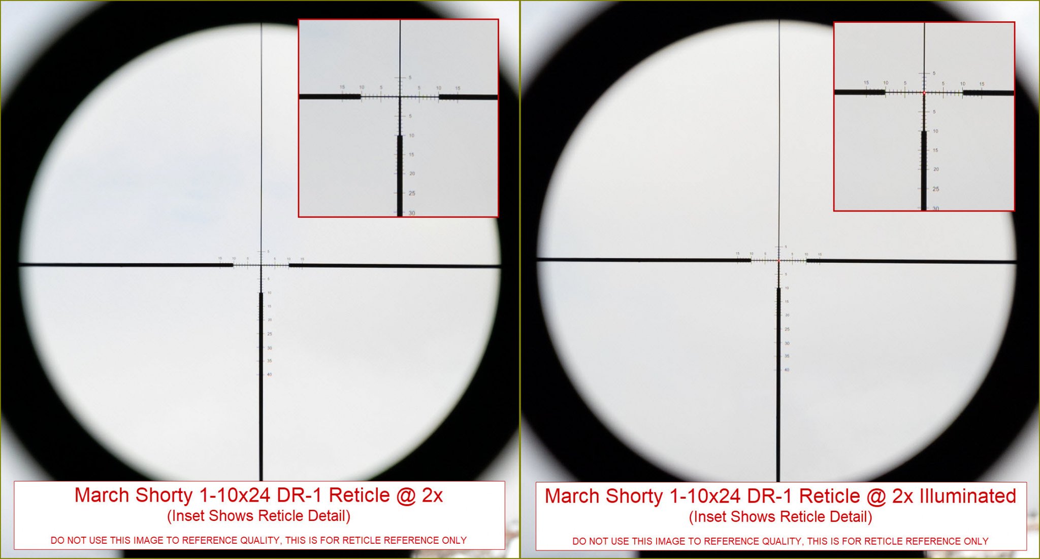

    AT 2x​
    AT 4x​
    AT 6x​

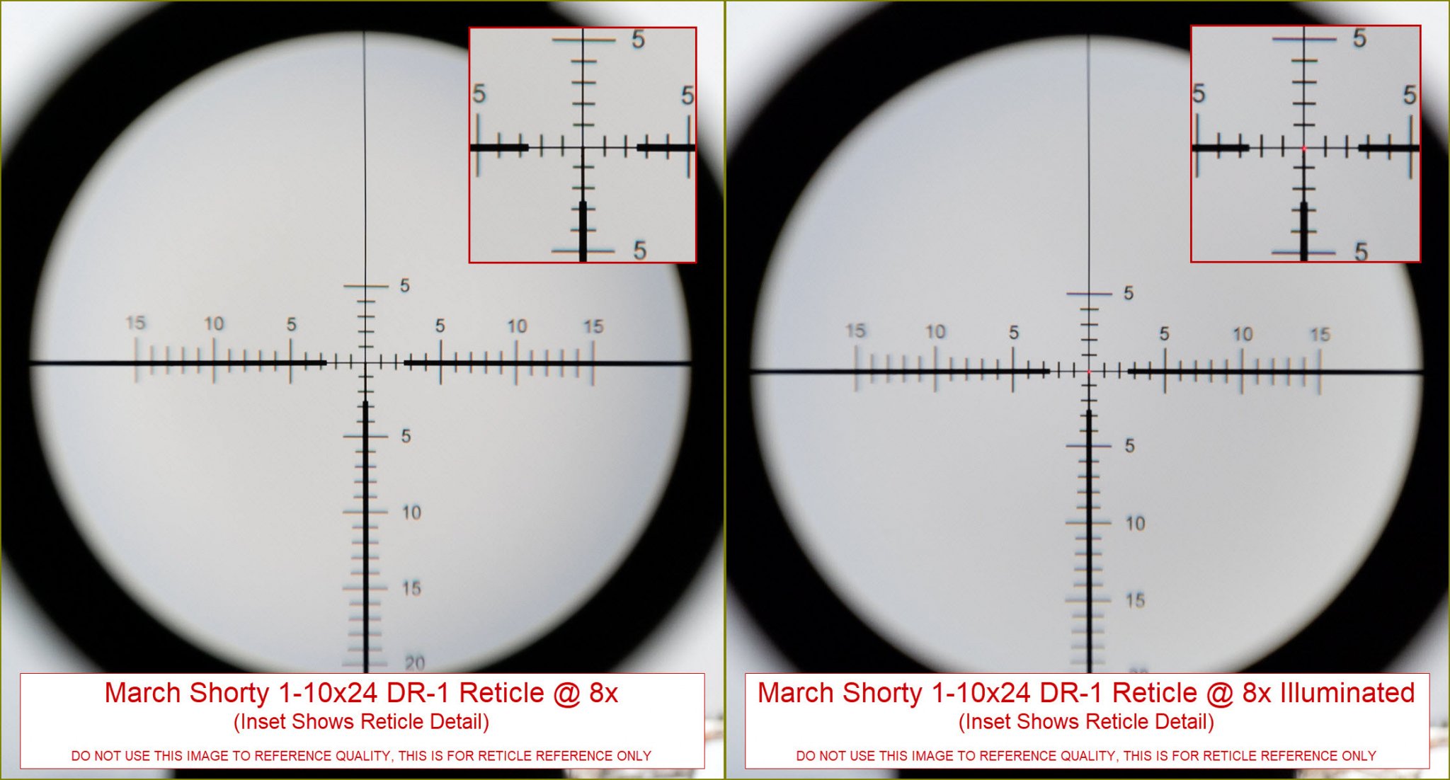

    AT 8x​

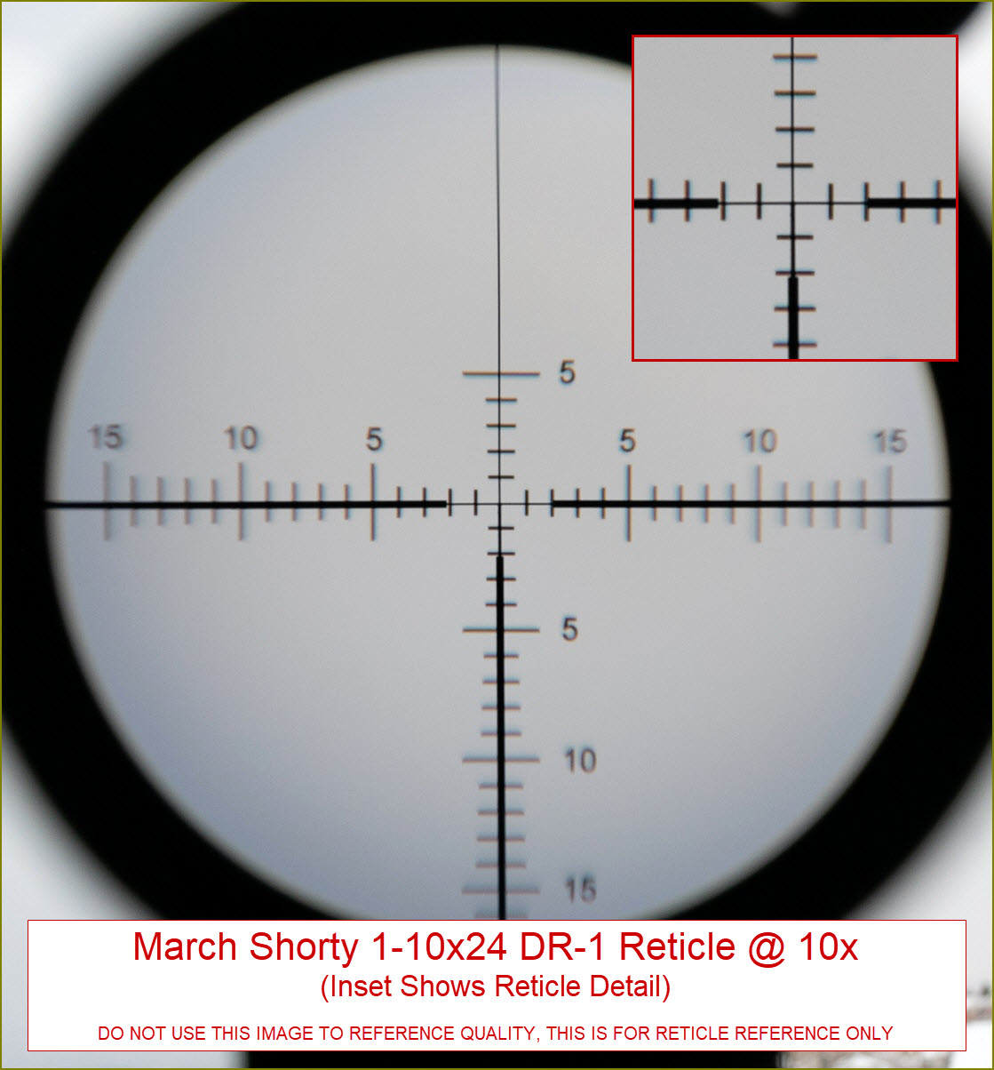

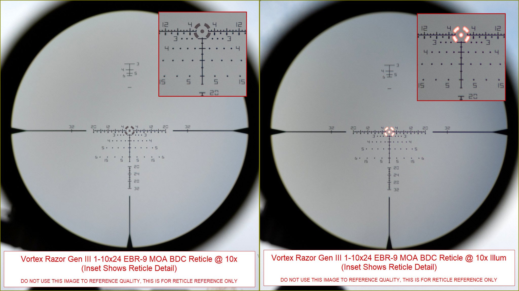

    AT 10x​
    Oops, forgot to take a pic of illumination at 10x on the March, ugh

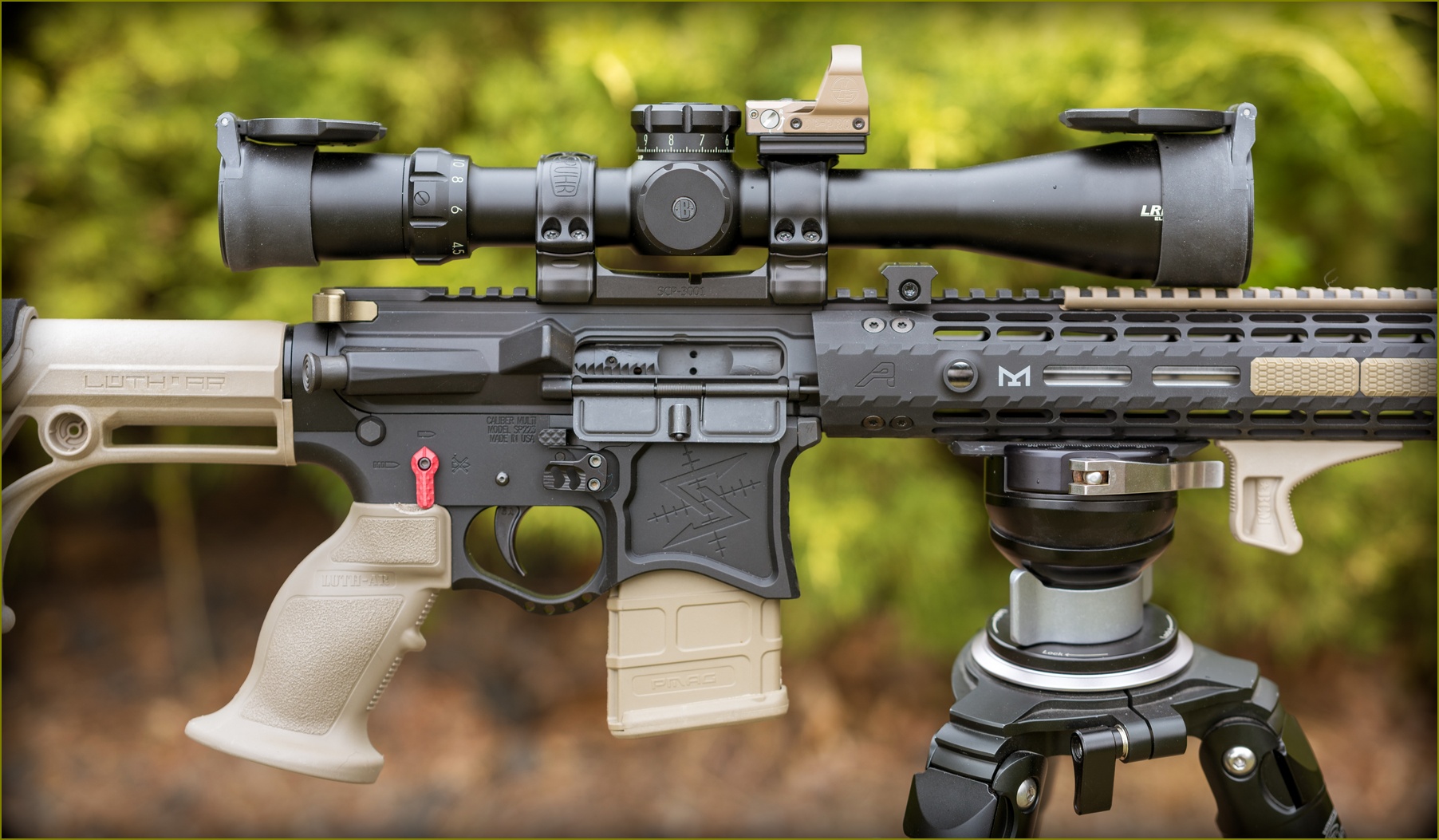

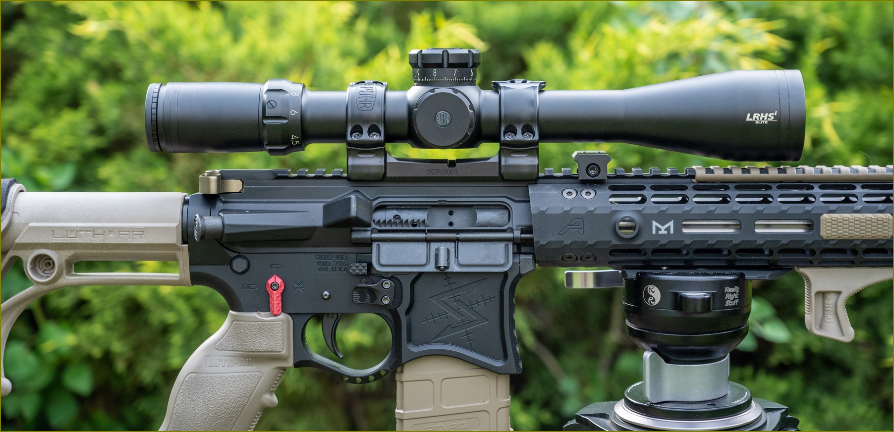

    Just to give perspective, from Left to Right: March 1.5-15x42, ATI SAI 6 1-6x24, Bushnell LRHSi 4.5-18x44. As you can see the March is incredibly small!
    Bushnell LRHSi 4.5-18x44 on my SPR
    March 1.5-15x42 on my SPR
    March 1.5-15x42 with SIMRAD on my SPR

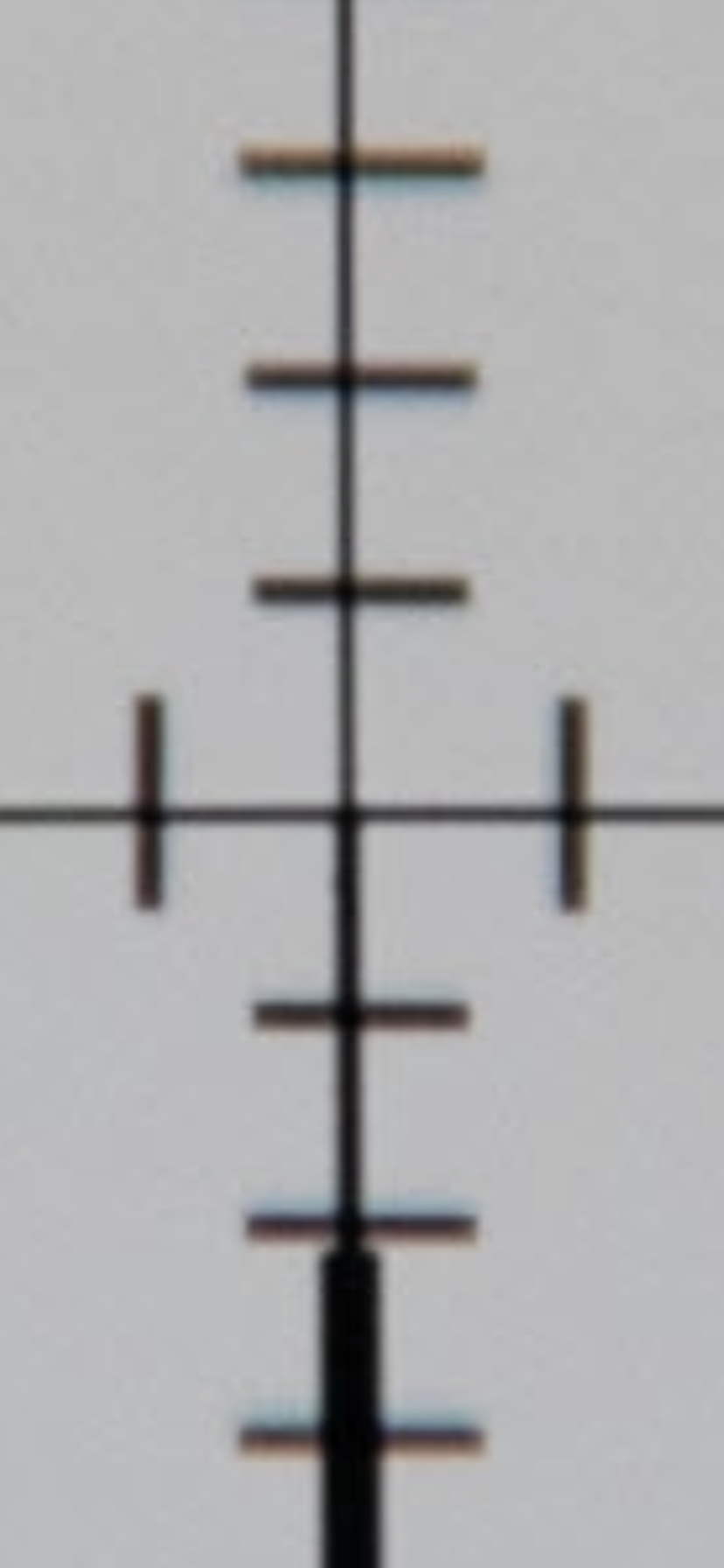

    Im wondering why all of the reticle stadia on the March do not seem “centered up.”
    Seems a bit fucky.
    Considering the dual reticle design, I might be willing to look past it as long as they line up enough that zeroing at 10x is still effective at 1x. Looks to be less than 0.5 mils, which is sufficient for 1x use IMO.
    But I can also see myself getting very annoyed if it were off that bad as my brain tries to fight "center of the box" vs "crosshair."
    What you are seeing is the difference between the SFP lines and the FFP lines, the distance from center should be accurate even if the hash mark is not completely centered, I will ask March and see how they respond.
    This document here references **Image displacement due to zooming conforms to ISO 14135-2:2017.
    Reactions: BoldCorrections

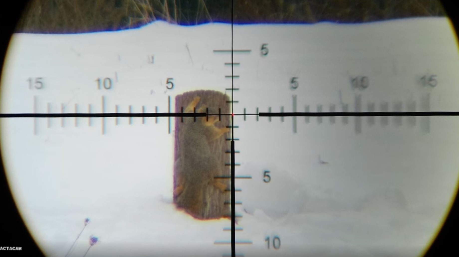

    Regarding the march retile at 10x, I have seen some other reviewer posted video and images elsewhere on the Internet. Here are some examples:
    I took the liberty to make some screenshots from the videos in the second link:
    I think if you look hard enough, there may be a tiny bit of misalignment between the two reticles. However, I would still applaud March for achieving such feat with a scope that compact.

    That's how I setup my LRHSi, I love the G2H for close up at low mag, 4.5x is easy with the G2H, and I just started piggybacking my DPP, but now I've got to try it with the March 1.5-15 and see how I like that.
    I did exactly this on my ar. Its a little slow inside a house BUT DOABLE.......add a 45 degree offset reddot (or piggy back if that's your thing)
    It looks a little funny but it's good from 0-750 yards......... and its light....and it has an excellent warranty so I don't feel bad using it hard....
    Excellent scope for the cash....
    But man that march 1.5x15 is soooo much smaller........I want it to replace the lht......LOL
    Doable is the perfect way to describe it. Not great but good enough to get the gears turning. I live in a rugged heavily wooded area and the rifle in question usually wears a bushy SMRS2 1-6.5 pro which is a perfect walking around the woods scope. The 3-15s ride in my spotter bag and were intended to only be used for setting up somewhere to target shoot off bibods but the lht especially seems to be quite useful as a general purpose optic. I'll still use the bushy most of the time due to size/weight.
    I spent most of my glass budget on spotting equipment and haven't seen a reason to step up from mid range Japanese rifle scopes. Now if I can get the size, weight, magnification range, with a daylight bright dot and top shelf glass all in one package then we're talking about something worth spending 2-3k on.

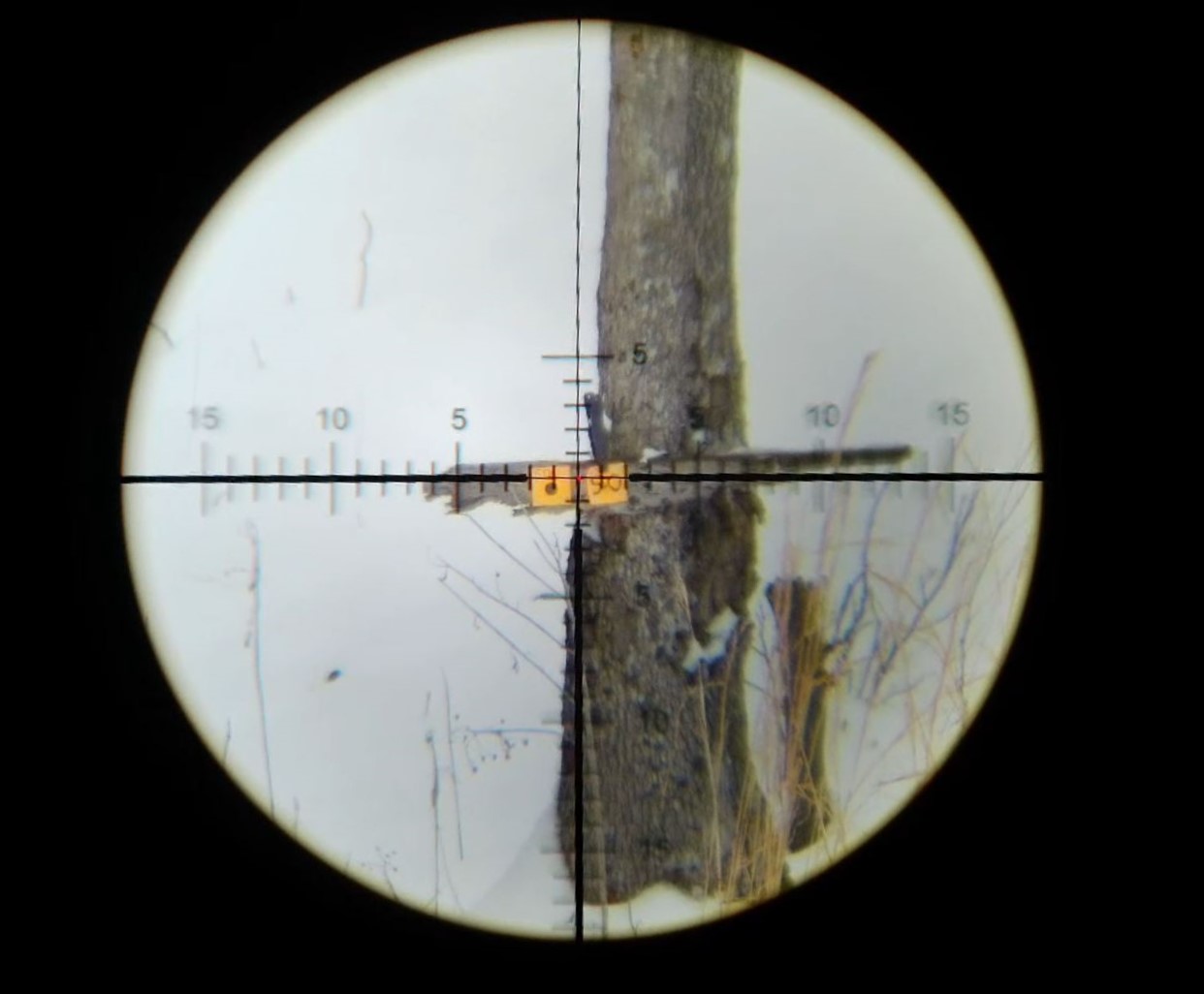

    A couple of comments on the 1.5-15x42 reticle illumination.
    The MTR-5 in the scope Bill has is a conventional etch-and-fill illumination and it is not day bright. They do have a version of this scope with FD-1 and FD-2 reticle, but covered turrets. These are fiber dot illuminated designs (FD-1 is the same thing as the SFP reticle in the 1-10x24 Shorty) and they are reasonably daybright.
    ILya
    ILya
    Brilliant. I’d love to see them produce an SFP variant of your FML-TR1 in the 1.5-15 but calibrated for 15x instead of 10x, if they could somehow make a daylight bright etch-and-fill illumination like many OEM’s from LOW that would be even more compelling. The 1.5-15 is really growing on me, in the right configuration I could see myself wanting that more than the 1-10.
    Reactions: Bravo6
    There isn't really a true daylight bright etch-and-fill reticle out there. The closest is Sig Tango 6t 1-6x24 and they have a pretty thick donut to illuminate. Larger area helps in this case.
    Reticle calibration on 10x is a mistake, I think, but a it is not uncommon when companies want to keep reticle reasonably thin. FML-TR1 was realy designed for FFP scopes. If I were making one for a SFP scope, I would probably do it a little differently.
    ILya
    Reactions: Bravo6
    I suppose we need to define what I mean by daylight bright - is the reticle bright enough to see during bright sunlight, it doesn’t have to be glowing but enough to differentiate between the black reticle and see red illumination. And not LPVO mind you but long range scopes. Reticle on the Kahles, ZCO, Bushnell LRHS, NF and Vortex are all what I consider daylight bright, much brighter than anything from March. So what technology are they using that March does not have access to?
    Reactions: Bravo6
    all of these are day visible, but not really day bright and, to me, barely day visible unless against a black background
    Ilya
    Reactions: Bravo6
