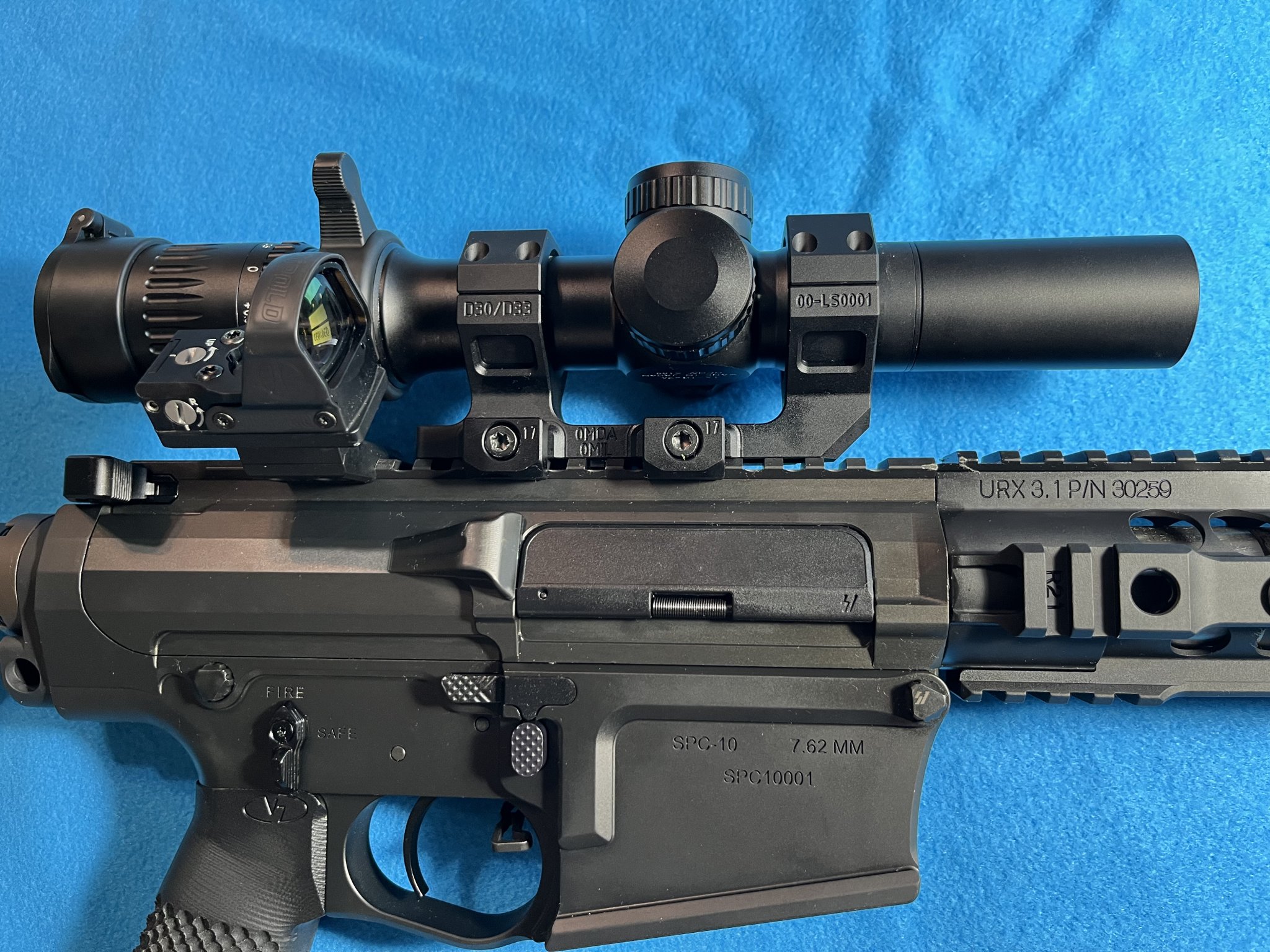

I have never put the Scalarworks/March setup on a rifle. I am currently using the original March Shorty single ring mount (#MAR2037), now discontinued. I don't have a picture of it on my rifle, but you can find pictures of the mount on the web with a search.
Many people, including some I much respect their experience, say they have had issues with this scope mount. I have not.
I will take a picture and post it later.

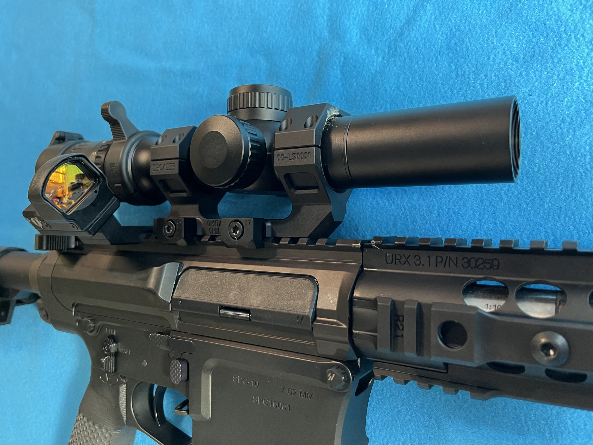

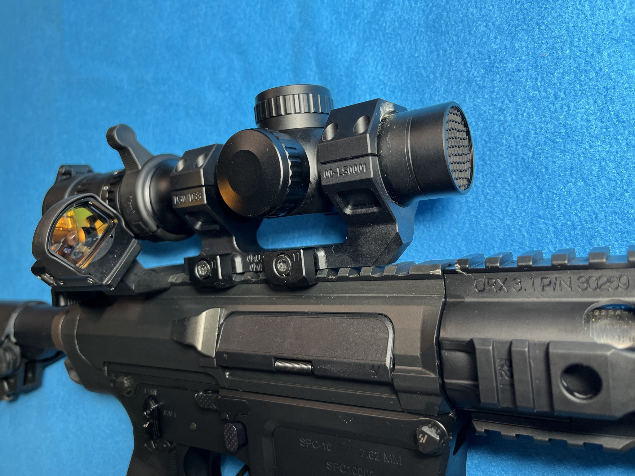

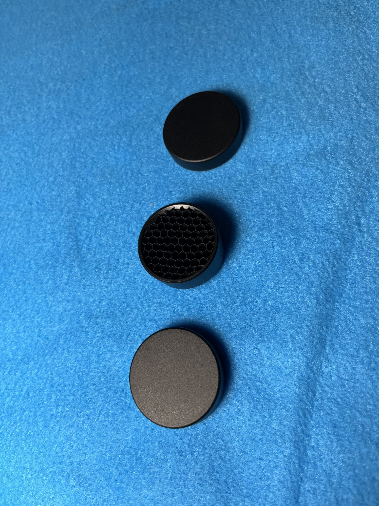

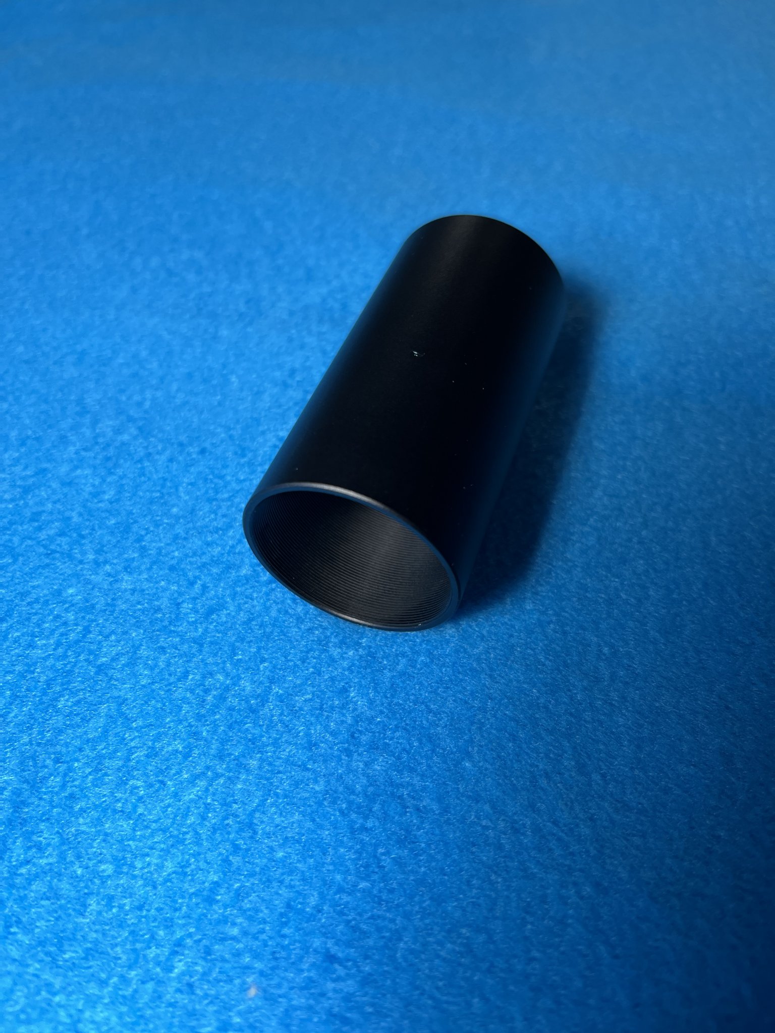

Sharing this information in case anyone else is interested.

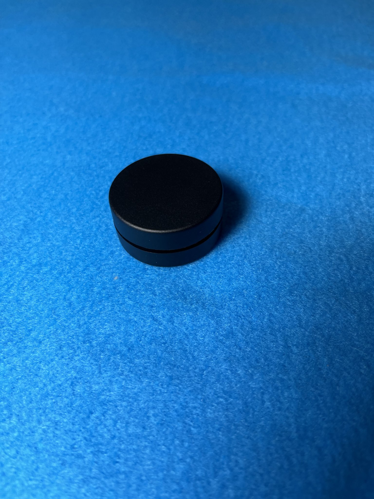

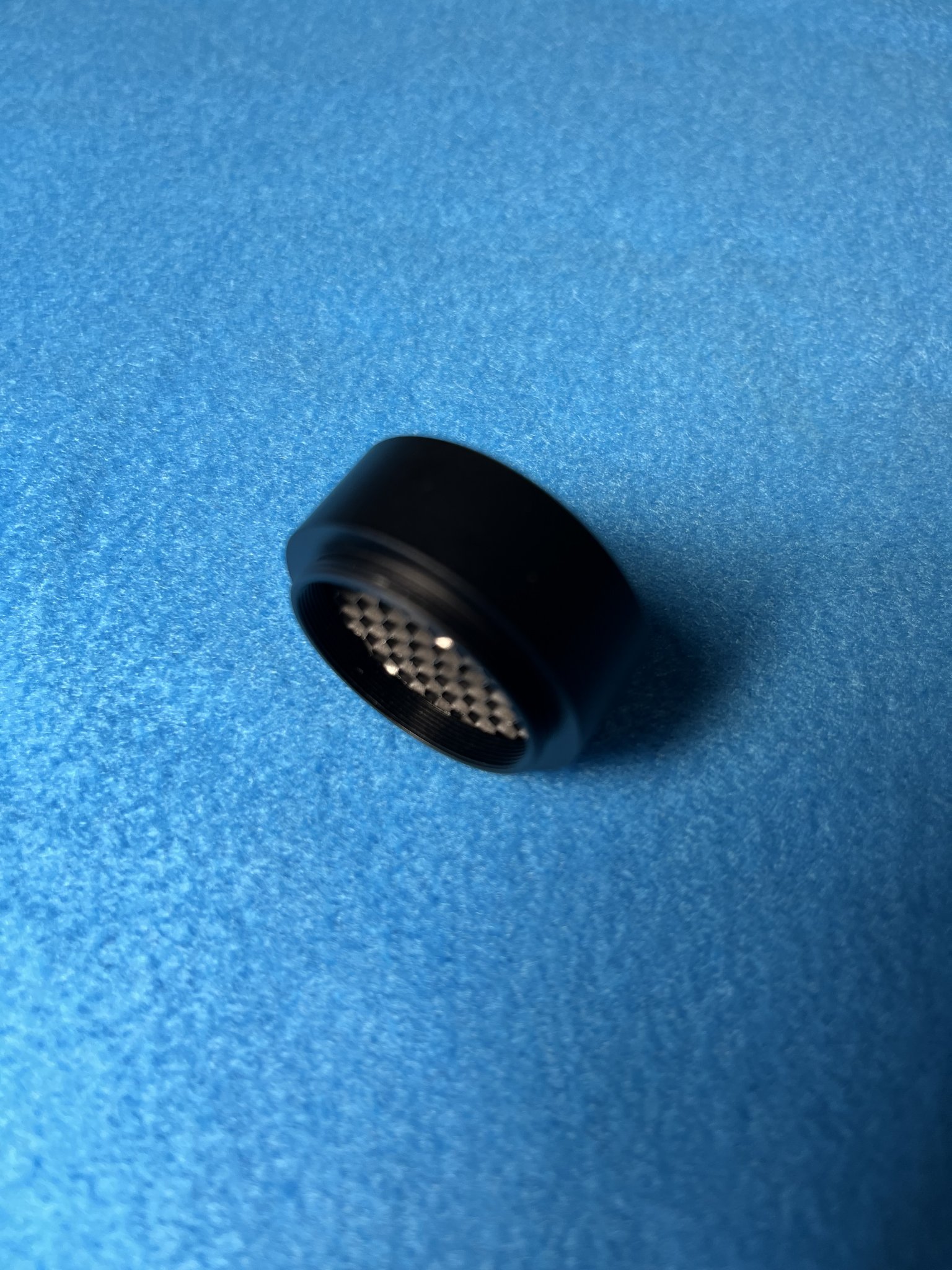

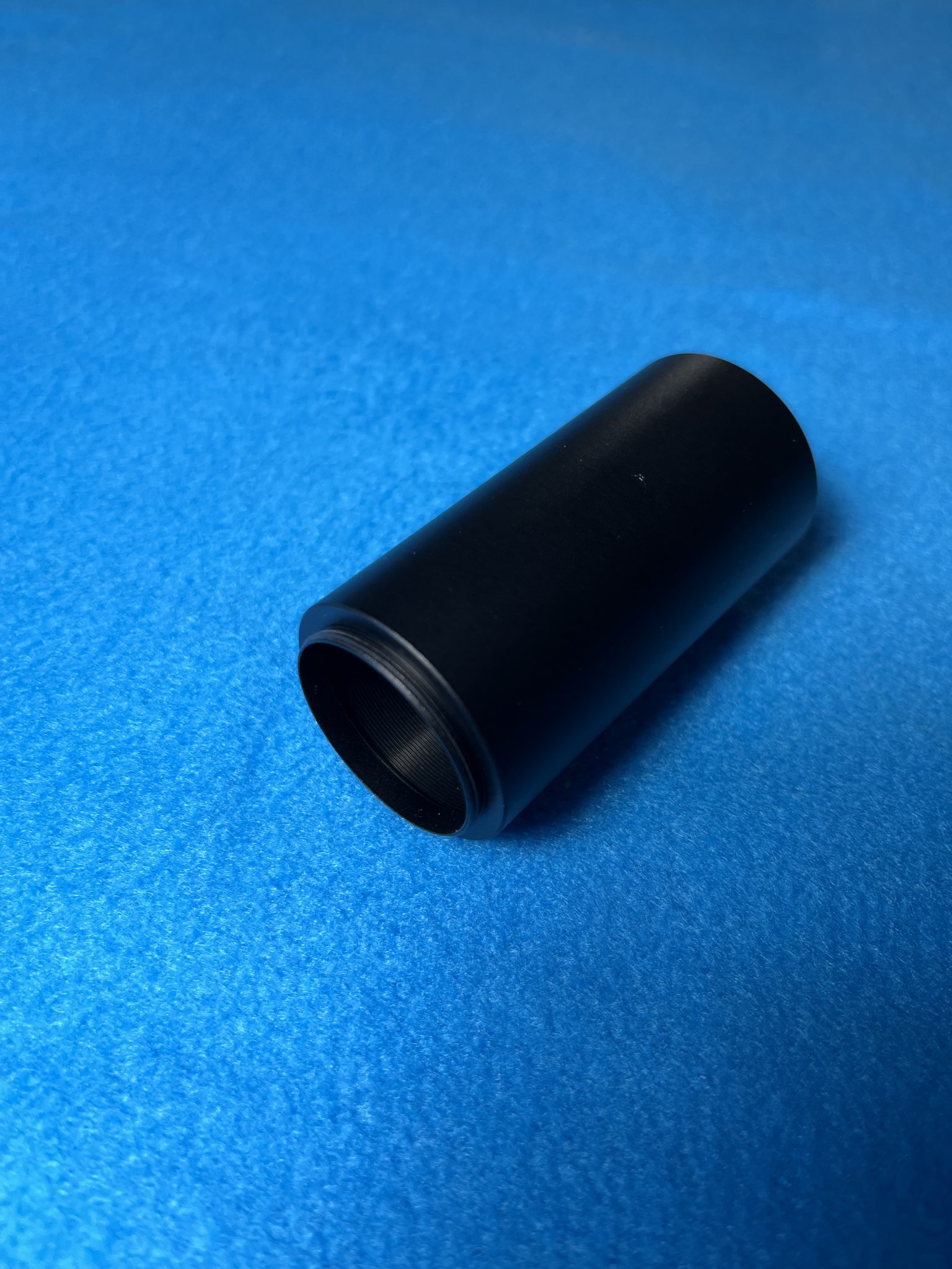

I run ARD’s on most of my optics, mainly to protect the objective lens and for the other obvious reasons. So after getting the March Shorty I decided to order one. I could not find one anywhere so I contacted Don at LongRangeSupply and he ordered it for me. Great guy, first time customer but plan on doing more with him in the future. Anyway, I just received it, it took 2 months to get it but I am very pleased. In the interim I have been using the March Sunshade which I found on Optics Planet. Following is some technical data if you are interested:
March 24 mm Sunshade – Black – Part #: DB485-0
Diameter: 33 mm (1.299”)
Overall Length: 66.15 mm (2.604”)
Length Minus Threads: 63.55 mm (2.502”)
Weight: 22 g (0.78 oz)
Cost: $38.00
March 24 mm Honeycomb Hood (ARD) – Black – Part #: DB391-A
Overall Length: 15 mm (0.591”)
Length Minus Threads: 12 mm (0.472”)
Weight: 6 g (0.21 oz)
Cost: $104.00

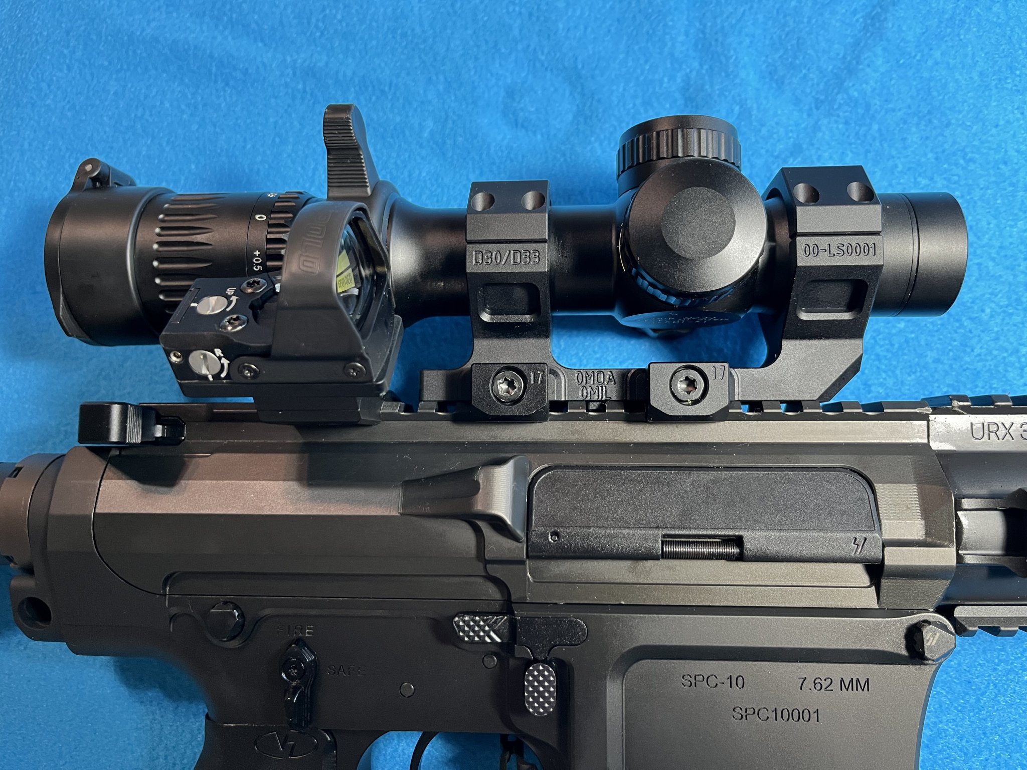

Following is what I measured with calipers:
Distance from top of the Picatinny rail to the center of the rings: ≈39.5 mm (1.555")
Distance from top of the Picatinny rail to the top of the rear 30 mm ring: ≈57.3 mm (2.256")
Distance from top of the Picatinny rail to the top of the front 33 mm ring: ≈60.68 mm (2.389")
Edit: Typo - 57.3 mm (2.556") changed to 57.3 mm (2.256").

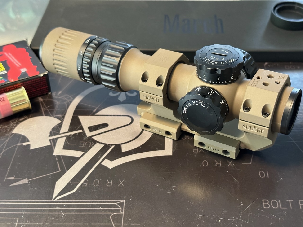

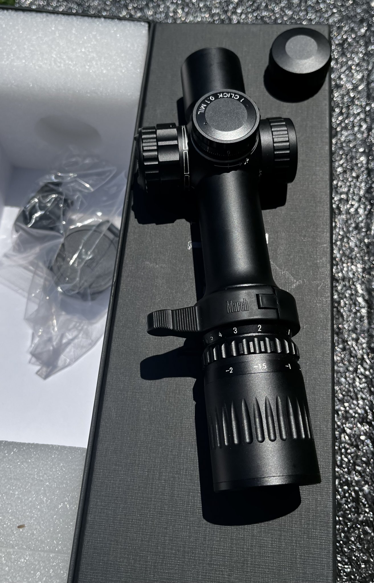

Finally got one. I know scopes can be very subjective and eyes are different and all, but I am extremely impressed so far. Nice eye box, clear glass, bright red dot, and ridiculously short and light for a 1-10 lpvo.
I already like it better than the Vortex 1-10, but it is more money. One of my favorite things about it is how it still would be very effective if the battery died and I didn't have a replacement immediately available, which can be an issue with ffp lpvos.
I wish they wouldn't have done those tall shuriken turrets on the gen 2. Low profile capped makes more sense to me.
I agree. That's why I ordered the Gen 1. It is capped and low profile, but it does require the factory mount. I looked at the badger c1 mount I like for my kahles k16i and the Vortex 1-10 (before I sold it) earlier on this thread, and realized it was only around an ounce difference or so in total weight compared to the March mount.

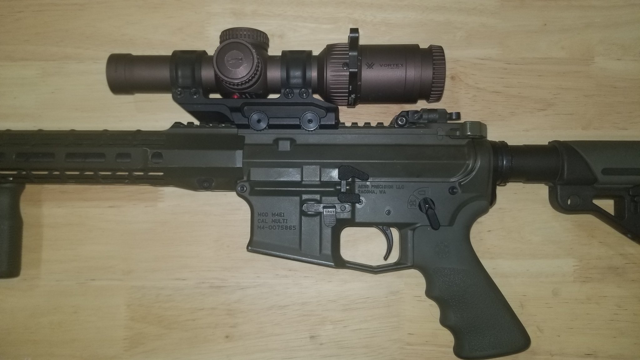

One other thing I noticed is that while the March is definitely lighter on paper compared to the Vortex 1-10, the difference feels more substantial due to being roughly an inch and a half shorter. It reminds me of how a really well balanced rifle can feel lighter than one not as well balanced. FALs always felt lighter than they were on paper to me, and so does the sr25 CC. For 556 ARs, it is sort of like a tapered barrel vs a govt profile feeling totally different due to the balance and weight distribution, if that makes any sense.

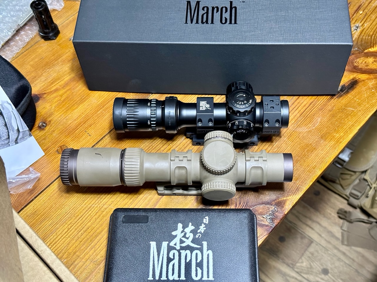

I use the earlier March 1-8x24 Shorty with a variety of clip-ons. It works exceedignly well. I have spent a lot of time with the 1-10x24 Shorty and like it quite a lot, but for hunting purposes the FFP 1-8x24 does everything I need to.
ILya
I owe you a big thank you for letting me know this March shorty even existed. After I saw one of your YouTube videos discussing it, I started researching and finally ended up buying one. Your review and comments were spot on!
Reactions: LRRPF52 and DustBun
Mine is the DR1-TR1 reticle with capped turrets. I had the one with the exposed turrets before and i wasn't really a fan of them on a 1-10x. Ive had it maybe a year now and still haven't mounted it because of the double dia setup. Im having a custom 34mm to 33mm delrin step-down insert made and I’ll probably mount it in a 34mm Badger Comm mount along with a 34mm to 30mm rear step-down insert. My last one I did the same thing but with aluminum sheet stock and it held up fine.
