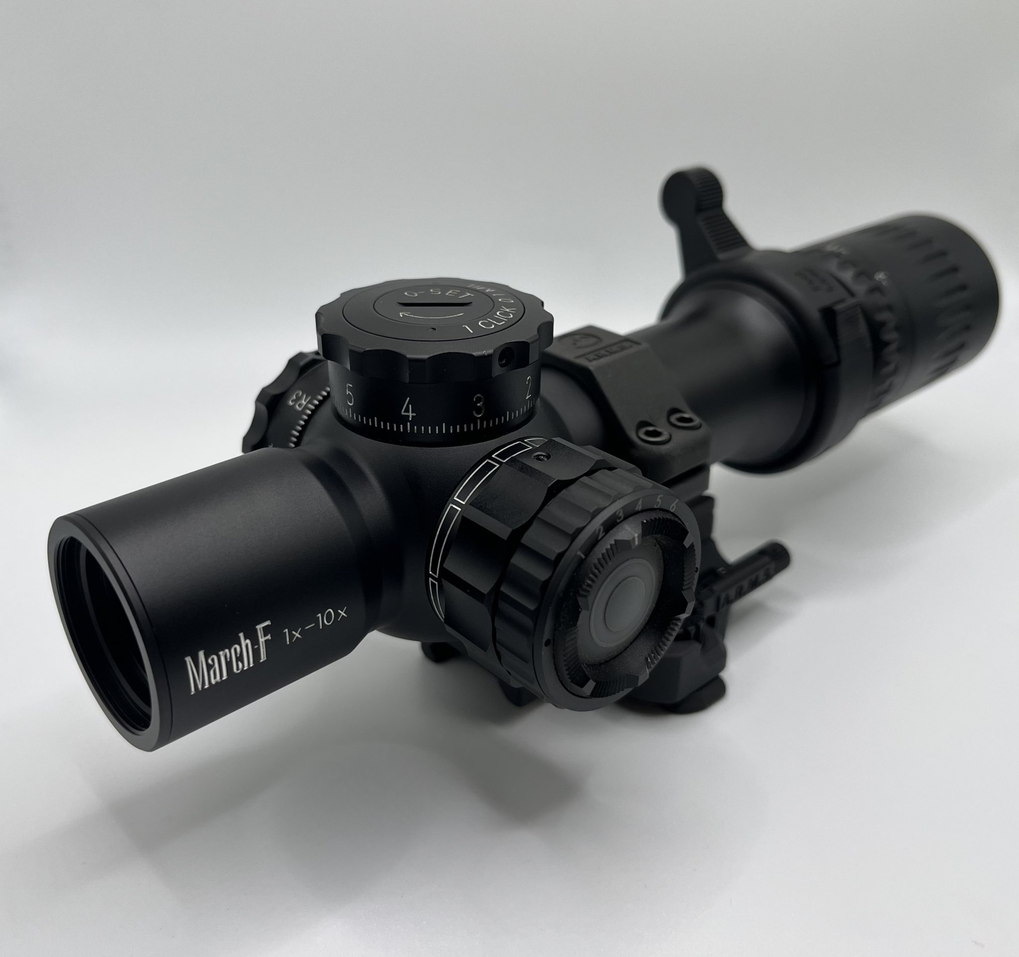

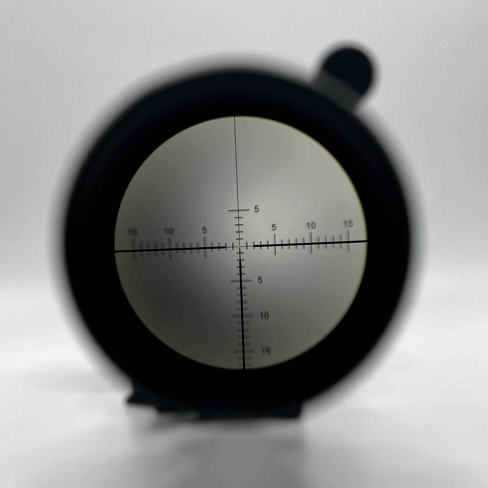

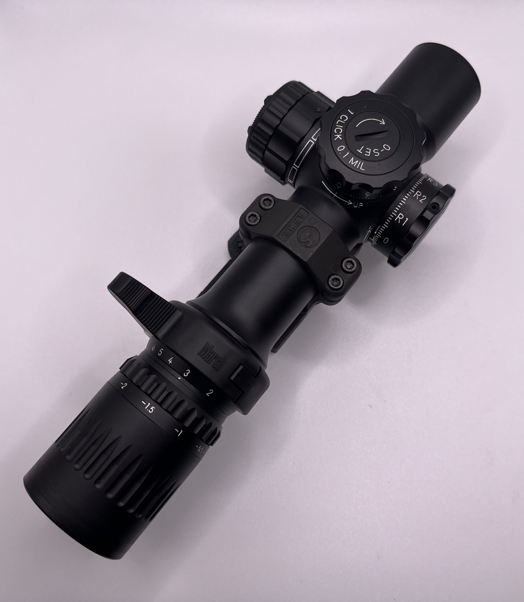

There aren’t a lot of them going around. I have one and absolutely love it but I’ll be selling mine since there are other projects that need attention right now…but for the short while I had it up until this point (since February) it’s near perfect. 17.7 oz 1-10x scope that has illumination and a parallax wheel is rare if there are any others out there I’m not aware of it. Clarity bests the nightforce NX8 1-8 and id say is up there with the nightforce ATACR in image quality. The previous poster NC Libertarian summed it up best really. But for me I’d add that I would have rather gotten the capped model (wasn’t available at the time) since I don’t dial much at all on this scope and mainly use the reticle so that’s something to consider. I will purchase the capped 1-8x model since that one has all the features I’d prefer for the shooting you’re talking about.

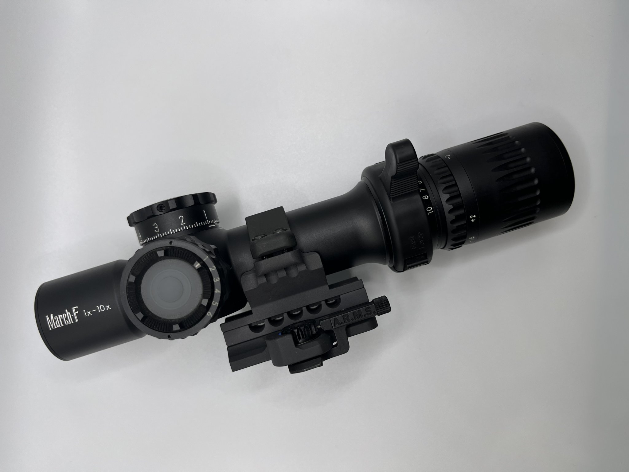

I see what you’re saying but that’s not how it actually adds up. So several of the 34mm rings I measured were at 34.10mm with some even as high as 34.20mm. The rings themselves are typically not undersized to allow for compression over a scope body if they’re aluminum rings if I’m not mistaken. The 1mm stock I have is not exactly 1mm. It’s more like .97mm and after finish blasting it’s further reduced .01mm - .02mm possibly more dependent on how aggressive the blasting is because I also don’t want them to be glass smooth for the obvious reason, I’ve tried this before with a thinner shim stock, maybe closer to what you were taking about and under recoil the scope moved forward and aft. Also aluminum shim stock compressed fairly easily…how much I don’t know. Scalarworks Leap 07 and 08 do it with some of the Vortex Scopes and anything else with a smooth finish even when torqued to spec. So it’s a trial and error thing. I’ll just have to test and if I need to I’ll scale down like I said before but exactly .05mm I believe is slightly undersized.

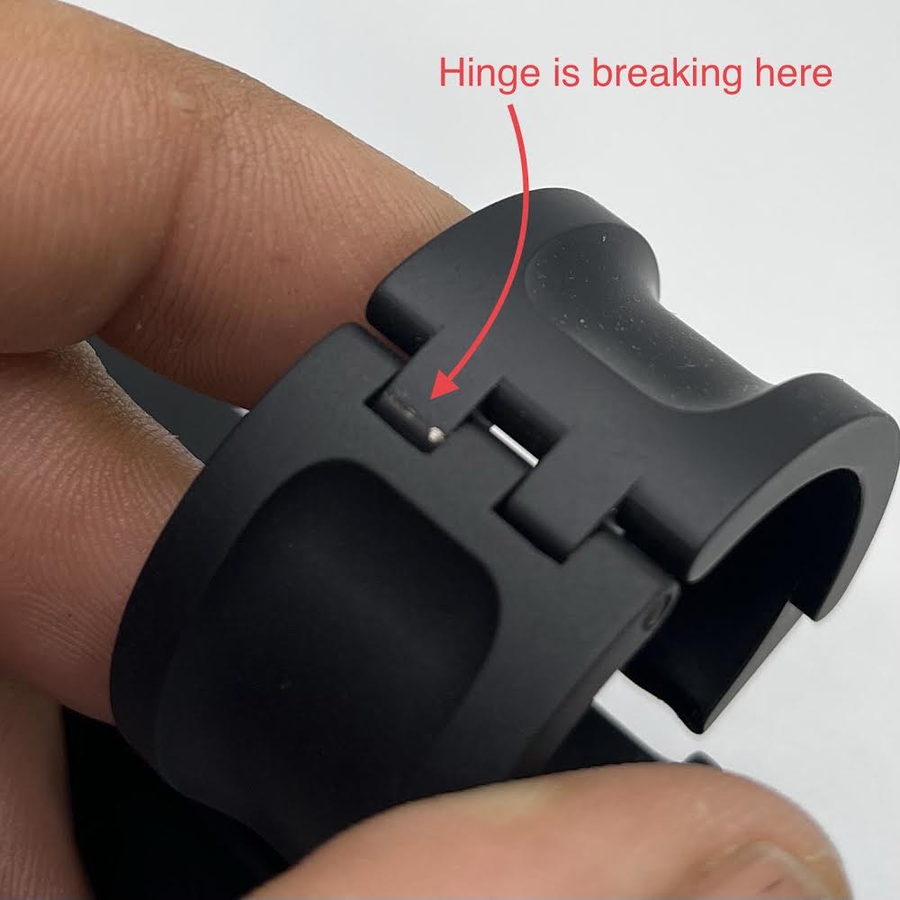

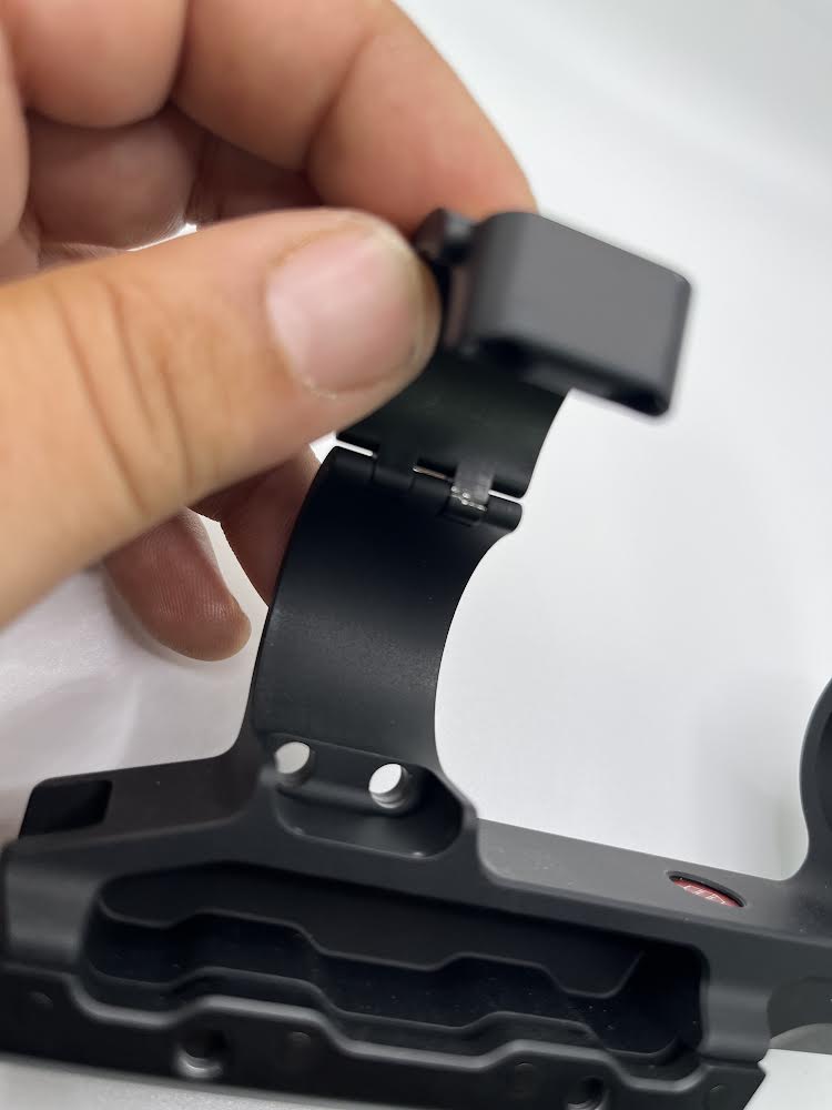

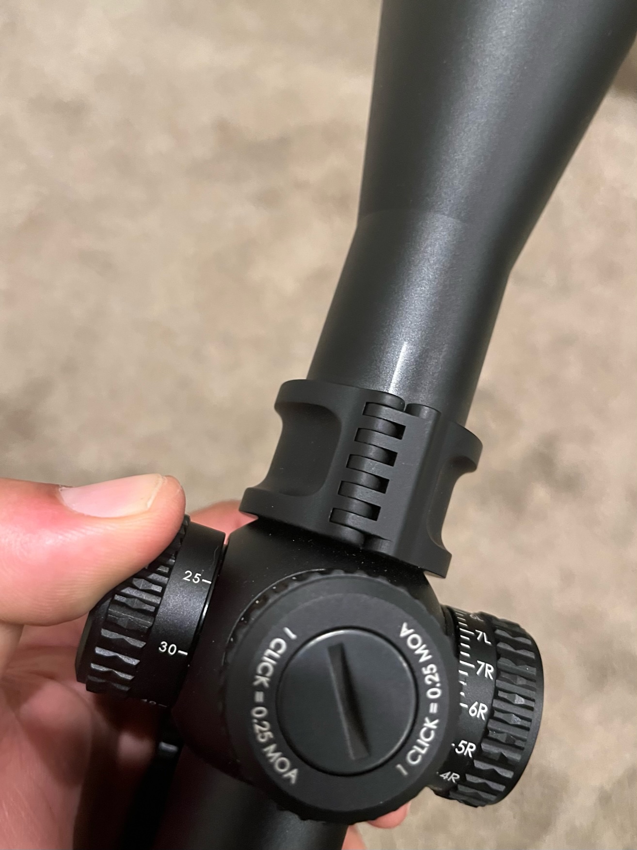

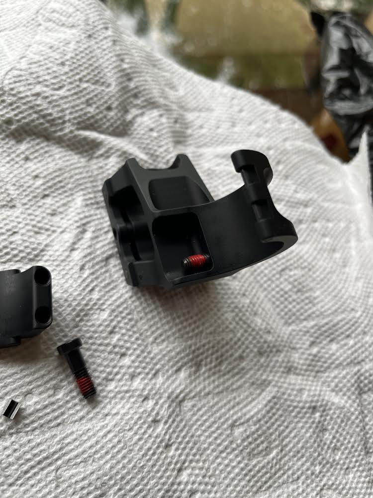

They’re garbage stay away. I’ve had two break at the hinges and the Leap 08 requires you to torque to 20 inch lbs but the scope would move under recoil. The customer service was good but that doesn’t take care of the damaged scopes that were mounted in the mounts. I sent the scope in with the mount and they pretty much put aluminum black on the scope and sent me a new mount that’s been torqued to 25 inch lbs instead of the spec listed on the side. I’ve since gotten rid of it and went back to Spuhr, ADM, Badger Ordnance COM’s and Larues. For the Aimpoint CompM5 they’re gtg though.
Thank you very much! I looked at the listed weight and was curious how it could be reliable. I guess the answer is it is not. I tend to use badger mounts anyway, and I think they only weigh an oz more than the March mount.
Reactions: DacianMH
Yeah I hate to bash a product but I’ve had a bad relationship with their products. A reputable gun manufacturer that I work with has since gotten rid of all of theirs they had customers complain about the same reasons with the Leap 07’s. A really good YouTuber compared these mounts for zero reset too and it did poorly. I really wanted them to do well because on paper they just sound so good and they look well made and contoured nicely but the mounts we had from them just weren’t holding up.
Yeah, I guess it is too good to be true. A mount that light would have been perfect for the March, but it doesn't do much good if it doesn't hold zero. Maybe someone else will come along and make a light weight mount for the March lpvo.
I have an older LEAP/07, hinge just fractured, I sent a warranty note and they said they'll take care of it right away, that was last Saturday, I provided all the information they requested but haven't heard back, hopefully they'll get back soon and will get me taken care of. Their new design is supposed to be stronger, I guess I'll find out.

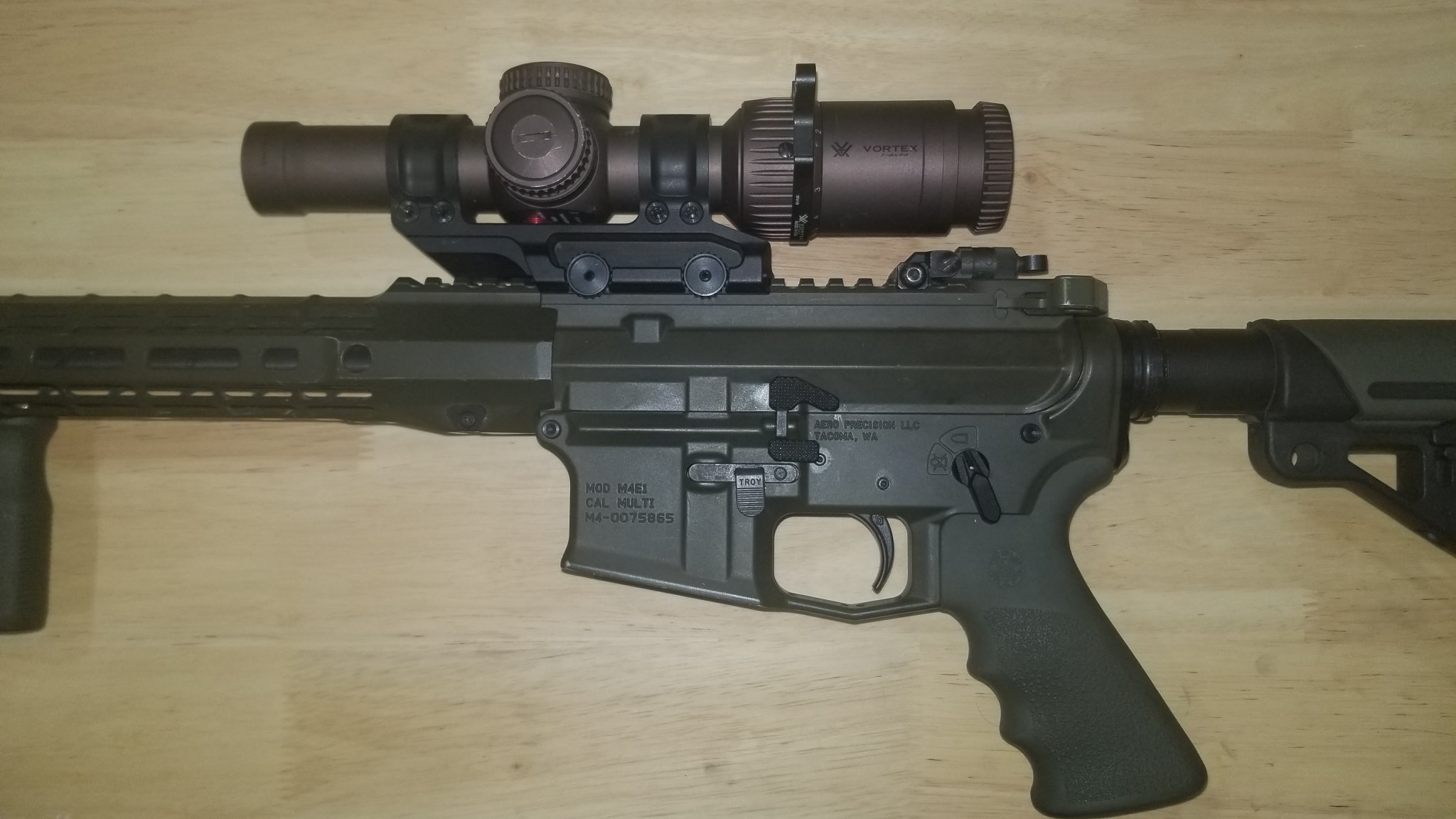

I have a Scalarworks on my first competition gun:
It was assembled just as shown here 2.5 years ago, and the scope has never been off of it since Day 1. It has been through 3 days of a carbine course, 6 Run n Guns, and over 2900 rounds. It has never moved. And this mount is the early model with the apparently troublesome hinge pin.
