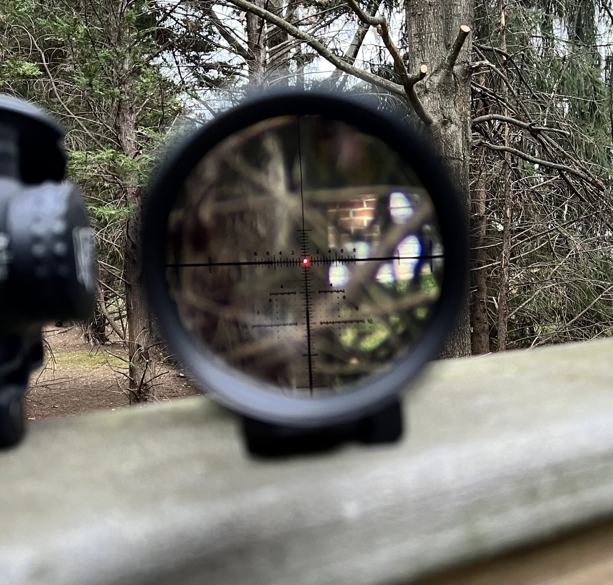

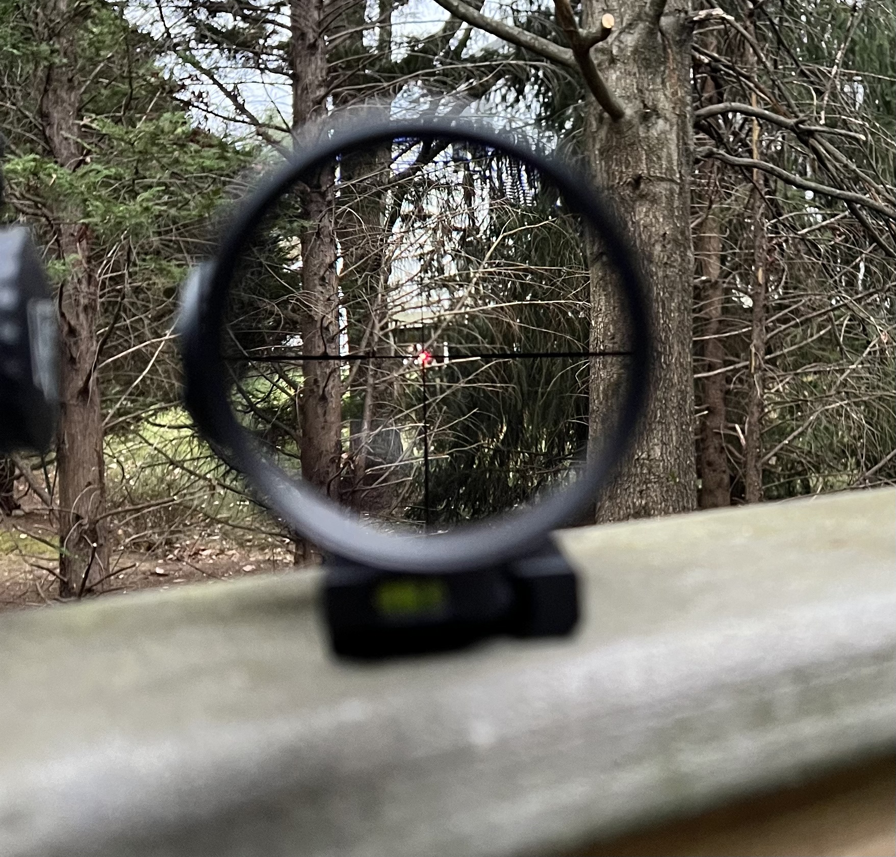

I don't have enough time with it to determine that fully yet. I can tell you that the difference is more from one distance to the next than you would have with my Razor 1-6x, but then we knew that without ever having the scope in hand.
I don't see being able to go from a short distance, like 5-10yds, then go to 800yd without dialing. That is just not going to happen. Exactly how far can you go, that I will need to do more examination to determine. Hopefully I will have more time to spend exploring all of this when I go back next week, weather allowing.
The above is one of the reasons I am already going to put a 45 offset red dot on this rifle, at least to experiment with. I had planned to experiment with this already, just to cover such situations where a shooting stage has a huge difference in distances. Elimination of cranking the magnification was the original goal, but if it also eliminates the parallax dialing, that is another plus.
And the Razor is not without its flaws in this area. Once it gets out to 300ish yards, it starts getting out of focus for my eyes, and there is nothing you can do about it. Cranking parallax is no big deal to me, so I can live with the trade-offs the March presents. Especially with the weight advantage. Others may not find it liveable.
1x and 10x (or maybe 8x? Dunno).
