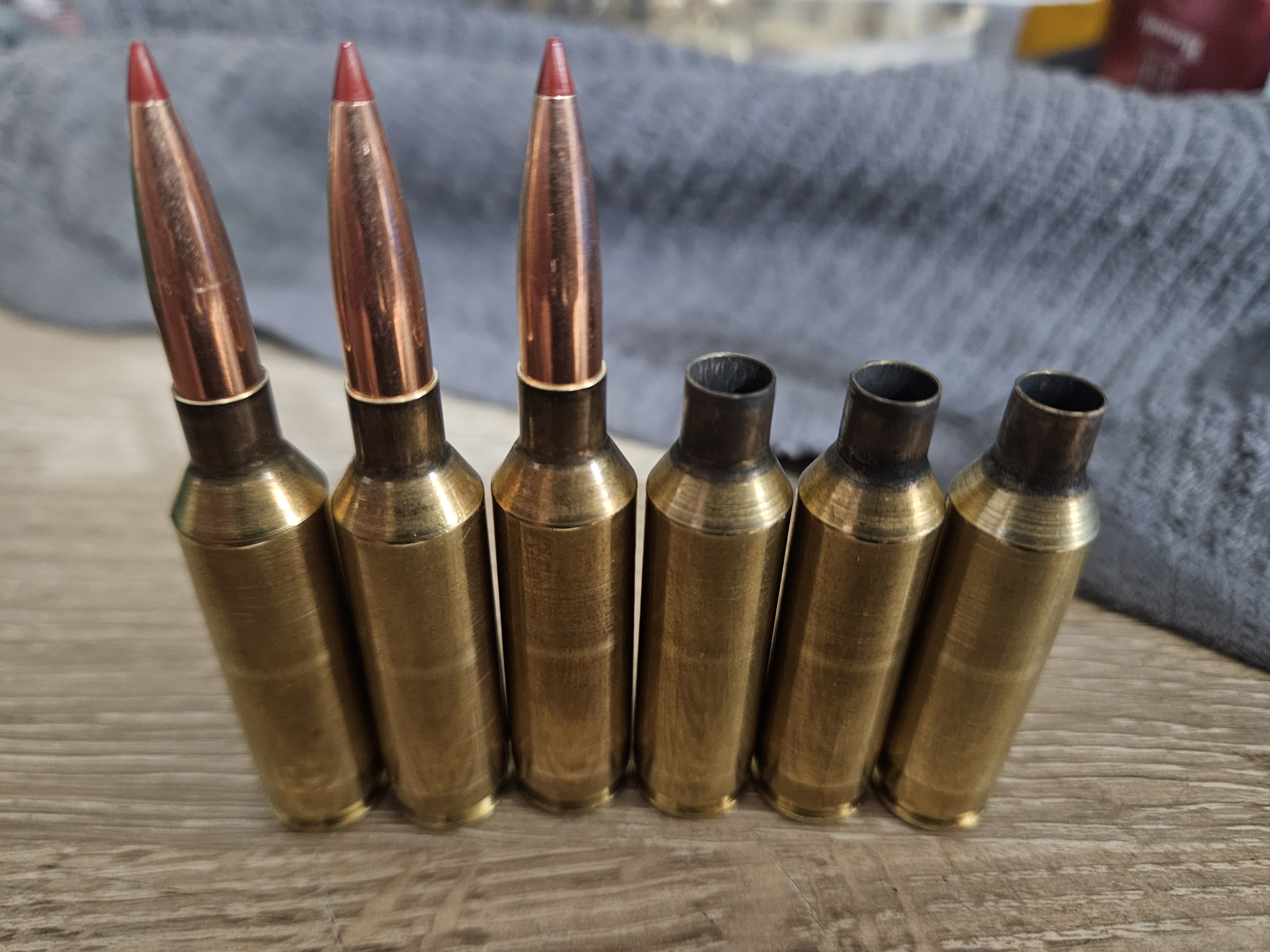

Question, I know you are getting good velocities. It looks like as the “barrel fouls” velocity increases as does pressure, but goes back down when cleaned. Describe the appearance of your cases when shit right after cleaning . Are they nearly covered in carbon or still bright? What I am wondering is if the fouling is sealing the chamber. As the chamber seals the pressures increase until they go above what you want.
I never thought to look at that before. I have only been reloading for about 1.5 years now, having done approximately 2k rounds in that time.
Here is a picture of 3 loaded rounds, vs 3 rounds i shot this morning after cleaning the bore and running 2 foulers. All brass has been fired 3x now.
Reactions: ShtrRdy

A test, may prove nothing but, after a 40 round test can you easily chamber a round? Does it pass a no go head space test?
I only have about 10 rounds through it since last cleaning, but just in case i did just try the no go gauge and it will not close.
This is the first rifle i built, and i did everything very carefully. Hornady virgin brass is measuring .004 shorter than my fireformed brass, and i am bumping shoulders back .003
Reactions: ShtrRdy
Speaking of head space changes, I can't recall a specific mention about HS changes however after shooting a number of rounds to heat the barrel, temps were recorded that were fairly high & the speculation was that the carbon wrap layers were either not expanding or expanding much less that the S/S liner causing the bore dia to be forced inward. I can't recall who conducted the testing or what the issues were if any but the tests brought about more questions than answers.
Having 2 completely different materials closely bonded that react differently with temperature increases & possibly decreases, left me wondering about CW barrel performance during string firing.
Still not sure what the resistance is to bronze brushes. Use one with an oil based cleaner and most of your cleaning problems will disappear. Don't use it with a copper removal solvent for obvious reasons.
Also, bronze brushes are consumables that has to be replaced after around 4-6 cleaning sessions depending on wear. And yes, the barrel wears away the bronze.
Nylon brushes are just good for spreading loose stuff around. They suck at removing baked-on cellulose based carbon like what you would get in a carbon ring.
Reactions: Haney
Thats interesting, next time i shoot a 5 shot group ill stick the no-go/go gauges in there and see if it feels different
