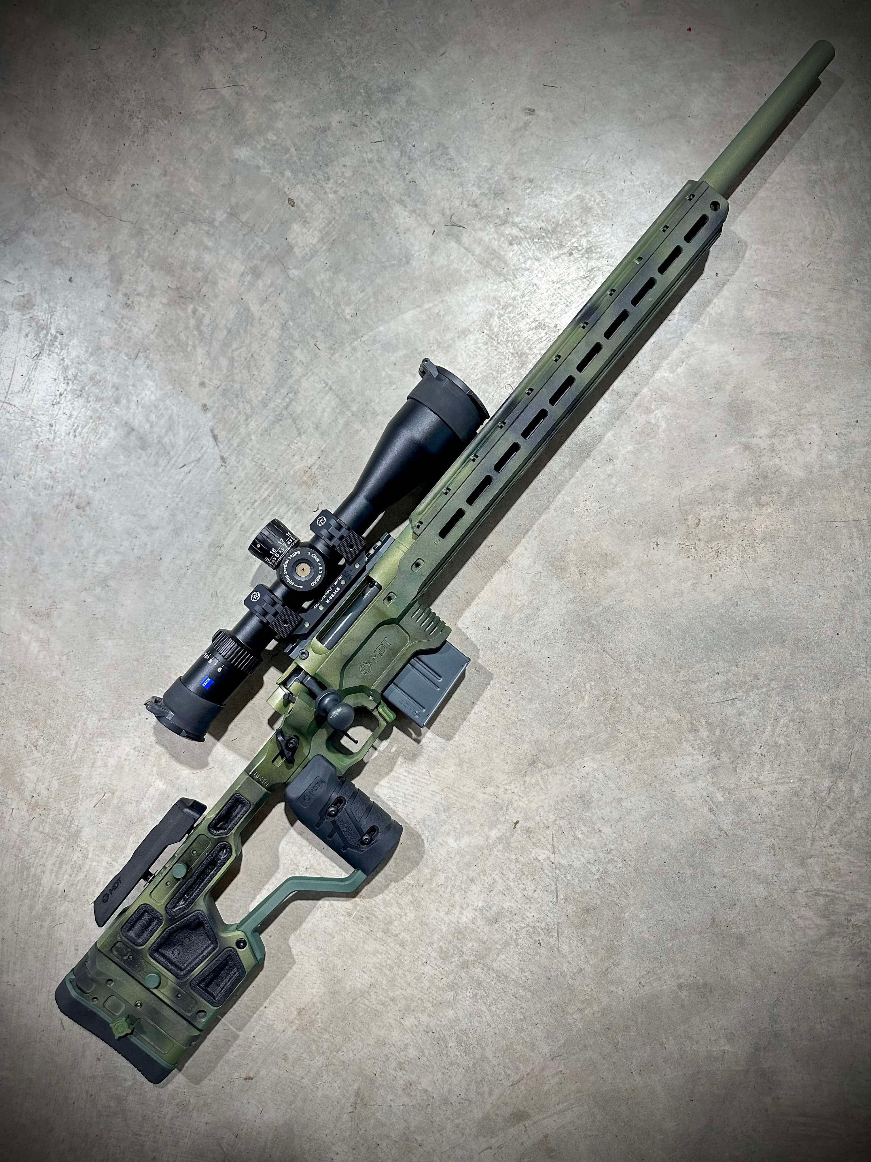

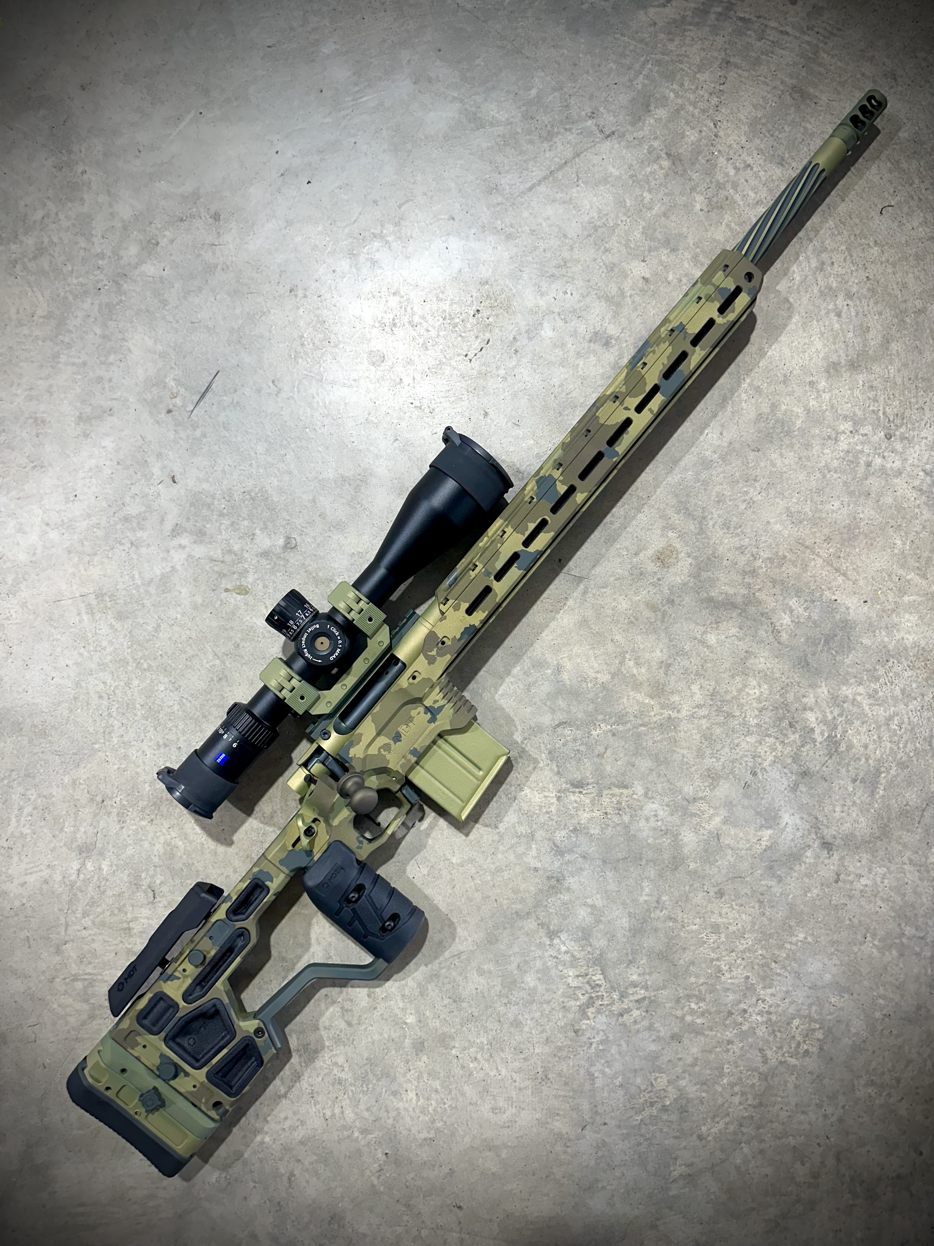

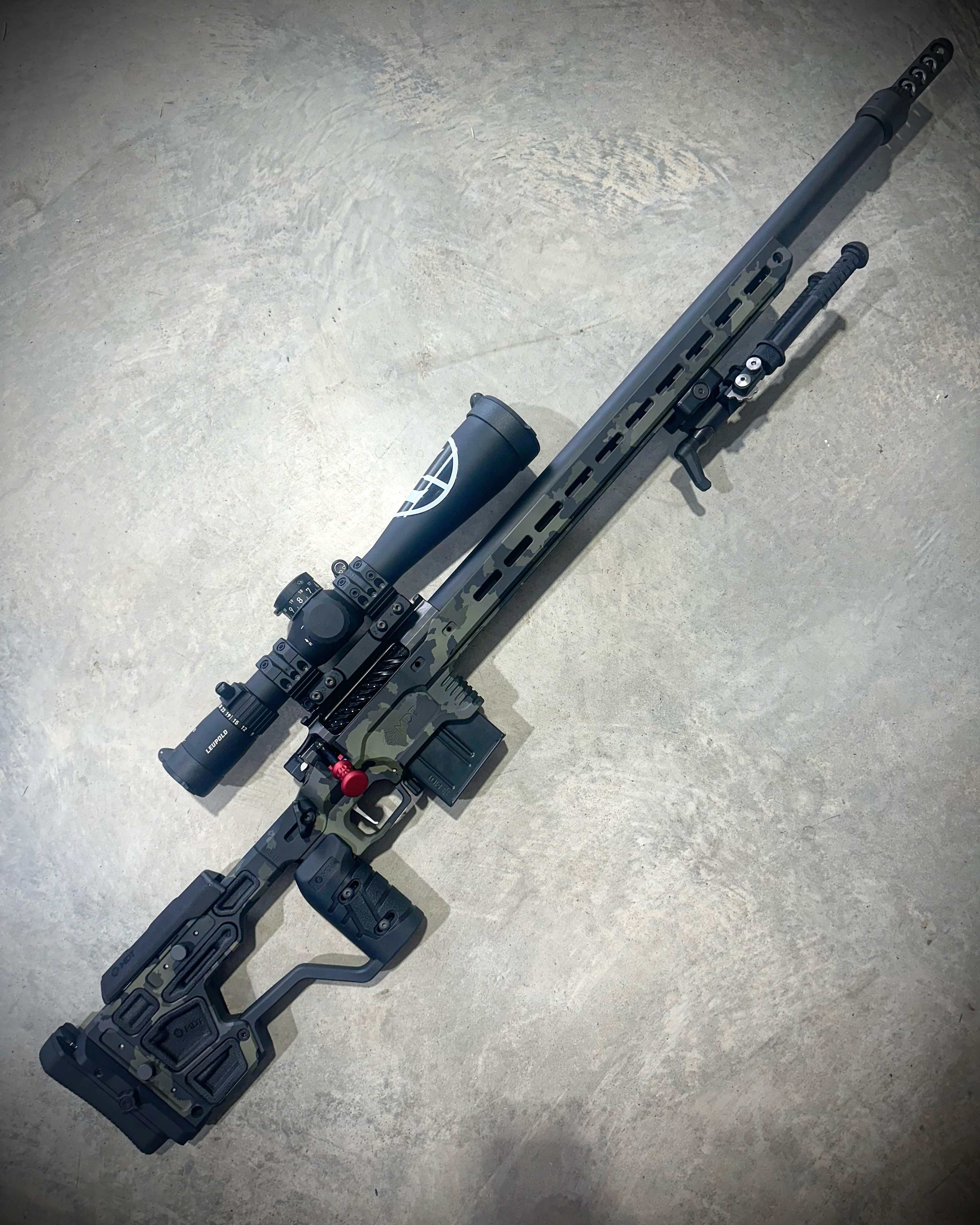

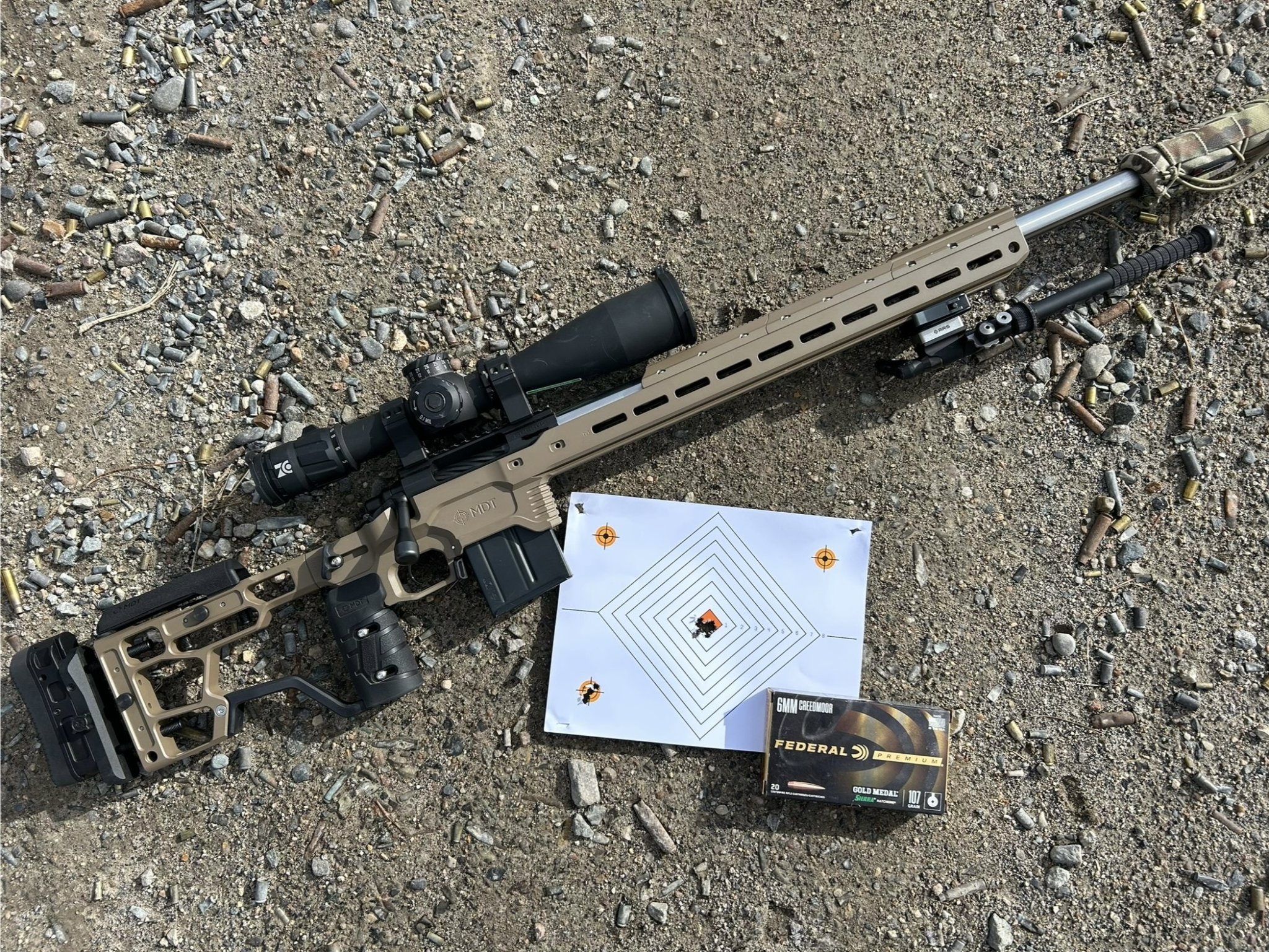

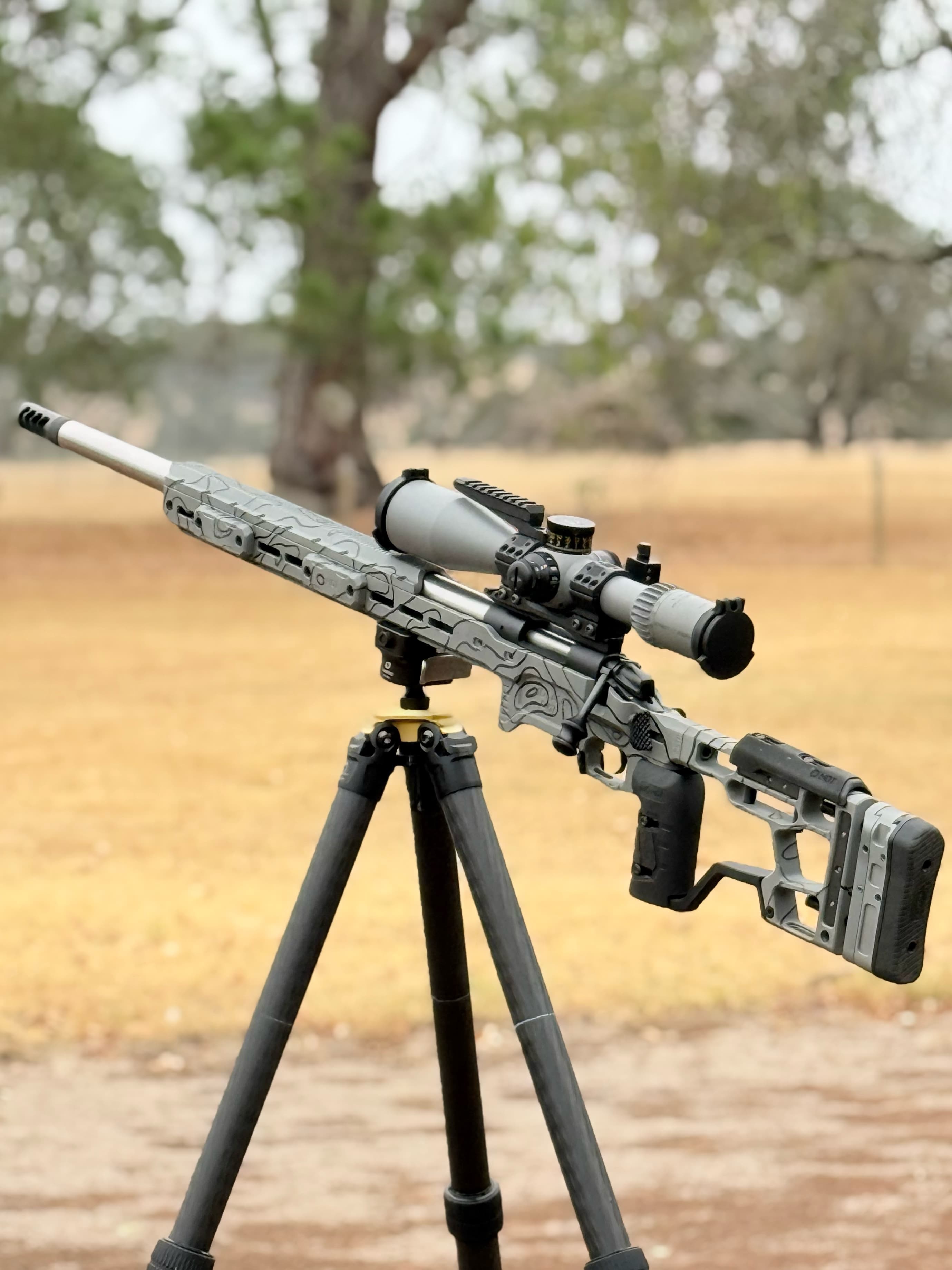

I like short suppressed rifles. What the minimum barrel length that the muzzle threading will clear the Elite hand guard? I’m thinking 20 in. Anyone has photos of a 20 in barrel in the Elite?
This is a 23 inch and a 22 inch. You could probably be fine with 20 inches.
Thanks for the pics man, that look pretty much perfect. I might just copy you and do the 22 in suppressed. Just have to use a shorter can.
Alternatively, we will have the new ACC Premier Gen2 available soon and the forend is around 2" shorter, meaning you could easily run a suppressed 18" barrel!

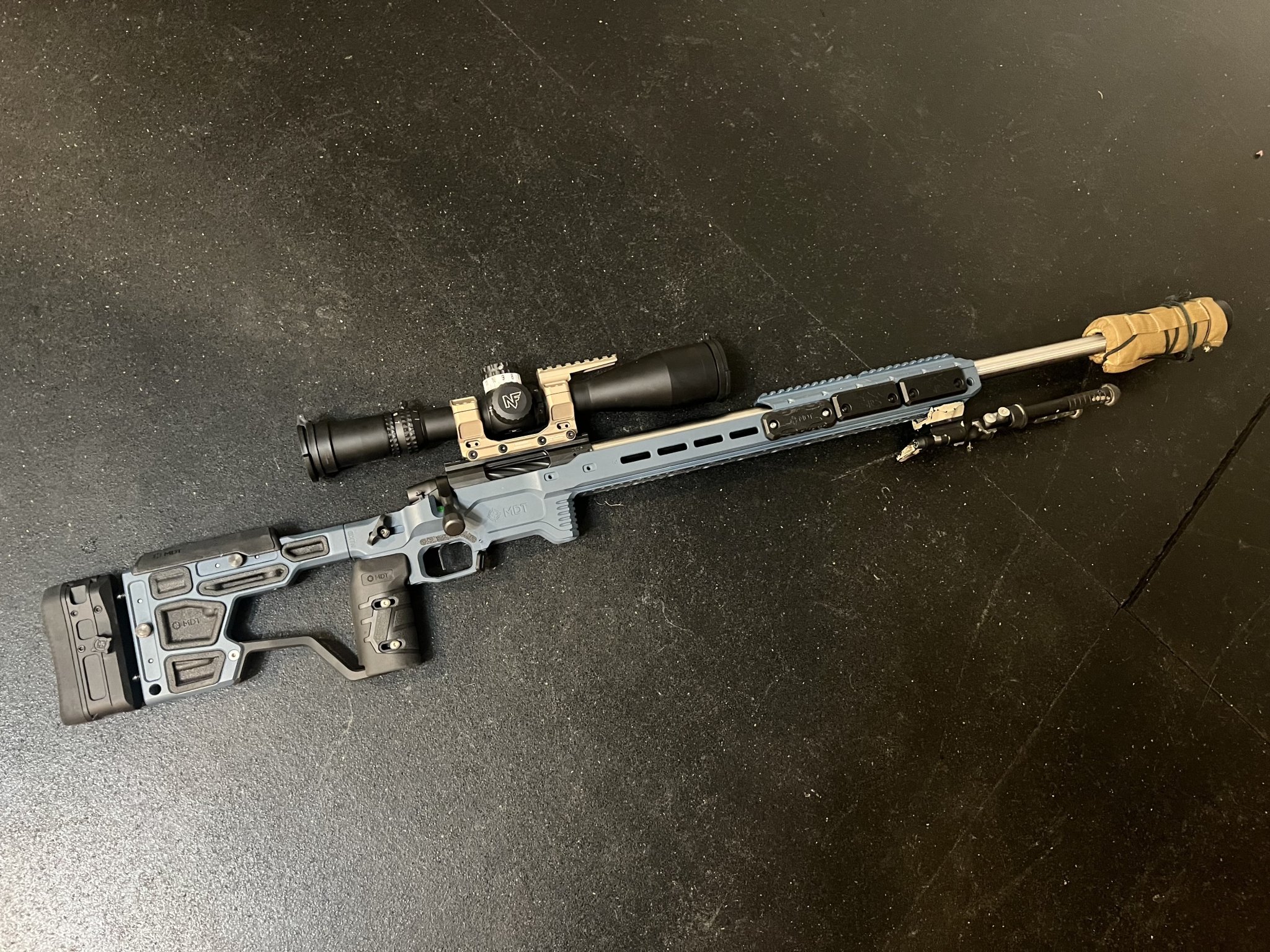

Looks like MDT won't have a rear bag rider available for the Elite until sometime in summer so anyone know if there is another source for a bag rider?

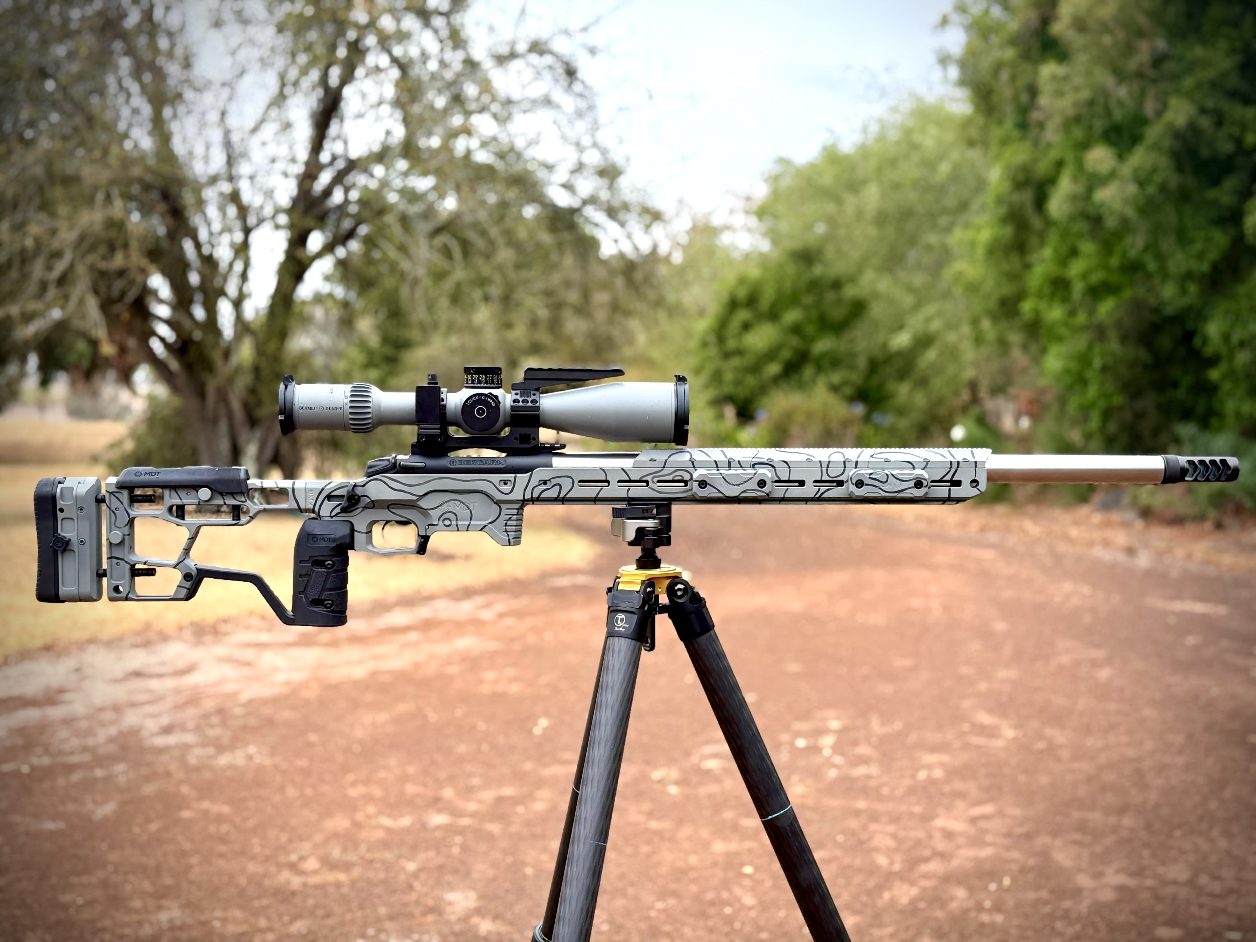

Just released. Bag rider for the ACC Elite.
CNC machined 6061-T6 Aluminum and Cerakote finish matched to the factory black.
Flat bottom with full radius edge for ideal tripod rear support engagement. Top surface has grip ridge texture to it (smooth). Does not stick out at all presenting any snagging surfaces. Tapers to match the grip support width. All other edges have a radius and are smooth.
Attaches with 2 MLOK fasteners (provided) into the MLOK slot on the bottom of the MDT rear stock. 4.9oz weight.
Tested by a top 10 PRS shooter. Everyone is happy. Get yours now.
Is this parallel to the barrel/forend or is it angled?
It creates a flat plane across the bottom of the rear stock. No relation to barrel axis, however it is very close to that axis.
Provides a 6.4" long flat area with a radius edge to engage rear tripod. The bag engagement part is a bonus. These chassis without a bag rider only leave a few inches of area in the rear where you are basically up in your armpit engaging tripod rear support.
In fact all, of our testing was around tripod rear support. Everyone has a place to engage they feel comfortable and stable and the full 6.4" length gives that room. Also this does not present a snag point like some of the other attempts I have seen at shorter versions.
The bag engagement is great too, but not much surprising there.

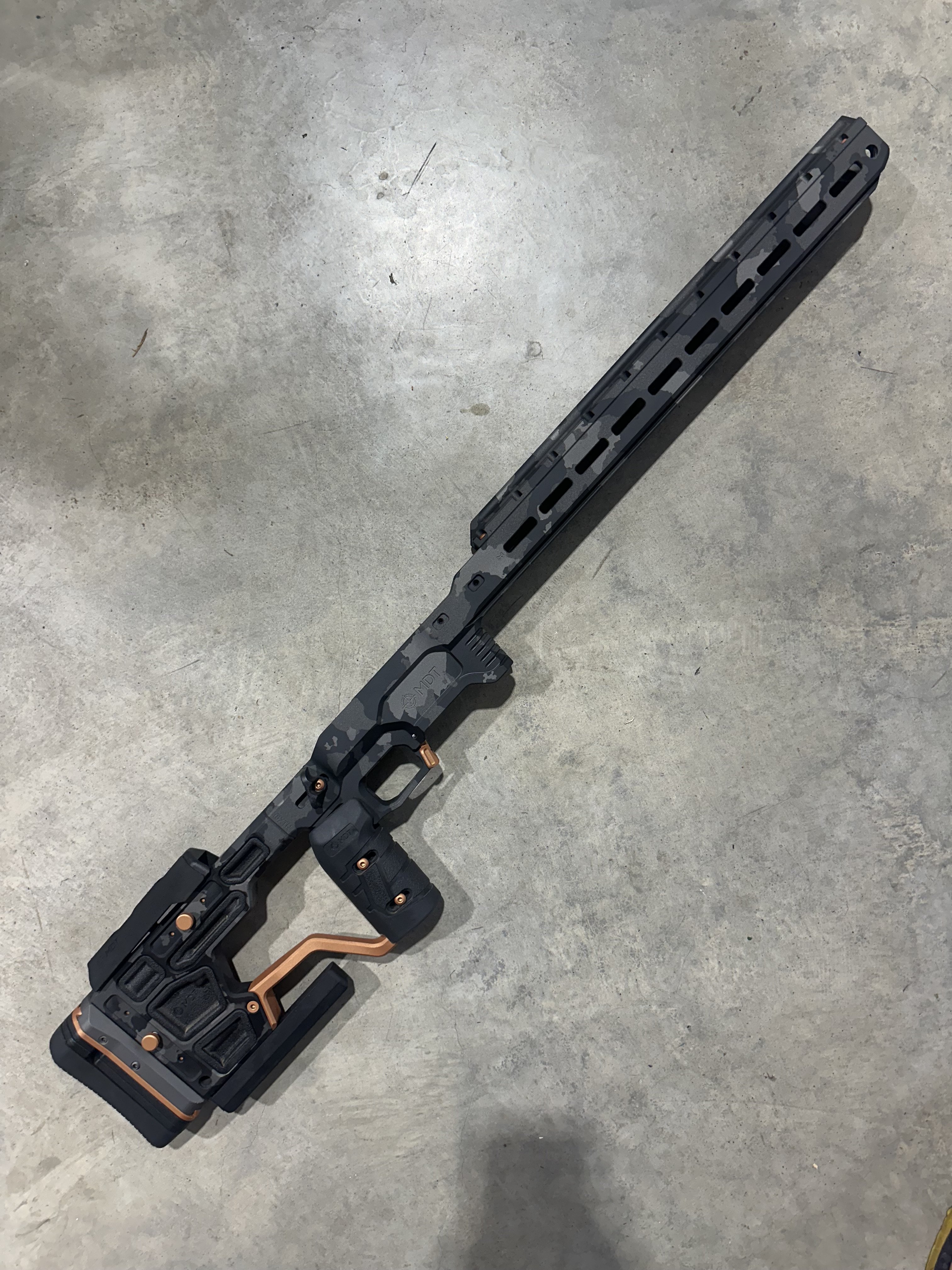

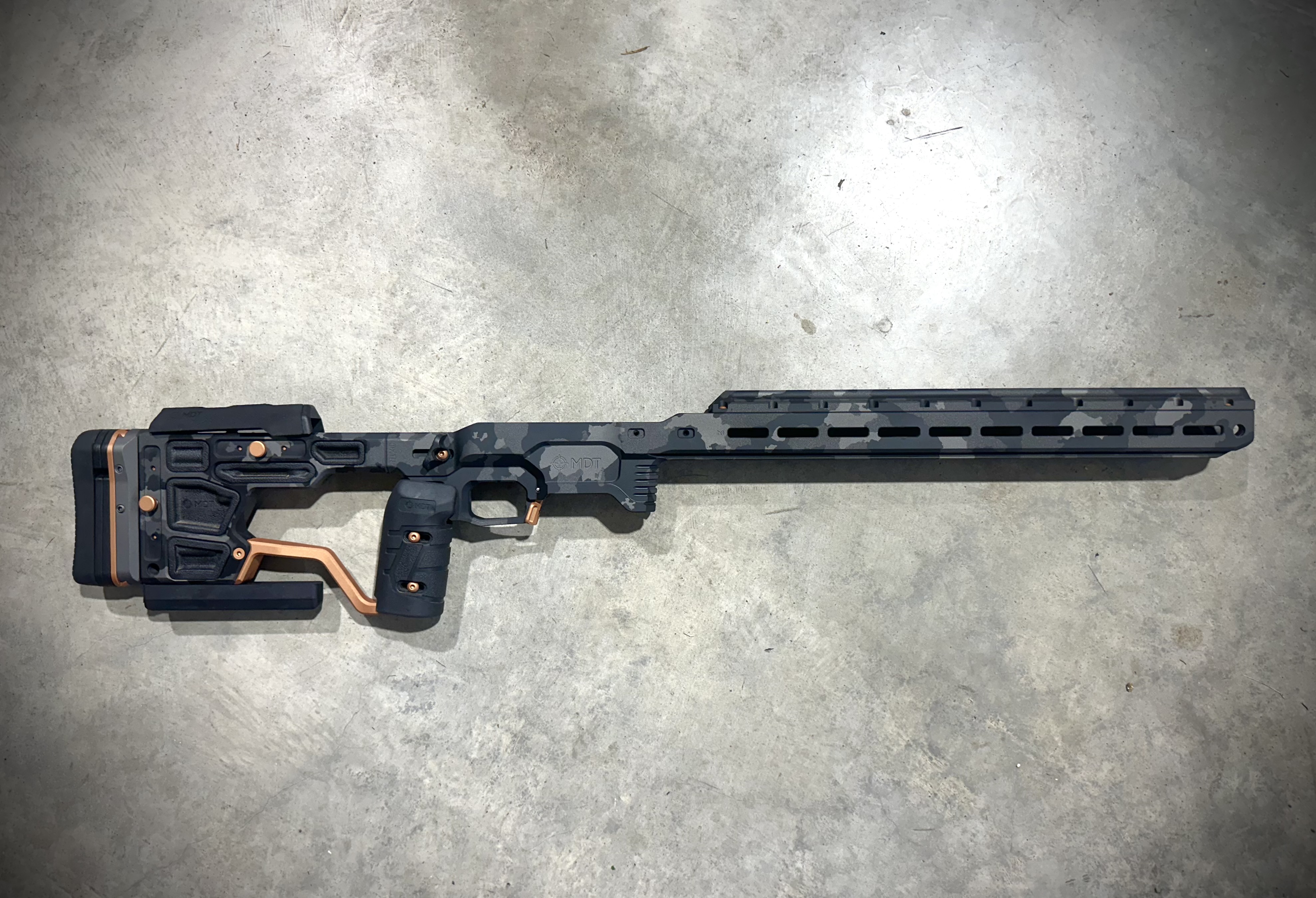

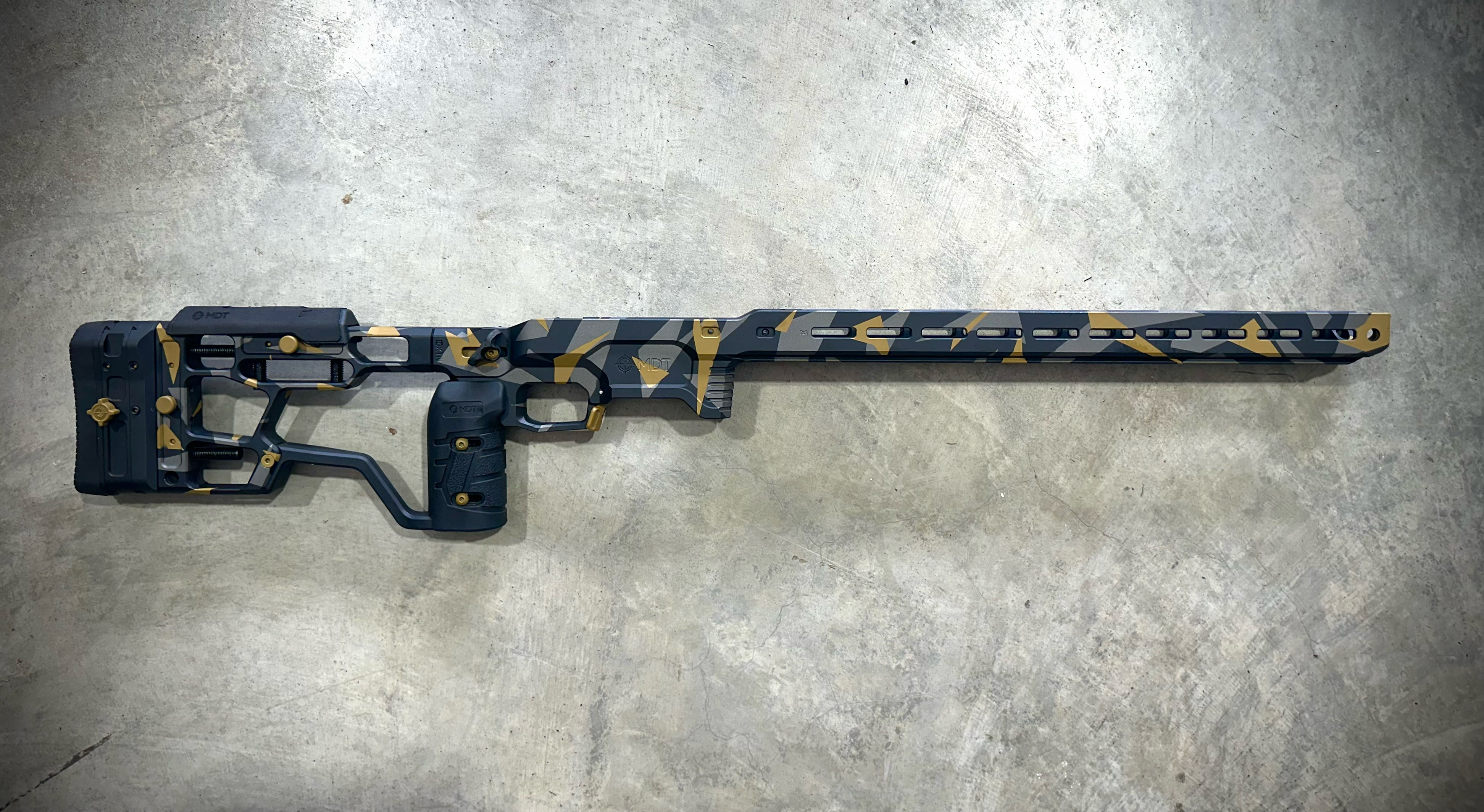

Any update on a folding stock for the ACC Elite ?
No positive updates for you yet. Our current folding stock (SRS-XF) needs to be updated and redesigned to better work with our newer generation chassis, and as part of that, I would like to spend some time to finding a good folder solution.
There are a few ACC style chassis floating around in the wild with integrated folders. I've no idea if these will eventually be available for purchase or if they're intended to be more of a Mil/LE specific product.
These are prototype chassis for a customer of ours and not an MDT retail product as of yet. This may be something that we retail in the future, however, we would need to make some changes and adapt it such that it is not identical to the one we have made for that customer.
- Josh
- Josh
