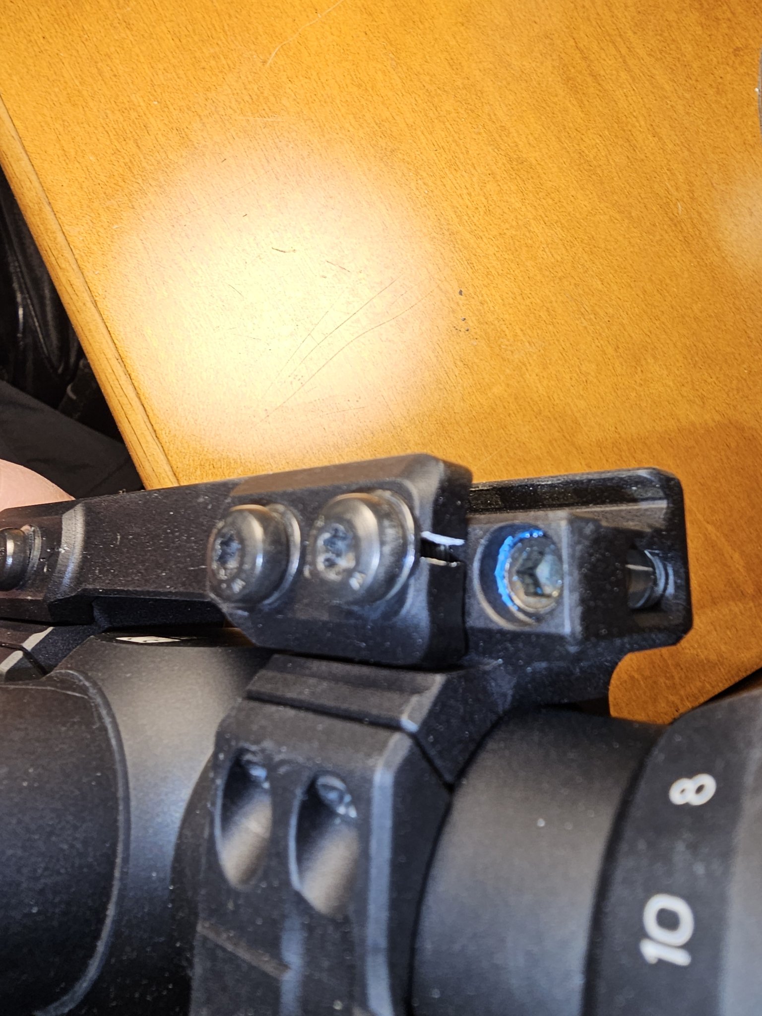

#metoo - cracked spuhr mount :(
EazyID
  • Jan 17, 2019
    1,346
    324
    Boise, ID
    Yes yes I know, many threads, but they all seem to degenerate into irrelevence.

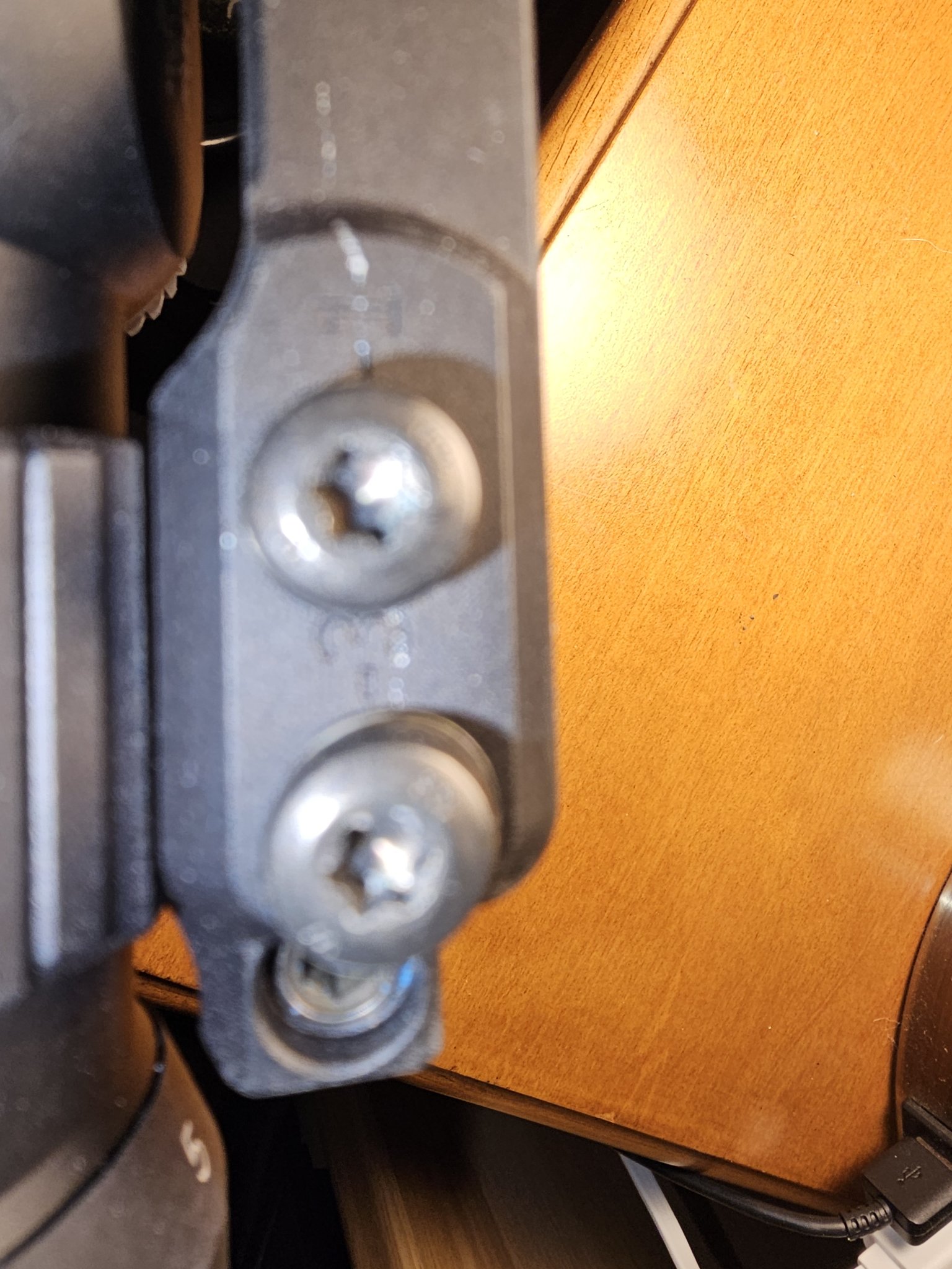

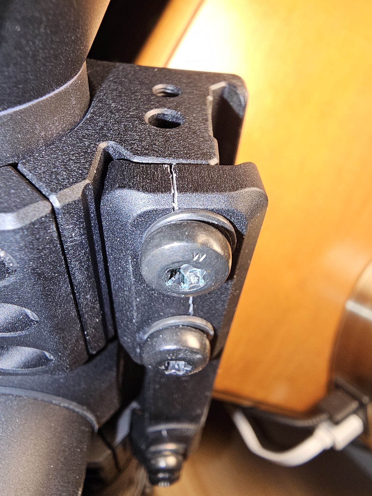

    Torqued to 45 with fix-it bit in order per ISMS Bible.....Shot.... put in safe....pulled out 4 months later and low and behold.....crackage. And no, I didn't use the wrong bit. The only higher bit i own is the big fat black 140, and there's no mistaking that beauty for anything other than my mk22 barrel swap.
    Luckily it's just the clamp bar as this is a discontinued model with perfect height for my gen 1 GAP-10.
