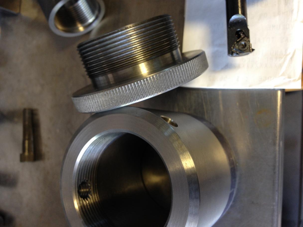

I hate to burst your bubble but it's not an uncommon practice to turn the tool upside down.
Guess you've been truing actions that way for years. I don't have any formal machining training to speak of. That post wasn't meant for master machinists like you, but for the aspiring up and coming that have to wing it like I did. Maybe someday, I'll be worthy of cleaning your lathe;-)
are manual lathes designed so the cutting forces are pushing down on the vee ways or pulling up?
Maybe it is going against the grain of the design but it works. Helps to have a heavy machine;-) I doubt cutting a thou or 2 on a pass would be a prob on those old flat way machines.
PM me, I won't "out" them. I've just never seen anyone else do it. But then again, I don't get out much;-)
Using tooling "upside down" is nothing new at all. It's common enough I wouldn't even call it upside down, I'd call it effecient use of tooling. It is a pretty standard setp on a CNC lathe as well.

HTF do you see the cutting edge of your tool when it is upside down on the back of the part? you can see the bottom of the tool, sure but guess what? that isn't what you are trying to see when chasing a thread. I think i'll stick to a method that loads the machine as it was designed and I can see the cutting edges of the tool.
as far as inverted tooling being discussed, 2009: http://www.snipershide.com/shooting...ous-about-threading-my-barrel.html#post165793
It's not a matter of seeing the cutting edge of the tool. It's a matter of ease of use. (not to mention setup) My lathe is covered with oil and chips. I damned sure don't want to climb on it to index a tool on a receiver thread in the blind side of a hole.

i have not tried this yet but i have heard it recommended a few time and it makes sense. run your spindle in reverse, your threading tool upside down and feed away from the shoulder. this way you can disengage the half nut at your leisure.
since i use triangle threading inserts, if i inverted my threading tool the tip would be away from the shoulder. this made me think about using my internal tool correct side up but on the back side of the part, again with the spindle in reverse and feeding away from the shoulder. it's not as rigid as the external tool but i usually take light cuts when threading anyways.
i have heard people say that with a loose lathe, using an inverted cutting tool can cause chatter since the cutting action is "lifting" on the carriage. i think an internal tool on the backside would eliminate any possibility of this.
I don't get your obsession with threading to a shoulder. Maybe it's your lathe. Mine is a Clausing Colchester. Reverses with a throw of a lever. Back out your tool and reverse simultaneously. Works like a bread slicer;-)

Because pictures aren't on the internet to prove it you think machinists aren't aware of your new discovery? I asked the guys in the shop yesterday if they ever thought of running tooling inverted and they gave me a blank stare like it was a trick question or something. Well of course they've all run inverted tooling at one time or another. Hell there's a slant bed CNC lathe six steps away that's full of it and why wouldn't we run it on the manual if needed? Maybe there aren't as many stupid machinists out there that you think there are. Maybe they just don't find the need to take pictures and post them on the internet to validate their work.
I have tried and do use your new found method. I thought I've stated that already. I don't find running the tool inverted on the backside easier when chasing an internal thread for the simple fact that I can't see the insert as well as I can running the toolholder conventionally on the front side and no I don't have to crawl over my lathe or use mirrors to see it either. It did occur to me at one point in the past that it might be a great way to true an action. I tried the setup and rejected it because of what I just stated. Maybe it's the small IC insert (3/8") on my internal toolholders that makes it hard to see but it's just my experience and my preference.
Here's some parts I made using your discovery. Of course I made them prior to your announcement of your discovery but I can't prove it because I didn't post it on the internet prior to you doing so. The male thread was made first and is a gage for the lock collar (and for future collars). I used the toolholder inverted for the internal threads so I didn't have to move the compound for reasons you have given. I just validated one of your discoveries in case you didn't notice.

All the lathes in the shop were set up with O.D. threading tools set to run upside down back when I served my Toolmaker apprenticeship... almost 35 years ago. Our parting tools were also set up to cut upside down.
