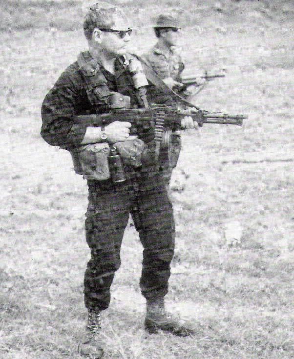

Just FYI. Here is my RPD, cut down, still heavier than hell. Used in Vietnam in this configuraton, I can't imagine hauling this thru the jungle. Con's: heavier than hell Pro's: big bullet, makes the same noise as your enemy and can use their ammo.
RPD at 100 yds on 12 inch plate.

Just FYI. Here is my RPD, cut down, still heavier than hell. Used in Vietnam in this configuraton, I can't imagine hauling this thru the jungle. Con's: heavier than hell Pro's: big bullet, makes the same noise as your enemy and can use theur ammo.

RPD always seemed to me like a fun one to play with, minus the sheer weight. The Soviets did not really go in for grace in their designs, did they?
