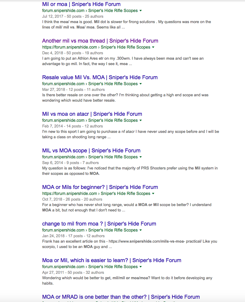

the MOA/MIL parameters is too short for the search function, so you won't find the threads using SH search. but google brings them up
Google should be everyones first port of call for any questions about anything.
There aren't many questions that haven't been asked on a forum somewhere in the world.
Best part about using Google is you can get hits from forums on all corners of the world, often showing points of view that you might not find here or other similar USA based forums.
