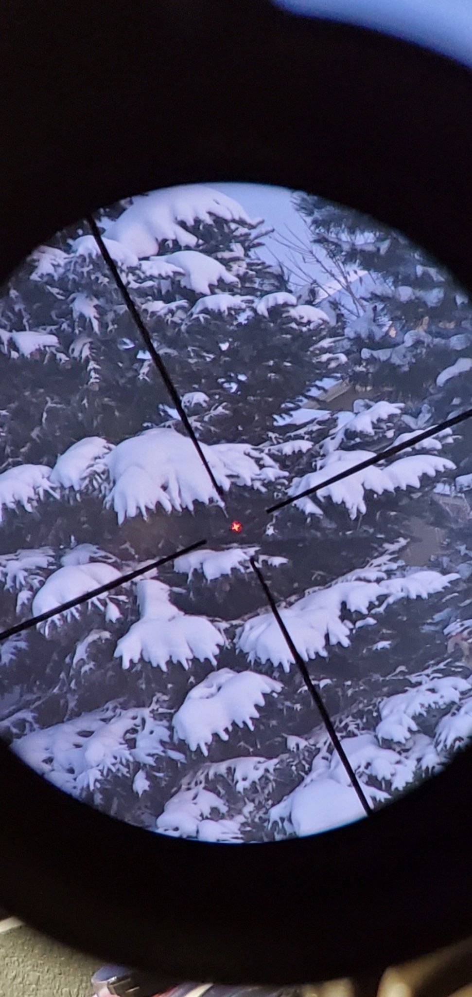

Here is the MR2 at last shooting light on 3x with illumination on with the center in a dark pocket. Phone picked up more light in the picture as it was most likely too dark to shoot in that photo but you can clearly see the vertical and horizontal dark lines that center your eye to the center. You really don't need illumination on these scopes for hunting, but in the last minute as shown in the photo it's plenty good. The gen 2 mil dot in the TT is just about the same.
I know you mentioned you don't need some of the features. To be honest I don't use many of them either. Just showing what the reticle is like in the last shooting light and the gen2 mil dot will be about the same in this scenario.
