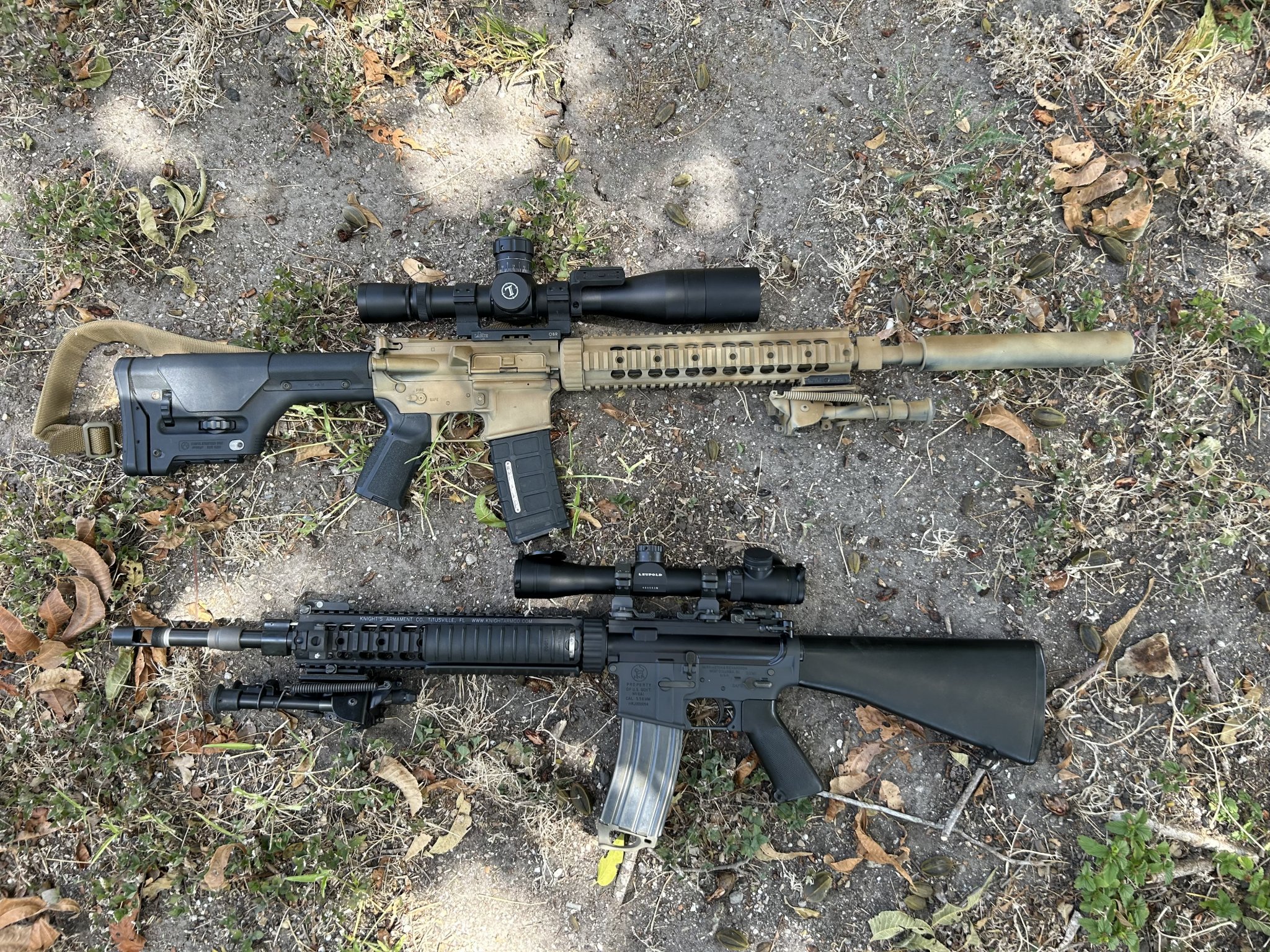

Been running AAC 77 SMK and their in-house OTM projectile loads lately (with a local store to buy from). Couple of groups from the last outing at 100yds.

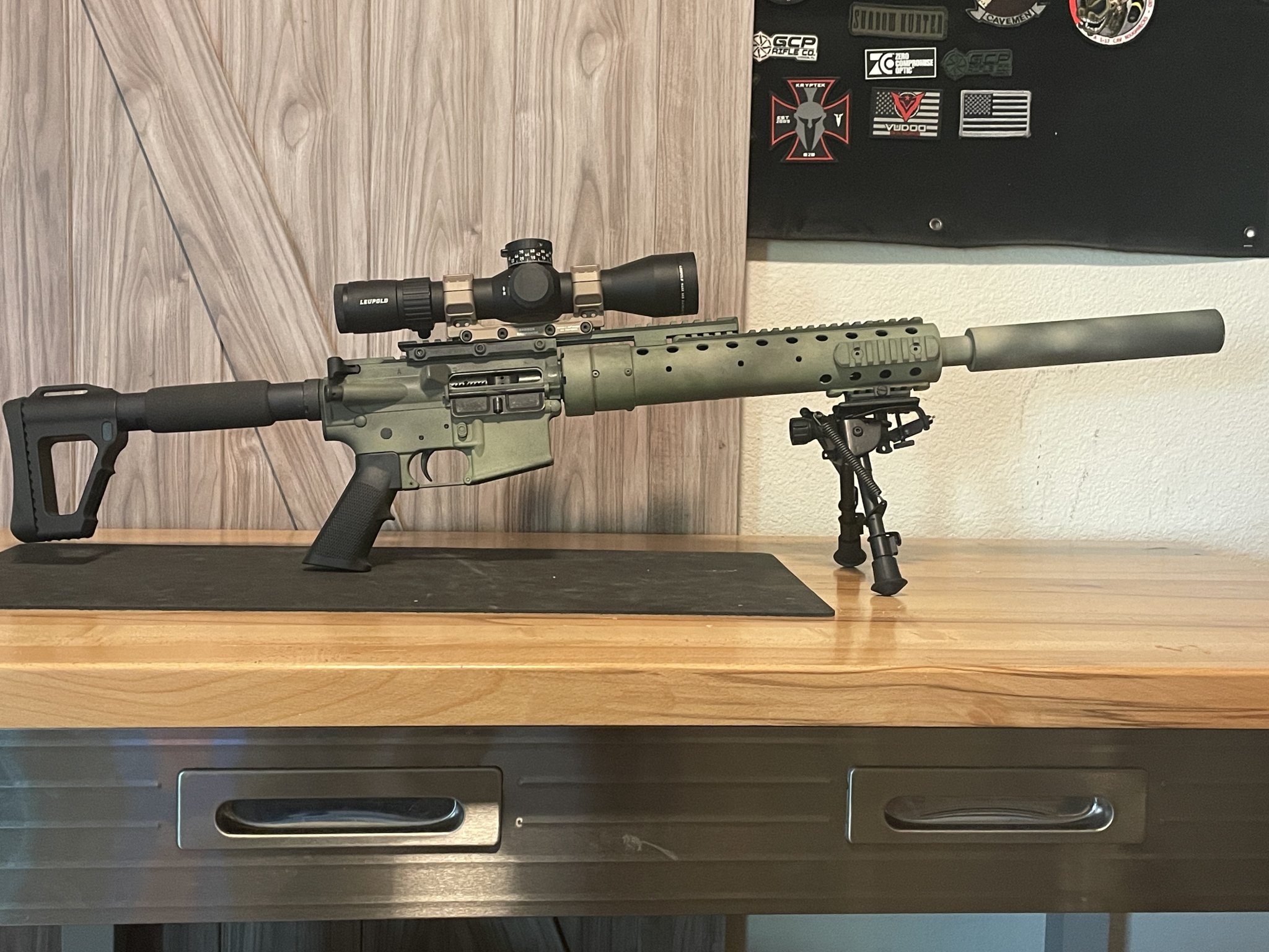

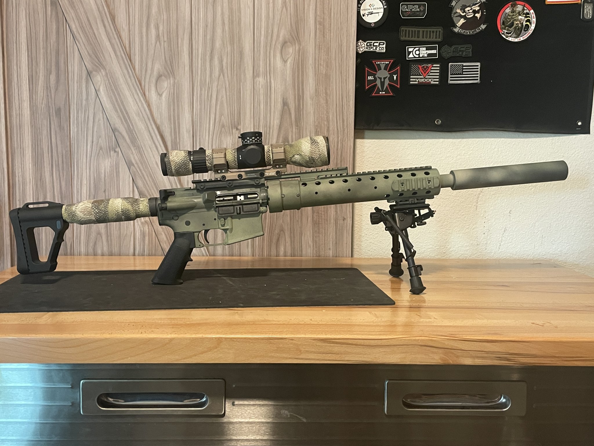

Snagged an H&R M16A1 lower last year from the first batch to repurpose the Nodak A1 lower it had...love the grey so left it as is and didnt repaint. White Oak SPR barrel. A5 receiver extension and A5-H1 buffer. Geissele BCG and SD-C. An old Battleline Industries SAPR attachment for the stock. Put the Vortex 1-10 (NF Unimount) back on it again but need to pick up a higher mag NF. Every time I shoot this I come back to wanting more mag.

Not really a Mk12 then is it
This.

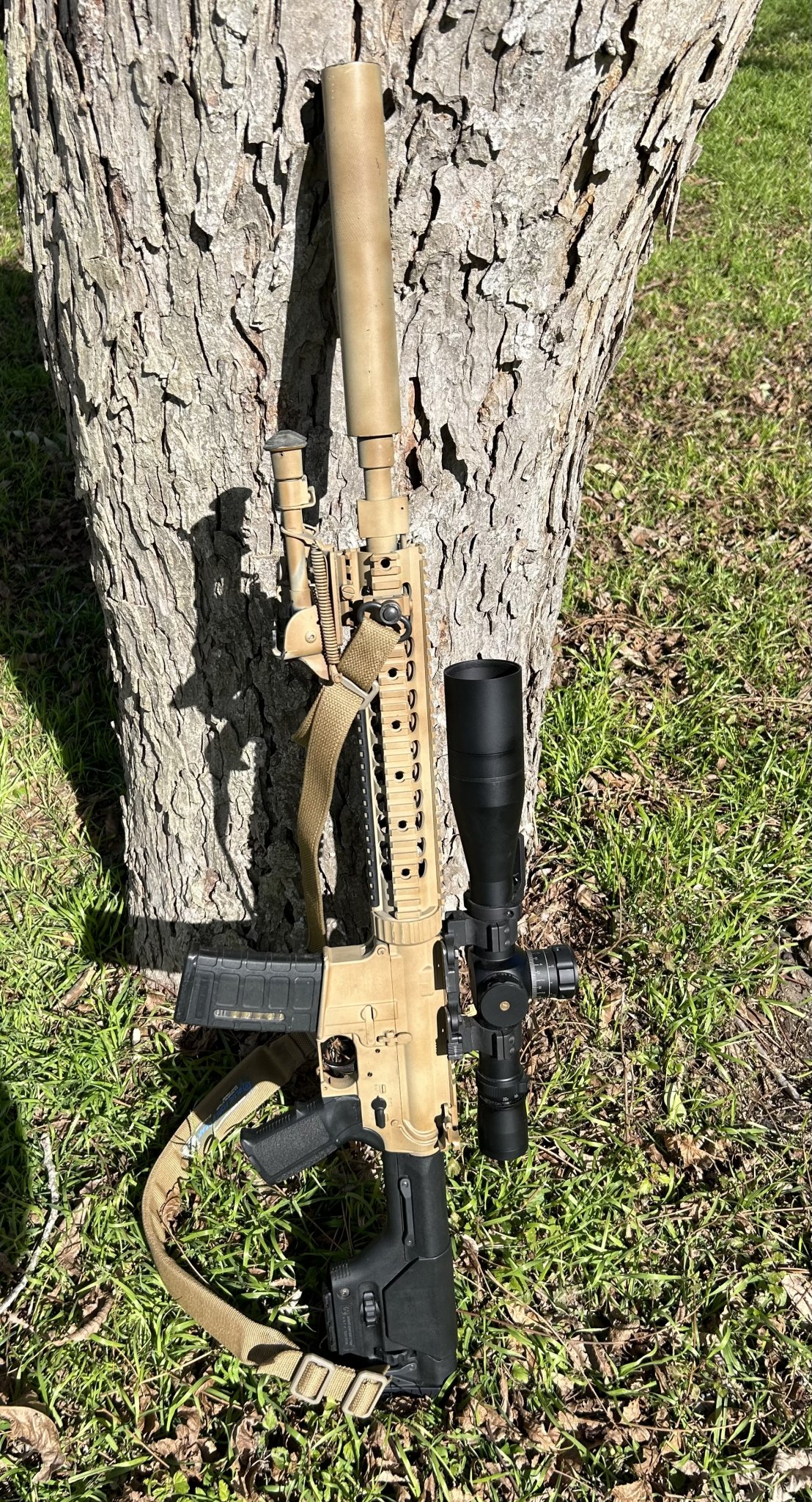

Finally got mine done. Ordered the KMW pod loc this morning. Decided to go with the 3.6-18 like @5RWill did. After I shoot it I will finish up the Krylon
Looks great!

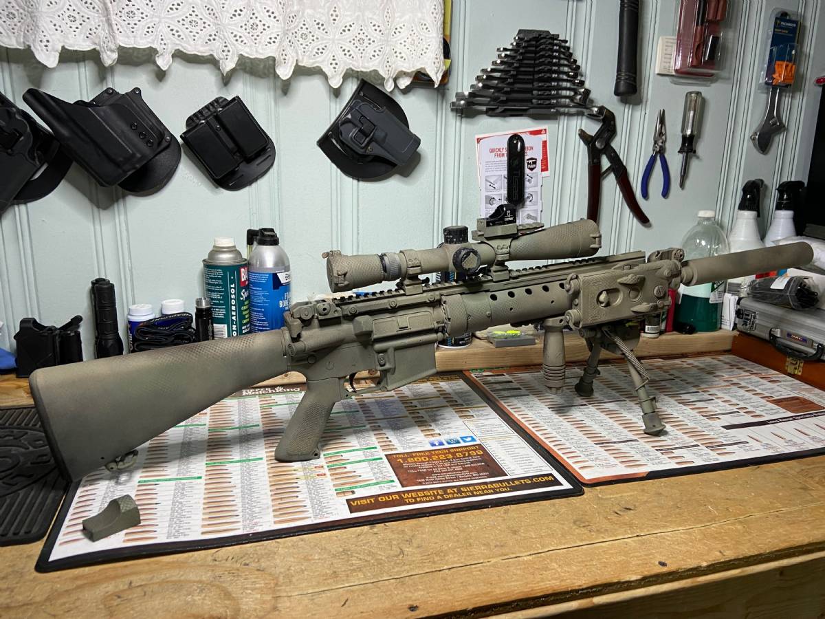

Mod H. Got rid of the RAID-Xe, I've been through several dozen of lasers and always go back to ol' faithful LA-5B or an NGAL. OCM5 still waiting in jail.
Using this with the CNVD-LR is a bit of meme, need to be at 8X to really make use of it and at that point, it's what the SR25 is for in a way with a 4-20 ATACR.
