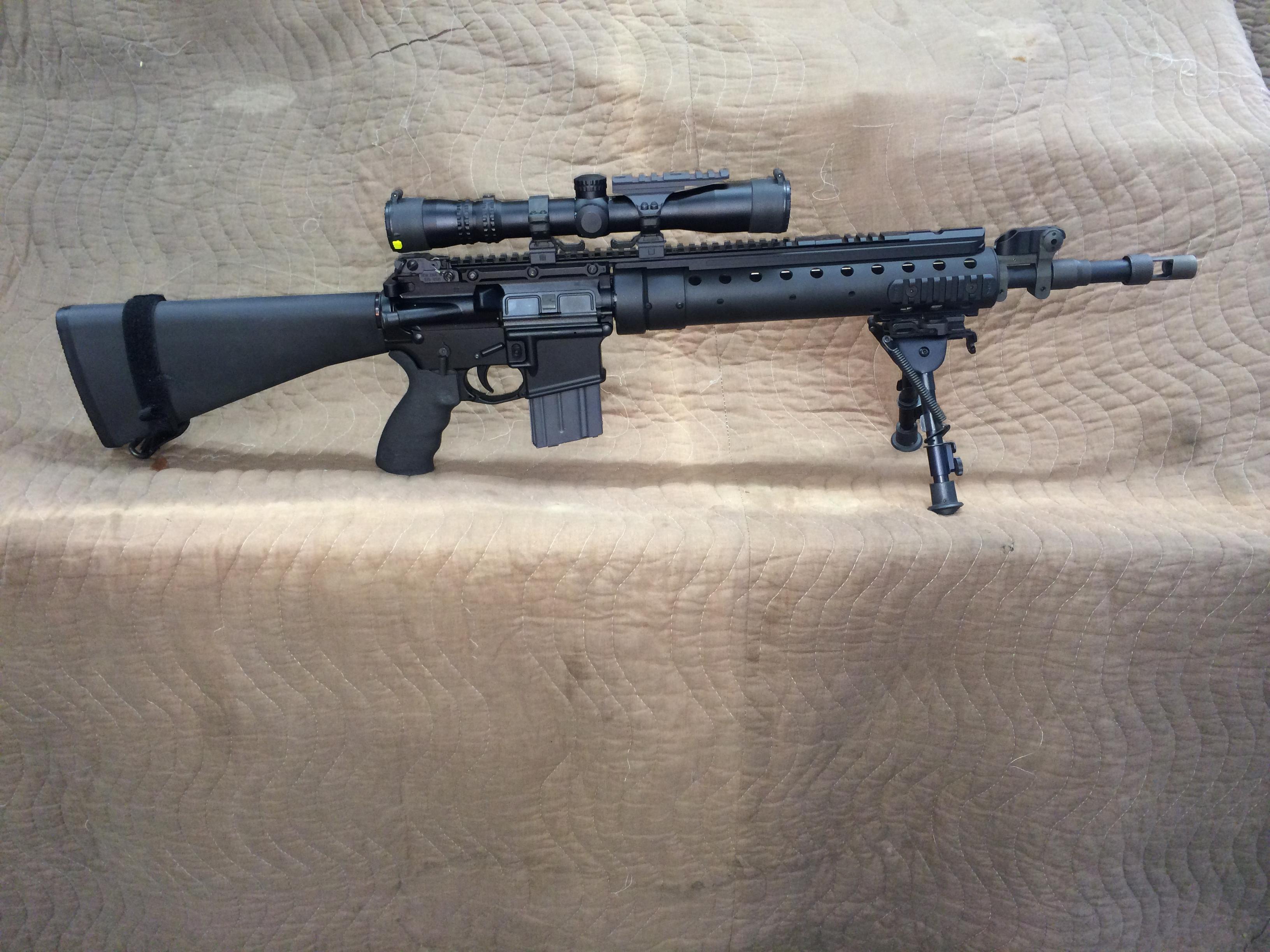

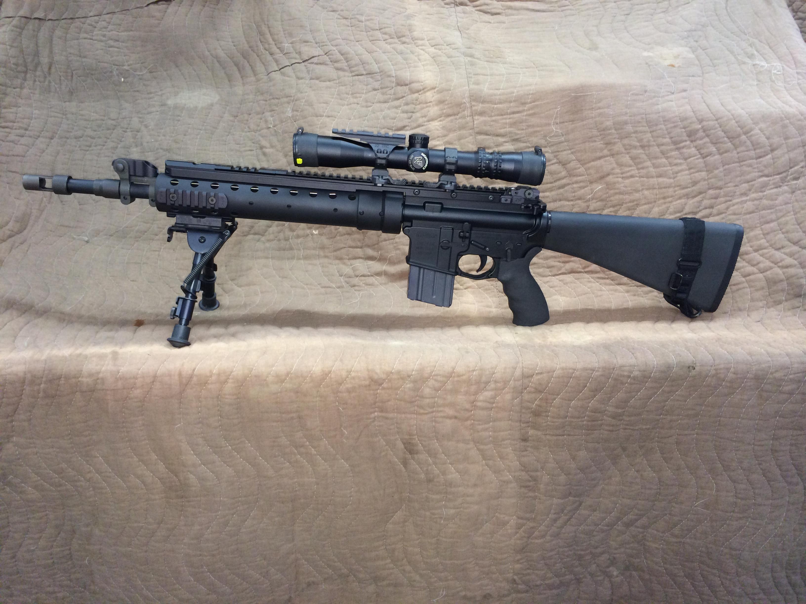

I built the one shown in the top right corner of this Wikipedia page:
Mk 12 Special Purpose Rifle - Wikipedia, the free encyclopedia
That photogenic backdrop is my washed rock patio.
The funny thing is it's not a Mk 12 at all, but a 100% correct SPR upper in "pre-Mk 12" format. The lower was 100% what I liked, not Crane at all. Wikipedia of course never asked me what it was.

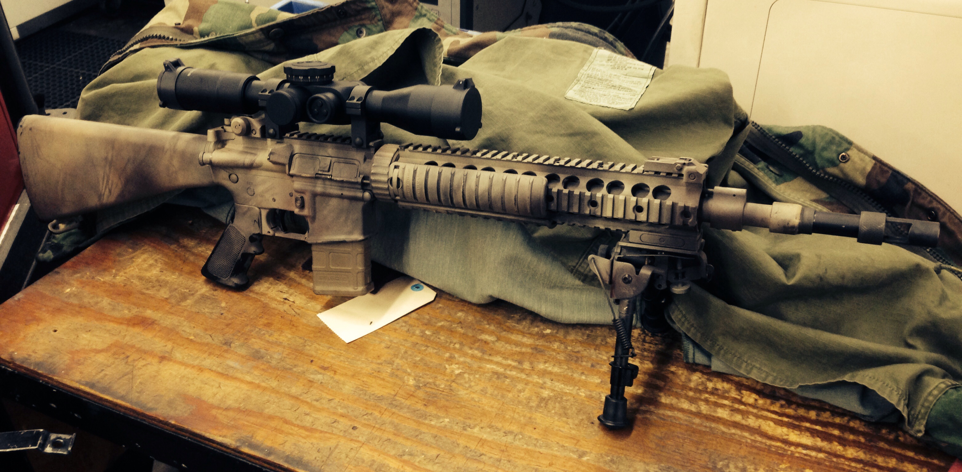

Let's hope this works.
It's been done other than the can since summer. You all are the first to get a pic.

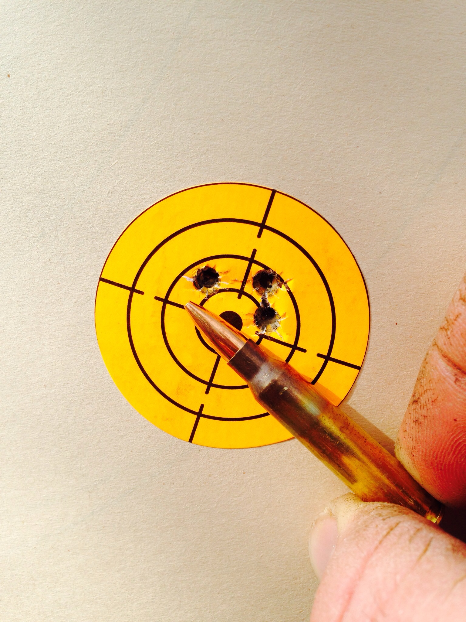

My MK12 Mod O Clonish. Using Black Hills Red box 77 grain .223 loads I was able to get these groups.
5-1/8'' group at 800 yds - 8.9 mils of elevation.
3-1/2'' group at 600 yds - 5.2 mils of elevation.
Used an Accuracy First Wiz Wheel. I am right at sea level.

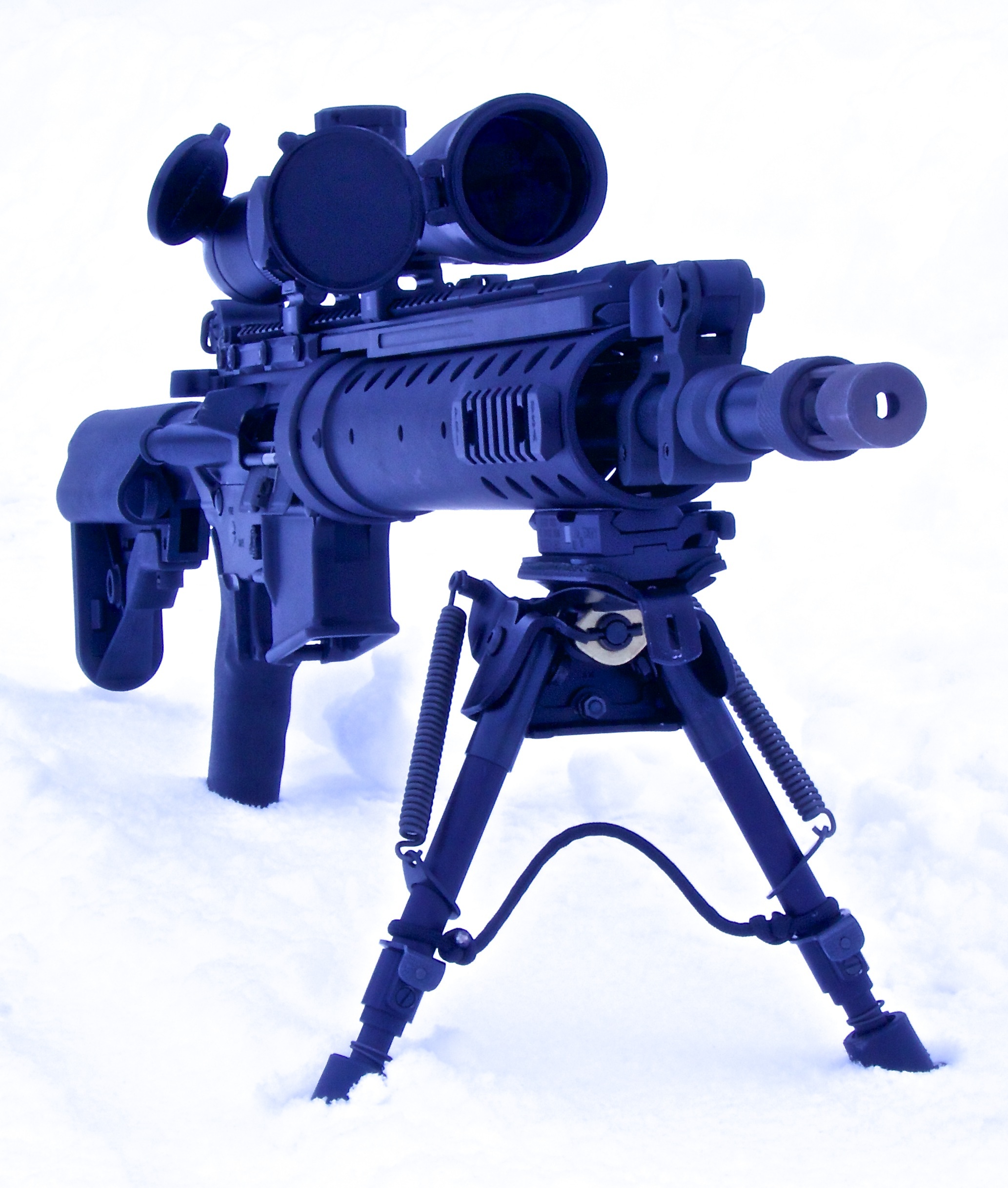

Here is my Mk 12 Mod Merle rifle I recently put together:
I used a Daniel Defense rail instead of KAC and a Vltor upper. The parts that matter most are up to standards like the Centurion Mk 12 barrel and the KAC 2 stage trigger.

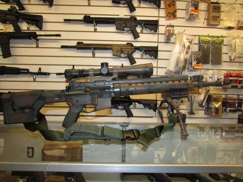

Billet SH MK12 Mod0
High Caliber Sales Built
16” Douglas stainless barrel 1:7 twist with OPS INC collar and brake
Battle Arms Development BAD-A ambi selector fitted with Short left and end plate right (non-ambi)
PRI Gen III fore end, PRI gas block/front site, #40 standalone ARMS rear site, PRI’s SPR-PEQ sleeve
Larue LT706 Atlas V-8 Bipod
Area53 SH Edition Billet Lower
Spikes Tactical Gen II Upper
LMT Machine Enchanced bolt carrier group
Sierra Precision Grip
V7 Weapons systems: Ti Gas Tube, Ejection port door, port door pin, light catch, titanium take down pins unfinished, titanium grip screw
Seekins Precision Catch Button, enhanced latch
KAC 2 Stage Trigger
MagPul UBR buttstock with MagPul Strike Plate and Modular Driven Technology Adjustable but pad
Fortis Rail Attachment Point
Magpul Flat Foliage Green Cerakote
KNS Anti-rotate pin set Gen
Badger Ordnance Tactical Charging latch Gen I
Tactical Springs LLC White H2 Buffer
BlueForce Gear Padded two point sling
Damage Industries Quick Detach Sling Swivels Unfinished, Cerakoted
Colt Small Parts Kit
Cerakote on all but lower by Spectrum
AEM5 suppressor pending
