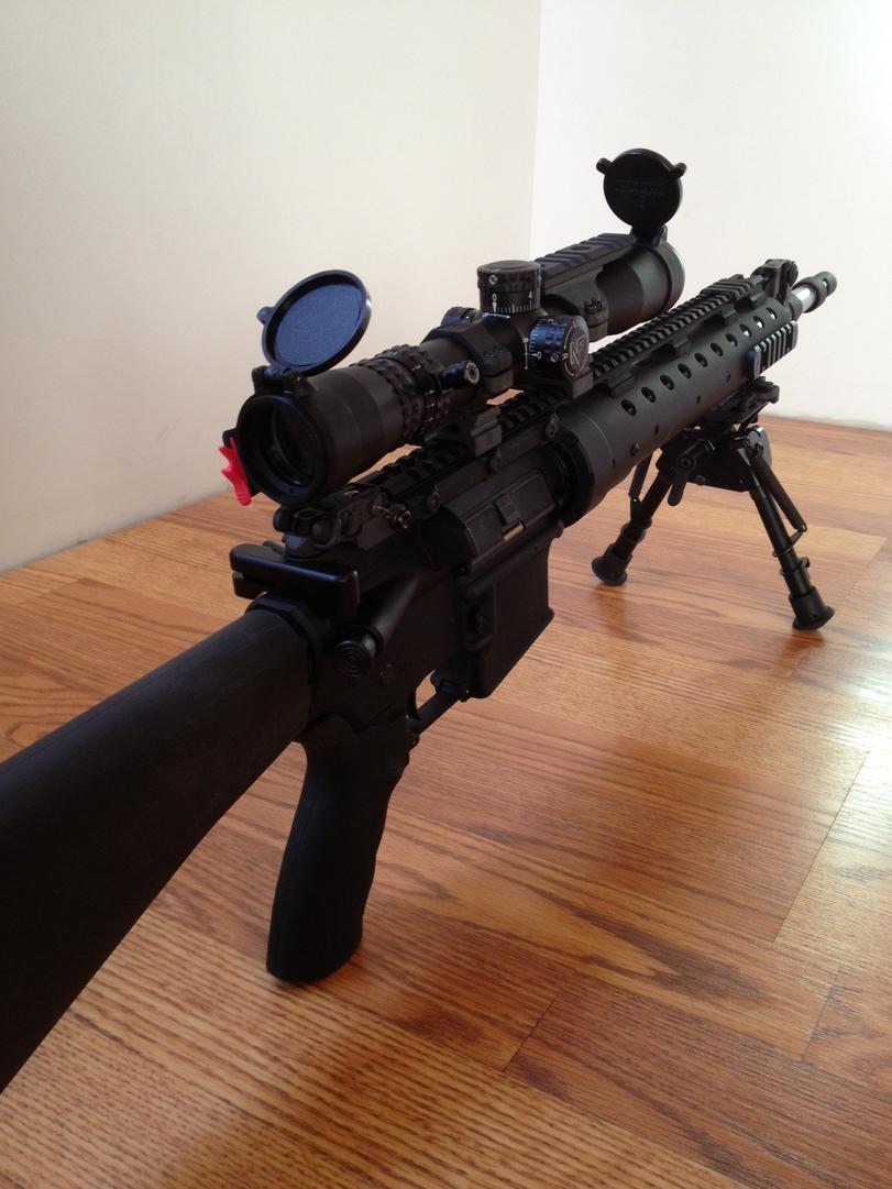

Here's mine. Built it over the winter.
Rainier Arms matched upper and lower
Douglas SS DMR barrel from Fulton (Navy overrun).
VLTOR EMod
Harris bi-pod
Vortex 5-15X from Midway w/ Mildot.
AMD 20 MOA mount.
I'm a transplant from barfcom, although I feel more at home on m4c. Hope to become a contributing member here.

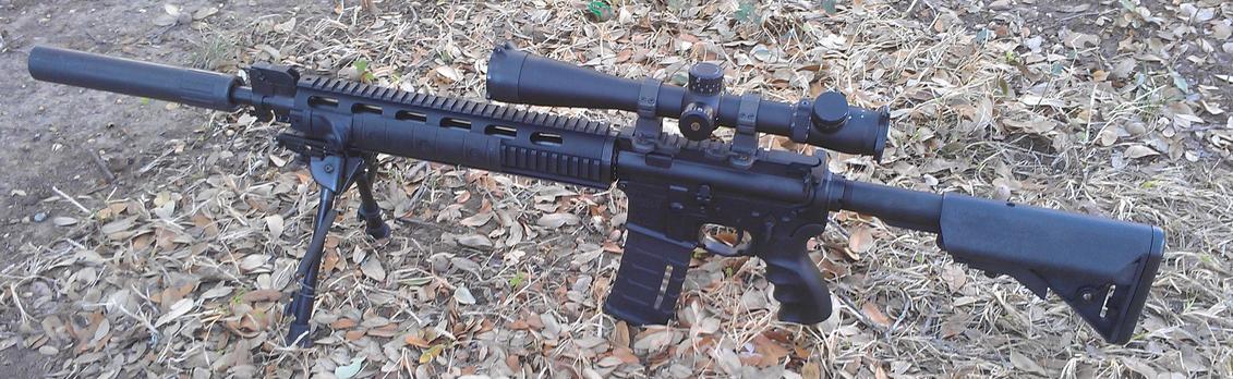

Not a really a Mk12, just a DPMS mk12 with an AAC SPR-M4 and Mk4 3.5-10, but I absolutely love this rifle, it's ragged hole accurate and I've range steel at 600 yards and beyond with 77grn black hills.

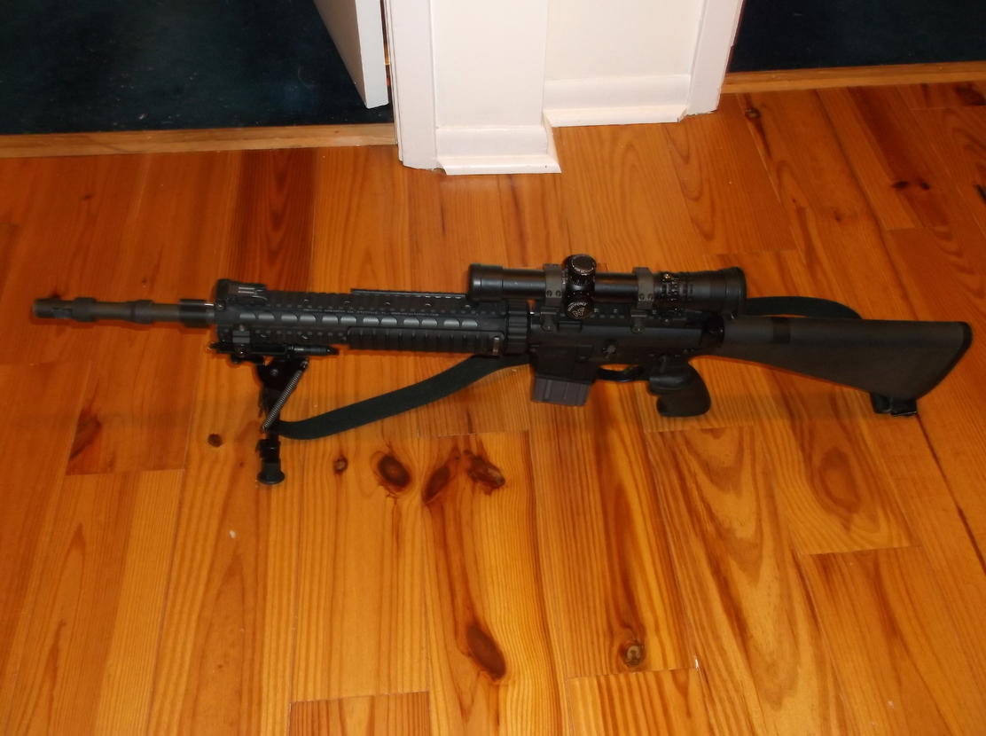

Here are a few photos of my Mk12 Mod 0.
Mk12 Mod 0 SPR
18" SS Douglas Barrel from Compass Lake.
(SPR contour with AMU Chamber & Matched bolt)
Bravo Company BCG
Nightforce 2.5-10x32 Mil/Mil with Zero Stop
PRI Gen 2 Carbon hand guard
PRI Gas Block/Front folding sight
PRI Gasbuster charging handle
Ops Inc Muzzle brake and collar
Noveske N4 Lower
Geiselle SSA-E trigger
Colt A2 Stock
Harris 6-9 bipod BR-S
Pod Lock
ARMS #32 QD bipod mount
ARMS Swan Sleeve
ARMS #17l BUIS
ARMS #22 Rings

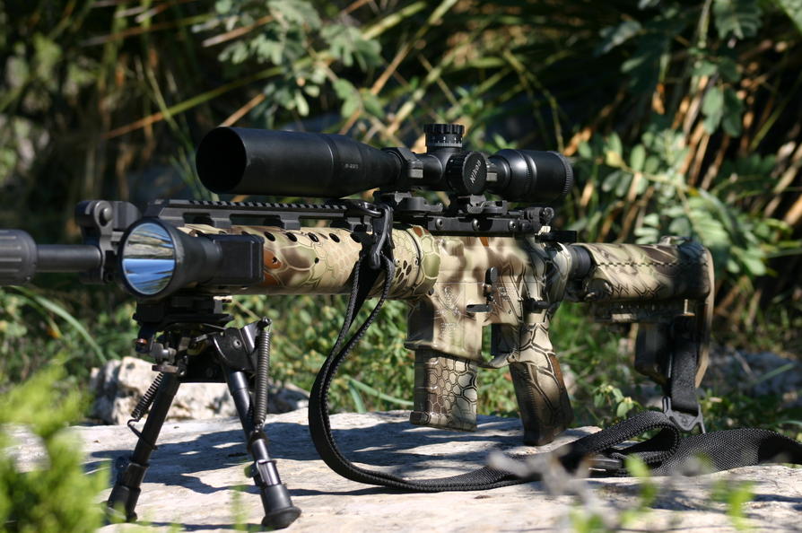

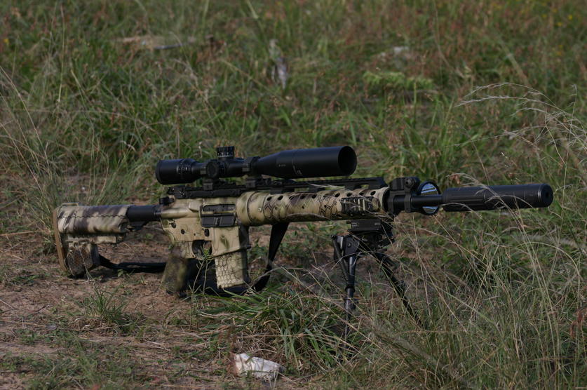

I still can't seem to get the recipe right. Every time I try for a Mod 0 build, I end up doing it wrong. This one ended up about 3.5" short, and chambered in 300 Blackout.... Weird, right?
That looks awesome. I just ordered a 16" barrel to use with my suppressor. I've been thinking about going with a PRI tube. I dig your rifles color too.
Thanks :) The color is a mix of Burnt Bronze and Armor Black Cerakote. The ratio was 10:3 Bronze-Black. It took a while to find a good ratio that didn't end up looking like either gunmetal gray, or just like Burnt Bronze. I really like the PRI tubes. Light, rigid, easy to install and they don't get too hot to handle from barrel heat or from being out in the sun. They are a bit spendy though. I saved some money by going with the most basic model they had, with no pre-drilled holes. With the 14.5" barrel with pinned/welded brake, the suppressor I eventually plan on getting for this one should tuck inside the handguard about an inch. I'm using a Spikes Tactical alignment collar, which needed a .700" diameter X 1.00" inch long step turned at the muzzle to get the right spacing between the mounting threads and the shoulder on the collar.
