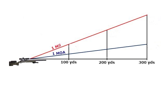

A MIL is equal to 1/1000 distance to target.
Period there is no argument, the measurement doesn’t matter if it’s standard, metric, shoe size, your height, dick length or fucking light years away.
Show me a MOA shooter who can tell me how big a MOA is at 947 light years? Take your time and use google……
MIL shooters will do it in their heads before you get to hit the search button or beg Siri to find it.
A MIL at 947 light years away is equal to .947 of a light year, 1/10th click is .0947 of a light year adjustment.
Want to screw around and convert it to another unit of measure go ahead, but you’re literally doing all the work for nothing.
Base 10 numbers isn’t metric. Surveyor's survey in 1/10’s of a foot, does that make them metric? How about machinists breaking an inch into 1/1000’s?
Funny how a MIL is equal to 3.6” @ 3600”s, or 36” @ 36,000”s ……..must be a mistake right? 🧐
