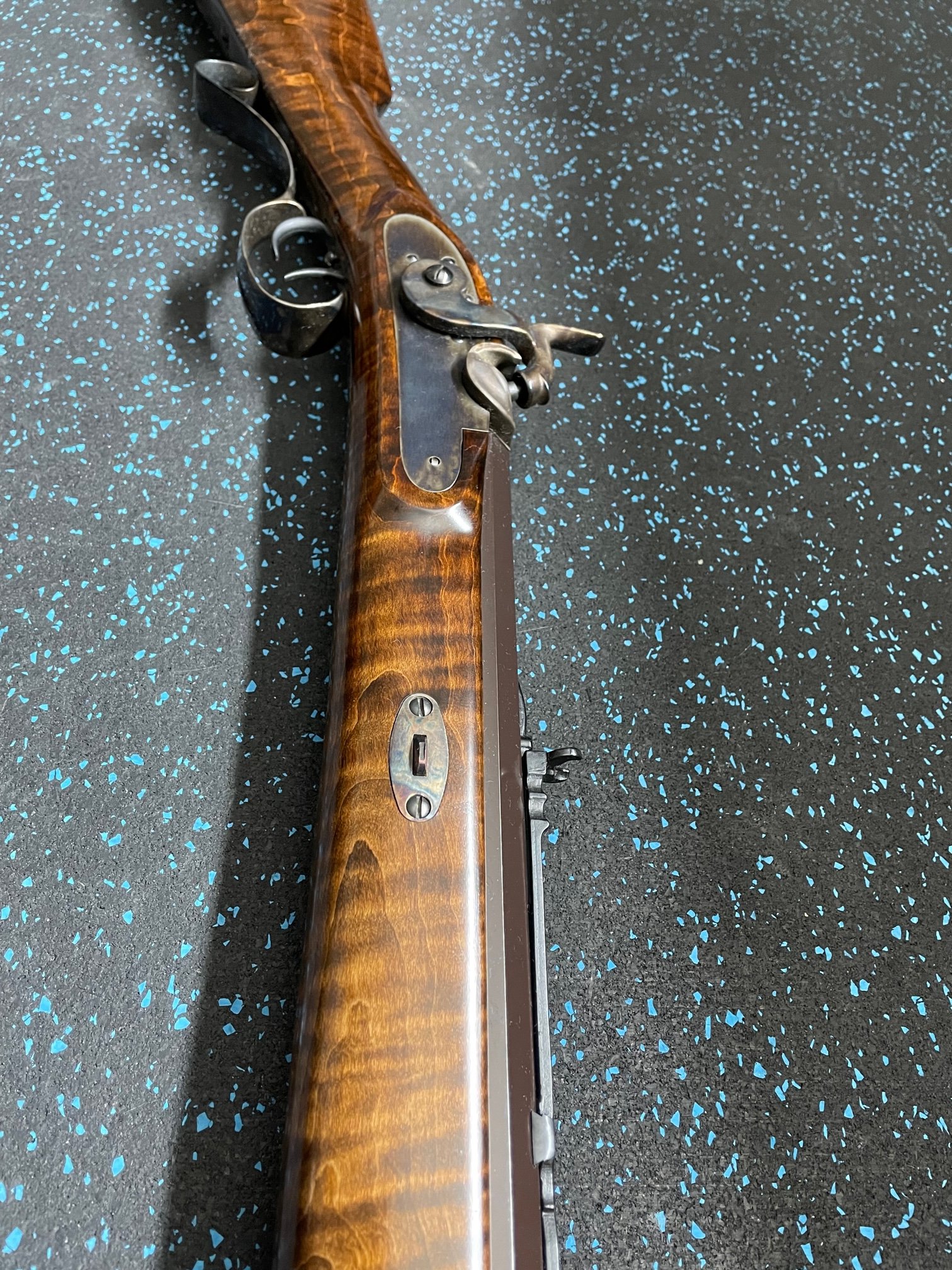

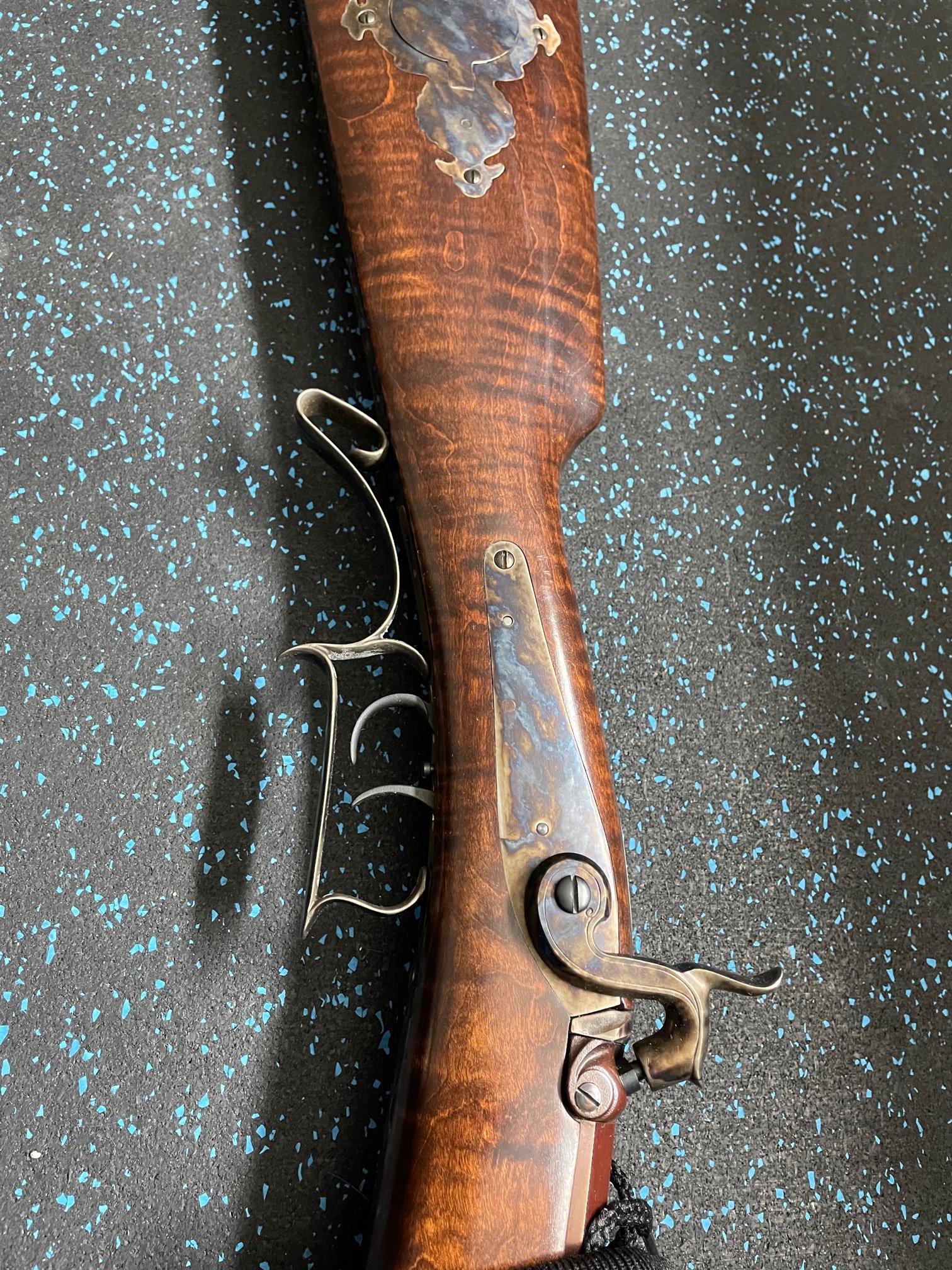

Not in those rifles. I have shot MBs out of other folks rifles but the twist rate is so slow on mine that round ball is the best option. I would give them a try in a 1-48 as that will handle both OK but if I was only shooting MBs, I would be looking at a 1-32 or faster twist rate as that seems to be the common acceptable range for the best performance.
