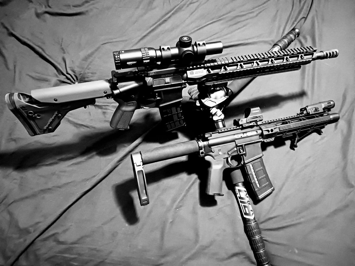

Absolutely. It’s my go-to AR right now. I wish something like this was available for pretty much everything I have used a rifle or carbine for in my life.
HD...check
Hunting....check
Long Range fun shooting steel....check
Kid-friendly....check
Suppressed and compact....check
For years people who have never chronographed short barrel Grendels have said it doesn’t do well, not enough velocity, but that has been opposite of my experience across 2x 12” ARs I built with the same barrels.
90gr TNT is doing 2700fps from my 12” suppressed.
120gr Federal is doing 2400fps.
That’s not much different from all the 16” Grendels I have owned or built.
These are large sample sizes, not 3-5rd data points. 11-15rd averages minimum. I could have cherry-picked higher numbers from smaller shot strings, but I prefer larger shot strings to get an idea of what mv really is.

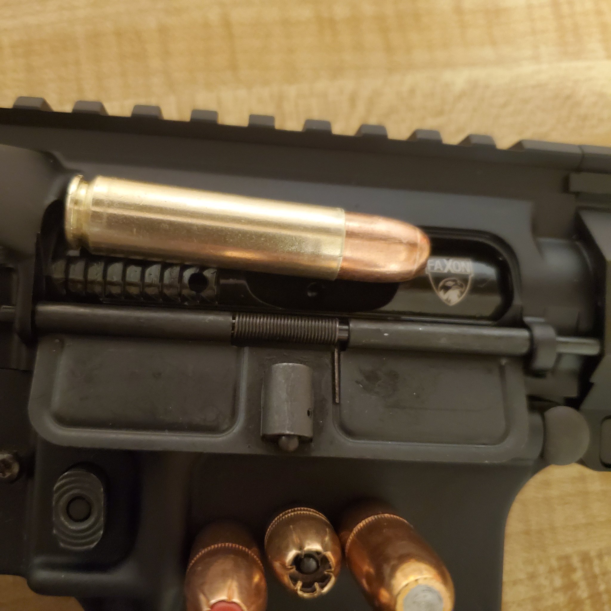

.458 SOCOM. Get a Rock River or a Tromix. It has the ballistics of a .45-70.

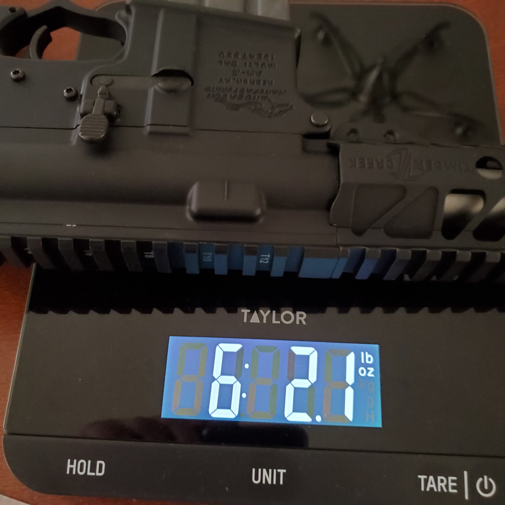

Or build a 6 lb 2 oz 308 16" barrel carbon fiber handguard, titanium bolt carrier, titanium muzzle brake, magnesium upper.
Shooting 168gr ELDM with loadbook max to 2756 ave fps with 1/2" 5 shot group
accuracy.
Capable of 1200 yd shooting.
If you are not into building a light 308.
Order a rifle or a complete upper from ROAM. They use pencil barrels, I used a light fluted barrel that was slightly heavier but a stiffer profile.
That's where I got the magnesium upper reciever, and it handling every thing well.
Including the heavy 208s at 2442 fps.
You gun build it your way, just a suggestion, where ya don't have to give up 308 energy and range, in exchange for weight. This 308 is lighter than all my AR 15s with 16 and 18 inch barrels. Plus ammo is available everywhere. And if ya handload little performance is lost.

Yeah, I like the 308 and it's family. Thats a sweet rig.
I have a sfar I'm going to improve on that I really like. But I feel the recoil isn't the best learning tool for my kids who aren't yet teens, and are sub 80 lbs.
I'm a fan of short, heavily fluted barrels. Haven't heard of ROAM, will look into them. Thx
Check them out, they have complete light weight AR 10 uppers starting around $1300.
Plus complete rifles, or all the parts, handguards, uppers, lowers, etc to help reduce the weight, of the AR 10 to your liking.
ROAM is a magnesium high tech aerospace contractor, who also do this AR 10 business their CNC machines.

My 60lb 8yr-old was just spotting his own hits with the Grendel and 123gr on Thursday at 400yds, using the LaRue Stealth 2.0 with 18” barrel and the Tranquilo brake. He was able to see dust kick-up or plate movement through the Vortex Razor Gen 3 on about 6-7x with no problems.
He also enjoys shooting the 17.6” Grendel with 2.5-10x32 Viper PST on steel:
tempImage9ch6FO.heic
Pic through binos of the targets he’s on. He 1st-round connected on that 400yd round plate on Thursday with the LaRue 6.5 Grendel and Razor Gen 3.
A 14.5” Grendel would be sweet with a suppressor like the TBAC Ultra 5 Gen 2 or Dominus K-SR.
I have an Ultra 5 on the 12” Grendel that the kids love to shoot as well. They were shooting that on Thursday too.
Even with the lighter weight kids, none of the Grendels have short-stroked on them. I’ve seen some semi-autos short-stroke due to kids being too light to resist the whole blaster traveling with the bolt carrier group, like limp-wristing for long guns basically.

The 450 Bushmaster does everything the 458 SOCOM can do plus more...and does it with less cost, more energy available and flater trajectory with the 250 grain types.
Just get cheap Lee resizing dies .451" and .452" and lube and resize any .458" bullet to .452." IF you get the 1in 16 twist barrel.
Not the 1-24 twist.
I just ordered my 2nd 1-16 twist 450 Bushmaster barrel. It will stablize 500 jacketed and 502 grain lead...and still enjoy bulk 45 ACP bullets too. So any .451 to any .458 bullet available for 45-70, 454, 45 Colt 45 ACP, 458 Win mag can be sized down and used in the 1-16 twist.
Here is a resized 500 gr jacketed bullet in the 450 Bushmaster.
