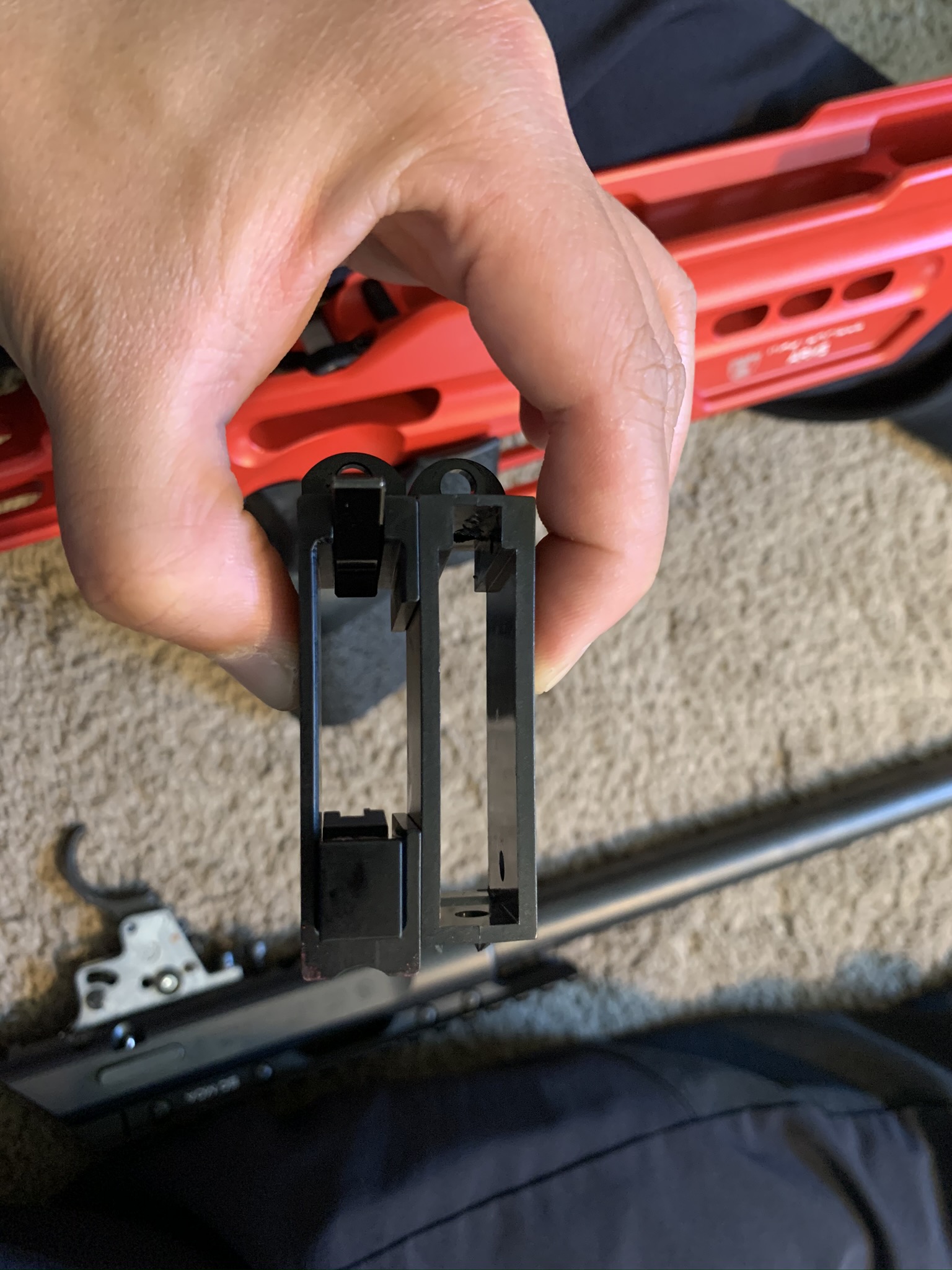

Well sorted bolts, and worked out how to get the lug in, next issue appears that the front bolt isn't able to put the receiver on the bedding , i think the magazine well and the well bolt are actually sitting on the chassis, the old mtr actually has a completed scallop cut out of the pillar bedding so I'm thinking I may need to route out a bit more room... anyone else seen this?

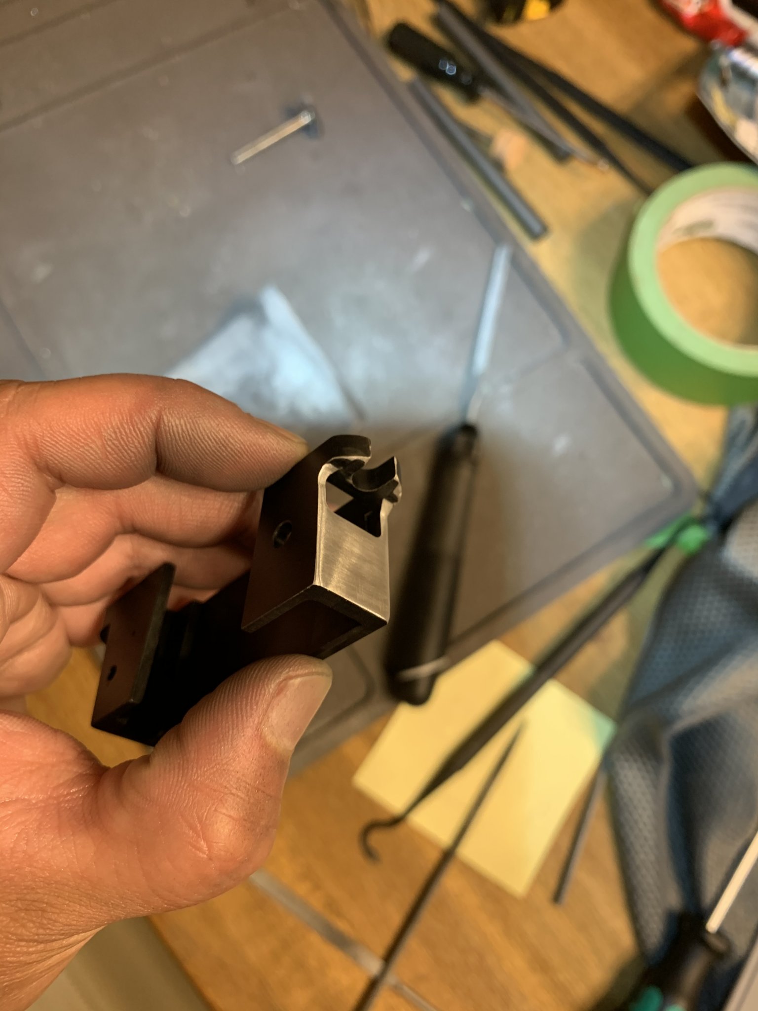

Hey just curious- your CZ- does it have the aluminum magwell housing from DIP? Because if so, that’s why you are hitting the MPA chassis. The magwell from DIP has different dimensions than factory plastic one. I had to file mine down significantly for it to fit, but better than messing up the MPA chassis.
Reactions: AllAheadFull

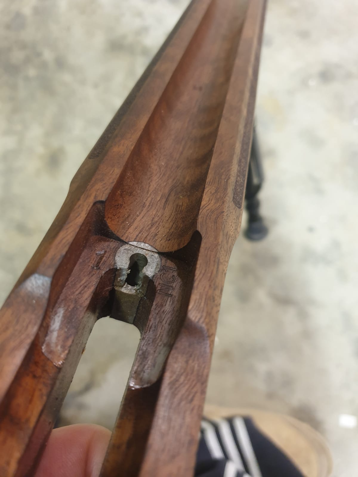

On the money, I'll get it sorted , its a learning experience and asfarasthechassis goes its a ripper. Apparently the MTR has different length bolts, I'll chuck up a pic of the MTR, and I recon something has changed in specs as you can see CZ is now cutting right into the pillar to fit the action in
