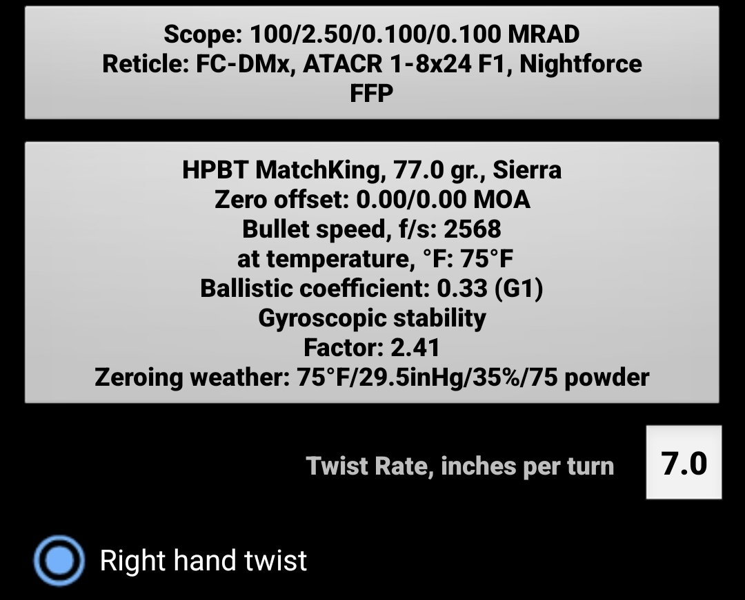

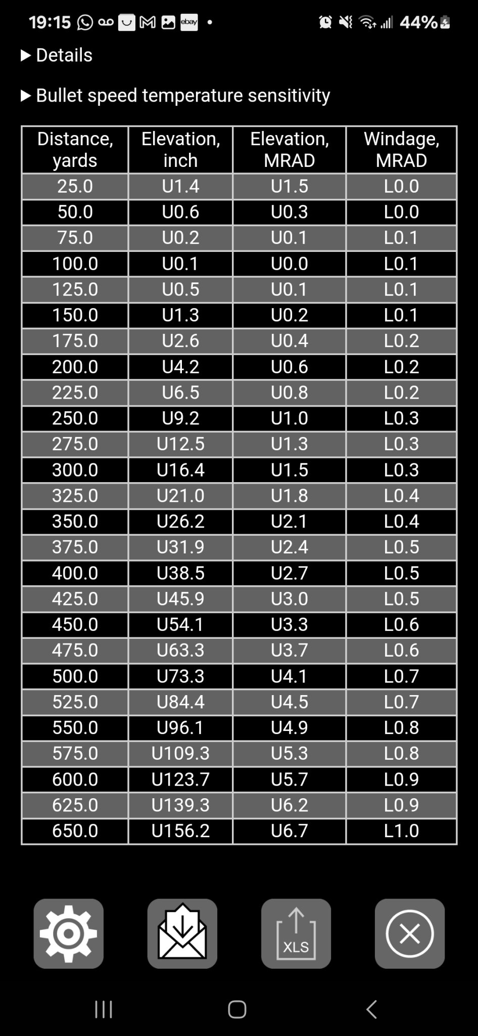

One other question. I normally zero my ATACR for 50/200ish just like I do my red dots on my ARs. If I went with an MPVO and offset red dot should I zero the MPVO at 100 yards instead? I'd probably zero the red dot at like 25 yards since I would only be using it for close targets and 2 gun type stages.
Or would I even need a red dot with a 2-12x?
I've also looked at the Mk5 HD but it's a little more expensive than these options.

I have always zeroed my rifles with red dots at 50 yards because there's no way I can group at 200 yards with a red dot. Plus I didn't have access to a 200 yard range and now I do. We also shoot most of our stages with rifle at about 50 - 75 yards and an inch "is" a big deal. Each target we miss adds 10 seconds to our total workout time. So 10 misses out of 60 is 100 seconds added to my total time. If we go out past 200 yards the targets are full size ipsc steel or bigger. I feel like I do fine/well in the workouts but get outshot with my rifle at this point (it's not just the optic). Pistol I'm pretty good.
Let me know if I'm missing something but I zero at 50 and then see where my drop/dope is at 200 since most of our stages are 50-75 yards. My zero is also pretty close to a 50/200 zero with 77gr but dead on at 50 yards. That's just what I'm used to.
But if I go with something like a 3-15 with an offset red dot would I zero the 3-15 at 100 yards for the longer stages and red dot at 25 for the 2 gun type stages? I would still need/use magnification for most of the rifle stages even if they're 50-75 yards for the precision aspect.

Re: zero distance. Everyone has their thing for their application. I zero my magnified optic setups at 100y. 50y is almost always less than 1" low with a 2.5" bore to optic height whether I'm doing 55, 62, or 77gr. Just know your holdovers every 100y out to 600. Or, if allowed, make a tiny dope chart and tape it to your buffer tube so you can just glance down and see it.
So, that's just me. I've never used an ATACR 1-8 in a competition, but I've shot with one for fuckarounds and that optic quality is amazing.
Edit to add the below:
100y zero, classes data to what the AAC does out of my 14.5.
Full value 3MPH wind from left to right
50y is 0.6" low from a 100y zero.
