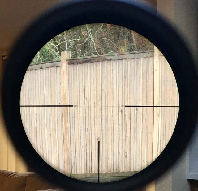

When you get a chance, post some through the scope pictures of what the reticle looks like on low power.

It is really hard to see the center part of reticle at 6 power. I absolutely don’t think this would work for hunting stuff.

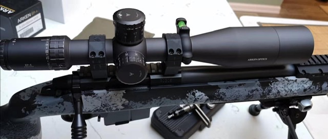

Mounted on the rifle. I do think it is a good looking scope. I fuddled with it and will do some write up tonight. So far no major disappointment yet, but the glass is not as good as I hoped for either, need to figure out how to put some words with it.

OK, got bunch of things to do tonight so let me put up with my initial observations on good, not so good and ugly.
The Good:
  1. The turrents are amazing. Best I've used. Line up perfectly, no wiggle, no fuss. Very mechanical. Better than my SB, Kahles, Hensoldt, ETR, and the list goes on. I did not have a chance to use TT yet, so not sure about that. Point is, for this price, its crazy that they got these kinda of turrents. Smart design, good execution, very cost effective with good results. A real treat to turn those huge stubby things.
  2. The eyebox is huge. Only seen similar thing on Hensoldt. Very easy to get behind, taking photo with cellphone is remarkably easy, comparing to my other scopes. I really like their optical design from this perspective.
  3. The mag ring takes right amount of force to turn, and has clear stop. Eye piece ring is a little small for big hands, a little hard to get out of its initial rotation but otherwise I like it to be tight so it does not turn easily by accident, as it is not locked.
  4. The through scope view is beautiful. The edge is very thin and present a sense of huge FOV, but I have not been able to measure it to validate what Arken says on their website.
  5. Comes with sunshade, not too bad. The included scope covers are interesting as they are see through style with real glass ends, never seen real glass on this type of thing, always plastic stuff.
Not so good:
1. My current observation, is the reticle is way too thin for low power use. 10x is the minimum you would want to use this.
2. The finish is OK, definitely there is visible difference between this and $1500 scope.
3. The glass clarity, is not as good as I have hoped for. I need to do more thorough comparison the next few days when I can. It is definitely clear and usable, but could be my standard being too high, I need to go out to my 600 yard range to carefully look into it. I indeed hoped it will have similar glass like Weaver tactical, that's my expectation.
4. The focus knob is a bit tight to turn. Hope it will ease out over time. Also I think it does not focus very close, at least 25-30 yard based my results. May not be a good news for air gun and .22
The ugly:
1. They did a horrible marketing job, ruined the initial reputation, and somehow fucked the new owner like me as well. Feel like I'm the Trump supporter among Demo's these days, on this website.
2. No illumination is a challenge for thin reticle, and significantly limit the use scenarios. It may mean additional cost though.
3. Long term durability is unknown, how long the company will exist is unknown. So do not buy 3 scopes at one time like me - it's risky.
If you're like me, have couple nice rifles built out but could not afford putting $2K glass on all of them, I think it's a pretty good solution.
Thanks, I was afraid of that. I'll wait until they have an illuminated version or a different reticle before I do a review on one. That will really help on low power.

it needs something close to pop,
reticles are easy to redesign, everyone has an opinion on them, so finding a decent middle ground should be easy. Some people get used a particular design and others find it not so useful, it's subjective, you are asking people to pick a favorite color. With the reticles you really have to get behind them in the scope because on paper they all look great.
The reticle is a bit tough to resolve in the 4-16x, no so bad on paper at 100, but on steel at distance, yes.
I would almost say, it needs illumination to be able to pop it on.
I started getting more into it this past week, shooting it on my Cadex, there is actually a tiny piece in my latest video with the Prime 6CM ammo.
I had to make sure the ocular focus was perfect so I could see it against the variety of targets we have. it depends on the target color and the surrounding area, but I noticed it too.
under normal conditions, this is where i would turn on the illumination, pretty much the same thing for the S&B LRR reticle, it's nicely thin and small but can get lost in the noise of the background.
