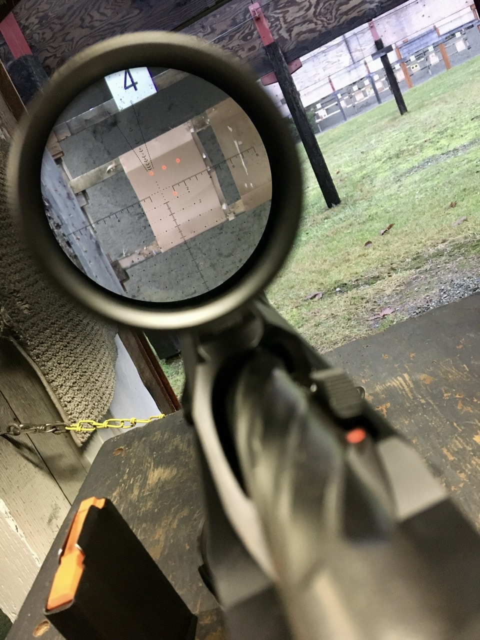

A full power reticle image by my crappy iPhone 6, dusk of a rainy WA day. I was completely wrong about the glass. It is just impressive. Very bright and clear, CA is barely visible ( photo shows more than you see through it) and really good resolution. Will skip the spoken comparison with razor g2 but I have my opinion. Parallax is actually turnable with one hand in position so I am good. Mag ring is now really stiff and I think I will need a lever.
Just amazing, will order one more to cover all my rifles with it.

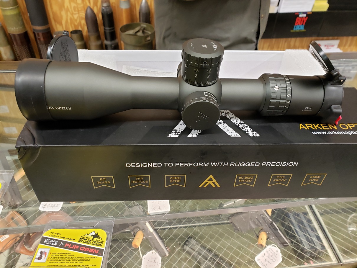

Ok, so my 4-16x50 just showed up. The mag ring is snug, but not overly tight. I could see throwing a lever on it, especially with frozen fingers on a hunt. The El and Win turrets are super tactile. There's no chance of missing a click when setting. I'm a fan of fine reticles, and think this will be alright, but I could definitely go for one just a touch thicker. The reticle is busy, but I don't pay attention to the parts I don't need, so the range thing above the crosshairs don't bug me. The glass is fantastic, especially for a sub $1k scope. I'm happy I went with this over the refurb Viper PST I was going to get (I don't use illum ret). The parallax knob is snug at first turn, but buttery smooth. I can't wait to get this mounted onto my CTR!!

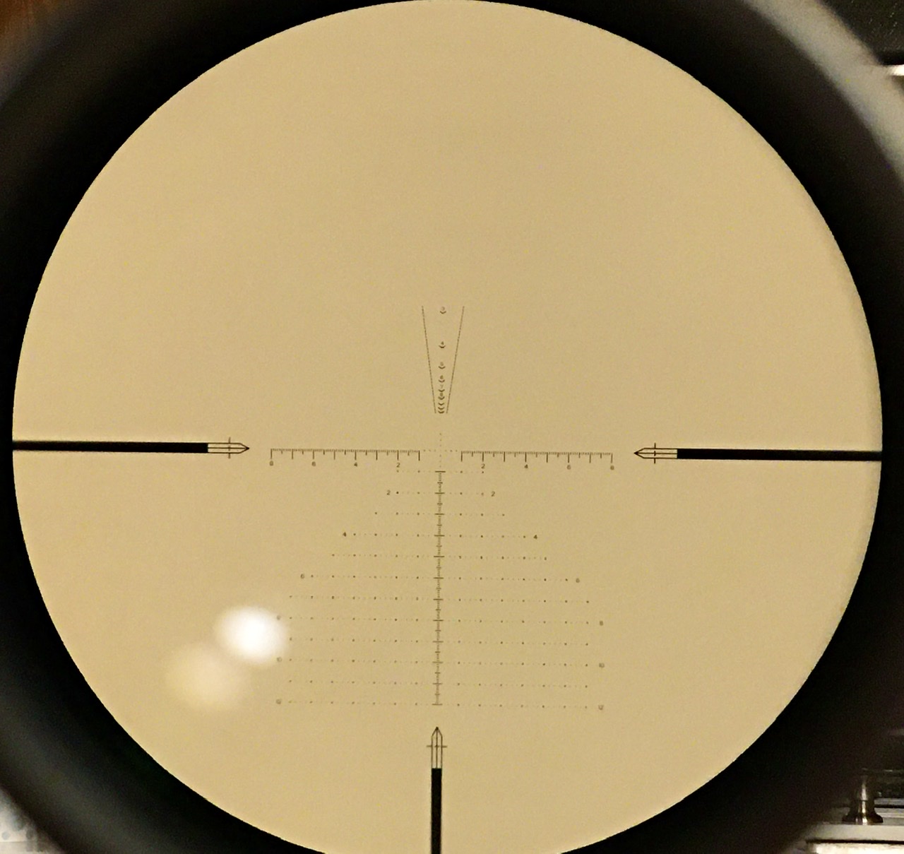

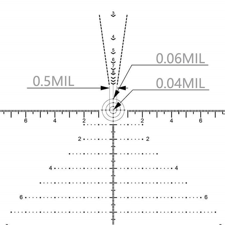

@lowlight does the reticle have .25 mil marks in person like the pics? Between each mil mark there are only 3 marks so it's not .2, .4, .6, .8 as in others but .25, .5, .75. Odd for mils. If so that is something they need to change also with that reticle as well as the upper portion. Other than that it looks good.
Can anyone answer this question?
Mine has .2 hash marks. 4 marks between each major hash mark. The photo of the reticle must be a mistake.
So 4 marks between the center dot and 1st mil and same for the dots in the Christmas tree between mils? Diagram shows three in both those spots but .1 marks between 1 mil and out on the horizintal and lower main crosshair. .1 is pretty fine for those spots. Should be .2.
