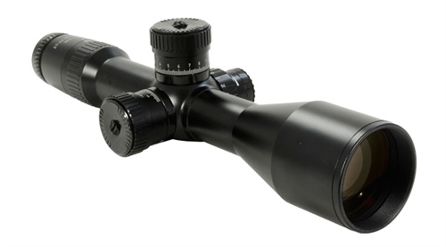

I have had Hensoldt ZF 4-16x56 FF scope for some time. It is an old thread, but it could be helpful info for someone who is still interested. I "compared" it side by side with these well known scopes I had opportunity to work with:
a) SB PMII 3-12 ST/IL (single turn, no parallax adj. - fixed at 300m, illuminated),
b) SB PMII 4-16x50/P (parralax adj. only)
c) USO LR17 H59 (3.5-17x44) 2016 year made
all scopes were FFP and mil-mil. Hensoldt is the most expensive of these 4. All of them are great scopes with no doubt and be sure I am very picky of what I am looking at. What I have found on Hensoldt ZF 4-16x56 FF are my basic observations and experiences only. So, here we go:
1) glass: image quality and colours were nice and true, but had some distortion through FOV to the edges, mainly on top (above horizontal mildot line). Edge resolution was better on PMII and LR17. PMII 3-12, 4-16 and LR17 had more comfortable image for my eyes (3-12 has fixed parralax at 300m). Slight tunneling on 4x, the same on PMII 3-12 at 3x, no present at 4-16PMII, and worst on LR17 3.5-5x.
2) turrets: personaly I did not like them - not so good for firm grip (narrow knurled grip area), click spacing was too short for 12mils / 1turn on small turrets and marking lines did not match reference zero arrow marks (and this issue you can not eliminate with this scope, it was mentioned in manual already). I prefer PMII ST and USO EREK turrets because of their grip, clicks are slightly more positive and definitely better spaced for reading. Click step is 1cm / 100m (.1mil / 100m) on all these scopes.
3) parralax adj.: picky to set up - very sensitive which was not a case on PMII 4-16 and LR17.
4) magnification ring: better smooth operation and grip feel than SB PMII with rubber ring, but LR17 wins with no doubt.
5) build quality and finish: excellent and rock solid, there were no any rubber, plastic or soft material exposed to the user. Black anodizing was perfect, the same as PMII. LR17 had different type of surface finish - hardcoat anodizing, which has higher friction coefficient (lesser possibility of moving inside scope rings when mounted - you can use less torque on screws).
6) weight: lower than LR17 and adequate for scope with 34mm tube and 56mm objective.
7) reticle: mild-dot with range meter (200,400,600,800 and 1000m) all illuminated - better than SB 4-16 P3 which is too thick. I do not compare it with H59 at LR17 which is a totally different reticle. P3L at 3-12 is a little bit thinner than P3 4-16PMII non illuminated and looks better for me. I can say, both are very good reticles (Henny + 3-12PMII P3L). No visible reticle cant on each one was found.
I have had all these scopes brand new. Each of them has its +/- and facing to the question which one is the best is really hard to tell. PMII 3-12 and 4-16 scopes have illum. knob located separatelly if you have parralax adj. already on them, which take off some ammount of mounting space for rings / hide observation of position of the parallax adj. knob. SB 3-12PM II had no parralax adj. but illumination which was located instead of parralax adj. knob (SB does not make this version of 3-12 PMII anymore).
It is my observations with pro / cons based on my point of view only. I did not make a full evaluation report because of time. Hope this helps someone...

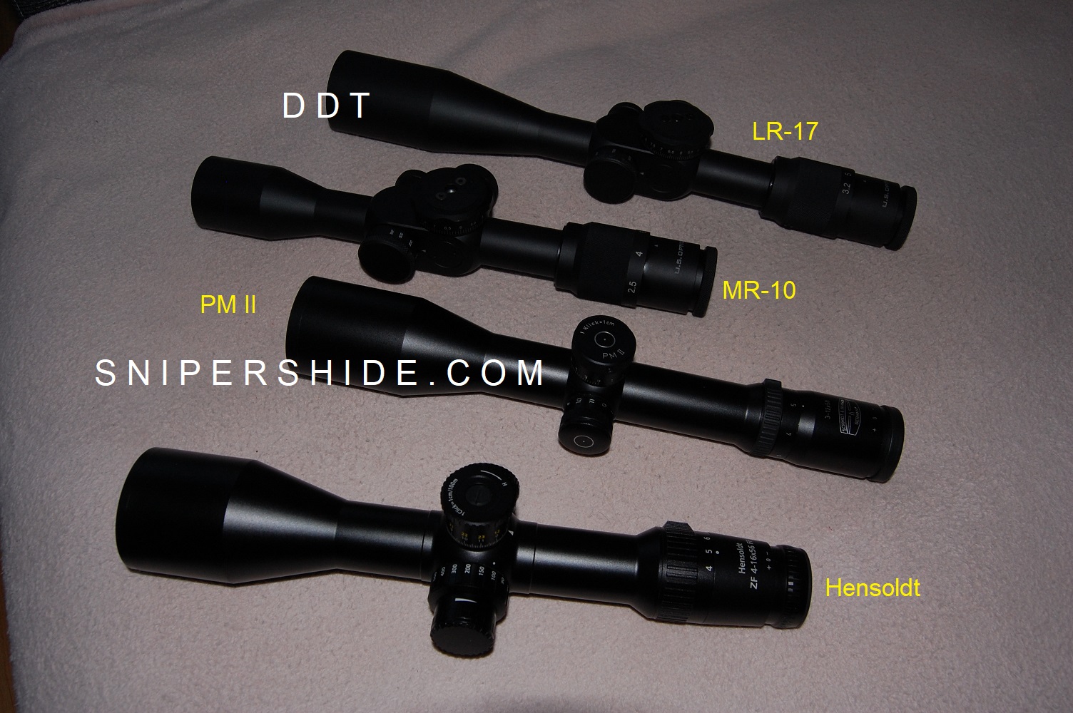

...have had a time, so I made an image / picture quality comparsion test side by side with these scopes today:
a) Hensoldt ZF 4-16x56 FF
b) USO MR-10 MIL ( 2016 year made )
c) USO LR-17 H59 ( 2016 year made )
d) SB 3-12x50 PMII/IL ( fixed parallax at 300m )
I have compared them all adjusted to the same FOV no matter which zoom mark was on each one. I do not compare them at min / max zoom ratios which would be "unfair" due to different errectors (4x vs. 5x) and zoom range (3-12x; 4-16x; 1.8-10x; 3.2-17x). Also keep in mind, that USO scopes have 30mm tube only and smaller objectives. Picture quality has been compared mainly on 5x and 7x magnifications (occasionally at 10x). All scopes were brand new, never installed. I ended up with this result, which first means the best:
1. SB PMII 3-12
2. USO LR-17 ( 44mm objective; 30mm tube ) - but very very close to SB PMII
3. USO MR-10 ( 37mm objective; 30mm tube )
4. Hensoldt 4-16
Hensoldt was the worst of these 4 scopes in picture quality. SB was the best with LR-17, both had only small distortion on edges and was very difficult to determine which one is better. MR-10 had small FOV, so it had to be adjusted to lower magnification, but picture was still better than Henny, and only with small degradation on edges.
I have spent a lot of time to find out the right head / eye position on Henny scope. However it have not helped much, picture was still fuzzy and distorted on edges, far more than other scopes did - distorted picture circle was 2-3x times greater. My second complaint on Henny is that its whole picture is very distorted if you move your head even very slightly from optimal sight axis. Parallax adj. does not helped, it is simply its attribute. For me, it is absolutely unacceptable at such expensive scope.
1. SB PMII 3-12
4. Hensoldt 4-16

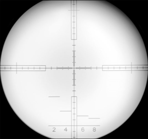

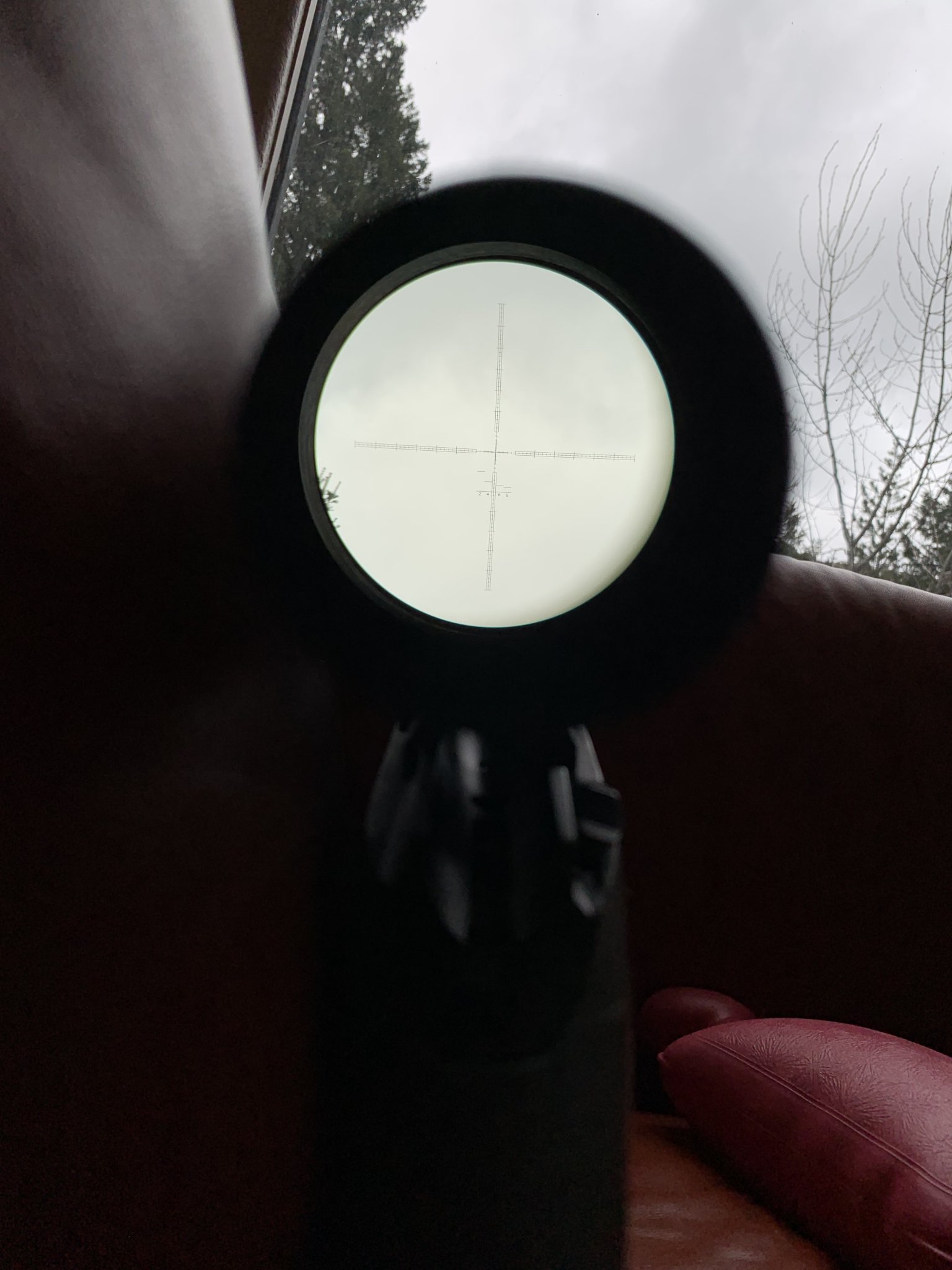

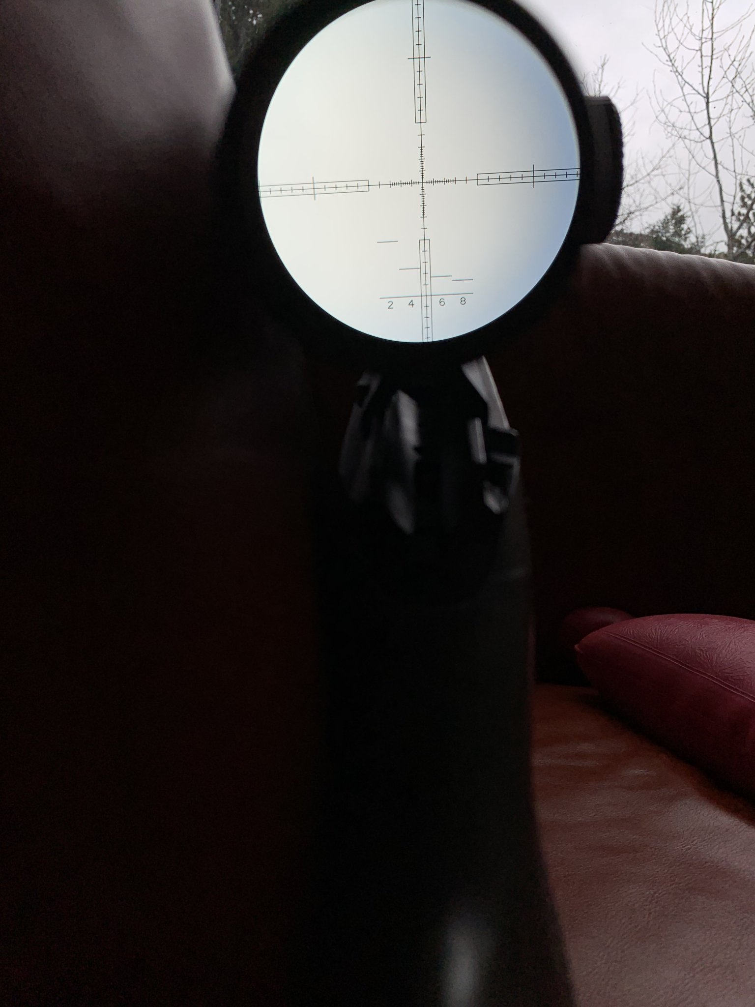

The mil hash reticle of the 4-16 at low/high mag. The sight picture and edge to edge clarity of mine are outstanding.
