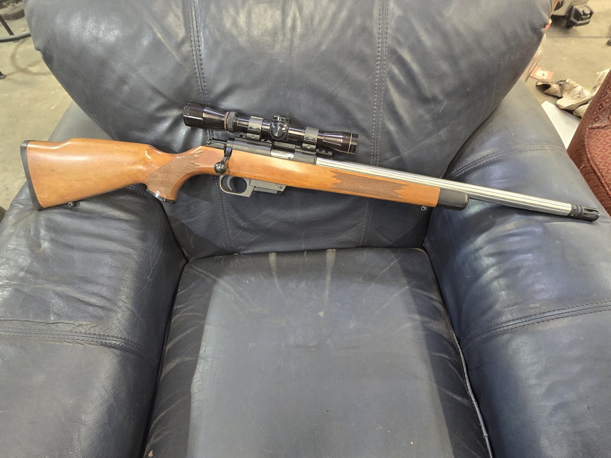

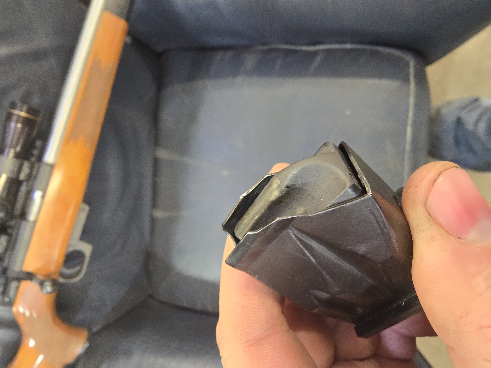

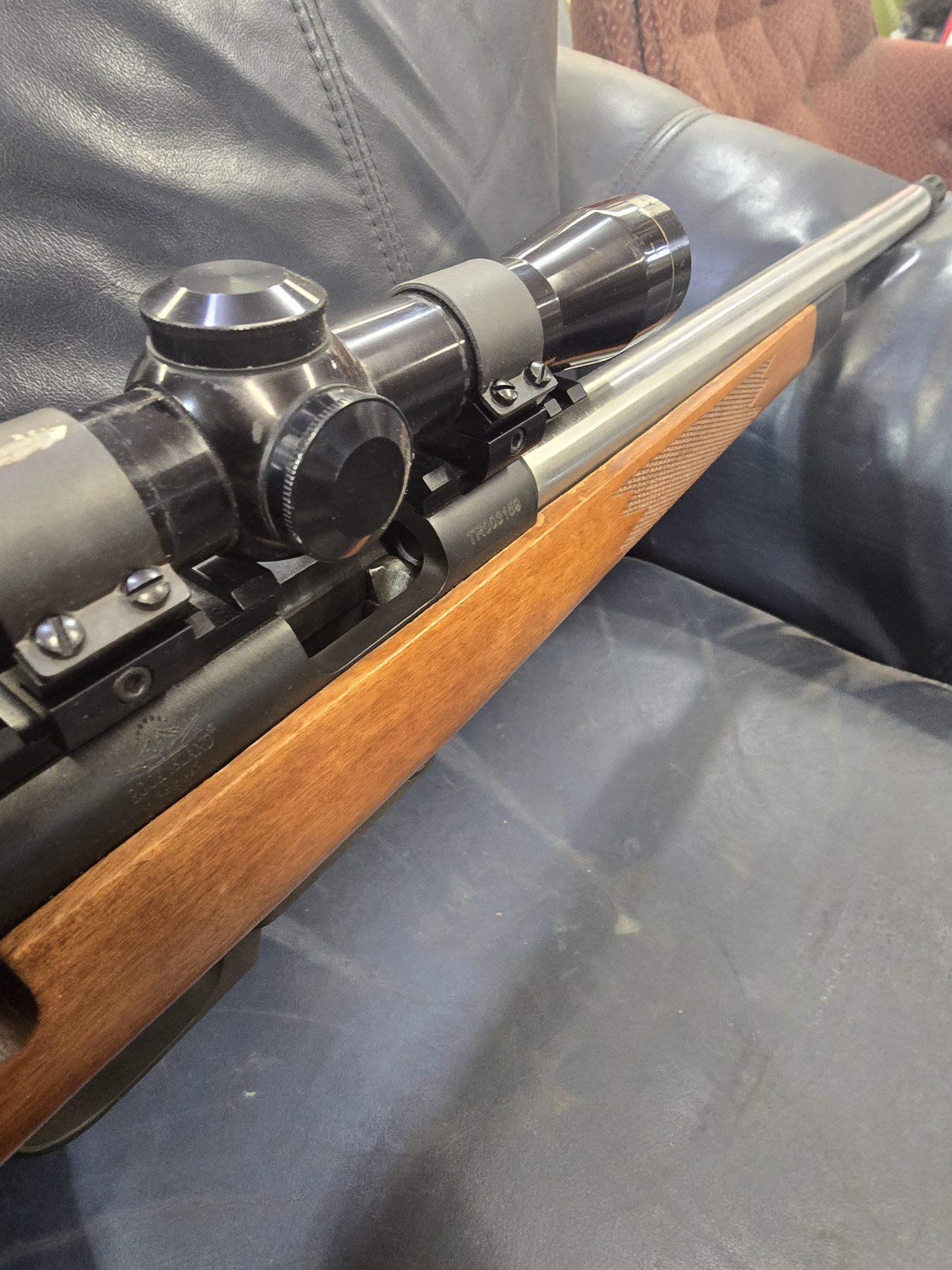

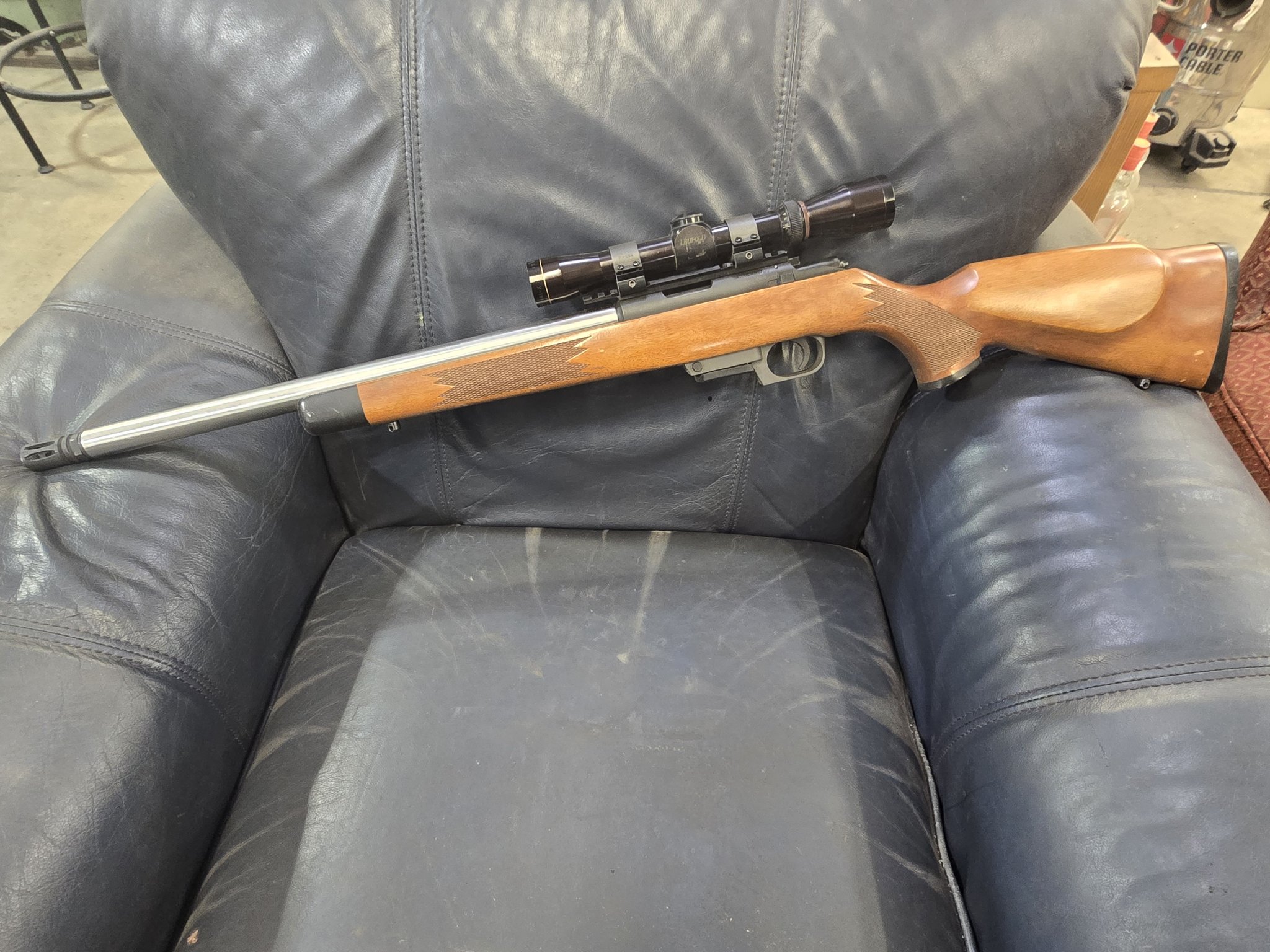

Matthias, can you post pics of your current rifle? I'd happily accept 3-4 MOA. I can always get bigger steel targets! Thanks for sharing that list.
Pictures are not the best. Feed ramp opened up, magazine lips smoothed out, the bolt has been opened up just a bit all around and you can see two little angles at the bottom opening for easier feeding, also extractor was refit slightly for better brass control on extraction to ejection.
