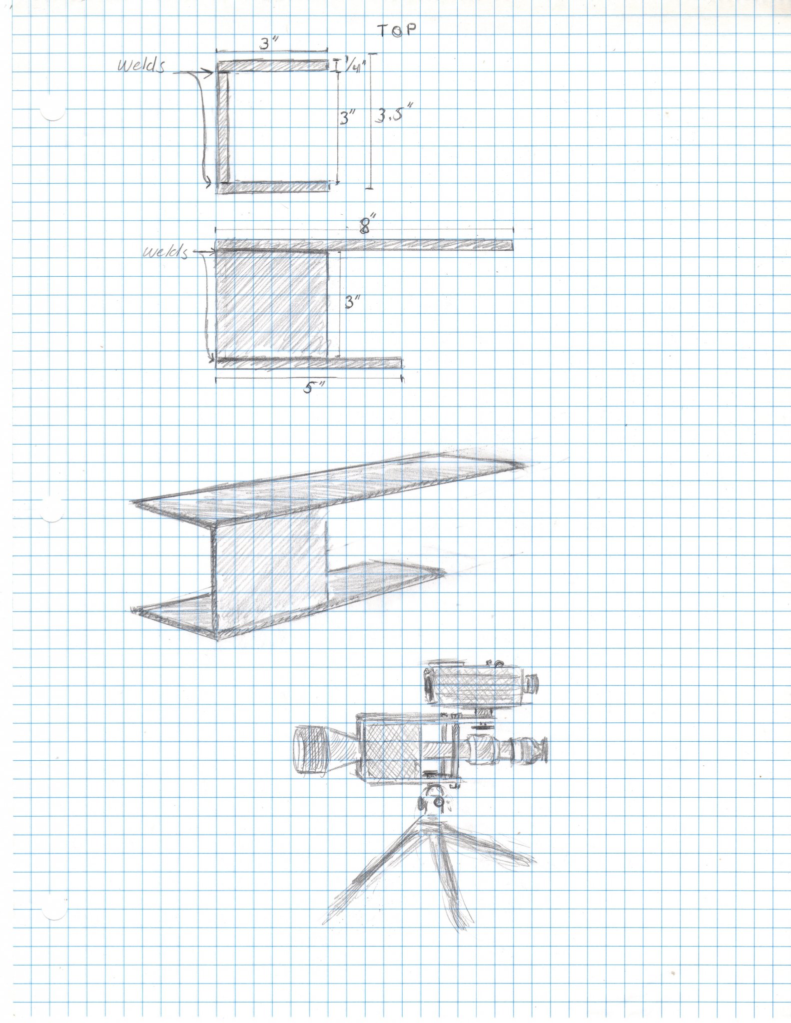

    Edit: go to page 3 for the pictures of the finished unit.
    I need a "C" shape welded from 1/4" aluminum plate that measures 3.5" high with 3" long legs with the left side 3" deep, the top leg 8" deep and the bottom leg 5" deep. All edges will be flush in the front so the top extends 5" past the side and the bottom extends 2" past the side. The left side piece will be 3" tall with the top and bottom welded with it in between so the whole height will be 3.5". I need really solid welds and a perfect square in all 3 dimensions!
    I can make a good drawing and scan it and email it to whoever can do it. I figure if you can weld the aluminum and are as good as I need, you've probably got some 1/4" x 3" x 8" scraps laying around. I can pay $20 plus the shipping; it should fit in a flat rate Priority mailer.
    I plan on installing posts on the three unsupported corners using 3" hollow aluminum tubing with 1/4" thread stock and lock nuts. It's going to be used for a spotter/LRF mount and the LRF will be sort of cantilevered out on the end of that top 8" piece. The LRF is 2 or 3 lbs. I'm guessing, it's a Litton LRR-104 Mk5 if you want to see what it will need to support, and the bottom will have a USO spotter mounted forward on the bottom 5" piece. There'll be a 2.5" length of rail on the side to accept IR illum. I'll try to center the weight the best I can and mount the whole thing onto a ball head and tripod with a steel helicoil threaded insert, which will be used for all the threaded mounts.
    So that's it the best I can explain it, like I said, I'll include a good drawing. It's really simple if you have the materials and equipment to keep it square and weld it solid. I figure $20 is reasonable? If it's honestly not, let me know. It's only two welds and three pieces of scrap. I can throw in some KAC rail covers or something to sweeten the deal.
    This would really help me out, nobody makes what I need and I don't really wanna put 'em side by side. And I know some of you are excellent welders.

    Okay, here's the drawing:
    Edit: I can drill and tap and work all the holes and fittings of course, I just need the 3 pieces of aluminum welded together.
    Not really elementary dude.
    I suck at welding aluminum but I know enough not to promise "perfect square" unless I can flycut the sides after welding.
    If I am imagining this right, he would be better off buying a piece of 3.5" square tube with 1/4" wall (shouldn't be too hard to find) and then cut it to shape with a milling machine, bandsaw, the creative use of some other machine or even a hack saw and files.
    Pro tip: lay out the corners and drill holes to make nice radius'.
    Welding probably won't come out perfectly square unless your fixtures are perfect and a 1x piece doesn't get that.
    A square tube will spring back a bit when you cut one of the walls but dealing with that is about like dealing with a crooked weldment.
    Bending and thick aluminum don't really mix, you get cracking at the edge and if it's under any stress, metal fatigue will break it.
    If you made the left side of a "C" thicker, you could get the edges milled square and then bolt the "C" together pretty square but it could loosen and isn't as strong as a tube extrusion.
    Any way you slice it, making 1 isn't cheap.

    Stryker... Give me a few days and I'll do it for you. I have 1/4" scrap lying around. And it's too damn hot to go out shooting. And the workshop at Schloss Nitrocellulose is air-conditioned.
    No charge. Pass the favor on to someone someday. Though I am partial to good hoppy India Pale Ale's if you happen to have some lying around!
    PM me with where to send it when it's done.

    @Strykervet, back to the second sketch with the 'support posts' installed. Do those need to be fastened/removable or can those be welded at the same time? I ask, because in the due process of setting up and welding, those done at the same time would DEFINITELY help keep things aligned and stable and square and plumb and perpendicular and gooder.
    Those are technical terms, for the unwashed.
    What I've gathered from the drawing above.
    1 - The fleshlight mount has me concerned because if I get a bit overzealous, I may cut the shit out of my abdomen with the protruding edge of that design.
