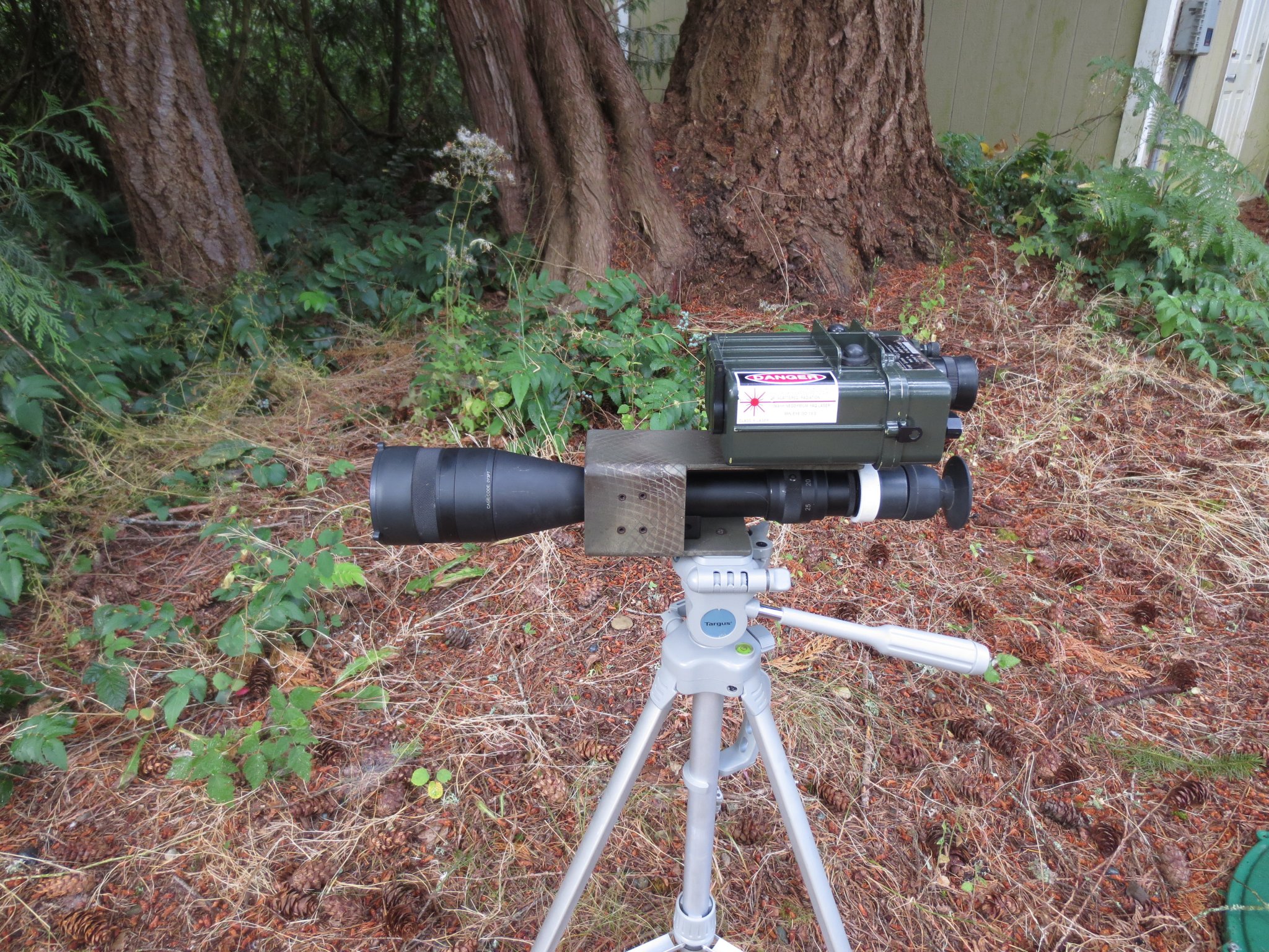

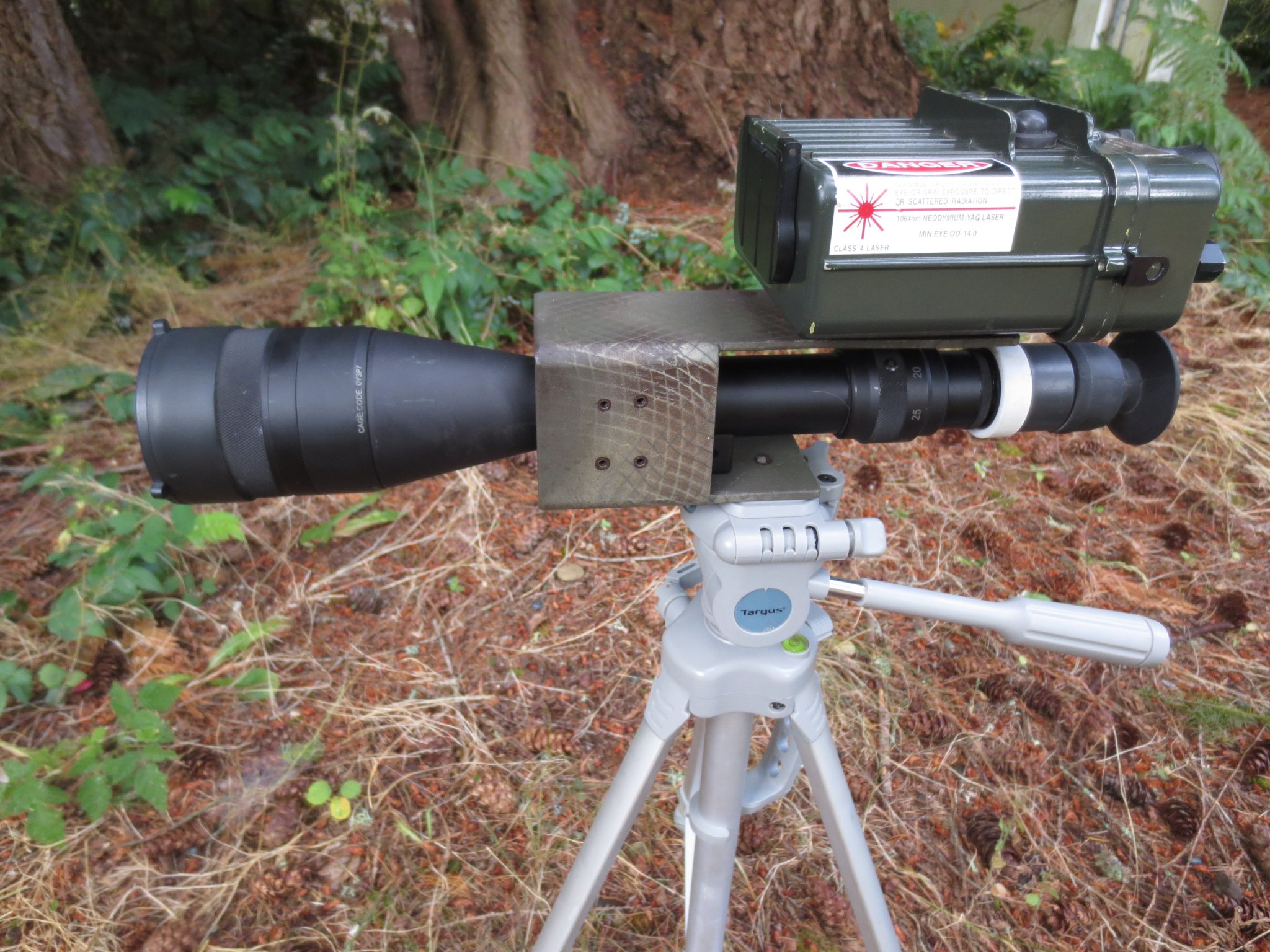

Alright, here it is! USO spotter with a custom eyecup (made by another member) that keeps eye relief just right with an LRR-104 Mk5 LRF piggybacked on a Sirhr Custom SS mount! Totally badass. All it's missing is a piece of rail on the side that a PEQ or possibly some other illuminator will attach to. The four holes are for a small elevated rail section I'll install later. The tripod is a cheap one I got for a cheap chrono but it works for the picture. I got a Sirui from Cameraland on sale that'll go down to 5" so it can be used in the prone, but it won't be here for at least a week. Just need to add a Kestrel and a PDA.
It's a really nice looking little field setup and it's as rugged as it gets. Totally satisfied, the mount is solid and well made and supports the weight. Wanted a Spotter 60 and PLRF-15C but divorce derailed that. Even made saving for a Leupold Mk4 60x out of reach. I got this spotter and LRF for $1000 total and the reticle matches the reticles in two of my scopes and the LRF works out to 10km, so I don't think I'm missing out. Leaves me open to finish other projects and to load, load, load.
Cost me some beers and some shipping and I got what I wanted and he got what he wanted --and USPS, they sure as shit got what they wanted!
This setup will seriously come in handy with the DTA HTI and M2HB.
